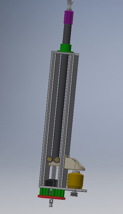

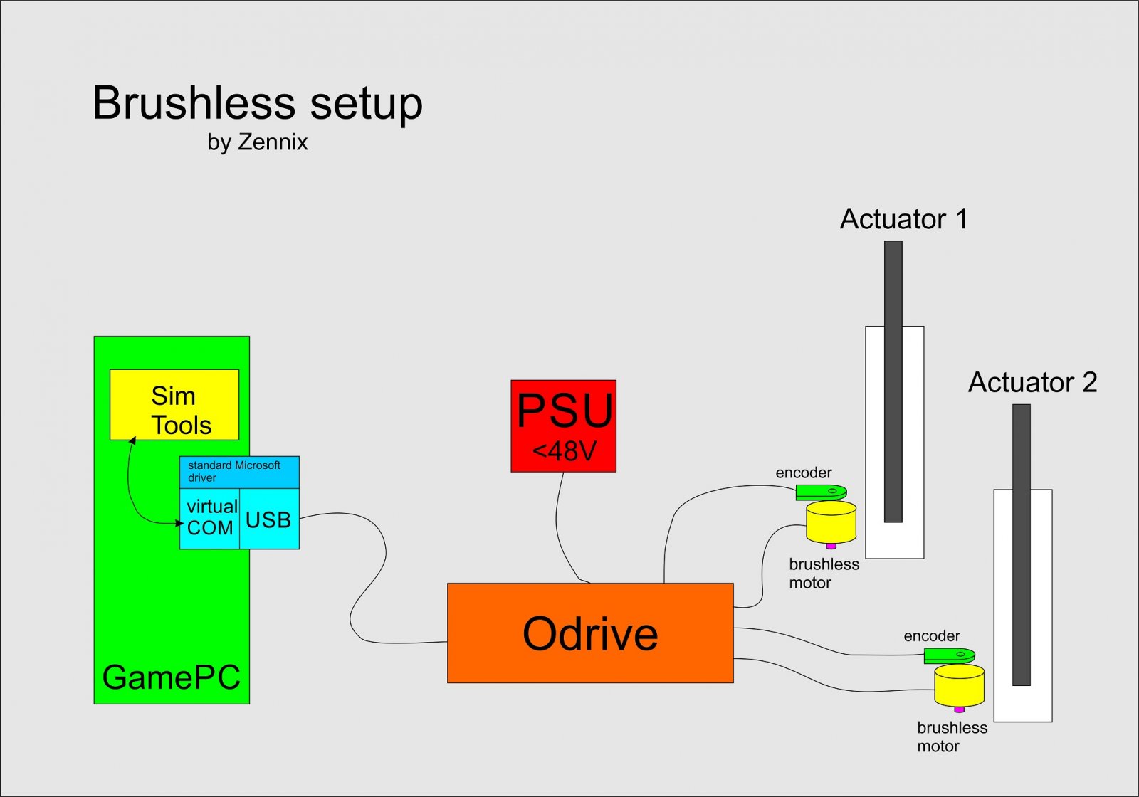

    Hi all,

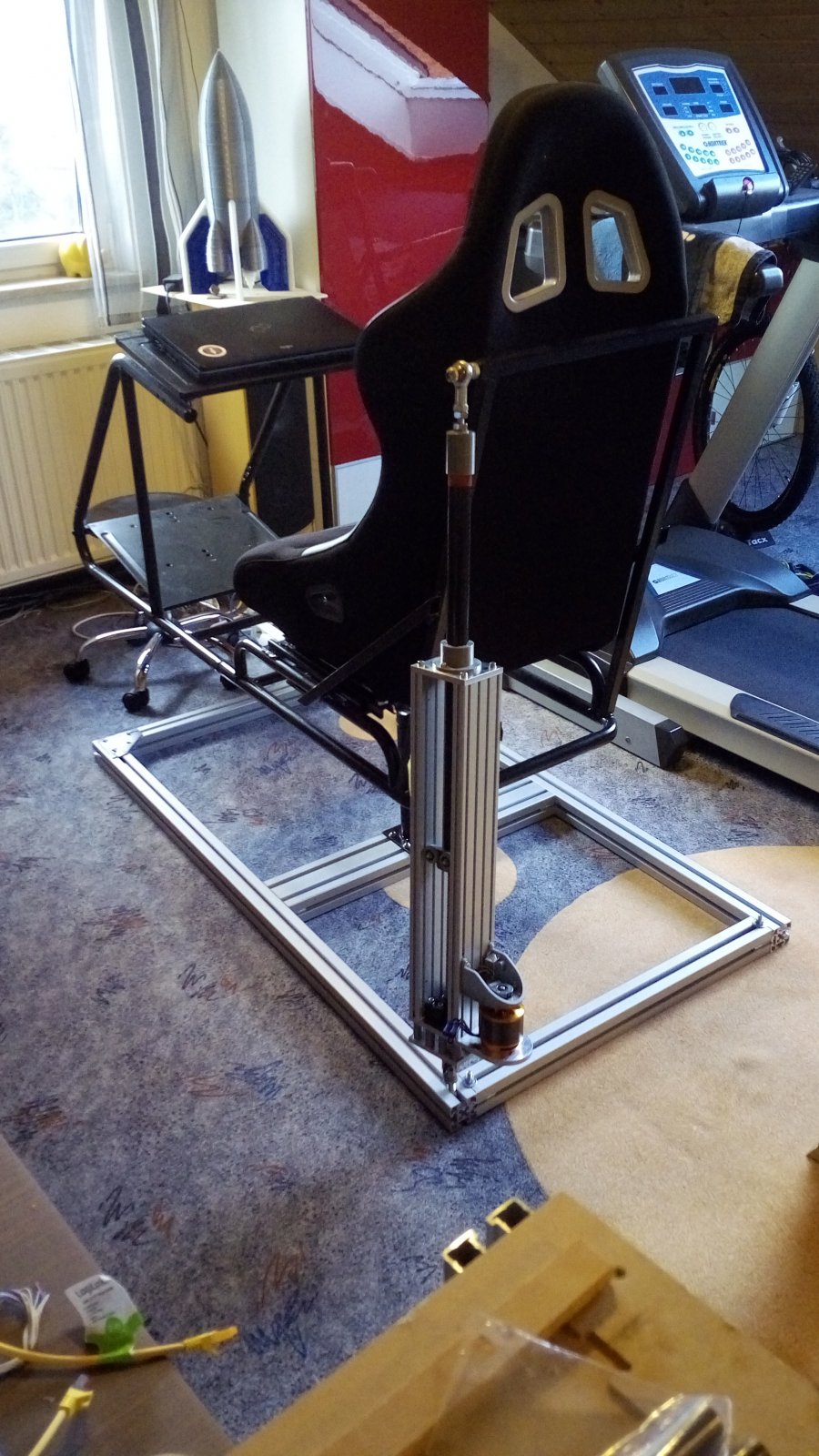

    it's time to present you my 2DOF solution.

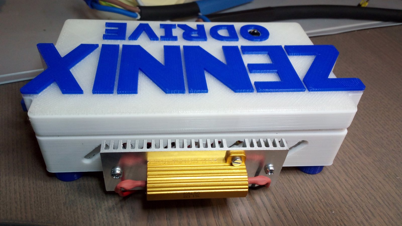

    After reading a lot in this community and inspired from simulators like silentchills and other great builders, I decide to build my own. The goals for that sim was cheap, easy and the use of brushless components. After some digging I found a project that combines the power of cheap brushless motors with the accuracy of stepper motors. In addition, it understands serial commands and one circuit board can drive two motors. And the best, it costs 150$. If you are interessted in, have a look at https://odriverobotics.com/.
    The ODrive guys are still adding new features and debugging their software, but now I have a version that will be able to drive my 2DOF. It connects via USB direct to the game machine and understands the commands direct from the game engine. No need for additional Arduinos or other stuff.
    Here the pictures of my solution:
    Drawing

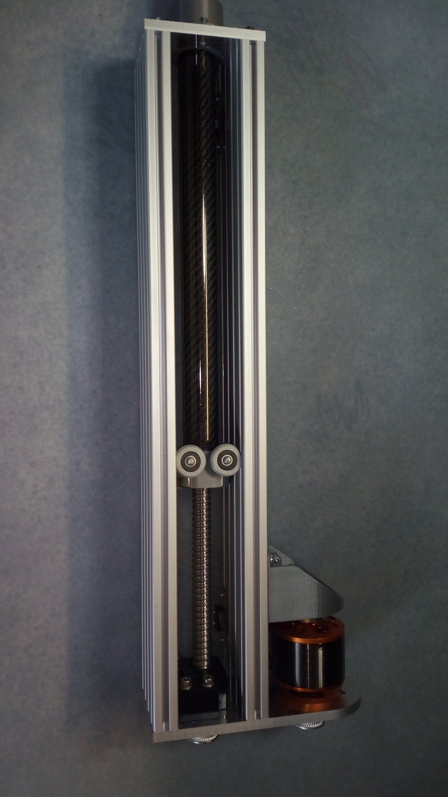

    real actuator

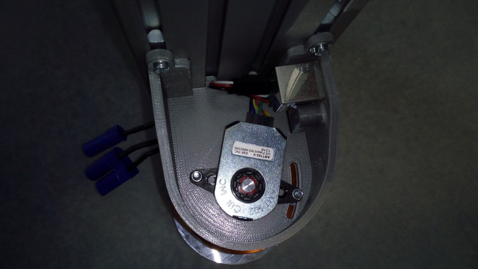

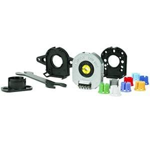

    Encoder for position control

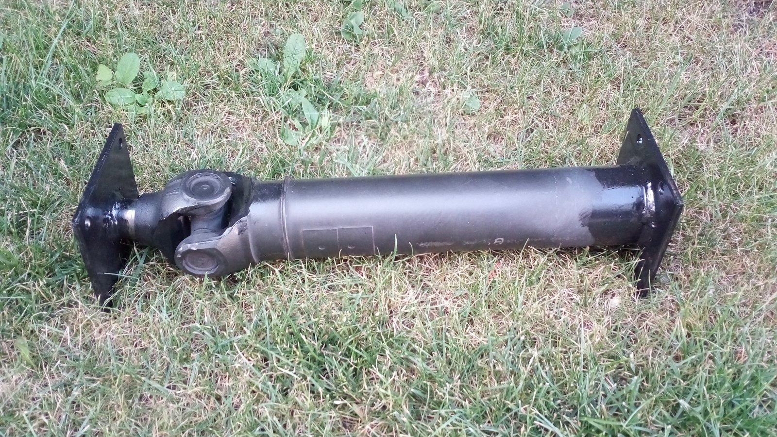

    kardan of a Mercedes SLK

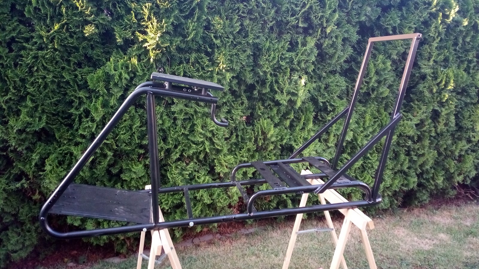

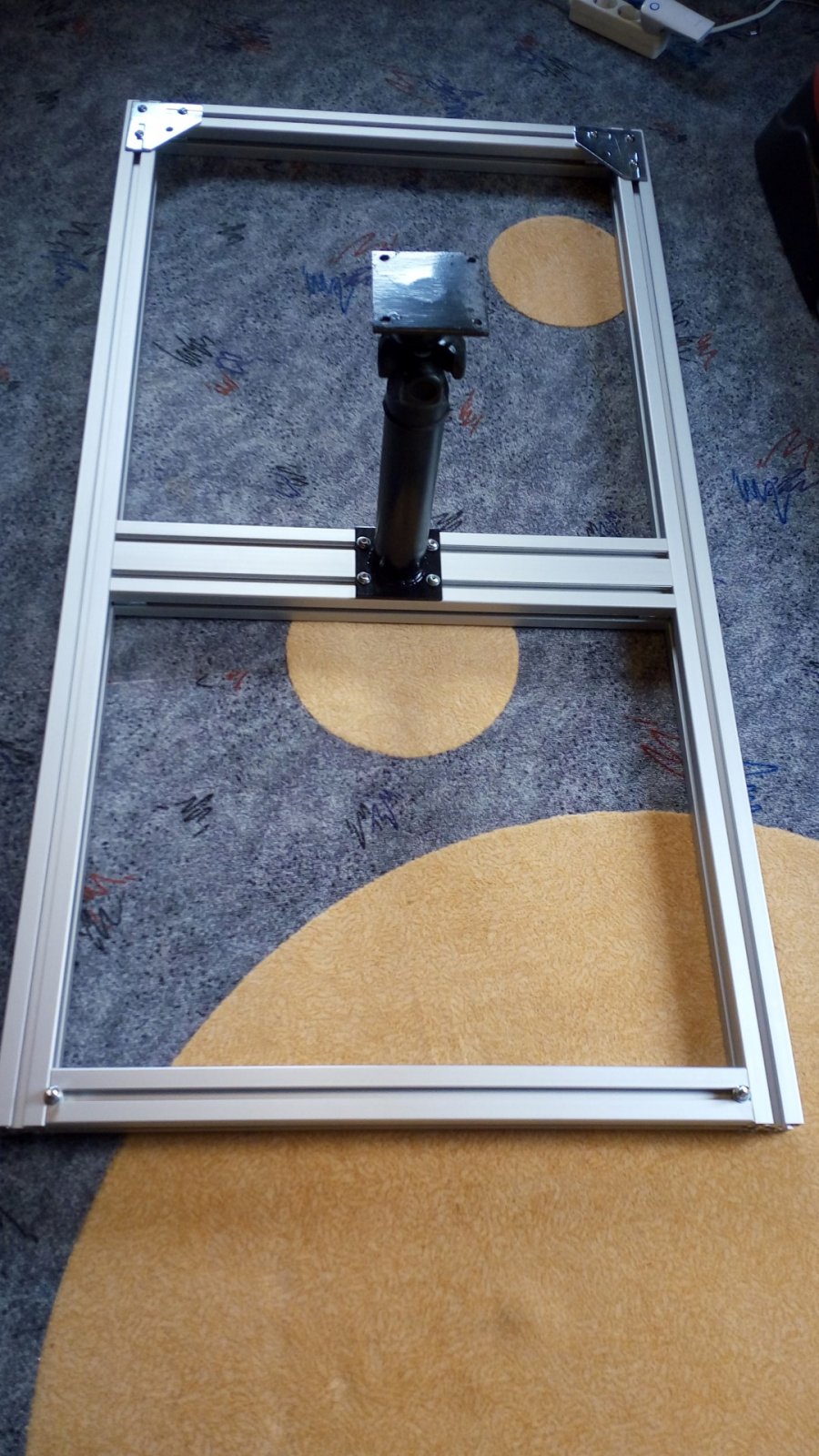

    playseat welded
    base frame

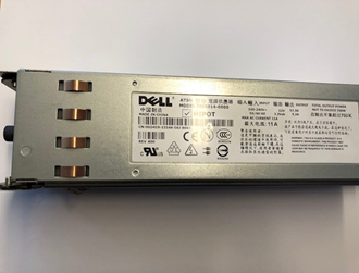

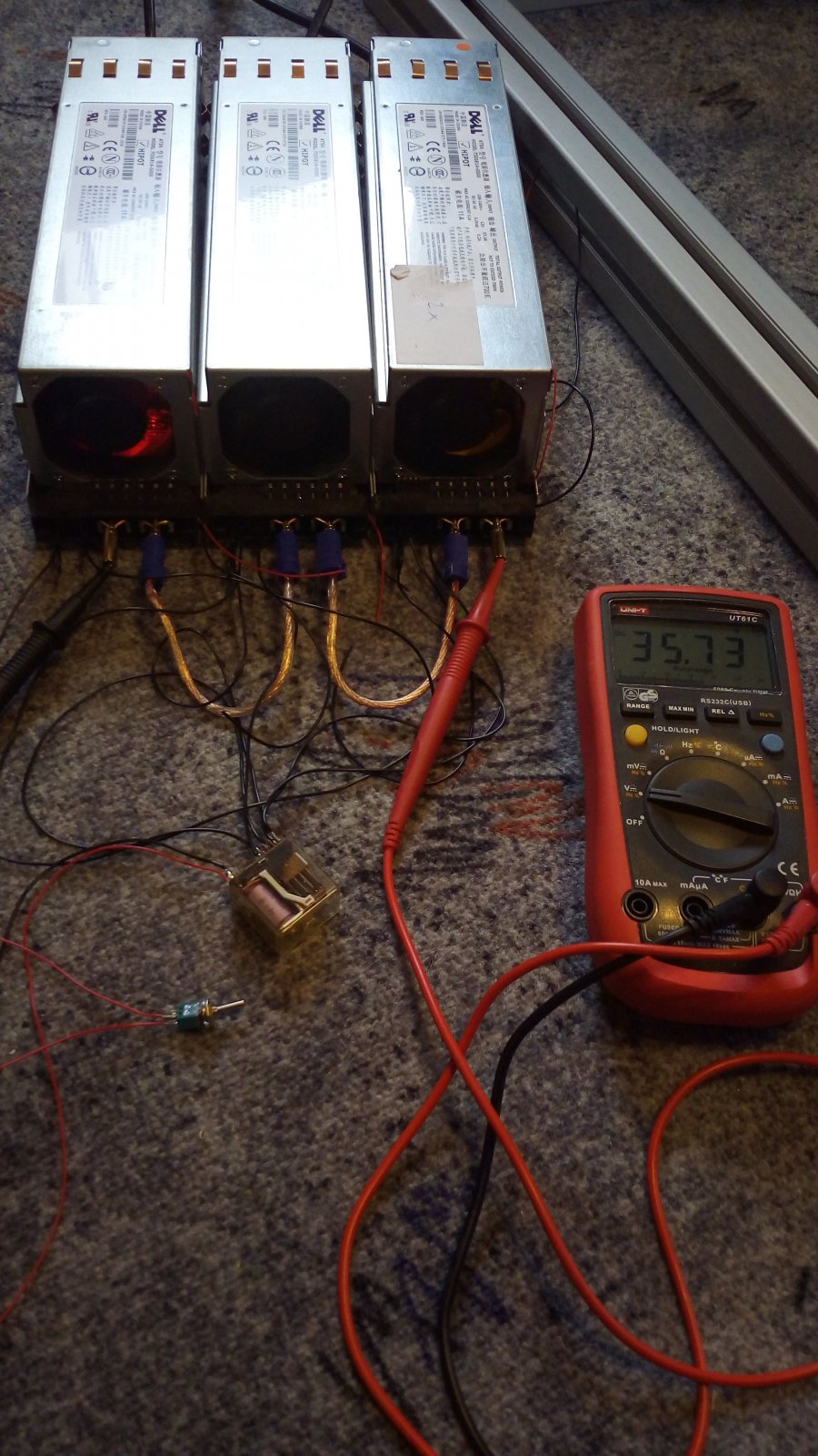

    three DELL PSUs serieal 36Volts.
    ODrive
    one actuator mounted
    First actuator tests
    Project Cars 2 ride

    i like the actuators - do you have any idea how much load they can lift ?

    unfortuntely not. But during the testing, NoLimits2 shakes my father (120kg) without getting warm.
    If your PSUs have enough power you can get 2000W out of the motor. https://hobbyking.com/de_de/kd-53-30-high-voltage-brushless-outrunner-190kv.html
    In the firmware of ODrive you can set the maximum current for each motor. I set only 35A as maximum. It's about 1200 W. It's possible to read the amount of the current out of the management interface of ODrive.
    But I didn't do that for now. Nothing gets warm and the power is more than expected.
    Greetings / Zennix

    those motors have some punch ! - what rpm and gear ratio do you run on them ?
  7. Zennix
    Zennix New Member Gold Contributor
    Mar 4, 2018
    12
    Bayern
    66Coins
    +32 / 0 / -0
    Ratio is 1:1,
    1605 ballscrew
    150mm per second = 1800 rpm

    My shopping list for one actuator:
    mechanics:
    Motor: 42,23€ https://hobbyking.com/de_de/kd-53-30-high-voltage-brushless-outrunner-190kv.html
    SFU1605 Ballscrwew 550mm: 31,86€ https://de.aliexpress.com/item/Mach...489.html?spm=a2g0s.9042311.0.0.de644c4dO7byca
    2GT Timing Belt 9mm: 10,20€ https://de.aliexpress.com/item/SUMR...129.html?spm=a2g0s.9042311.0.0.de644c4dO7byca
    40 teeth timing pulley GT2 9mm Belt, 8mm hole Motor side: 2,99€
    40 teeth timing pulley GT2 9mm Belt, 10mm hole Ballscrew side: 2,99€ https://de.aliexpress.com/item/POWG...676.html?spm=a2g0s.9042311.0.0.de644c4dO7byca
    BK12 BF12 for SFU1605 ballscrew Set: 17,89€ https://www.aliexpress.com/item/BK1...241.html?spm=a2g0s.9042311.0.0.8a304c4dnWV88a
    carbon tube 3k-LW (Ø 30 / 28) x 1000 mm: 32,30€ https://shop1.r-g.de/4DCGI/ezshop
    Alu profile 80x20: 22,-€ https://www.smt-montagetechnik.de/produkte/71.htm
    Balljoint M10: 5,93€ https://www.ebay.de/itm/M10-Gelenkkopf-Gelenklager-Kugelgelenk-Uniballgelenk-Spurstangenkopf-10mm-/371605173666?hash=item568564f5a2
    12mm Dia Shaft Coupling Motor Connector Steel Universal Joint DIY Steering Steel Universal Joint 9,15€ https://www.ebay.de/itm/DELL-700081...e=STRK:MEBIDX:IT&_trksid=p2057872.m2749.l2649
    8mm Aluminiumplate milled by myself.
    A lot of 3D printing parts made by myself.
    A Lot of Bolts and Nuts
    electronics:
    3 x DELL PSU: 3 x 19,90€ https://www.ebay.de/itm/DELL-700081...e=STRK:MEBIDX:IT&_trksid=p2057872.m2749.l2649
    Microswitches for endswitch 4,64€ https://www.ebay.de/itm/10-X-Taktsc...m=232952960228&_trksid=p2047675.c100005.m1851
    ODrive 48V motor driver: 149,-$ https://odriverobotics.com/shop/odrive-v35
    AMT102 encoder: 20,--€ https://www.mouser.de/ProductDetail/CUI/AMT102-V?qs=sGAEpiMZZMs8jstQXqv0yYb50Z4CpSMXgMm2nTUjwU4=
    STM32 Programmer for programming the firmware to ODrive: 5,45€ https://www.ebay.de/itm/ST-Link-Sch...684649?hash=item27f980aea9:g:LMMAAOSwuPZbu2h3
    A lot of cables and plugs.
    Greetings Zennix

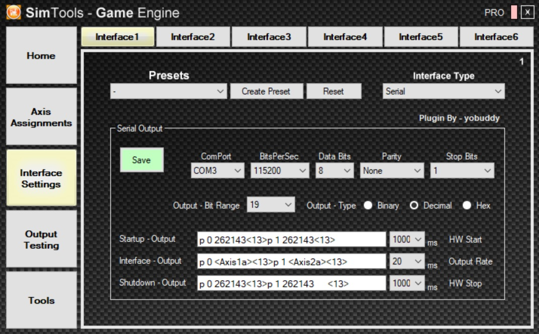

    Hi @Zennix
    can you share a picture of your Simtools interface setting for this setup
    thank you for sharing
  13. Zennix
    Mar 4, 2018
    12
    Bayern
    66Coins
    +32 / 0 / -0
    OK
