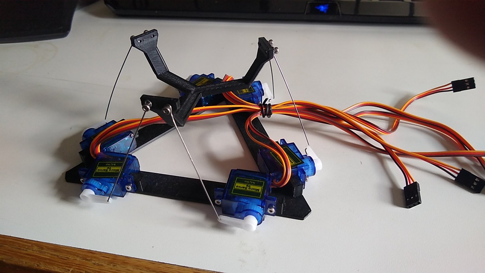

    Before I ordered anything for this, I wanted to get the software I’d need and do some early testing. I slapped together a python script for a Pi Pico to output six RC servo PWM signals. Then I sketched out and 3D printed a little 1:10 scale model platform, or at least close to scale. I didn’t take any pictures of this. After rigging up the interface, all that was left was the game-to-hardware bridge. I’ll admit I didn’t do as much research into this as I should have. Regardless, I ended up buying SimTools 3. From that point it wasn’t long before I had the model following along as I drove around in Live For Speed! The motions weren’t perfect, but it was close enough and I figured I’d dial in the mixing ratios when I can actually feel what’s happening.
    I still have the RC model on my desk, just not wired up anymore, so here’s that.

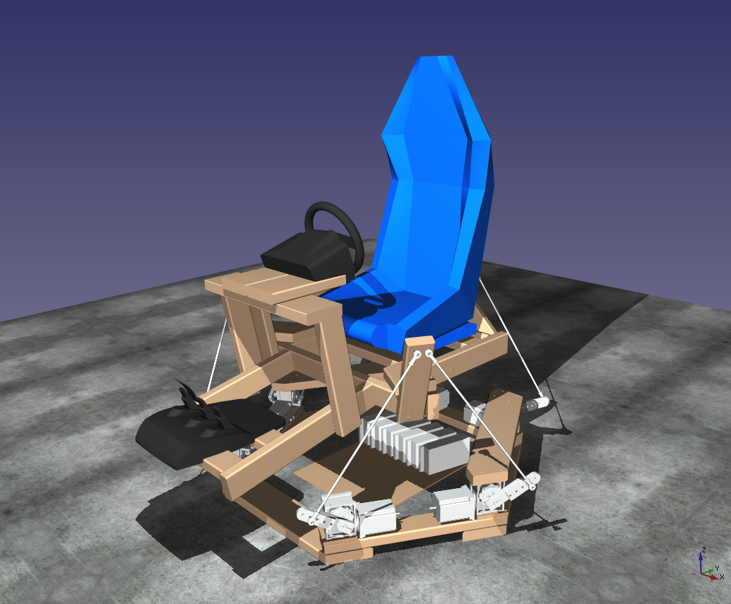

    Like any good project, this one needed a CAD model. At first I started drawing up a welded steel frame since that is my ultimate goal, however I was too eager to have a working rig so I switched to lumber for now. That will serve as a prototype or a working concept that I can use to really flesh out how I want the final design to be. Plus its way easier to make changes to if I want to add or relocate things.

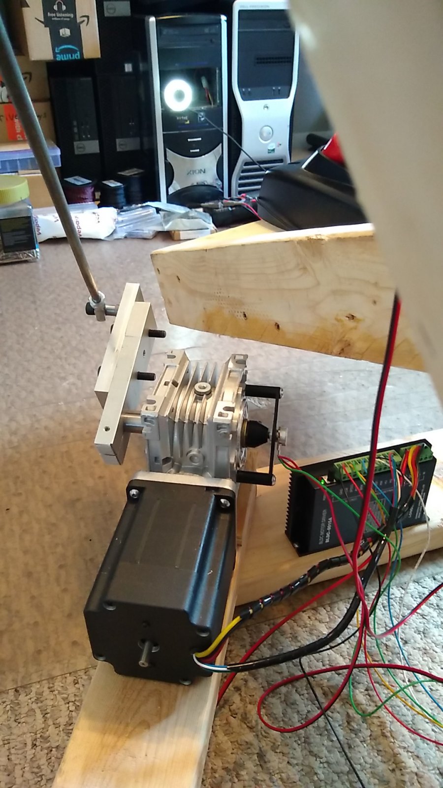

    Early on I thought I could get away with NEMA23-sized 180W 24V BLDC motors and the matching NMRV-030 40:1 gearboxes, however after buying one of each and bench testing it, I quickly realized how underpowered it would be. I could easily stall the gearbox output with a 3D printed crank arm and a board attached at the lowest 50 mm setting. By hanging the board and pressing down on a bathroom scale, it generated barely 60 lbs of force before stalling. That might sound like a lot but it felt very underwhelming, plus I really wanted to be able to use the longer crank settings and that would only further decrease the load capability.
    After weighing out a lot of other drivetrain options, I ultimately landed on a combination of NEMA34-sized 440 W BLDC motors, BLDC-8015A motor drivers, 48V 10A AC-DC power supplies, NMRV-040 50:1 worm gearboxes, and crank arms with 50 mm, 75 mm, and 100 mm radius options. This cost around $1300 and was on track to put me way over what I initially wanted to spend on this build, but once I started having parts arrive the excitement got the best of me and the budget got somewhat ignored.

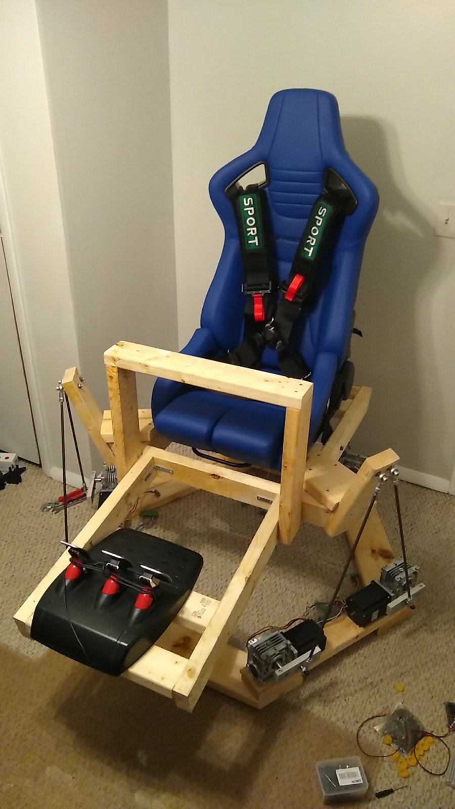

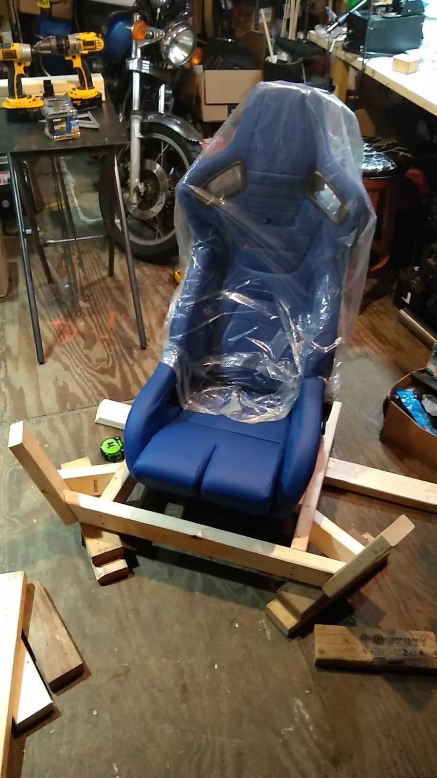

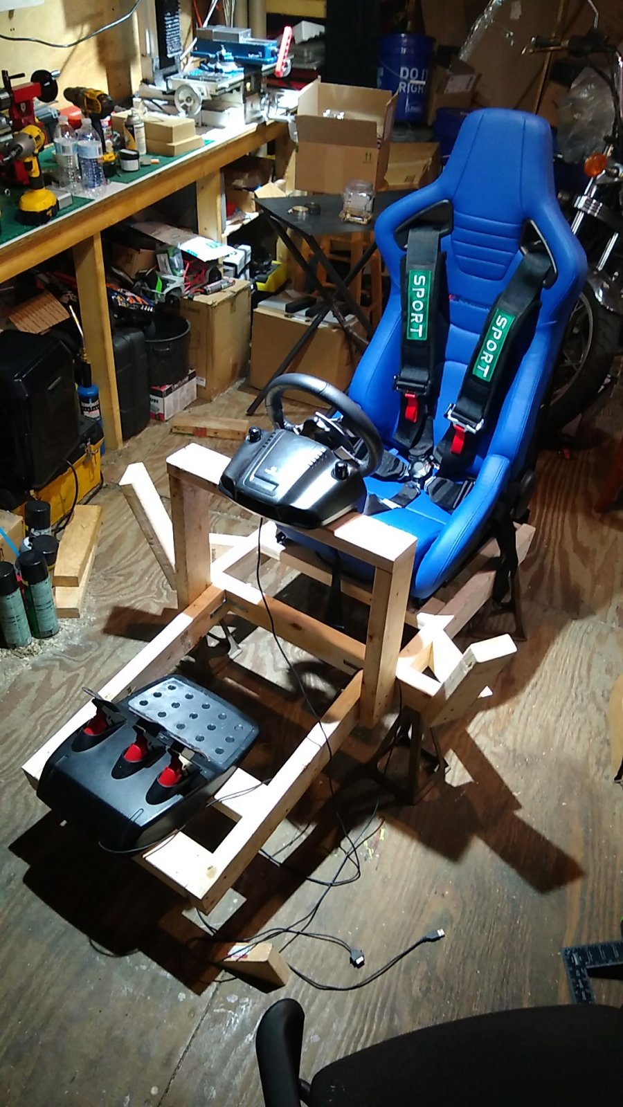

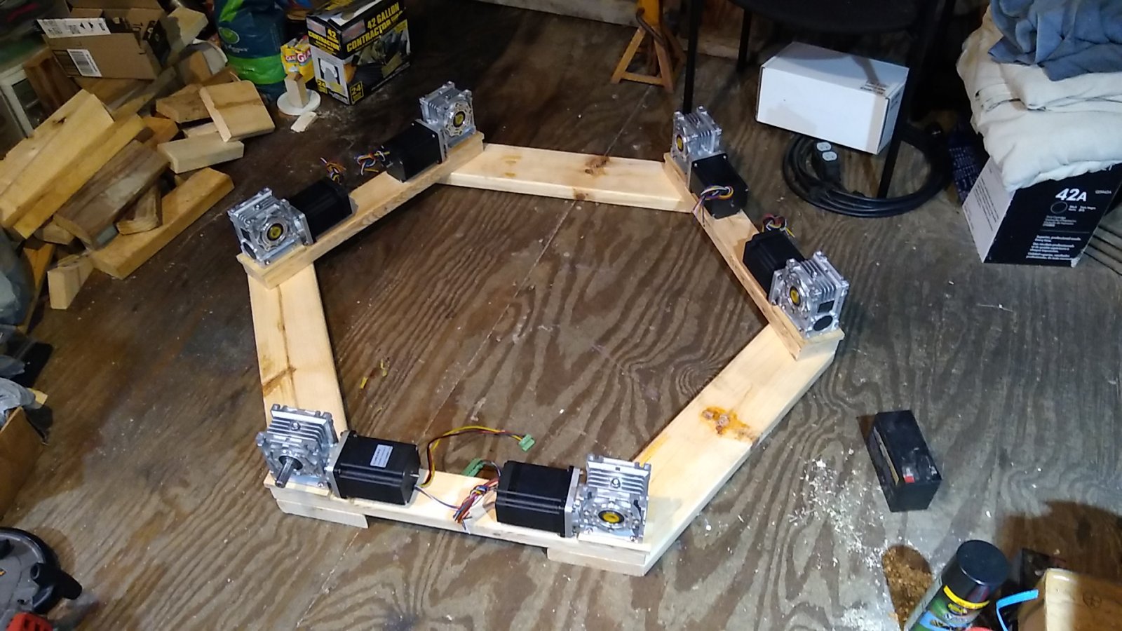

    For the initial prototype I just chopped and screwed some 2×4 and 2×6 pine lumber. It’s cheap, quick, and sturdy enough that I feel comfortable climbing on the frame. Another afterthought, if I were doing this all over, I would have used construction glue (liquid nails is a good go-to) to help secure the most stressed joints in the frame. I had to come back later and add a few gussets and reinforcements to eliminate slop in the platform frame.
    First up was what I’m calling the actual platform frame. This is the frame that the seat, wheel, pedals, and everything gets attached to and gets held up and moved around. It is made entirely from 2×4 except for a couple 2×6 reinforcements I added later.
    The CAD model really came in handy when it came to making all the angled cuts, especially for the compound angles. Once I had all my cuts done, screwing it all together only took an hour or so. I had a little snag when it came to attaching the seat. The threaded studs on the bottom needed the be chased with a tap and one of the sliding rails had chunk broken off the roller carriage that caused it to keep jamming up until we got the pieces out. I also had to order some M8 hardware that was more suitable, but I had other screws that worked for the time being.
    I only have a few pictures of this during construction and all of them were taken in my cramped and filthy shop.

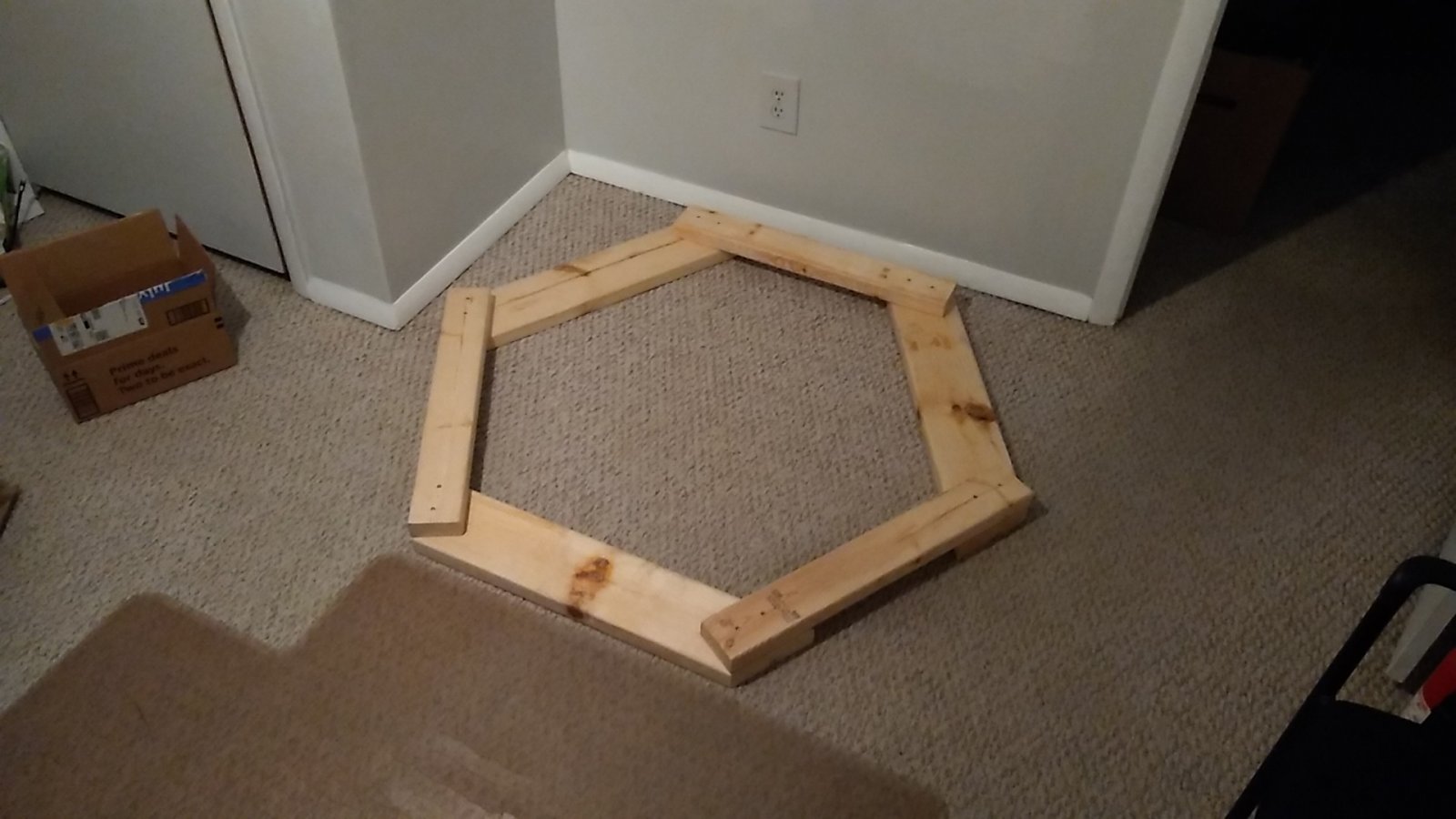

    With that done, it was time for the base frame. This is just a hexagon made of 2×4 and 2×6. I had to cut spacers from ½” plywood to lift the gearboxes. This was another late change. Originally I had designed it so the motors hung from the top of the gearboxes as is with most other rotary hexapod designs I’ve seen (including the H6). However, I took one of the oil plugs out to observe how much oil was inside the gearboxes. Out of the box they’re about ¼ full, maybe a bit less — and unless I fill it almost completely (meaning little space for air), the oil would always run down and away from the worm gear. Plus since the output shaft never makes a full rotation, the output gear could not be used to draw oil back up to the worm. Fearing premature wear of the gears, I flipped the design so the worm gears are always submerged in oil, but to do so I had to lift the gearboxes a bit for the motor to clear the frame.
    And with that, the framing was basically complete. Next up, machine the crank arms and connecting rods.

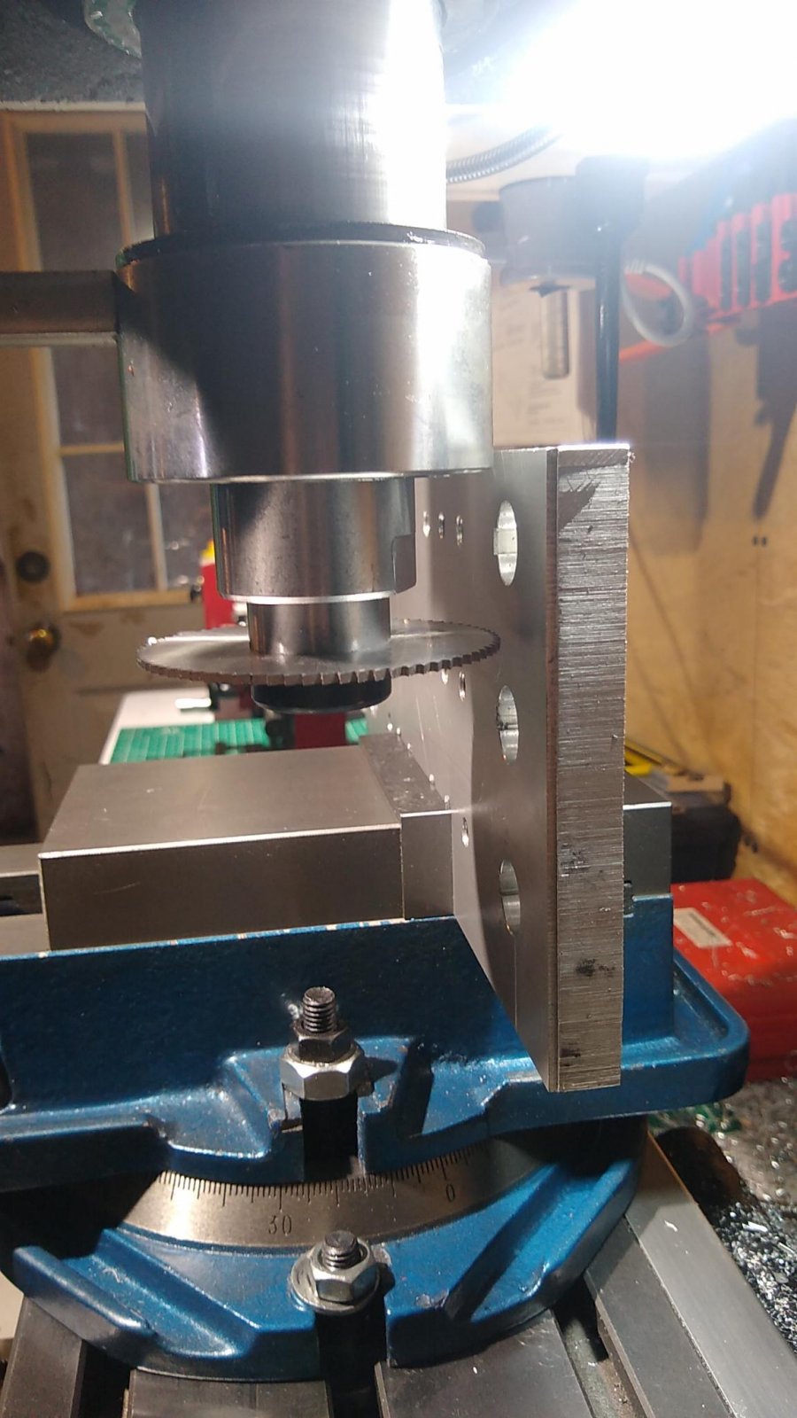

    Crank Arms
    The crank arms I made from a 5/8” thick 6061 aluminum plate that was left over from my CNC router rebuild. Each crank is 40 mm wide by 140 mm long. I clamped the whole plate down on my mill and started drilling. I figured I could drill all the holes and then saw apart each crank from the plate… that almost went to plan. I thought I could use a 2 mm slitting saw in the mill to split apart the plate, that way each side of each crank was a machined face. Unfortunately, my saw was too small and the spindle would hit the part. My only other option was to bandsaw the plate apart. I can go back later to machine the sides of the cranks, but that would be just for aesthetics. They’re functional as-is so I’m rolling with it.
    The only picture I got of the machining process was one showing just how close I was to making the slitting saw work.

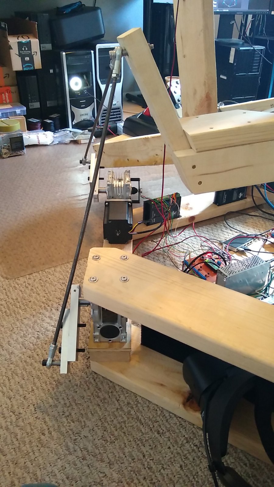

    Connecting Rods
    The connecting rods are simple — 5/16” mild steel round bar, cut to 22” length, and threaded M8-1.25x22 mm on each end. No pictures of this. Threading them was a little bit of a pain. I wanted to cut to them length and just run a thread die on the end. Well, I got a die started but couldn’t hold the darn rod. It slipped and spun in my bench vise and even in my mini-lathe’s 3 jaw chuck. In order to get the job done I had to start the threads by single point cutting them on the lathe. With the threads partially formed I was finally able to run the die on without the rod slipping.
    With those done I was able to fully assemble the motion platform to the motors! I started out on the lowest 50 mm crank throw until I knew what the motors were moving where they should.

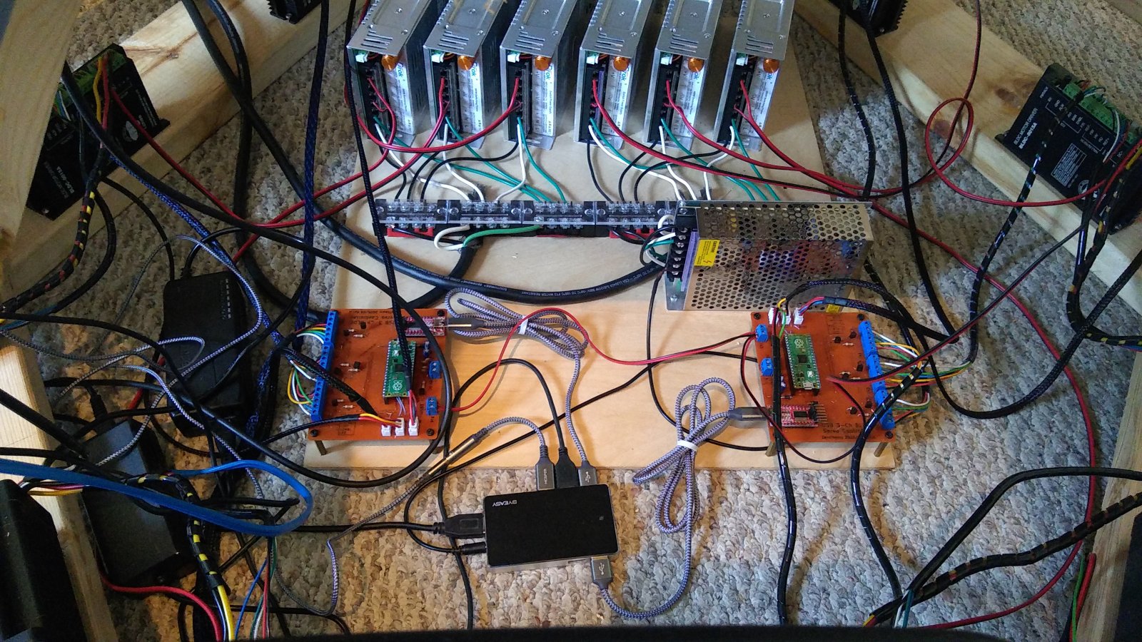

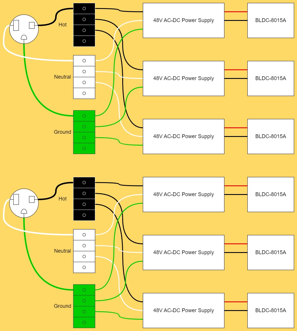

    Power Supplies
    Wiring up the power supply units (PSU’s) was pretty straightforward, but I can’t think of an easy way to describe it so here’s a diagram instead.
    I used two separate power plugs so that the rig can be powered from two separate power circuits, but for now I’m plugging them both into the same outlet. I threw in a single 5 V PSU to power a USB hub in the rig to help with cable management.
    I mounted all the PSUs in a row standing on their sides. They’re screwed to a scrap piece of 1/4” plywood that just sits on the floor under the rig. It’s not connected at all to the rest of the frame. I also screwed down the terminal strips, control boards, and the 5 V PSU to the plywood as well.

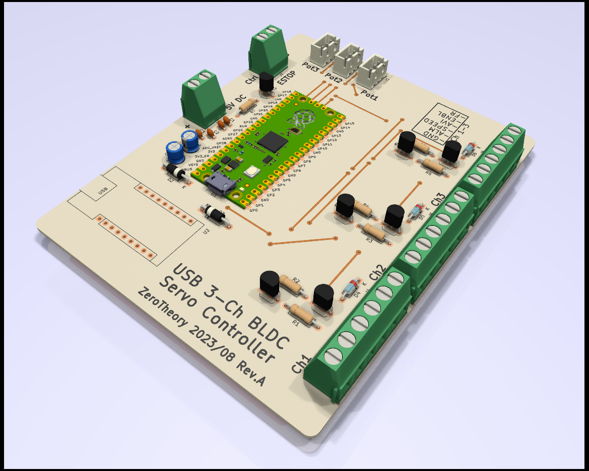

    Servo Control Board

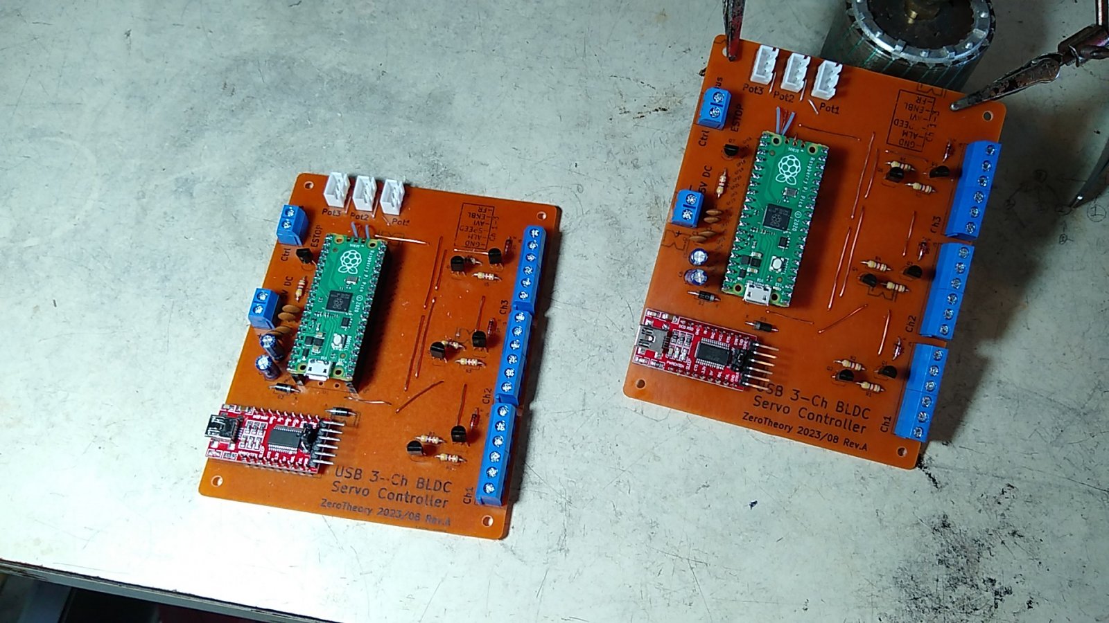

    I went fully custom for the servo control interface. I recently got a handful of Pi Pico’s and have been itching to use them for something and thought this was a great opportunity. I took a few shortcuts in making the control boards, mainly to save time because I was too excited to just get the damn thing working rather than have it made perfectly.
    Anyway, each board provides a USB-serial interface to control three BLDC drivers with potentiometer inputs to get the position of each servo. I was capped at three channels here because of the five ADC channels on the Pico only three are usable on the GPIO pins (one is internally wired to monitor input voltage and the other to the internal temp sensor). Obviously for a 6 DOF hexapod design, I had to make two of these boards — one for motors 1, 2, and 3, the second for motors 4, 5, and 6. In another attempt to “hurry up and make it work”, I used entirely through-hole components. I used my CNC router to mill and drill the boards, so making a single-sided board cuts the milling time in half.
    Each board basically contains a Pi Pico, a FT232 USB-serial module, some discrete level-shifters, an enable bus for the kill switch, a few connectors for the potentiometers, and a few filter capacitors sprinkled about for best practice. I even included an extra screw terminal for a 5 V power supply, but the USB provides more than enough power.
    The code (can a python script be called “firmware”?) running on the Pico’s is a bit, how should I put it… crude. The servo control loop takes a very naive approach to determine how fast to run the motor in whichever direction it needs to go. There’s no acceleration ramp and a very basic deceleration (if you can even call it that). Again, this was just because I wanted to hop in and start driving ASAP.
    I will be revising the code to implement a smarter motion algorithm to smooth out the movements. I am already looking to make a new control board that fixes my other complaints with these. This post is already way longer than I expected, so I’ll post more info later if anyone is interested.

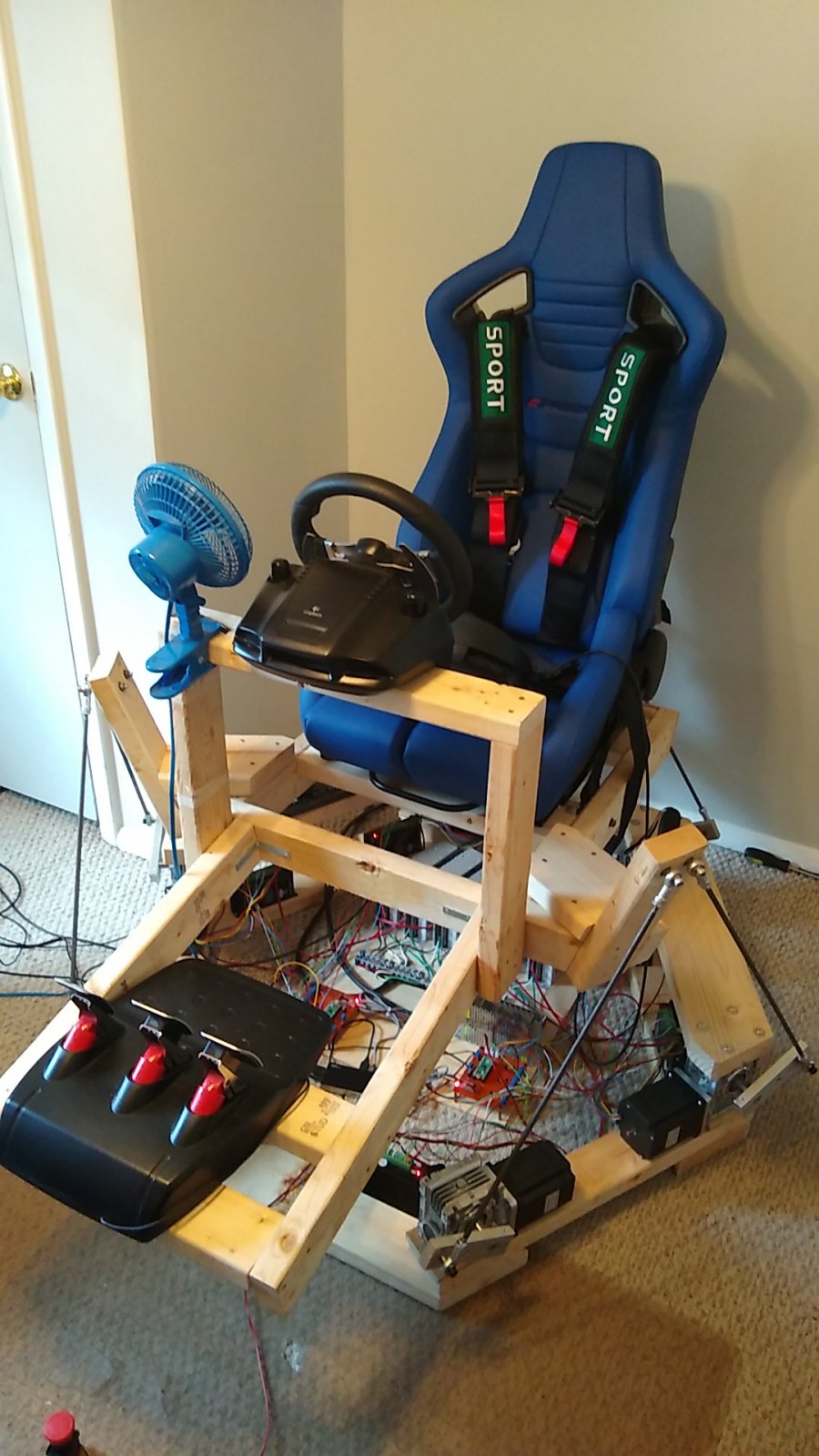

    First Ride
    My best friend has helped through this entire build. The grins on our faces when we took it for a spin! Well, you couldn’t really see our face because of the VR headset, but oh man! There were plenty of times when the rig would reach a maximum and stop moving, but when it wasn’t it was a blast. That’s not to say there wasn’t any tuning to be done, because it definitely needed it. I had almost no idea what I was doing with the axis assignments settings, but eventually I got it feeling alright. It wasn’t but the next day when we moved the connecting rods out to the full 100 mm radius crank arm setting. To my surprise, the motors handled it like champs! I was worried the extra torque would stall them, but nope! I even made extension blocks to add 125 mm and 150 mm mounting options to the crank arms. The 125 mm is where it is now and it’s still performing just fine. I’m not ready to try 150 mm yet because if anything fails the crank arms could potentially drive down hitting the floor. I’d have to raise the frame or be completely sure that the control boards and potentiometers won’t fail and cause a crash.
    As an unintended bonus, the PSU’s I got are adjustable from 0–48 V and I’ve mostly been running them at 30 V. I did recently crank it up to 48 V because one motor was always running hotter than the others. I figured higher voltage means less current for the same power, so maybe it’ll help it run cooler. I haven’t had any long sessions yet, so I’ll check it when I do.
    The picture below is the closest I have to how it looked on the first test drive. The only difference is that on the first drive the cranks were pointing inward instead of outward and the connecting rods were on the smaller 50 mm crank setting. The bystander had control of the emergency stop switch (that’s on the floor and barely in-frame) if anything went awry. The desk fan is always on because it gets hot in the VR headset after a few minutes.
    I’ve done a little bit of cable management since then, but it’s still quite messy. As long as nothing is about to snag or get ripped off, I’m just leaving it since I plan on replacing the control boards anyway. It’ll get rewired then.

    Rod End Articulation
    I underestimated how much travel range this rig would be capable of. Using the SimTools movement test I positioned the rig so that was lifted and rolled (or something like that) so that I could more easily reach under the rig to work on something. In doing so, I noticed one of the connecting rods was angled further than the rod end balljoint can articulate which results in the rod itself bending. This wasn’t the first time that one of the rods had bent (I’ve got a short story about another incident), but it was the first time it was due to the bearing reaching its limit. The other bending instances were due to the crank pointing downward and the rod crashing into the crank itself.
