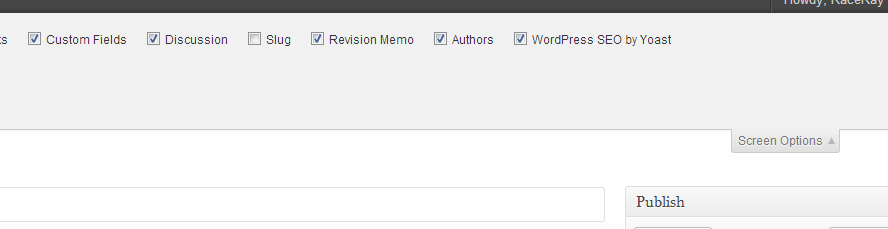

If not already done, activate the Custom fields on the Screen Options menue at the upper right corner of your post:
Add New Post ‹ XSimulator — WordPress

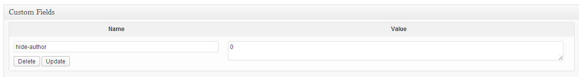

Than create any field and value, e.g.:
Value: 0
You can call the name as you want it. We define it in the template next.
custom fields in WordPress
