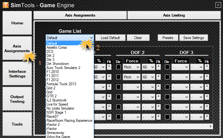

b) Setting up the „Default“ axis assignments
First, we must define the „Default“ settings that we want SimTools to use, later you can customize this.
  • Right-click on the GameEngine tray icon
  • Click on the Axis Assignments button
  • Under Game List drop-down (Axis Assignment 1) select Default
Select Default Axis - Game Engine

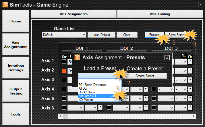

  • Click on the Axis Assignments second tab
  • Select a preset from the Presets drop-down list for your simulator
Selecting a Preset
The tab automatically switches back to Axis Assignments Tab 1
  • Select Default from the Game List and click on Save Settings
This is a first very basic setup showing just the roll and pitch from the game.
