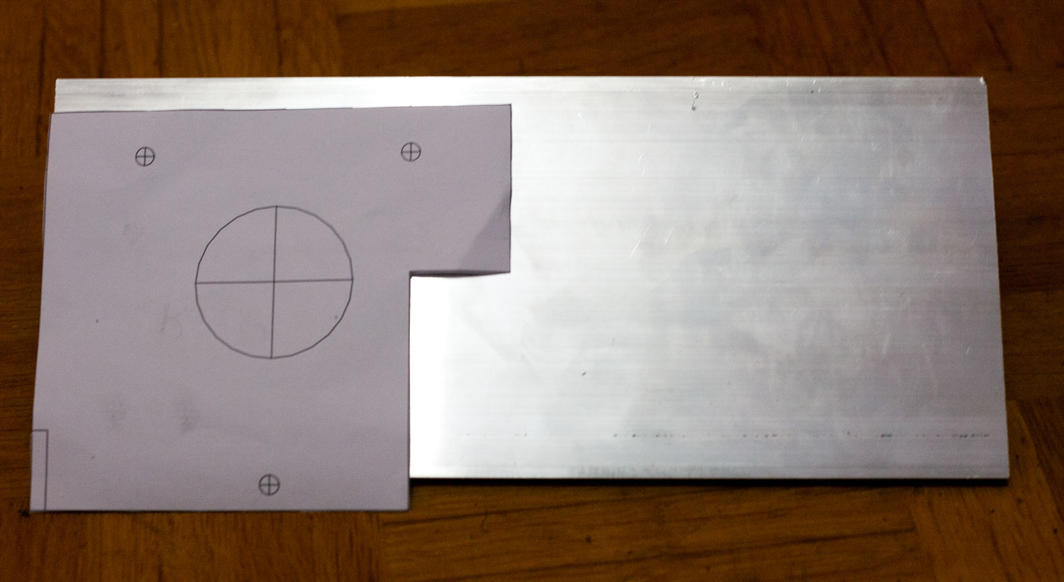

    no Problem. I don't know if you are fammilar how to export a 2d image with proportions out of Sketchup.
    I'll explain it short:
    1. Go to Camera -> Parallel Projection
    2. Got to Camera -> Standart Views -> Left or right(depends on which motorholder you use)
    3. Click on Zoom extends.
    Now you go to print and deselect "Fit to Page" and "Use model extends" and look that the numbers in "In the printout" and "In sketchup" are the same. Now you print it and get a 2d print like this.
    I made for each part a seperate layer so you can hide the others easyly.
    The design is for a aluminium profil with 130x80x6mm.
    The profile arrived to me today. I hope i have enough time tomorrow to build the 2 holders. I'll post Pictures of the finished Holders.

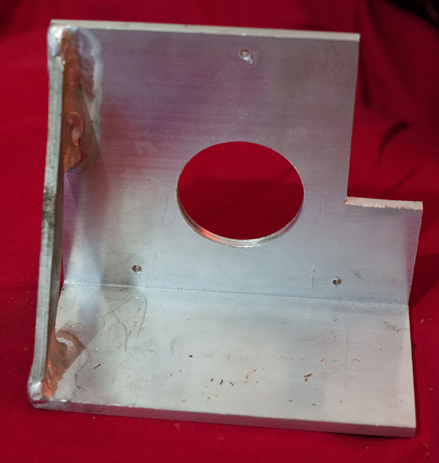

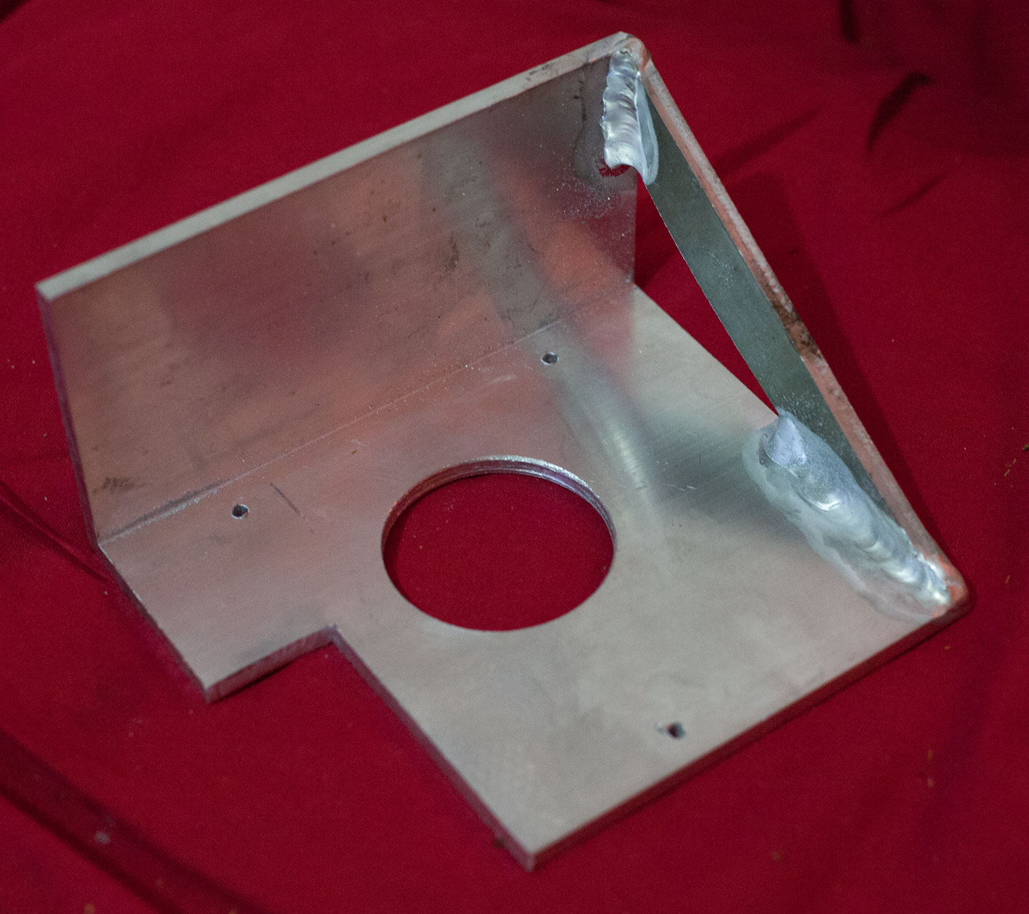

    Here is some process from my holders. I must clean up the little edge and drill bigger holes for screw mounting. At the end i paint all this in black like the motors.
    Sorry for the bad image quality I'll make better ones when the holders are finished.

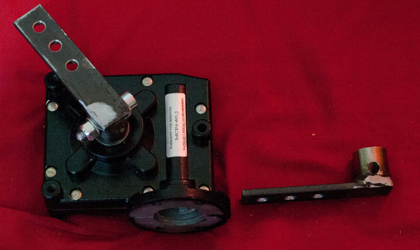

    I also made some process with my lever arms. I must fix out one problem. The tube is a regular 25 mm steel tube, with 20mm inner diameter, so not fitting 100% The M8 screw threw the hole is also not fitting 100%. So the construction is a little bit instable at the moment. I must think about it for good solution that i can make with my tools here.
    Thanks for noorbeast for the idea of the flexible mounting points They are in 40/60/80 mm
    maybe a litte screw like this [​IMG] and a second hole just a little bit into the shaft to give more stability?

    Maybe a shim or packer to make it a nice tight fit then a grub screw like you have pictured to help lock it all in place.

    i tried do meassure the distane today. The tube is about 0.3mm wider than the shaft.
    I don't know how a shim would be fitting there. And i can't find out what a packer is.
    Thanks for telling me how the screw in the picture is named in english.

    thin sheet metal wrapped on the shaft perhaps would fill the gap

    I would suggest Ali from a soda can normally about 0.25-0.4mm thick.

    As guys are saying , You need to Crush/wrap/squish Something in there to fill that void.

    Thanks for your helpful posts. I think i thought a little bit to complex :D
    Will try the alu can method.

    Thanks, i used a bit of mountain dew alu can and wraped it around the shaft one time. It's now very thight and fits like a charm.

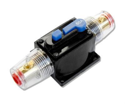

    Also what did you think about those auotmatik fuse switches like this?
    http://www.ebay.de/itm/60A-Automati...71398125?pt=Kabel_Stecker&hash=item462b2297ed
    I think about getting one for each Monstermoto

    For the fuse switch i find some reviews where people not recommend using it. I'll take this one instead. I'll install a 45-50A fuse.
    http://www.ebay.de/itm/400846999738

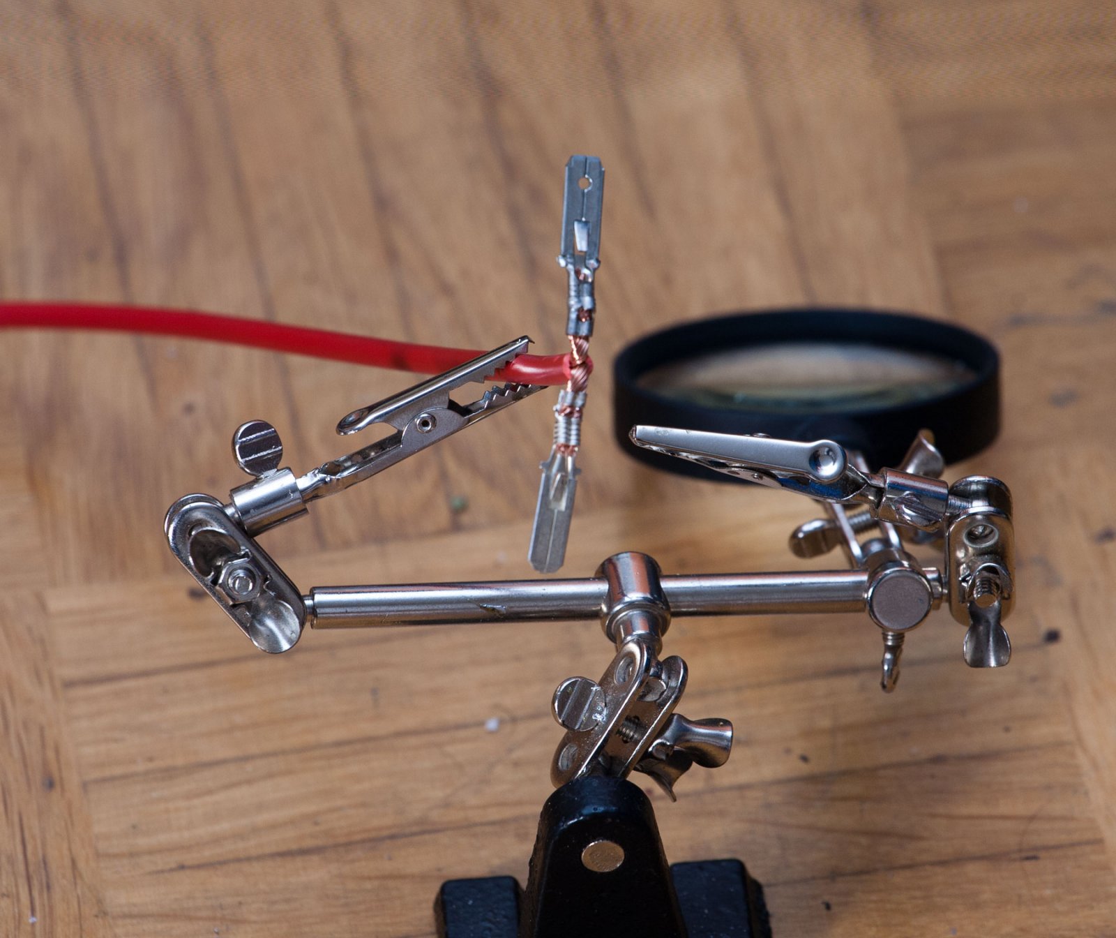

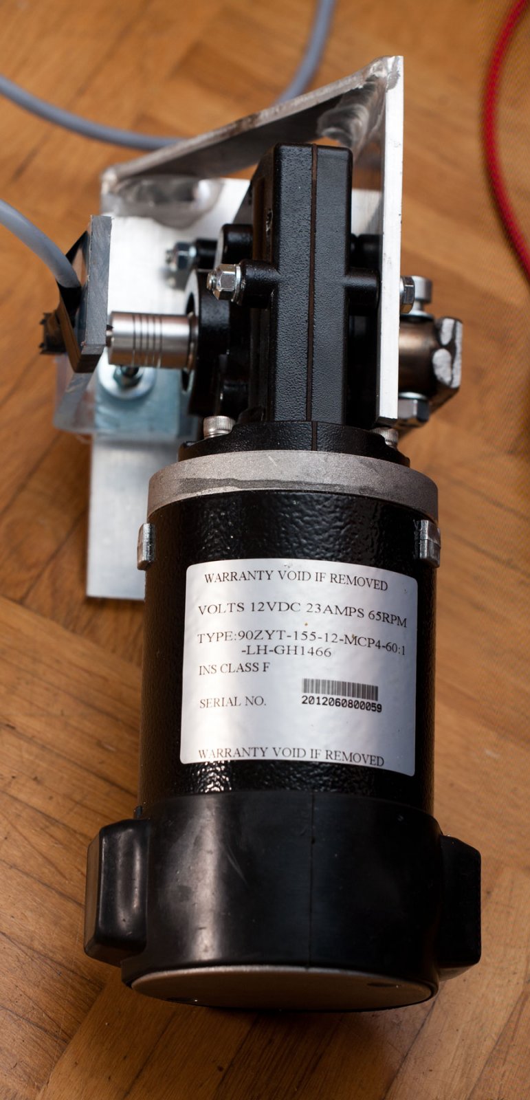

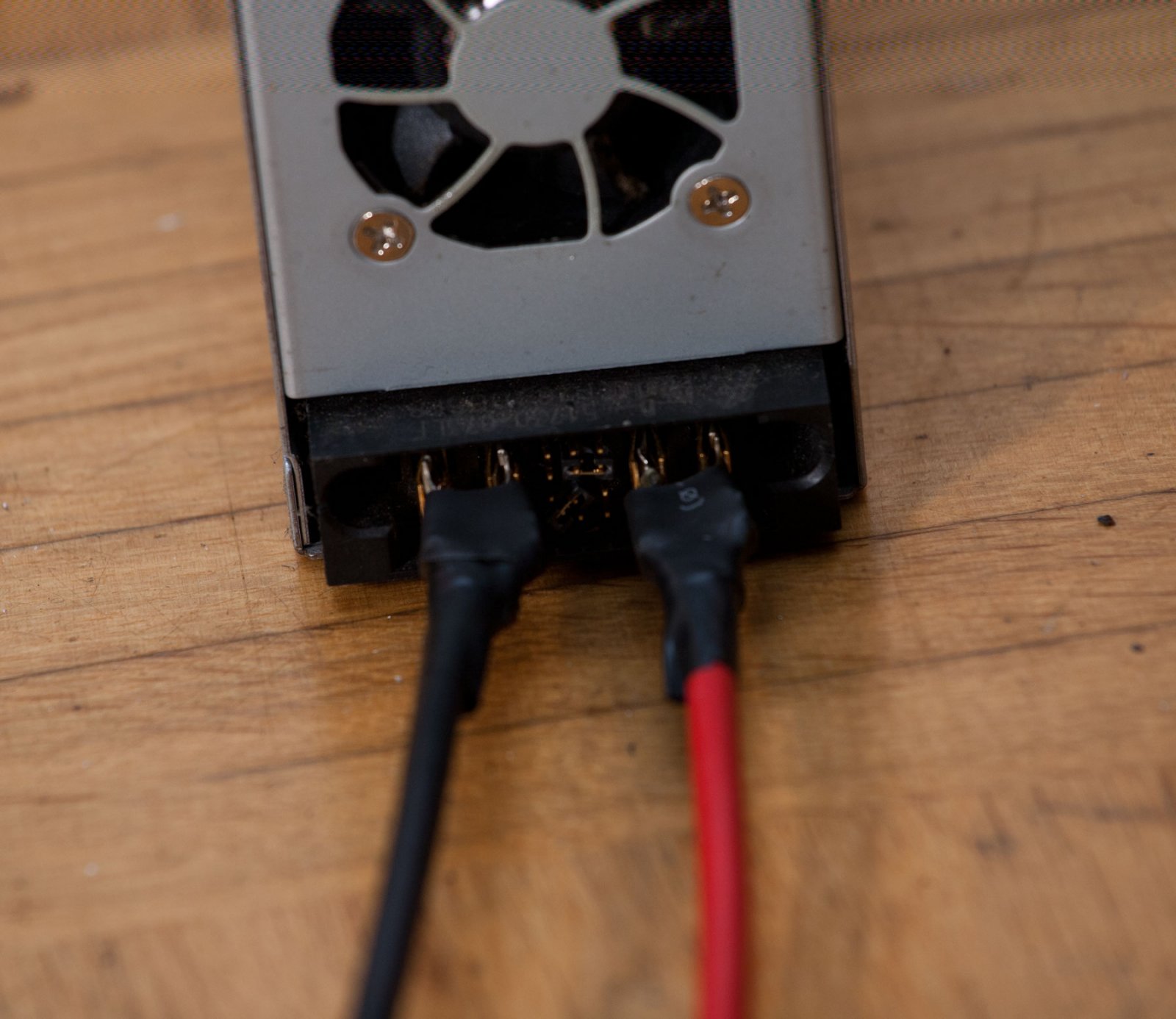

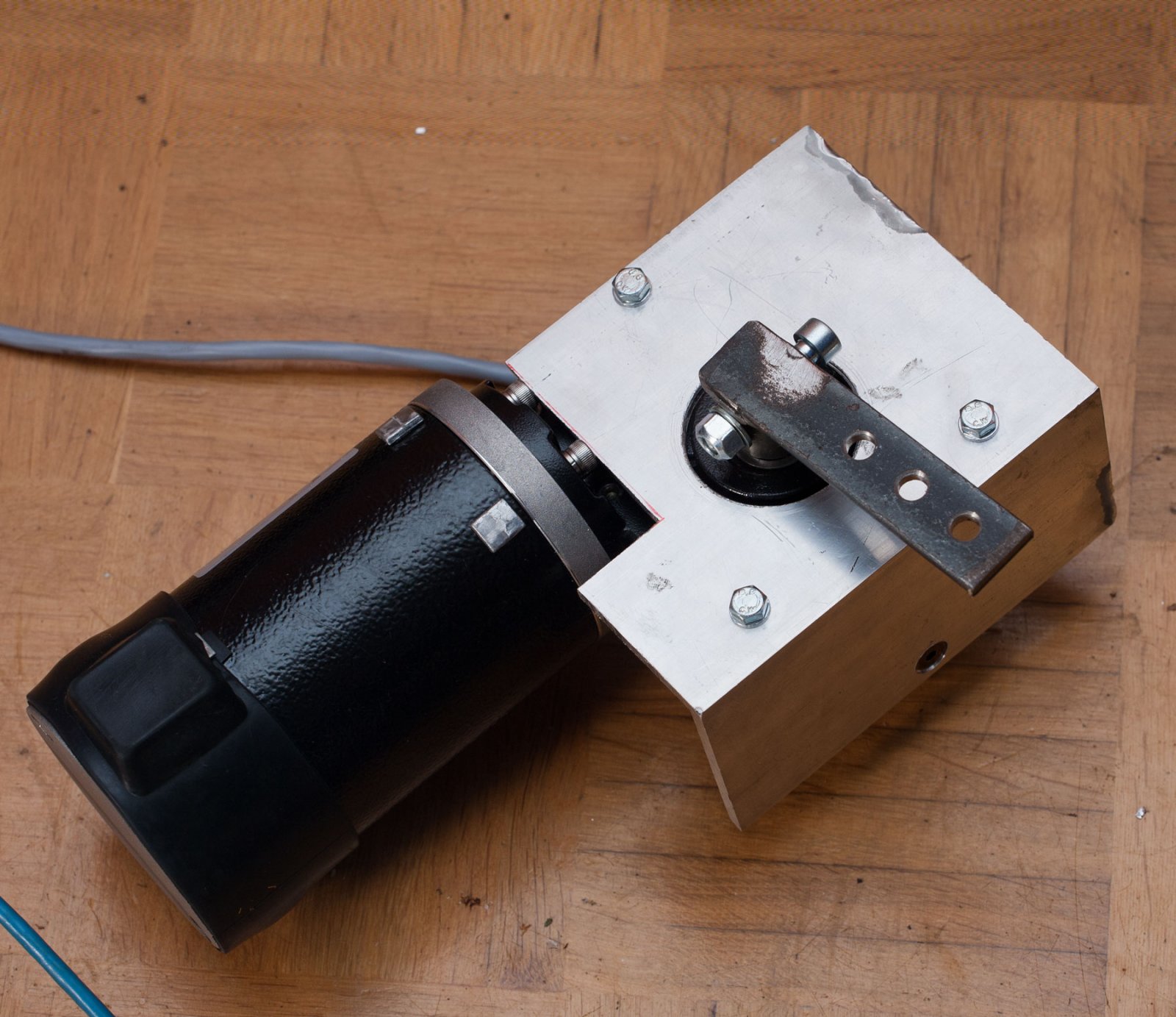

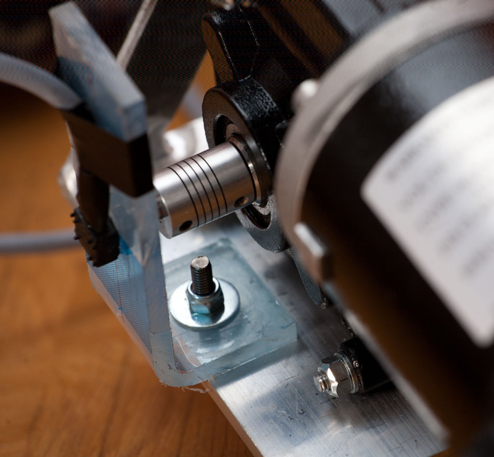

    So in the last days I realized my pot holders and motor Cables.
    Motor and Pot holders are not finished now.
    The pot holders are made out of a piece acrylic glas i had laying around. I bend this 90° with a headgun.
    My Motorcables are 6mm² cables at one and there is a 9,5mm cable shoe to connect to the motors, at the other end there is a 6,3mm cable shoe to connect with other electronics.
    In the middle there is a ec5 connector from modelcraft ratet for 120A continous current
    http://www.ebay.de/itm/151186271533?_trksid=p2059210.m2749.l2649&ssPageName=STRK:MEBIDX:IT

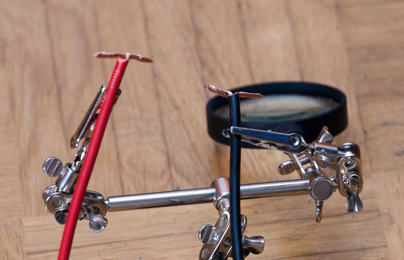

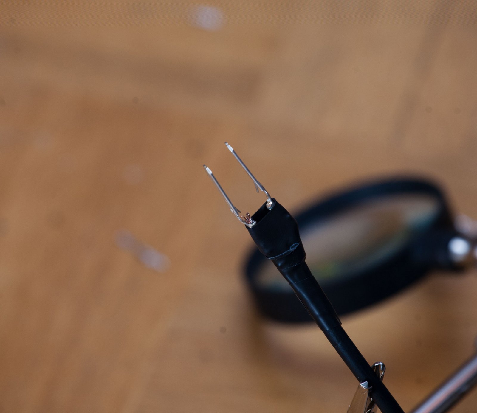

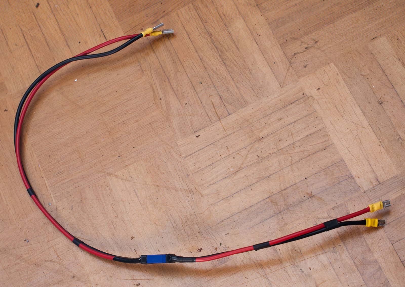

    For the connection to my Hp dsp 600 PB i made some cables too.

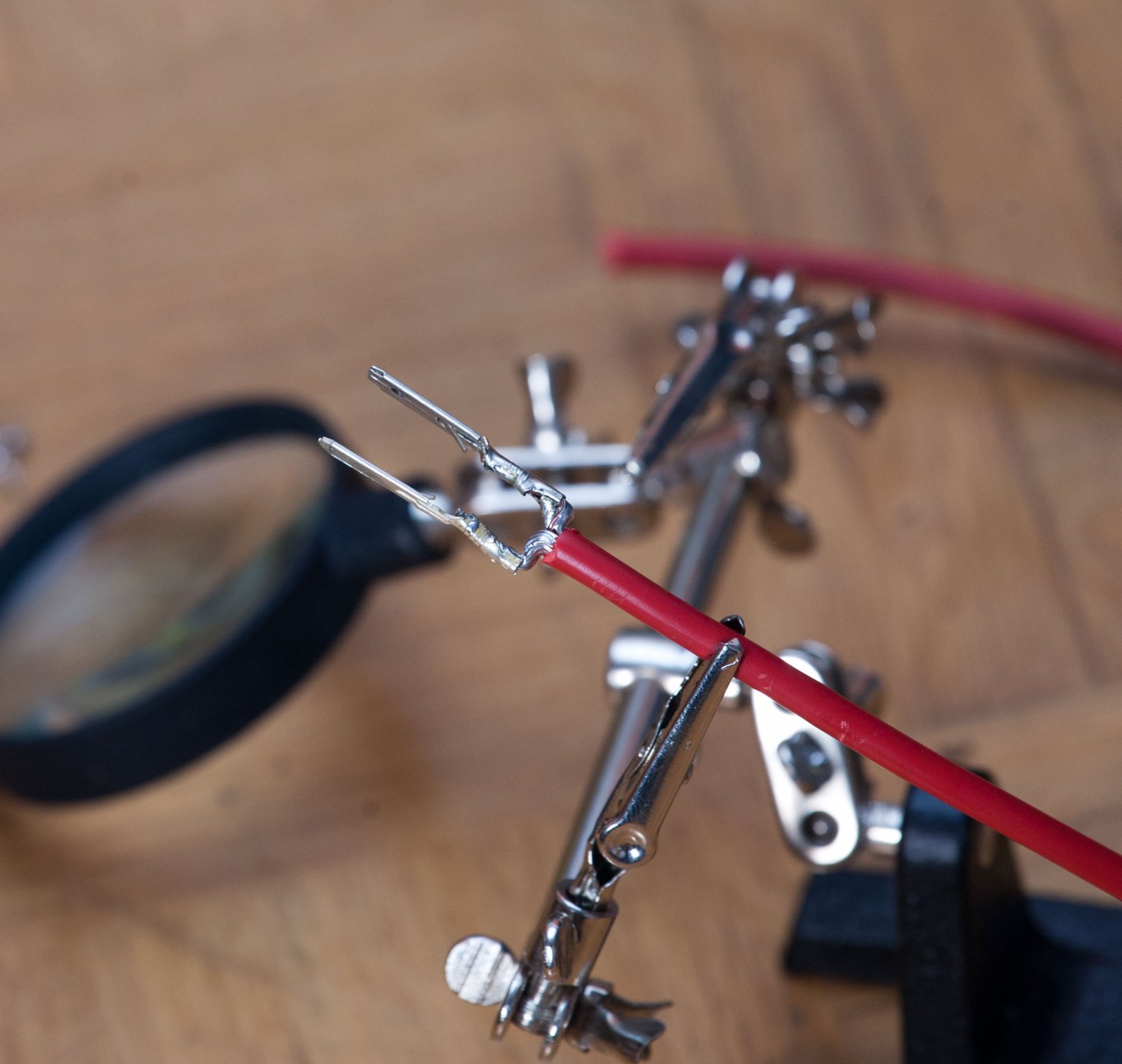

    They are made out of 6mm² cable too and have 2 male cable shoes at the end, bended to fit in the psu
    First i have stripped the wire and divide it in the middle I bended the two ends to the side and drilled them.
    Now i crimped two female cableshoes onto the two ends I don't know exact size, i had them layin around.
    The two ends where bended to fit into the psu. I tinned them with some solder to give them more stability. After that I isolatet them with some shrinktupe and isolationtape.

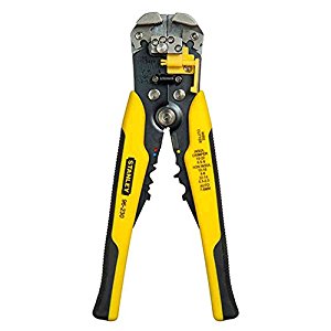

    Maybe interesting for someone. I bought a new tool for cable stripping. I'm very happy with it and it works properbly for all cables. I tried from 6mm² till 0,14mm² and the result is always perfect. You can although strip multiple wires at once.
    I've you don't have one, buy this! :)
    Here a little video

    Interesting way of using the Dual tabs to click into the PSU, I would however caution to Ensure your Wiring Cannot move or be unplugged for any reason. I would rather see a Soldered joint Vs a Plug of sorts. Also why the need for the Blue 3.5mm ec5 bullets AND the Tabs ?
