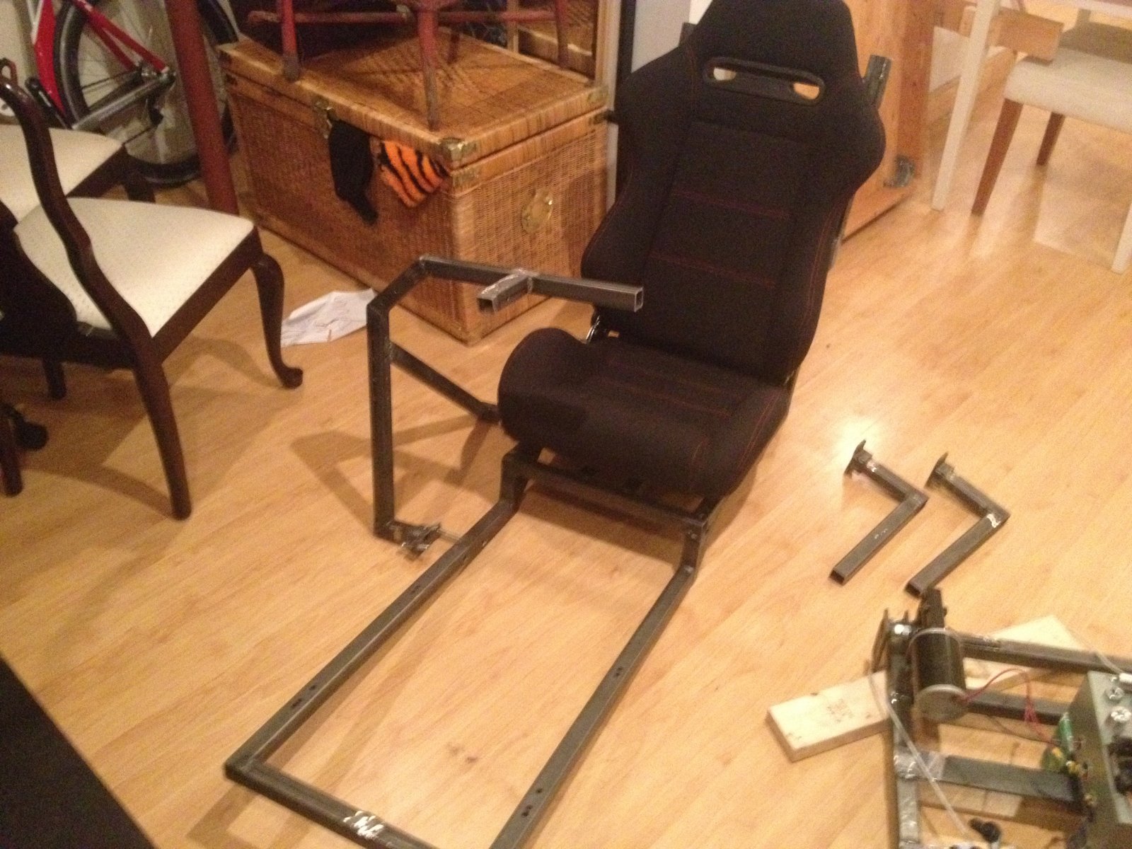

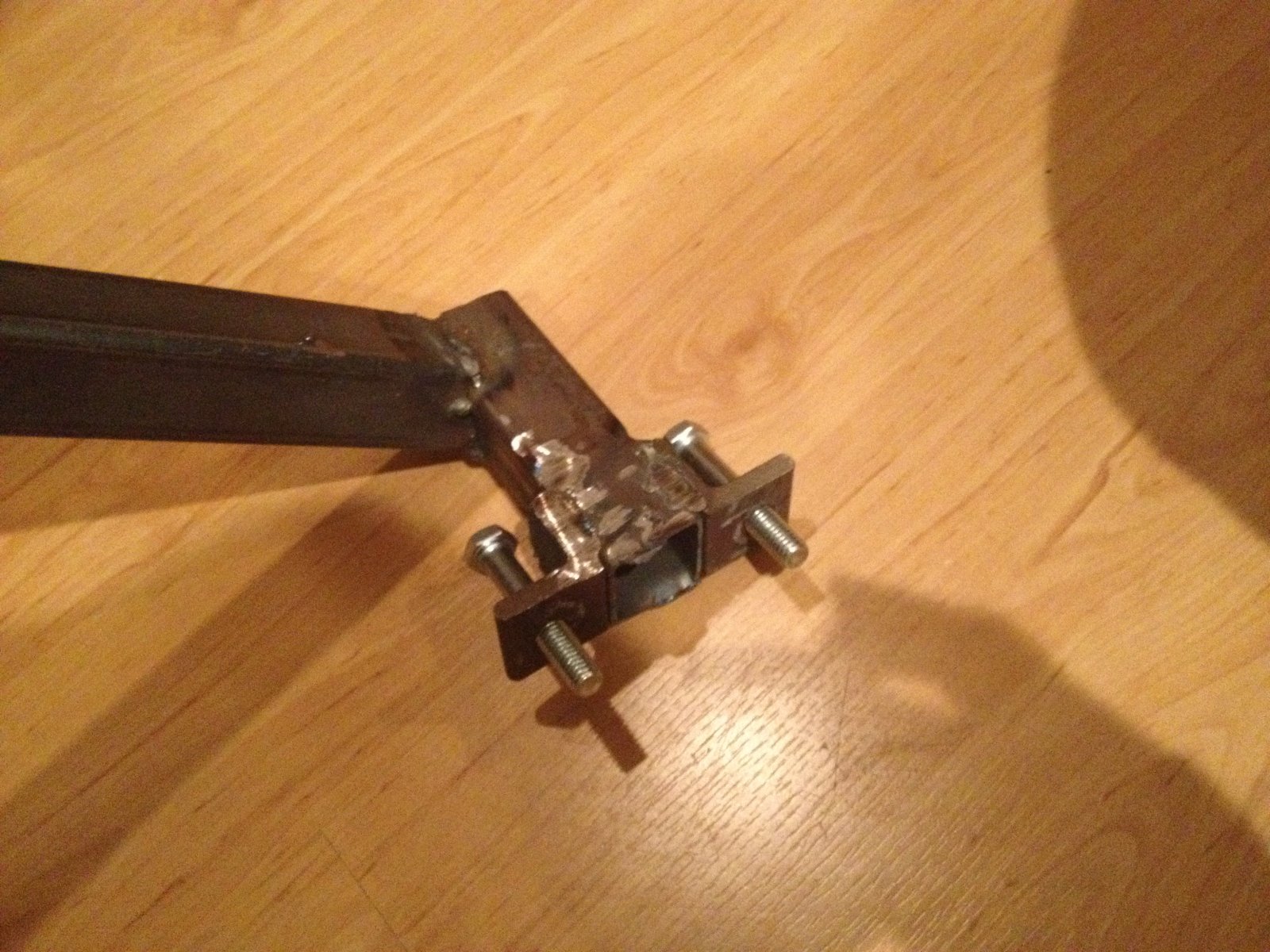

    Made some changes today! My HTC Vive arrived last week so I've been getting my setup prepped for VR. I added bolt flanges to the wheel mount so it can be taken off. I also made two mounting posts for the HOTAS that I purchased, and bought a few castor wheels so that I can easily move my sim in and out of the VR area.

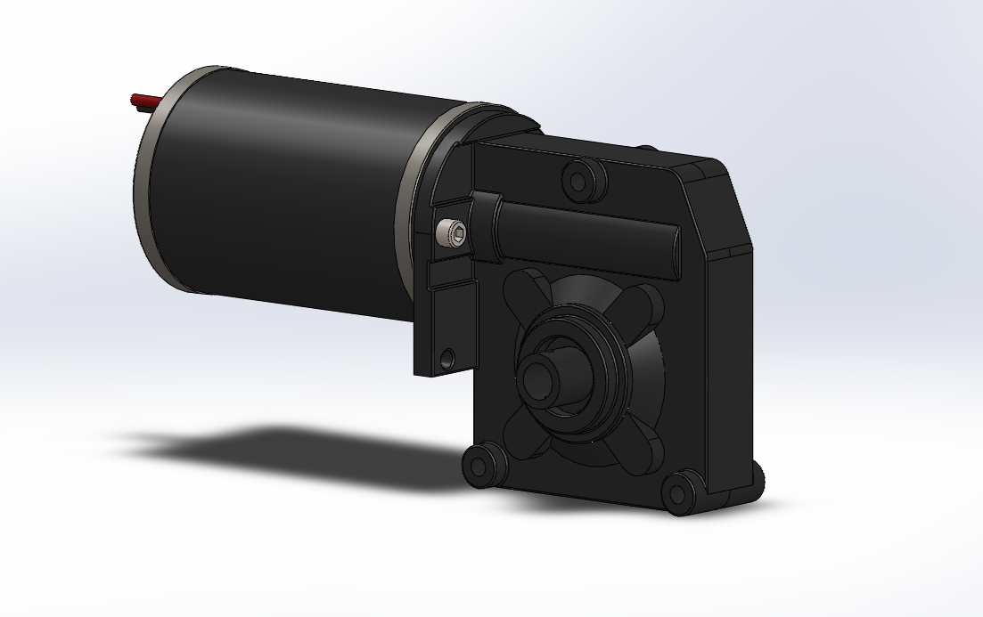

    On another note, would anyone be interested in me uploading a 3D model of the ebay pgsaw gearmotors? I'm designing a new base platform for my sim and had to whip up a quick and dirty sketch of them for measurement purposes. Might be useful for new guys modeling their builds.
    21,282
    149,361Coins
    +10,941 / 54 / -2
    The 3D model would be a brilliant contribution!

    Here's the model. I've got it saved as solidworks files as well as a .STEP file, so anyone should be able to open them. Do you guys know where this would be best uploaded elsewhere on the forum?

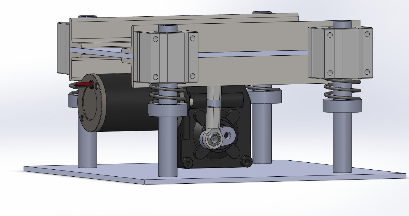

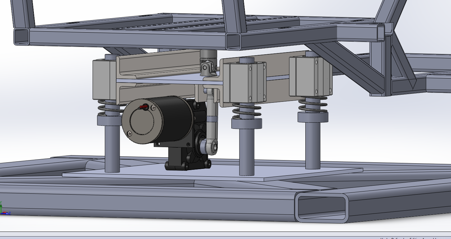

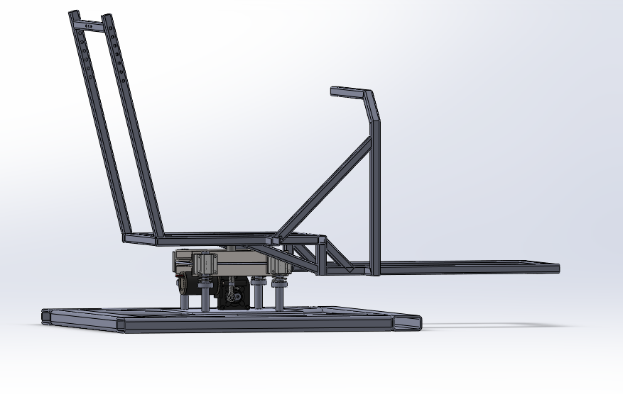

    Alright, well the idea has been gnawing at my brain for a while now, and I think I want to add a third axis to my sim.
    I'm re-modelling the base plate of the sim to be more portable and a bit heavier (it's jumping around a bit without extra weights put on it as it stands now). I'm going to opt to add heave instead of traction loss like most people would for a couple of reasons. Traction loss usually adds a fair amount of footprint to the sim, and I'm already space limited. Secondly, I use the sim for flight as well, and I want to have an axis that's usable in both flight and racing. Not to say that I won't add a yaw/traction axis eventually, just that it won't be my next addition.
    With that out of the way, here's a rough sketch of what I'm thinking:
    I want to build a module that I can just swap with the current U joint I have sitting under my platform right now. The motion would come from a 50:1 gearmotor with a very short CTC mounted under the plate. The motor would be assisted by four springs which would ideally hold the sim at half heave height when a person sits in it (I'm likely going to have to add some sort of pre-loading mechanism to the springs to account for differences in driver weight, most likely an adjustable bolt threaded to the outside of the rod that the spring goes around). I still have to do most of my calculations for lever length/spring rate, but everything I have so far seems feasible. The top platform would likely weigh about 300-350lbs (125-150kg) worst case, so I probably won't have a ton of travel total if I'm using the standard pgsaw motors, but since I primarily use the sim with VR I don't actually want large axis movements.
    The whole top platform would slide up and down on 4 linear bearing blocks (http://www.aliexpress.com/item/2pcs..._6&btsid=9a3f2d79-86f1-4382-9b8d-a1927f3ea5e1), bolted on to the plate with angle stock. I'm not sure what the exact size of the bearings will need to be, that's one thing I still have to figure out. I'd have to add hard stops to either end of the bearing rods to stop the platform from travelling too far in either direction.
    Anyways, suggestions and critiques are welcome! If anyone else with a heave axis could let me know how much travel they have on their sim I'd appreciate it, as it'd make some of the guesswork in calculating things a bit easier.

    I think assisted heave is wise, as is adjustablity for different users, I have found that very handy for heave on my rig.
    Have you done any calculation regarding the capacity of a single 50:1 motor? As a starting point a 3600rpm/50:1 with 40mm CTC at 72 rpm gives a linear velocity of 0.3015936 m/s with 1000 Newtons: http://www.xsimulator.net/community/faq/calculating-basic-linear-speed-and-forces.89/
    I run 50mm CTC on my heave 50:1, but it is a different design with more inherent leverage.

    I've got some rough calculations down:
    Assuming the motor outputs around 180W of power to the shaft at 75rpm, that means it should be generating about 23.74Nm (210lb-in) of torque (T = P/RPM) running at full speed.
    If I end up using a 30mm CTC that gives me 235.6mm/s of movement at 791N (177lbs) of lifting force in either direction.
    Now, I don't want the motor to be doing any static lifting, ideally the springs should be taking care of that. Optimally, the springs should be exactly halfway compressed when a driver is sitting in the sim. I also want to be using as long of a spring as I can fit under the mechanism. This reasoning behind this is somewhat tricky to explain, but I'll do my best. Springs will produce an output force in proportion to how far they are compressed, and their spring rate. So if you compress a spring with a spring rate of 30lbs/inch by 2 inches, the spring should exert a force of 60lbs. For the sake of the calculations, let's assume that my sim has 2 inches of heave travel, one inch up and one inch down. If I use a shorter spring, with a higher spring rate, say a 2.5 inch long spring with a spring rate of 280lbs/inch, then the sim would sit halfway down the spring (1.25 inches) which is good. The problem arises when the sim moves up and down on the spring. At full upward heave, the spring is now only compressed by 0.25 inches, which means that it's only providing 70lbs of static lifting assist, which is far too little.
    If I use a longer spring, say a spring that's 12 inches long, with a spring rate of 58lbs/in, then the sim would still sit halfway down the spring when static, but at full extension the spring would be providing 290lbs of static lifting support, at which point the motor should be more than capable of picking up the slack.
    In either case, it's actually the ratio of spring rate to length that matters most to me. So if I were to use a single spring, the rate-to-length ratio would need to follow the formula: Spring rate * Spring Length = 700lbs, or more generally, (Spring rate) * (Spring Length) = 2 * (Total weight of platform+ driver).
    I still don't have a good source for springs in my area, so that's one thing I'll still need to figure that out.
