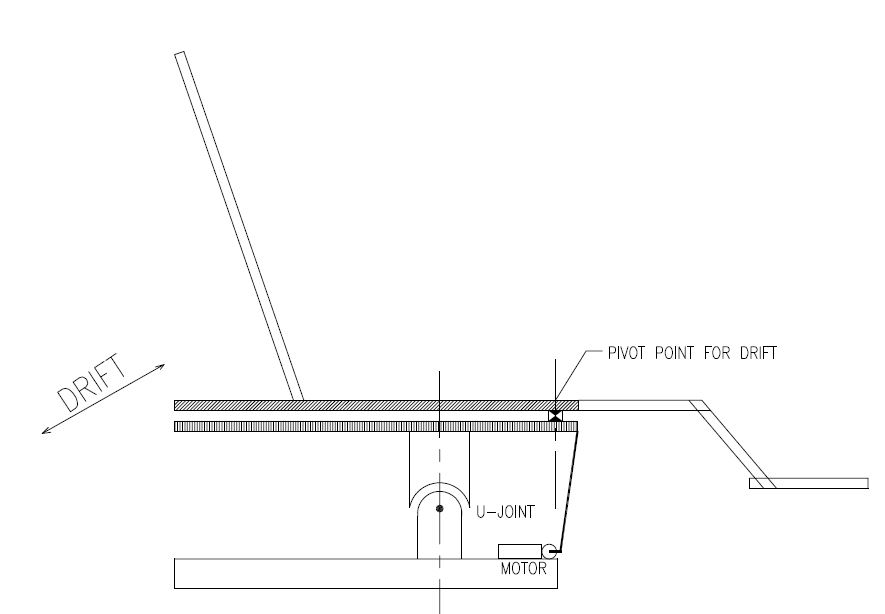

    Here is what i have in mind so far, first draft. I have to start somewhere so I ordered a seat as a starting point, this will drive the rest of the dimensions.
    www.amazon.com/gp/product/B002L1IMLK/ref=oh_aui_detailpage_o00_s00?ie=UTF8&psc=1
    Also, to avoid having to shift a u-joint when the controls are changed, I am thinking of leaving my driving controls in place and just adding a joystick on the right / throttle on the left. This takes away from the authentic experience but I think I could live with it.
    Power supplies came in today, one of them looks pretty beat-up.
    21,395
    150,025Coins
    +10,993 / 54 / -2
    If you plan on having the motors at the back then you really should have a much higher leverage point, such as a shoulder mount. Trying to lift from low on the back is about the least efficient design.
    I suspect what you have as drift will be more like yaw in terms of motion sensation.

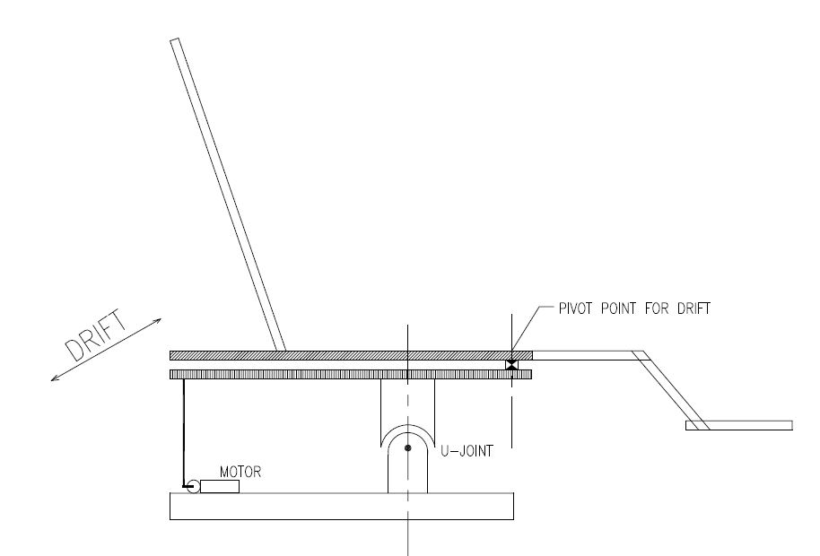

    So something like this, similar to your design? If having motors in the back is the most efficient design I might end up doing something similar to Nick's design.
    Hey Nick, there is a picture on your built thread posted by Prodigy, do you know whose built is that? Looks pretty slick.
    21,395
    150,025Coins
    +10,993 / 54 / -2
    At the front you want the mout point at least as high as the seat swab, mine is a little higher than that. A shoulder mount like @Nick Moxley's is the most efficient.

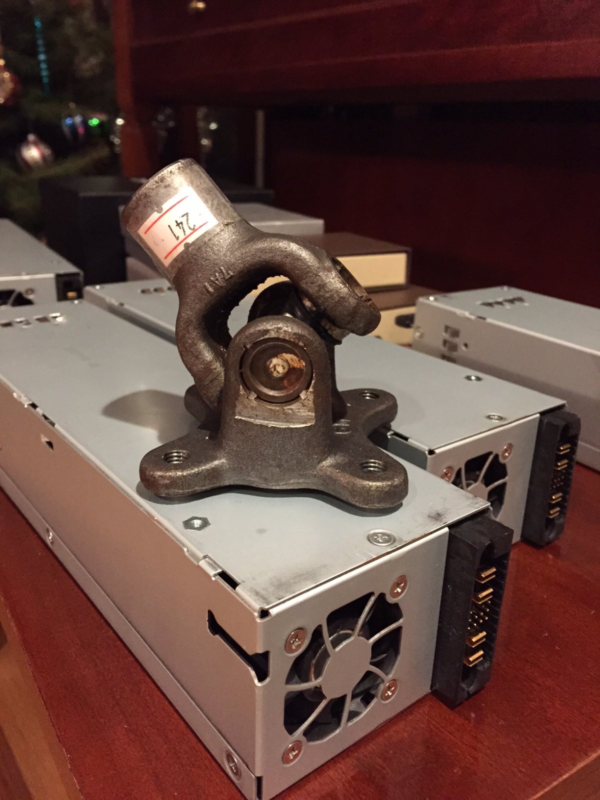

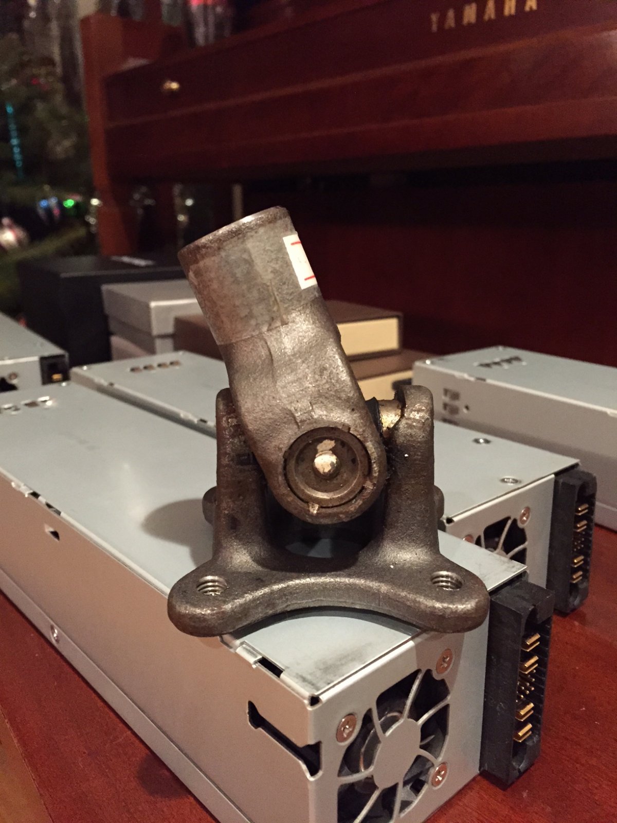

    so my u-joint came in today, it is a LOT smaller than what I was expecting. I am not concerned that it is strong enough, but is it going to give me a full range of motion? what do you think, pictures are taken on top of the power supply for reference, when it is in the extreme position. it offers more motion in one direction as compared to another.
  18. Nick Moxley
    17,056Coins
    +2,506 / 30 / -2
    I also thought I would need more angle when i first got the Truck Driveshaft for my 2nd rig i built for buddy. But in reality we are only using a fraction of the travel the Joint can offer.
    How many PSU's did you pick up ? backups or are you doing a 4dof ?

    As it is not really clear in your drawing just be aware you want the uni joint directly under the seat, not half way between the seat and the base.
