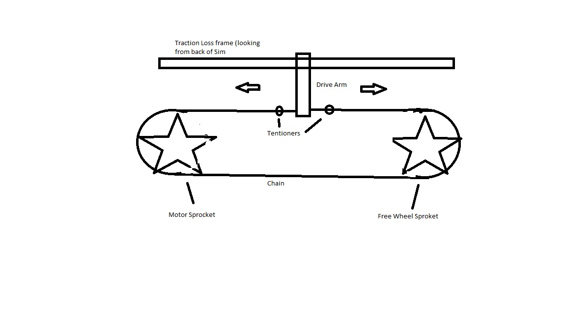

  8. SeatTime
    2,573
    28,370Coins
    +2,844 / 39 / -0
    My chain drives for Traction loss and surge are still working? I did not comment on your design as I have never tried it. Maybe something similar to this could have worked better? Basically similar in design to a chain driven actuator.

  9. Nick Moxley
    17,055Coins
    +2,505 / 30 / -2
    Thanks for the suggestion SeatTime, I Unfortunately should have tested the waters a little more with my planned setup. Oh well. No big deal. Already figured out how to correct the issue and use stuff I already have laying around. This time around there's no guess work. 100mm lever and 2 rod ends and im done. lol

  17. Al.Bundy
    Al.Bundy Member
    Jul 14, 2014
    77
    mechanic
    belgium
    682Coins
    +50 / 1 / -0
    Thats the same as I did mine wich is also still working really well, only difference is ,I have is that the tensioner is at the free spinning gear.
