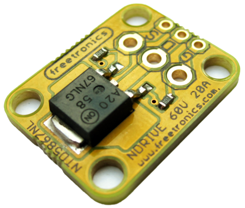

    Guys this is the easiest way to drive a fan, with an Ard.
    or even easier , its all on one pcb.
    As you can see it will drive a fan , up to 60v at 20amps.
    And is driven by one PWM pin , higher the value on the pin the faster the fan spins.
    Or an RC driven code like my Model code can be modified to run a RC EC brushless controller to run a little but powerful fan too.

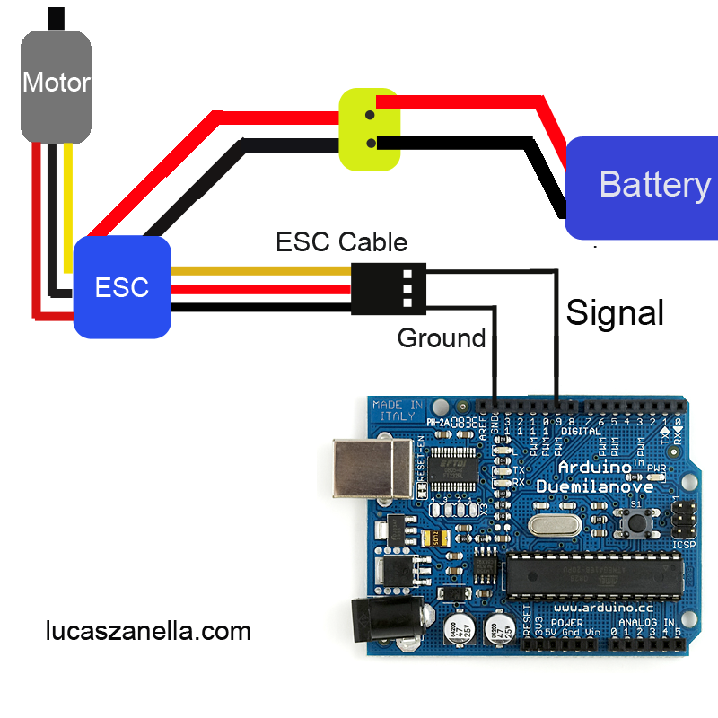

    eaorobbie,
    can you modify your "RC model" code for us. I can not code or modify.
    I have a RC brushless motor and ESC combo pack that I used on my rc buggy, and I am planning to put a rc model propeller on the motor in order to have the wind simulation on my RollerCoaster sim.
    Here is the wiring of the hardware, [​IMG] I need codes for Arduino to work with Game Dash.
    I think that once having the codes this hardware configuration will be the easiest and best way (as you mentioned) for wind (fan) simulation because they are cheap and there are many models for application needed as power, dimensions, long life, high RPM etc...
