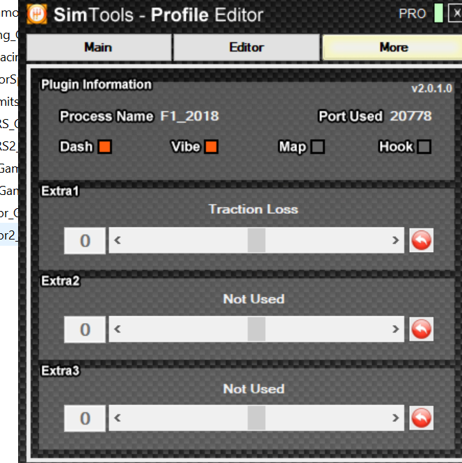

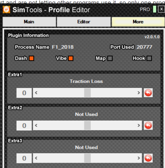

    Thanks yobuddy, i check but it's using 20777

    I'm afraid multiple apps can't connect to the same port, no matter what that port is.
    You may be able to set the game with a broadcast Ip address, something like "192.168.0.255".

    From what i have read on the codemasters forum, port sharing should be possible, but i have managed to find a work around by editing the plugin.
    Simtools is now listening to port 20778. Now with simracing proxy server i can have both programs at the same time connect to F1 2018

    Set the ingame UDP port to 20779 and all should be working
