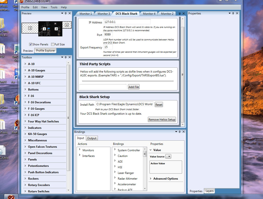

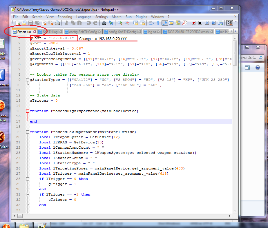

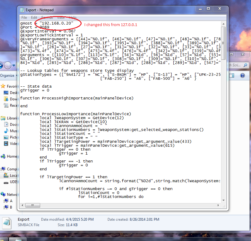

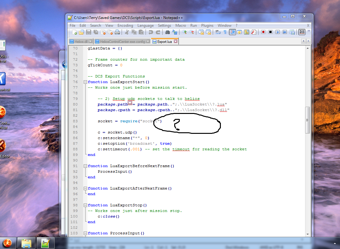

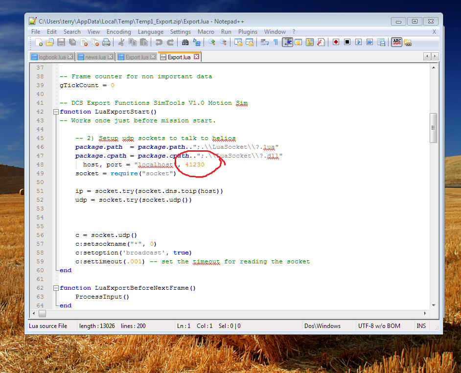

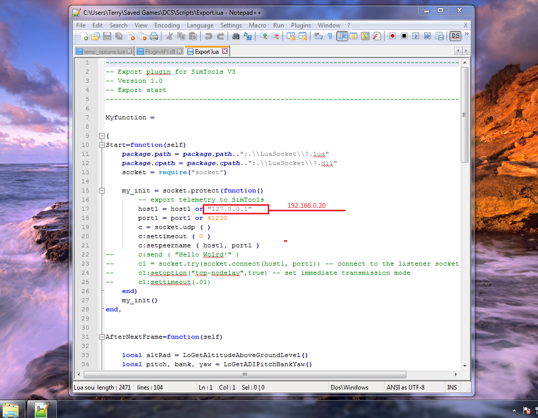

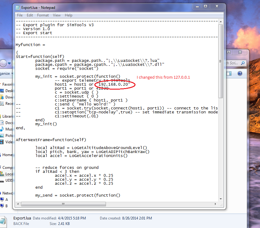

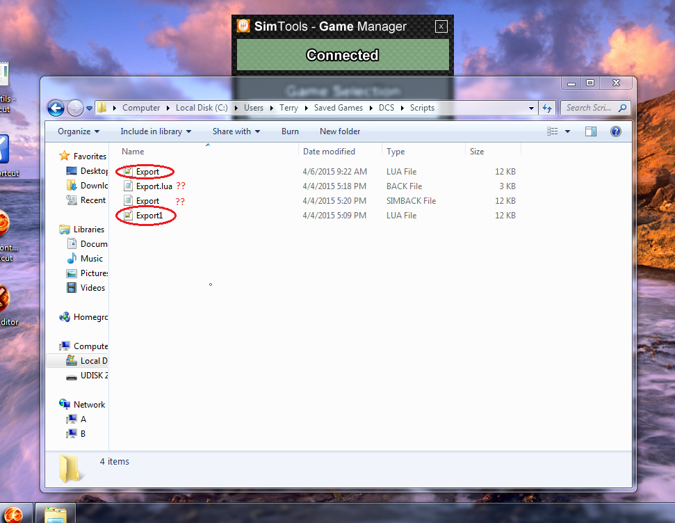

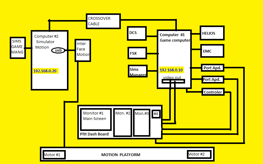

    @Macka I have been having the same problem that you had a while back connecting Helios into the Sims Tools for motion. I am using two computers with a crossover cable and each computer having it's own IP Address (#1/Game 192.168.0.10 & #2/ Motion 192.168.0.20). I can get motion if I edit the export.lua from Sims zip plugin to my IP Address, however I cannot get helios to work and if I config helios to work, I get no motion. I downloaded your zip export.lua and installed it but that to did not work. A few questions: Do I need to edit the export.lua BACK FILE and the SIMBACK file in the scrip's folder to reflect the proper IP Address? and Helios uses the 127.0.0.1 address and the ghost is also that 127.0.0.1, should that be edited?and should their be more than ONE export.lua in the scrip's folder? (see attachments)
    Thank You
    Terry

    I guess Helios is running on your game computer. So in export.lua try with host1 = "192.168.0.20" and ghost = "127.0.0.1" (or ghost = "192.168.0.10").

    Yes, I am running Helios from game computer. I am confused?, what export .lua am I to edit. (Macka's export file which only has the ghost1= or export plugin for sim tools V-3 which has host=) or- the SIMBACK file or the BACK file?? seems like I have tried all and none would work. I either get the game with Helios working or the game with motion working. Not both. Maybe I need to start over, where should I start?

    What you want is to send the motion data to the control computer (192.168.0.20) and the Helios data to the game computer (127.0.0.1) where Helios runs.
    So you will want to open two ports (192.168.0.20:41230 and 127.0.0.1:9089)
    Can you send me the helios export.lua so that I have a look?

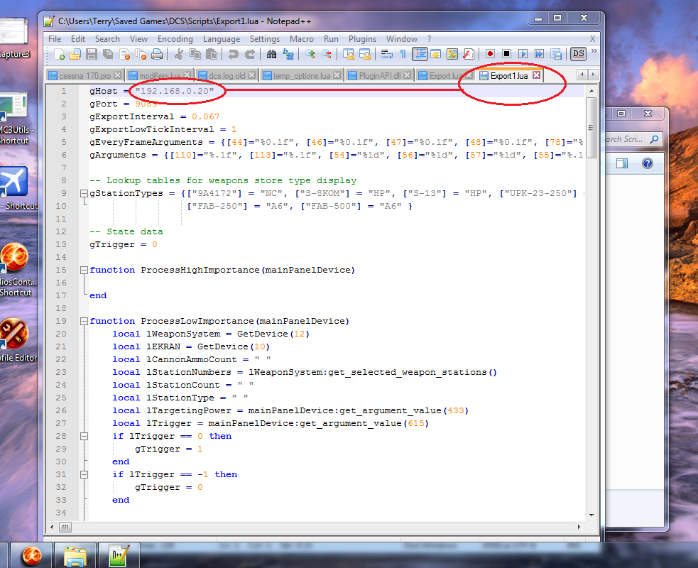

    OK, I removed my export.lua from the script's folder and installed what I thought was a good one (the one from macka), it has the ports that you were talking about 9089 and 41230, started the game and nothing. (no Helios or motion) so I went back and patched Helios started the game and Helios worked well but no motion. Went back and checked my export.lau and the part about port 41230 was gone.WTH. When I start up the game (DCS) it takes a long for it to load, much longer than FSX, so could the timeout be a problem? See attachments
    Terry

    I started over and all is the same, either motion and no helios or helios and no motion! Here is a copy of my export files
    Terry
