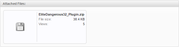

    This is plugin 1.0.0.4 which is an update for ED release 1.0.0.3
    This plugin now provides pitch speed and roll speed, surge, sway and heave :)
    I don't think, pitch, roll and yaw (angles) make a lot of sense, as in space there is no difference anyway. I mean, it doesn't matter if you're "upright" or "headfirst". I have added pitch and roll speed only.
    Also I don't think, yaw (speed) makes a lot of sense. I think there is no control for yaw in the game anyway.
    Let me know your thoughts, please

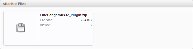

    This is plugin 1.0.0.5 which is an update for ED release 1.0.0.3
    And I've added yaw speed. Because I finally figured out, how I can yaw the space ship Psst.png
    This plugin now provides pitch speed, roll speed ans yaw speed, surge, sway and heave :)
    Let me know your thought, please
