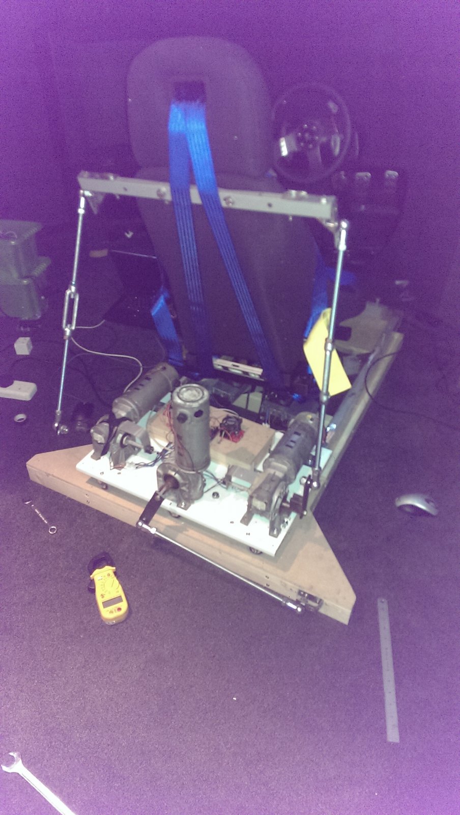

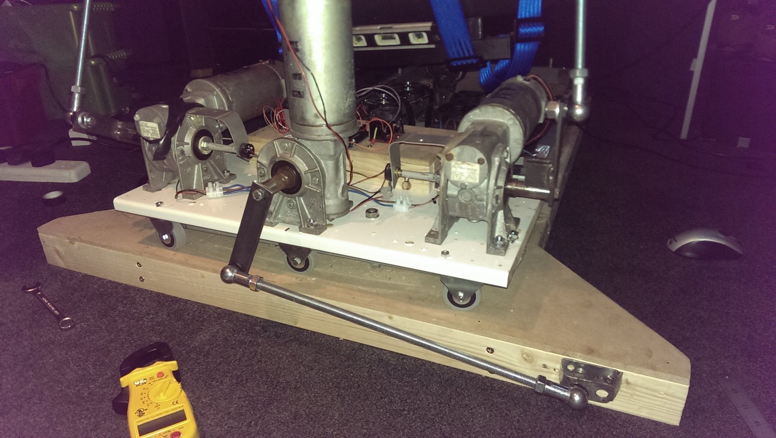

    Just a little teaser, I have now added traction loss and its amazing ! only had a quick test. I need to tweak a few things and then I will get a video posted.

    Great addition @SilentChill. Seems that adding traction loss is the flavor of the month.
    What did you use for the front pivot?
    I see you have the new motors sorted and attached.
    Looking forward to the video.

    @noorbeast I used a Lazy Susan bearing as the swivel point.
    Think i need to get solid wheels as the rubber have a bit too much friction

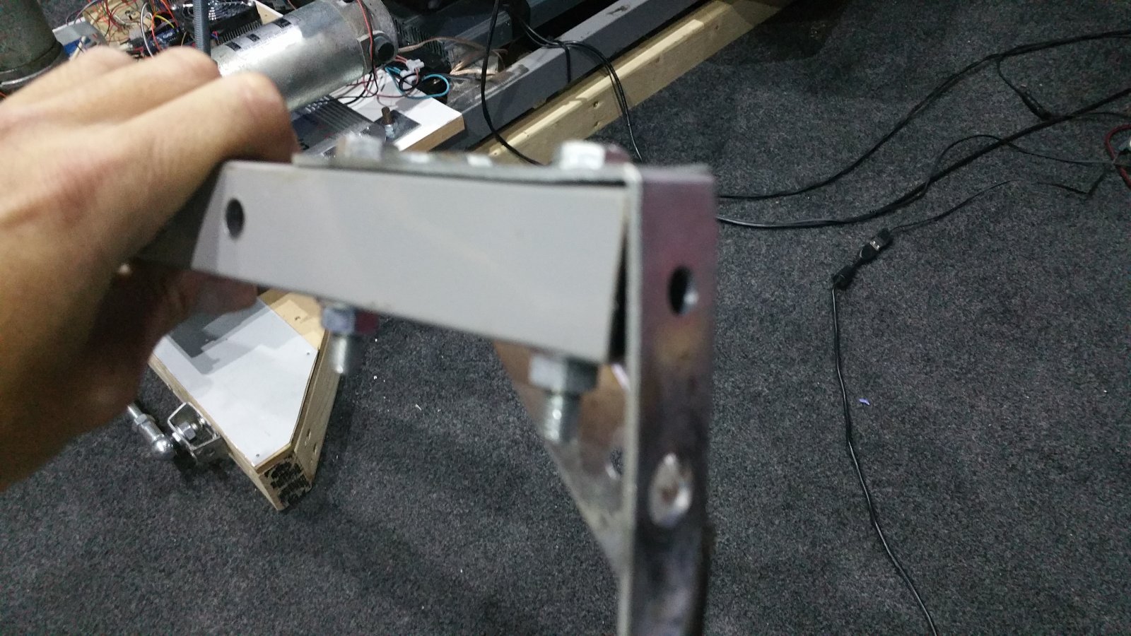

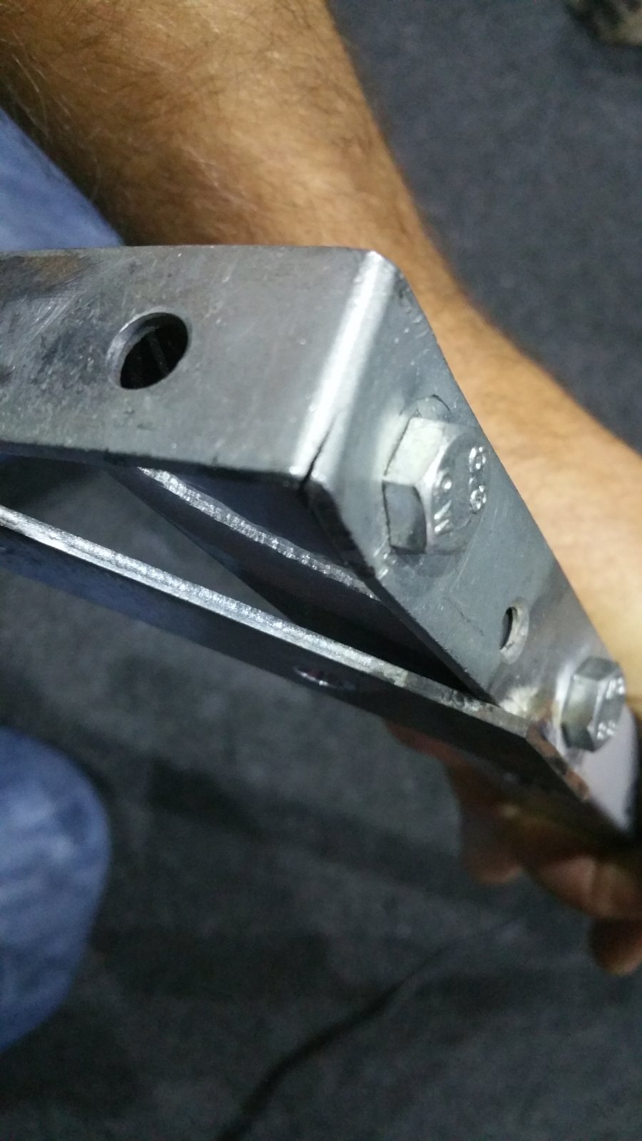

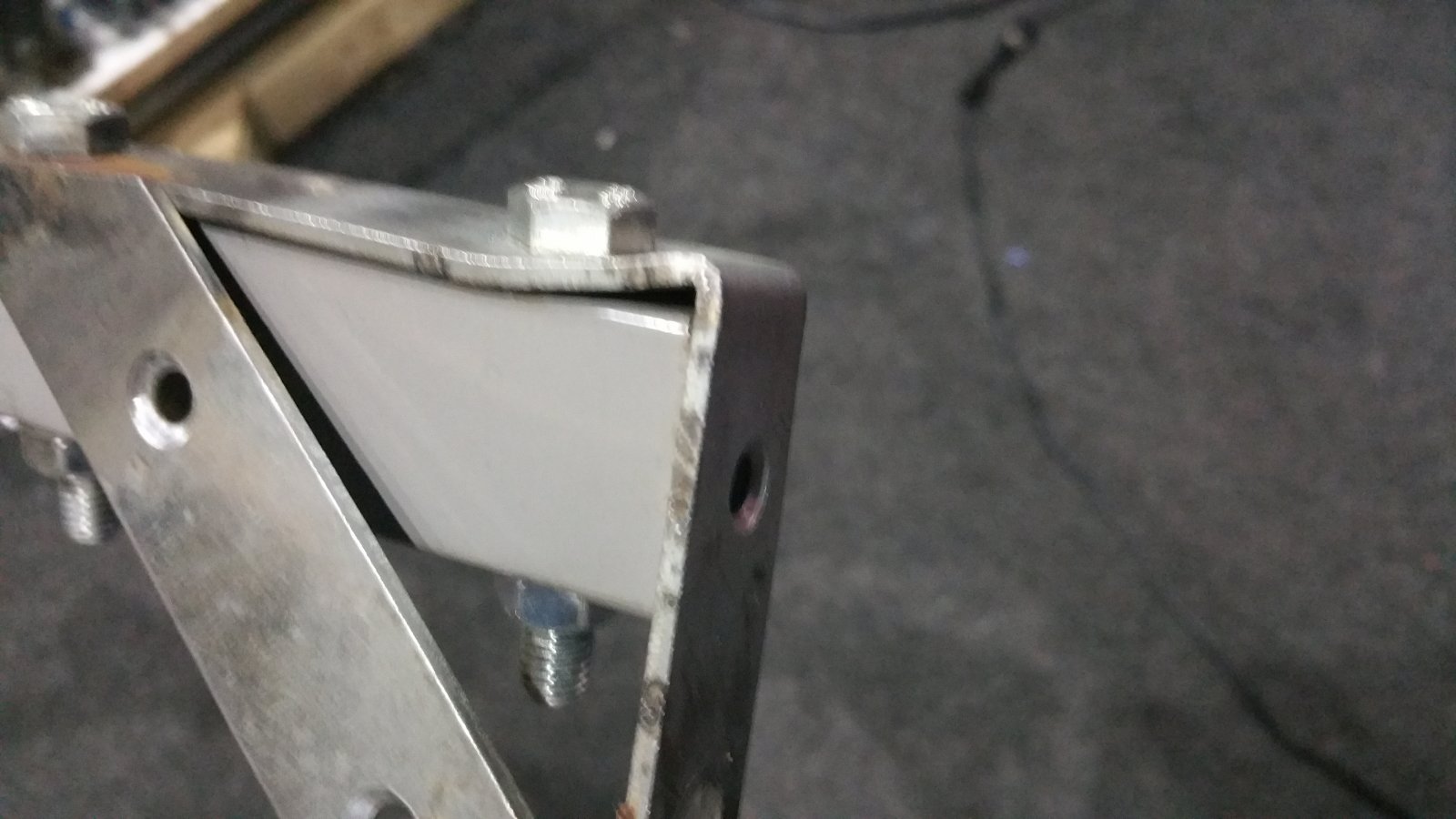

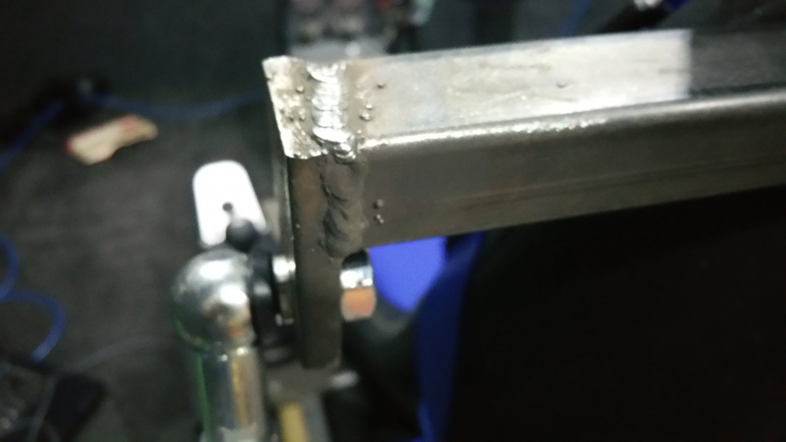

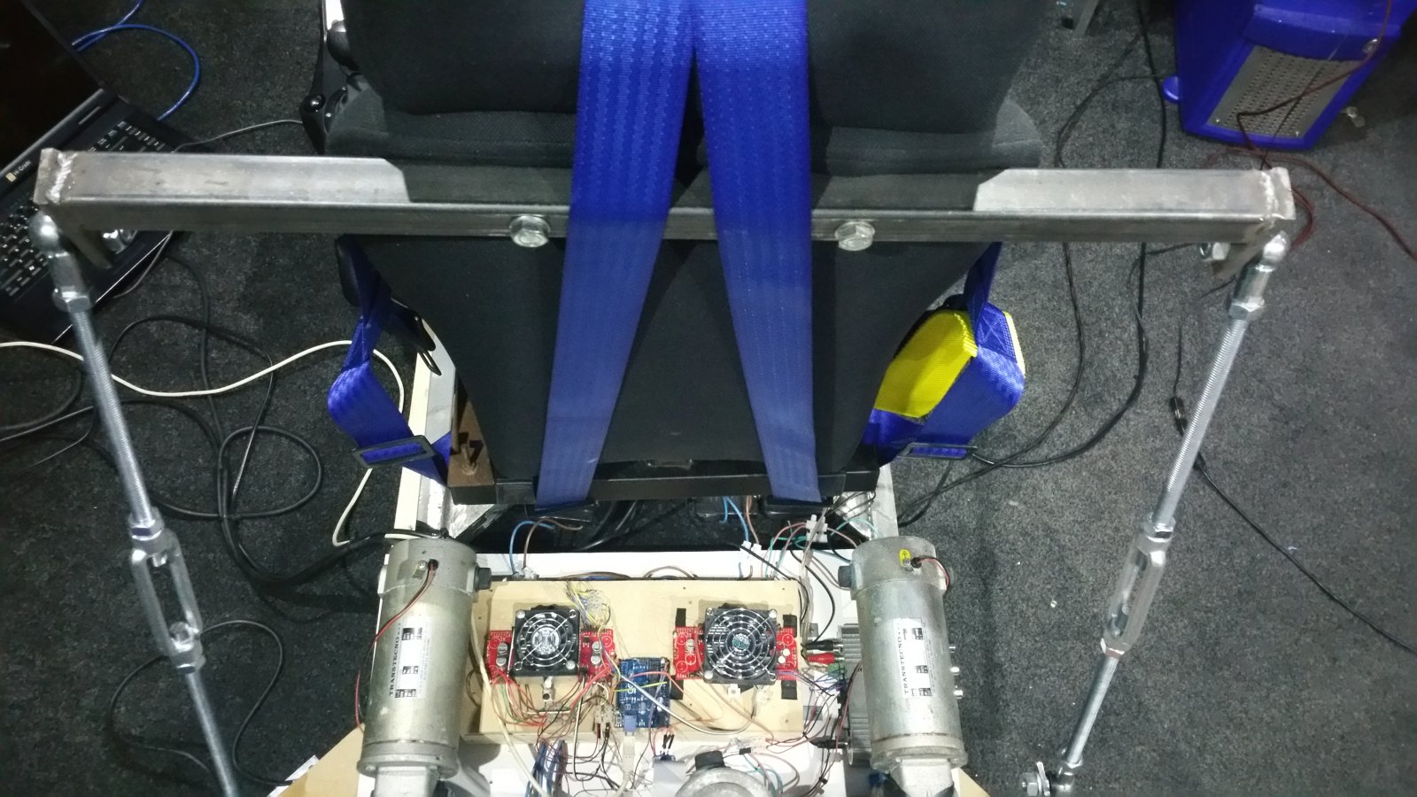

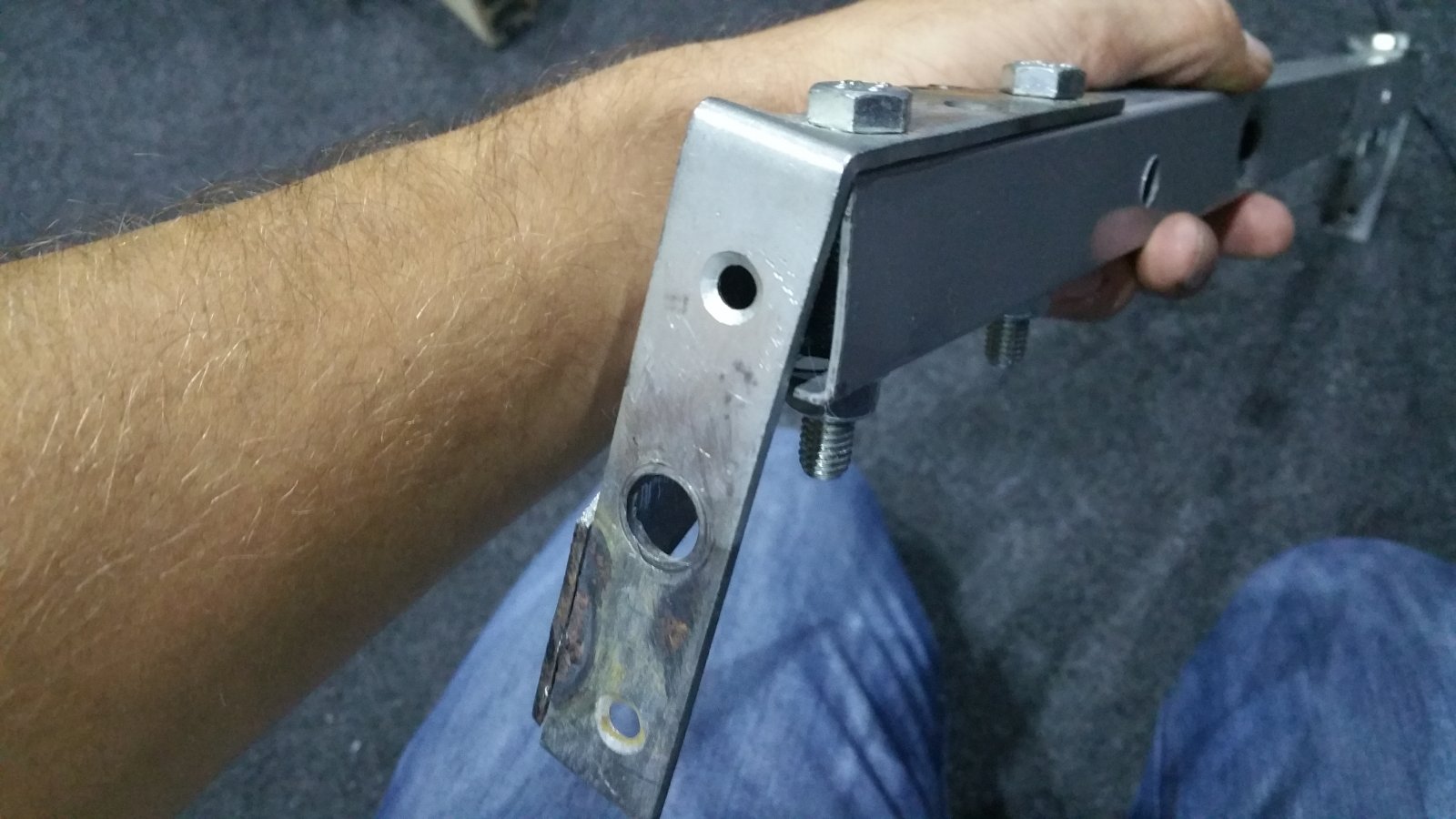

    Had to upgrade my bracket on the back of the seat it had started to fail on both sides .
    20141121_162726.jpg 20141121_162756.jpg 20141121_162807.jpg 20141121_162835.jpg
    So I quickly made a new more sturdy bracket. My welding getting slightly better but not much lol this should hopefully last a long time.
    It's so handy having a little welder handy.
    Thanks for looking :)

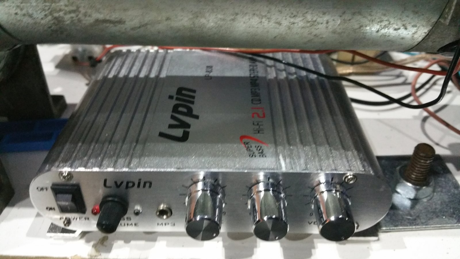

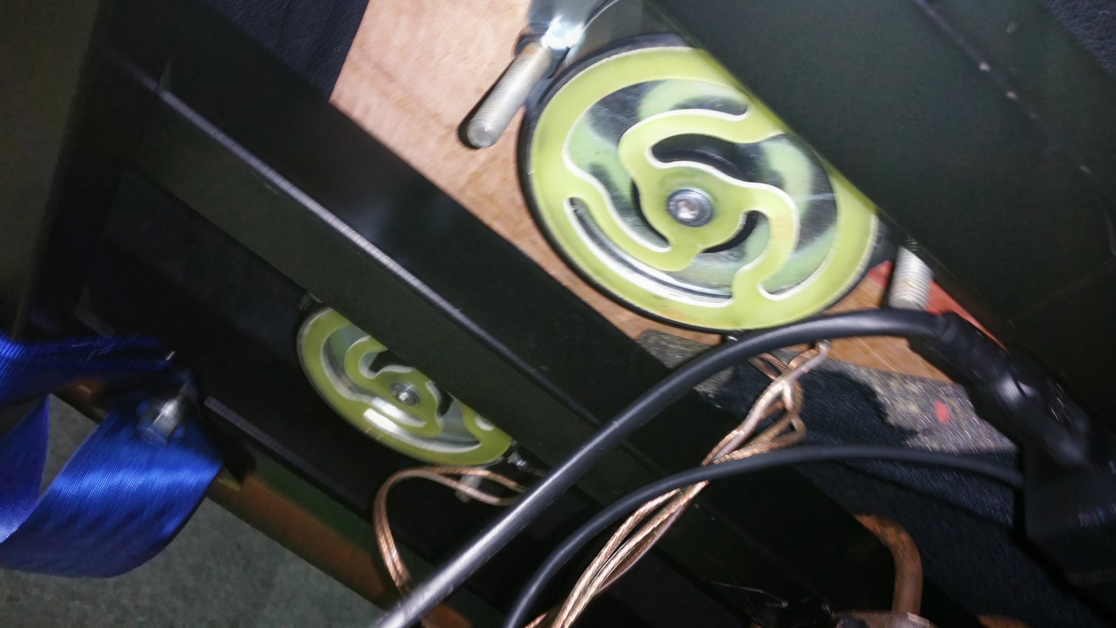

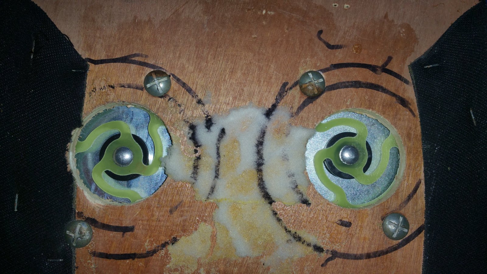

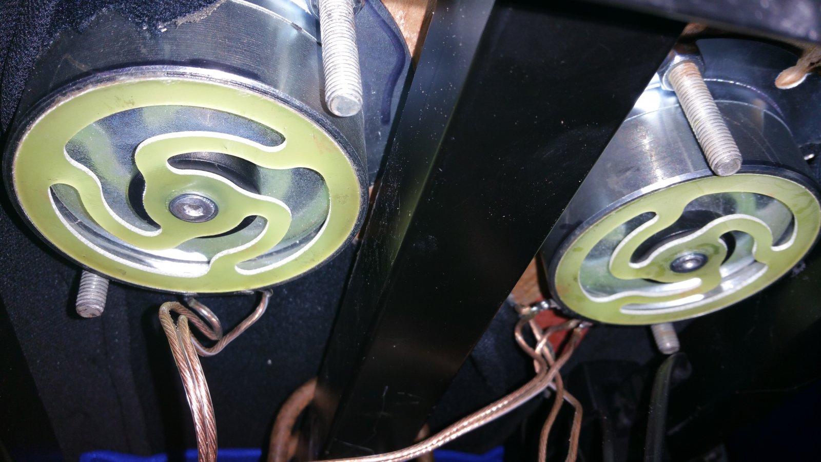

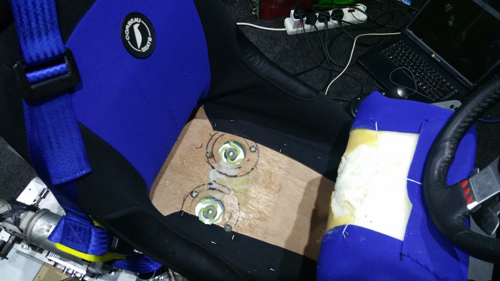

    I have got my transducers hooked up now also using the method I had posted in the other subforum. Works quite well I may try get a video see if it can show them working.
