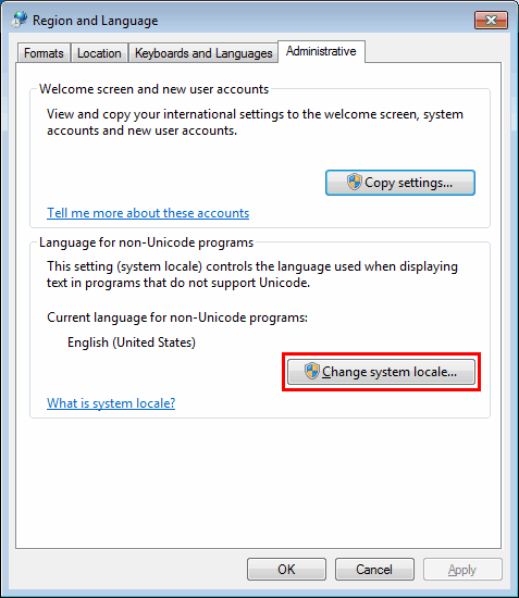

    Hi, thank you very much for your excellent work! I have same bug as 741852cp has. and I downloaded the last version of Simtools. But this bug still happen. I'm running Dirt3 in Win764bit. Please help me!

    Thanks for reply! I have read the doc. But I can't resolve this error by the doc. My situation is the game data input not correct. It is chaos. They changes very fast and erratic.
    I checked the hardware_settings_config.xml. But it looks like alright.
    I guess maybe the dll file of game plugin has problem?
    Thank you again for your help!

    I finally figure out this problem! I was running Simtools in win7 Chinese version. And I find a PC running in English version to test Simtools. And that bug is gone!
    So I think maybe the bug was the result of Language for non-Unicode.
    If anybody else run into the same situation. Try to change "Region and Language" setting.
    Thank you, your answer is really helpful!

    I am using Sim tools 1.2 test, a good improvement, data overflow can be restored. Thank you for your work!
    Test results are as follows:
    win7 64, windowXP Chinese version
    Sim tools 1.2 software interface overlap, but
    Can be used.
    IL2, Race07, ms Flight X. Normal data output, a perfect run.
    LFS, Game Data-input, Axis chaos jumping
    win7 64 English
    All passed the test, perfect.
    Two weeks ago and Tim sieh discussion and Tim sieh the same as.

    I also encountered the same problem. Use of local languages, RBR plugin output correctly, LFS plug-in error published output.
    After testing, the system changes the system locale to English, it is useful。
    Guess the question should be plug-in。
