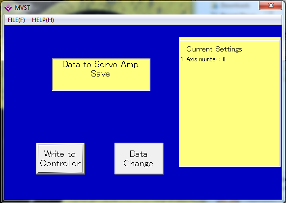

    And SUCCESS! MasterYoda, please update your thread with this info. It will be a HUGE help with anyone trying to do this conversion. The method of using x-sim to change the ID won't work right with the newer software and the Devantech converters, however this method will WORK.
    First you need to determine which actuator has the wrong ID. I achieved this by using the TBVST Visual Setting tool. Run the program, and choose the COM port of one of your actuators. It will poll the actuator and list the Axis number (Device ID) in the upper left. If it shows a 0, then this actuator is already on the correct Device ID. Repeat this with the COM port of your other actuator. If it reads 1, then this is the one you need to program.
    IMPORTANT: Disconnect the actuator that is properly programmed at this point.
    You will need to download and install the SCN5 programming software package from http://www.automation4less.com/servact1.htm
    I had to install this in compatibility mode for Windows XP and run the installer as administrator under Windows 7. I also needed to install VB runtimes from microsoft. You can get them here: http://download.microsoft.com/download/vb50pro/utility/1/win98/EN-US/Msvbvm50.exe

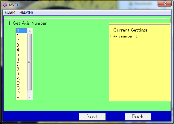

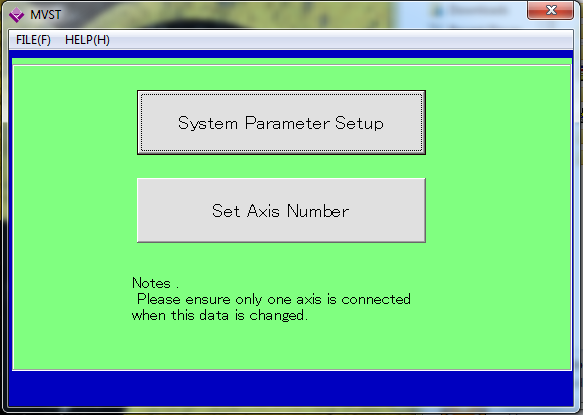

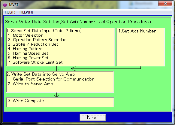

    Now, you will want to run the MVST ServoMotor Configurator:
    Click Next
    Click Set Axis Number
    Choose 0 and then hit Next
    Click Write to controller. This will write the new Axis ID to the actuator. You can then click Data Close.
    Go back into your Sim Tools, and configure the Interface settings. Restart SimTools and your actuators should both jump to life!

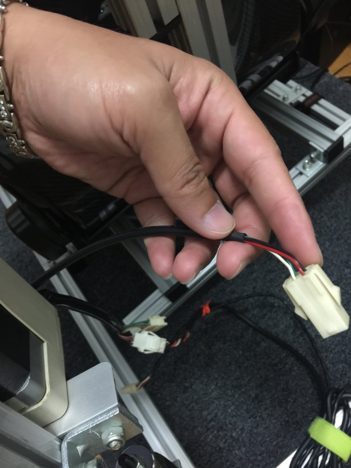

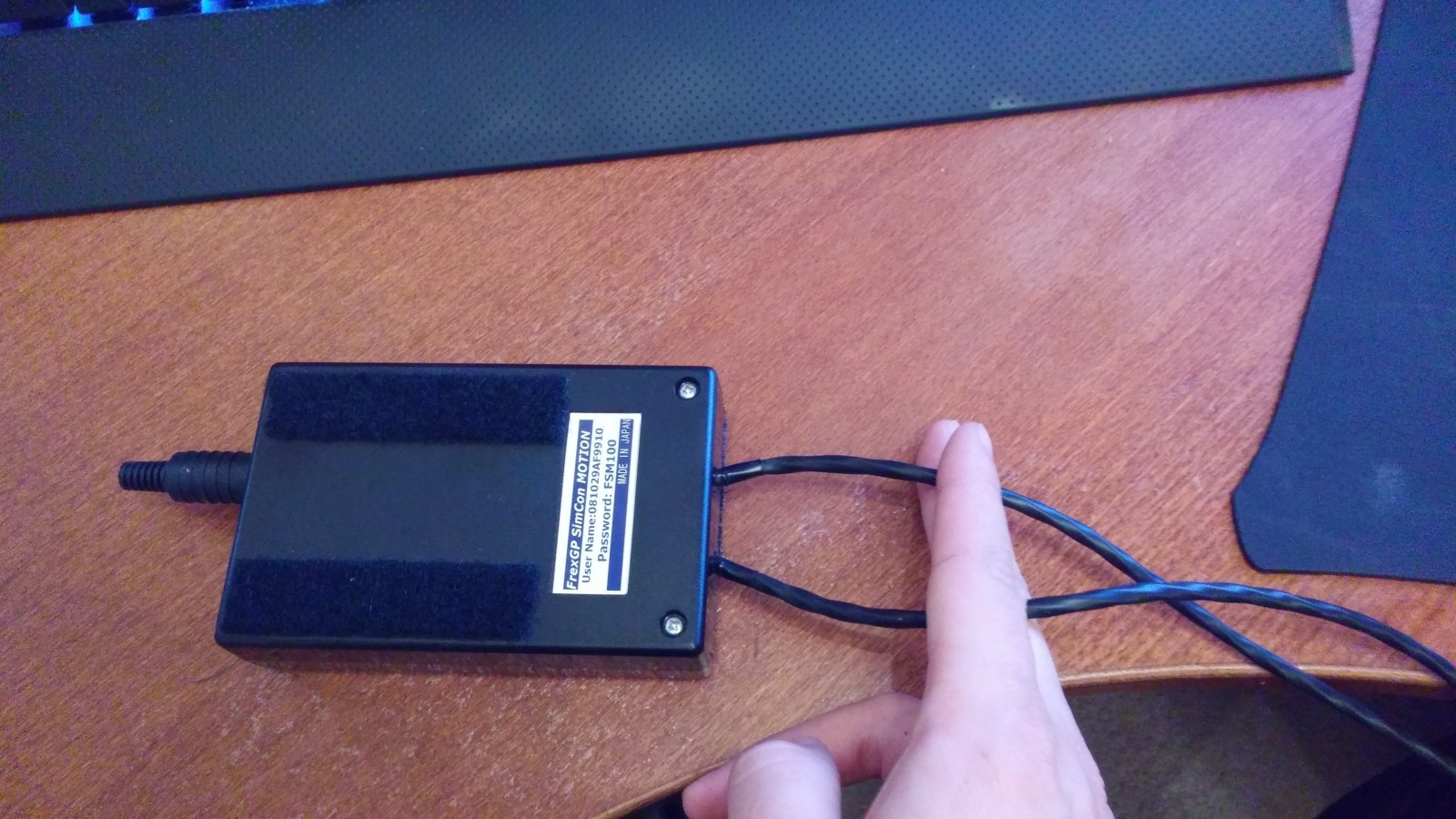

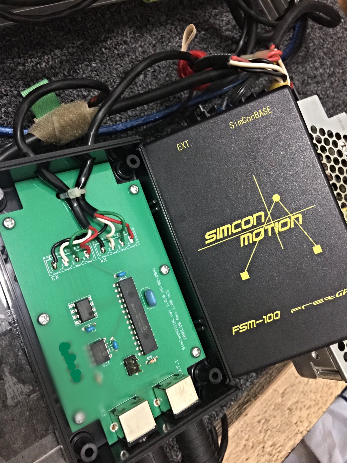

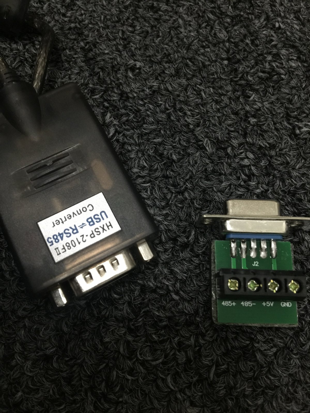

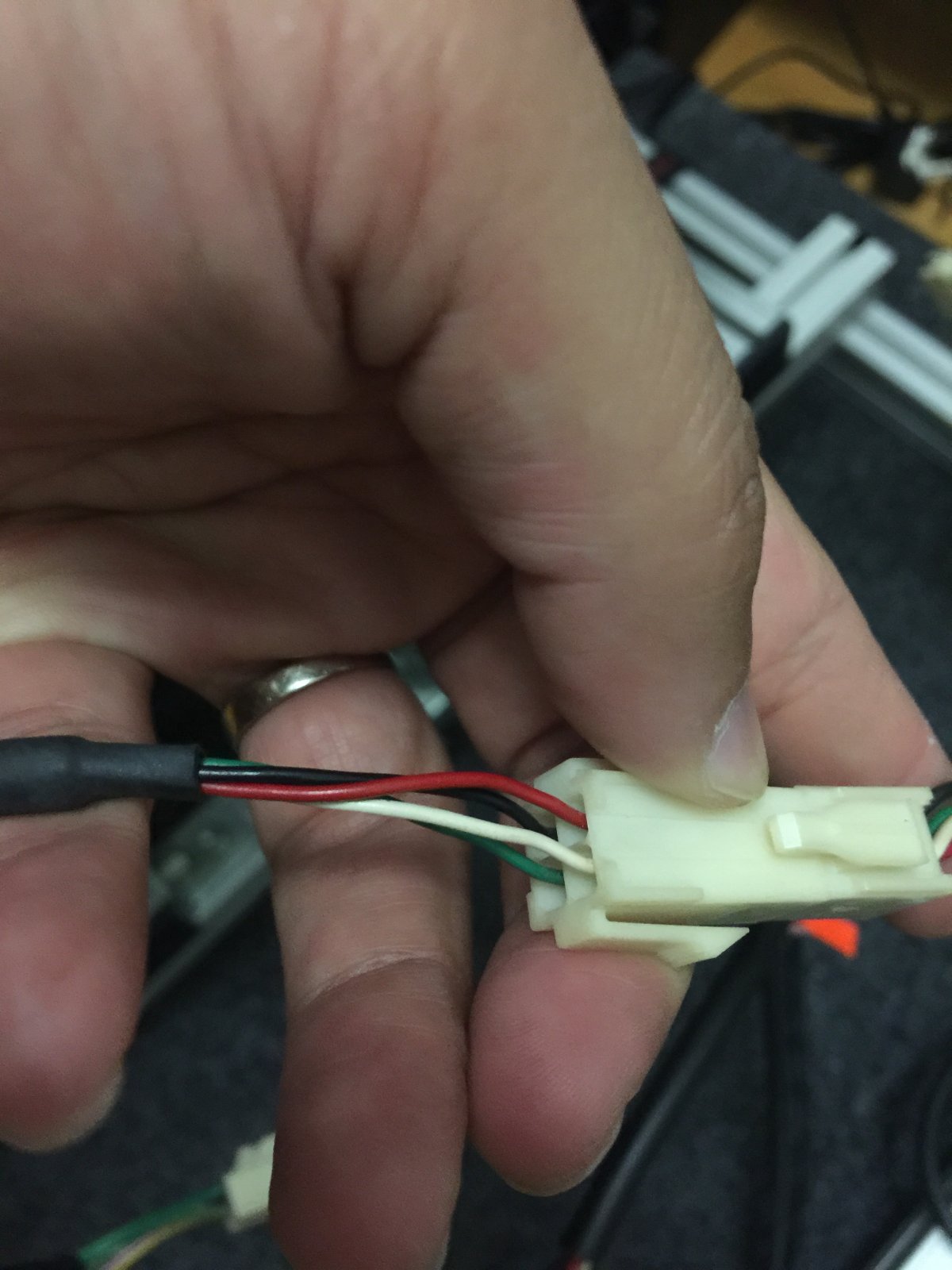

    Hi all, as I see the photos mine just got the different wire as a photo shows on the first page. So is that I just it it and place in it?
    Further I got a Simcon motion box seems is connecting to the power supply. Do I have to cut it out?
    Below is the rs485 that I brought in HK also the wire photo.
    I had been struggling for my rig for the 3rd week.
    Thanks in Advance for helping me out.

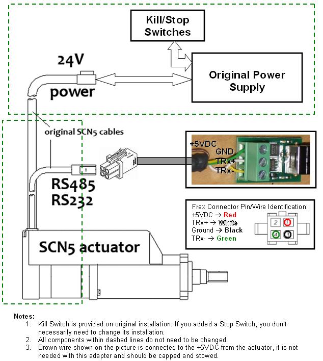

    It seems to be that the photos on the first post seem to be missing, at least for me. I ordered an extra set of the wires from Frex so as to not cut mine off. You will have to cut the wires off the simcon motion box, then strip the wires, and connect them to your RS adapter. If I recall, + is WHITE, - is GREEN, +5V is RED, and GND is BLACK. Let me know if this helps!

    I fixed my last post to have the correct colors, as seen in the attached.

    SCN5, SCN6
    Thanks @Mif. Thanks for the info and is helpful.
    One more question to be more clear.
    So just just need to cut that 2 wire in the motion and stick those wire to the RA485 then it done right?
    The photo that i post (the below show) doesn't need to cut right?
    Coz I don't think I'm gonna order another motion box for that. Hehehehe thanks
  17. Mif
    Mif Member Gold Contributor
    Oct 18, 2011
    30
    Seattle, WA USA
    - 8Coins
    +21 / 0 / -0
    2DOF, SCN5
    Correct. Only cut where I showed in my picture. Do not cut on the scn actuator side. That way you can still disconnect and reconnect for maintenance. If you want post a photo of your cables I can let you know if it is correct.
