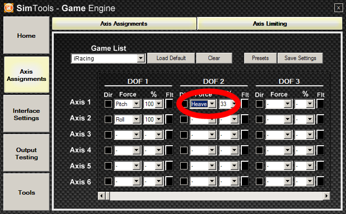

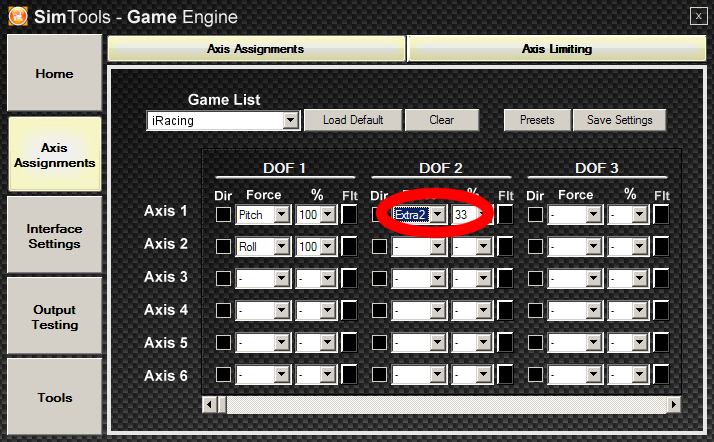

    People sometimes add a little heave to the profile even if they don't have a full motion seat. This to feel for example curbs when reaching the edge of the track.
    Maybe someone can share his settings?
    If you have added heave to your profile already in the past, you might want to exchange Heave with Extra2 in the GameEngine Axis Settings:

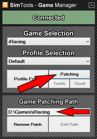

    Is there anything special I have to acommondate for? Game Manager stays always at connected and never gets blue and I get no motion out of my actuators from ingame.
    Test setup works fine though..
  12. value1
    Jan 9, 2011
    2,184
    Zug, Switzerland
    14,822Coins
    +3,324 / 11 / -1
    Did you patch the game?
    Otherwise there's nothing to do.
