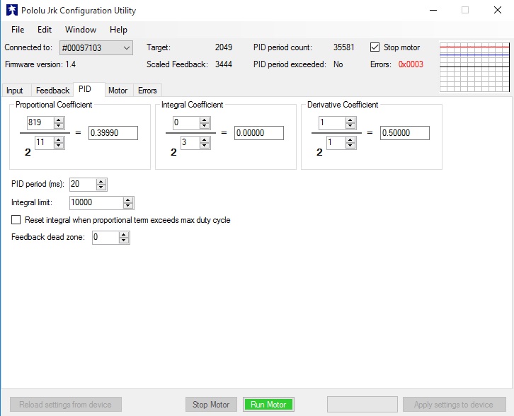

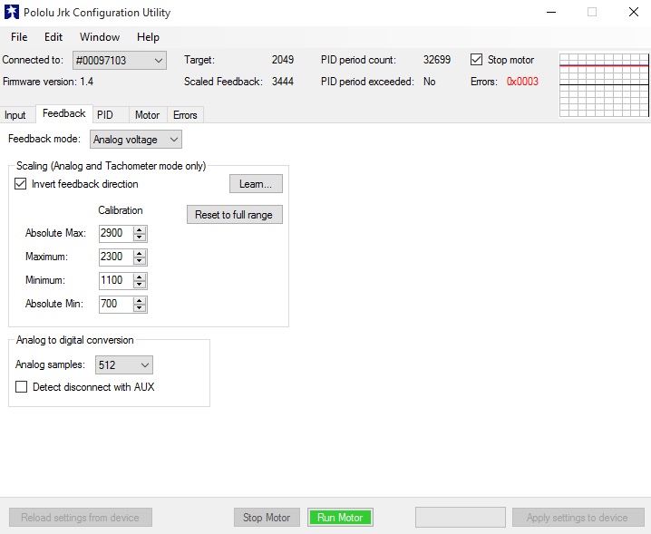

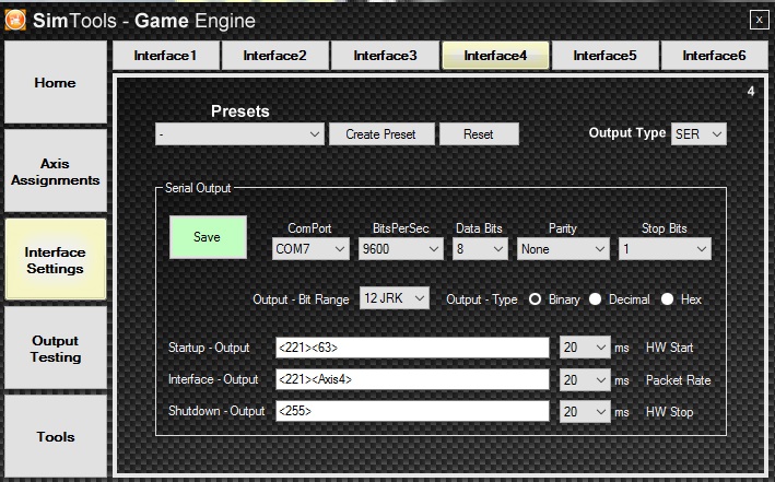

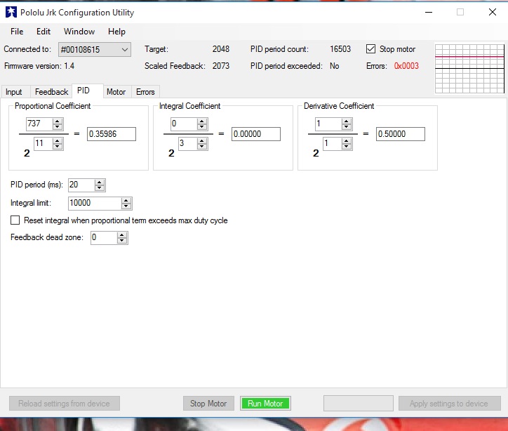

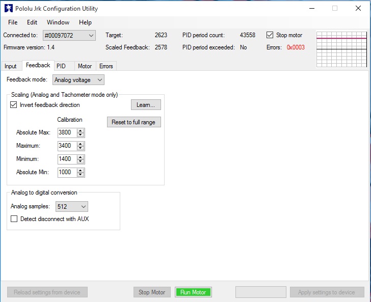

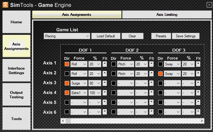

    I don't really wanna say my motion is awesome elsewhere as I'm not sure it is really, but it does seem worse in iracing for some reason. I'm happier with the feel of Project Cars and Assetto for instance but looking at your video it sure does look cool and I'm not sure ive ever had that sorta immersion from my motion

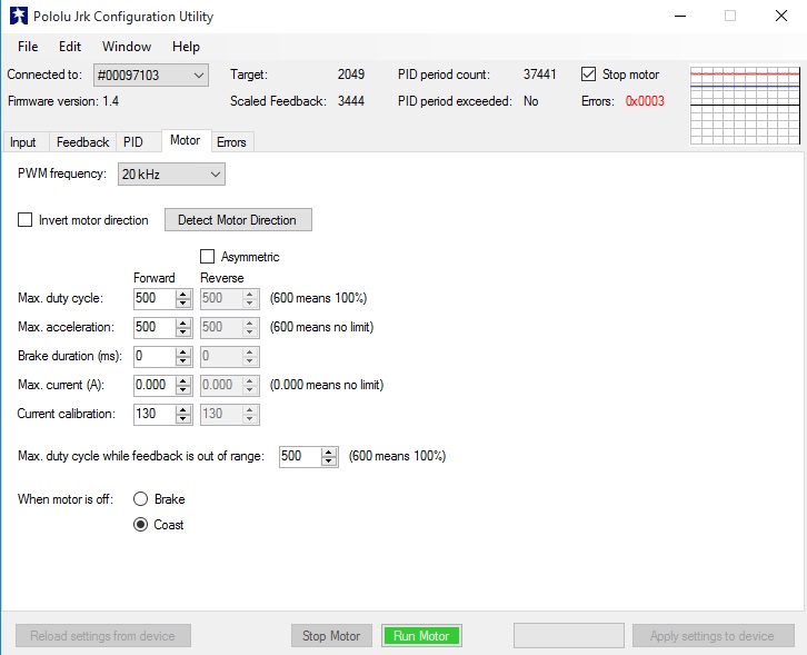

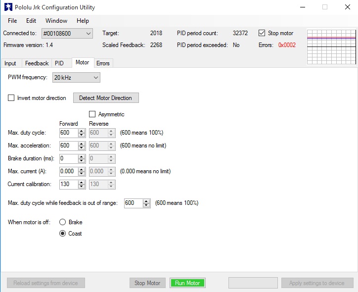

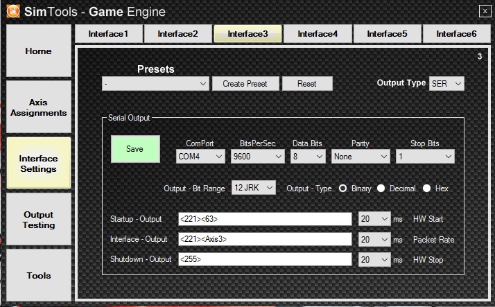

    Ive just gone through all my jrk config settings, simtools settings etc to see if anyone sees something ive done wrong. Ive played with settings so many times over the weeks etc that I may of stuffed something up I guess aswell so please take a look if you don't mind!

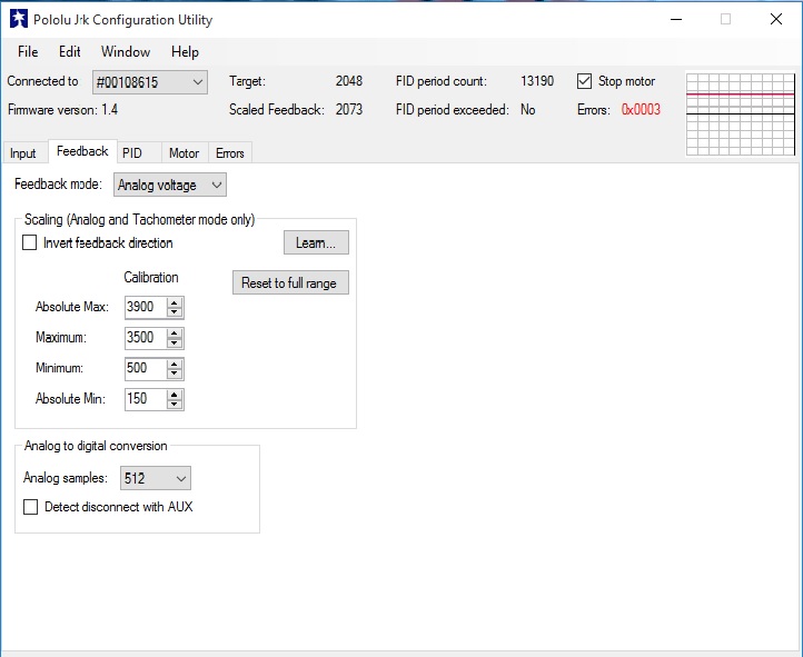

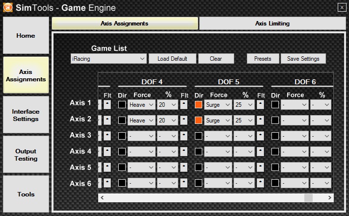

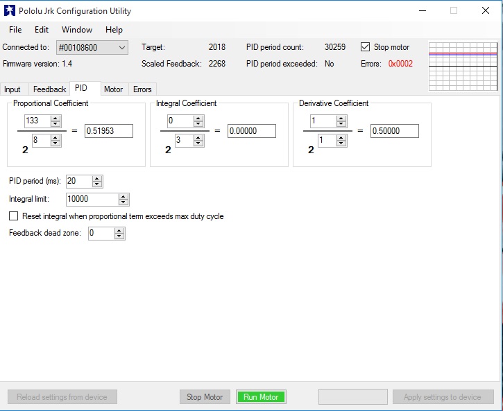

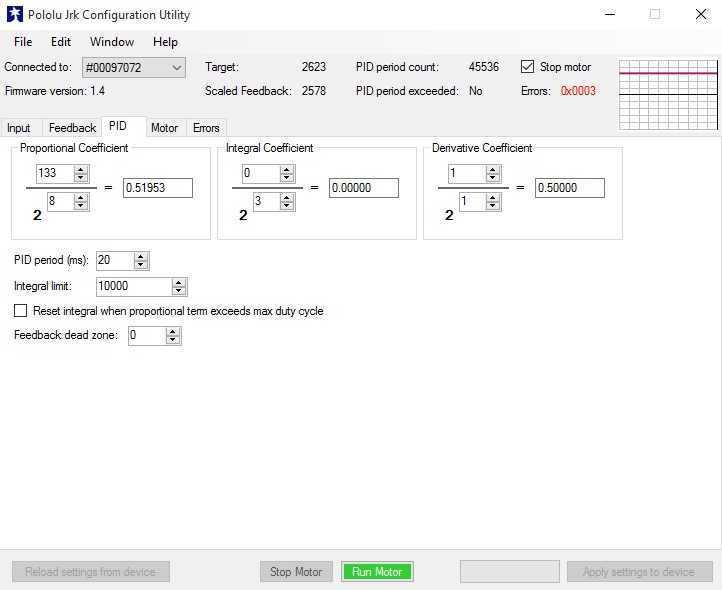

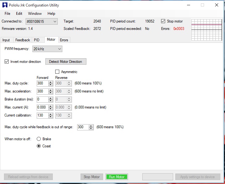

    The interface settings look OK.
    In the rear left and rear right JRK P looks too high relative to D, which will normally be higher, have you followed @bsft's guide to find the settings: http://www.xsimulator.net/community...-set-up-simtools-jrks-and-write-profiles.112/
    Surge and traction loss PIDs looks OK.
    I am guessing you have a reason for the traction loss motor settings being significantly lower than the rears or surge.
    I don't use iRacing but in the Tuning Center it is highly unusual to have Heave higher than something like Sway, though if I recall iRacing has gravity effects so that may be it. Did you go through and tune the settings one force at a time, starting with Surge then Sway then Heave? Personally I would leave out Pitch and Roll until those other forces are pretty much perfect.

  10. bsft
    @Boomslangnz , the JRK settings look ok here as well. I thought maybe a little high on the P on the shoulder motors, but the traction loss motor P is ok . So thats fine.
    If there are no errors, then leave things as they are.
    With motion, different game engines will give different motion.
    I think Iracing is based off the nascar 2003 engine. So as its an old game, but has good laser scanned tracks, the only thing you can do to compare is run say , rfactor or race 07 and test to see what the difference might be.
    Otherwise , its all good.
    Dave.

    That p is higher cos I went over it with rob. He wanted it high

    I determine the initial P and D as half the value of when the motors start to oscillate when you move the slider bar fast from side to side in the JRK Input tab.

    @scalhoun yeah mate, if you could post your settings that would be great. Yes I was using extra2 as my heave but since Pit was saying I had no heave I put it back to heave to try that out. However I will properly put it back to Extra2 as although he says I had no heave, I could feel heave just fine when in seat. I take it theres nothing which stands out as any settings wrong in simtools since no one has stated they see anything.
