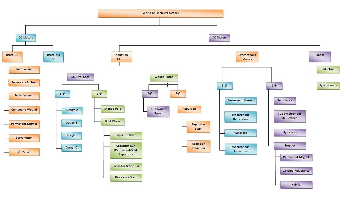

    Hi guys ... nice comparisons which I may add something ...
    @X71 ... I guess your main question is about the relation between : motors classifications , there related motion control technology that we can offer you here , the needed output power (torque & speed) at the mechanical end point ... all that related to your budget and what you can " DIY " ... That may summarize what you need .
    my point is you can notice that universal motors (which runs on AC like blenders or angular grinder ) are listed under the DC motors ... a powerful geared motors like this can be found and used with screw ball and linear bearings .
    • Informative Informative x 4
