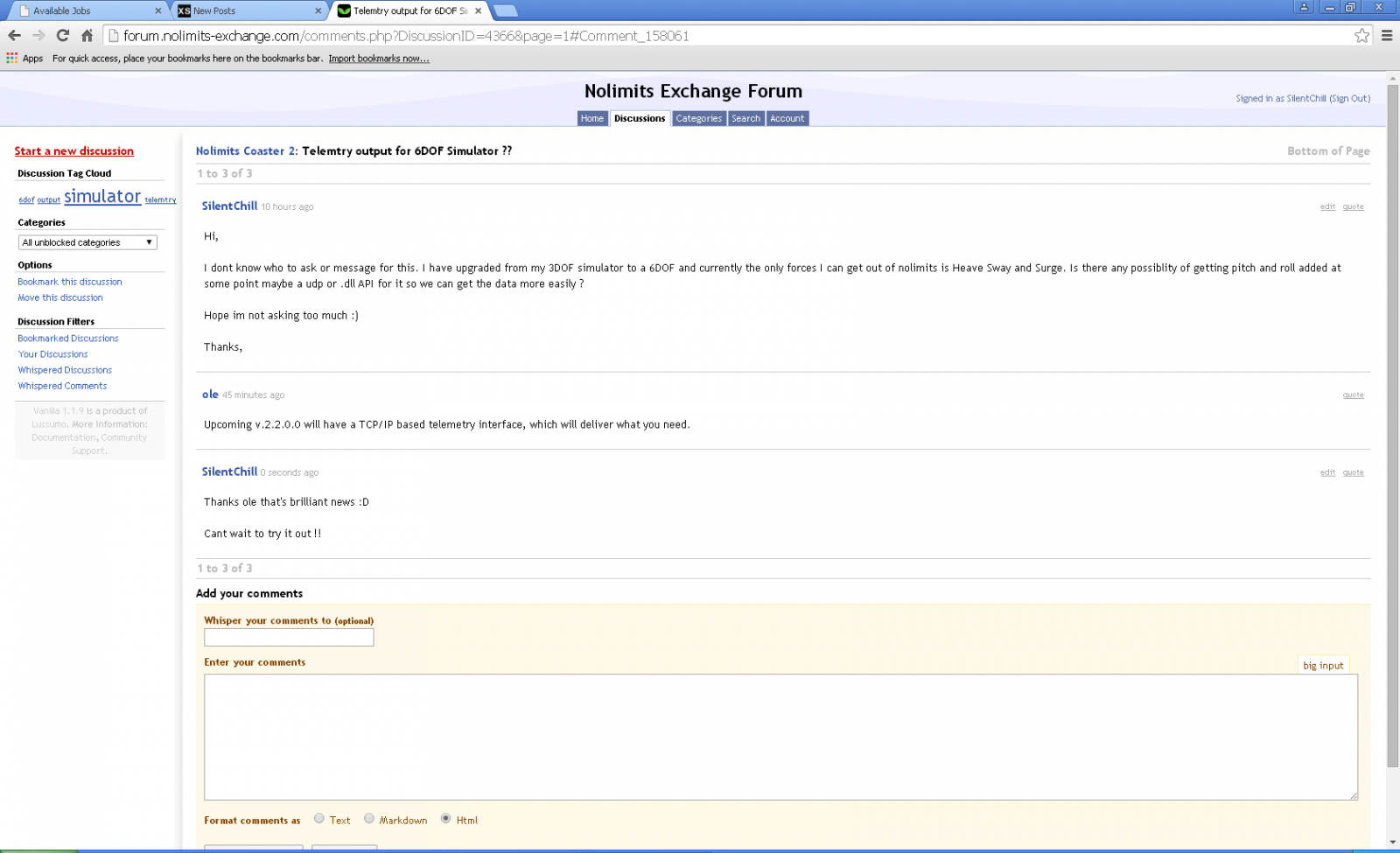

    Hi @SilentChill
    I've had a conversation with Ole some time ago about the coming API for V2.2 and for sure we will try to extract the motion data via this.
    Dunno ATM when V2.2 will be ready though.
    Thanks for sharing :)

    I haven't understood why the roll an pitch aren't present in the nolimits plugin. For a realistic simulation on a 3dof I think they are needed. Or not? I think the right configuration should be roll, pitch and heave, someone can explain me better?

    Maybe pitch, roll and yaw will be available with the IP-API of NoLimits version 2.2.

    Yes because advanced telemetry is now implemented meaning more motion and hopefully all 6dof and some shaking gonna happen !!!!
