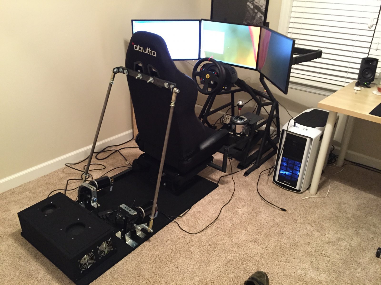

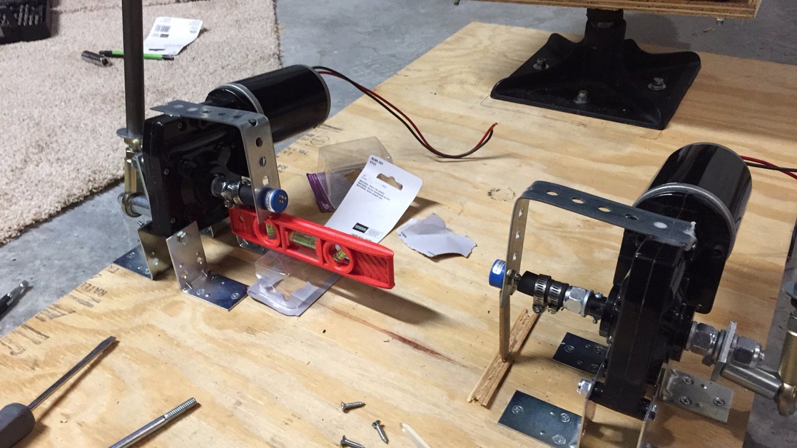

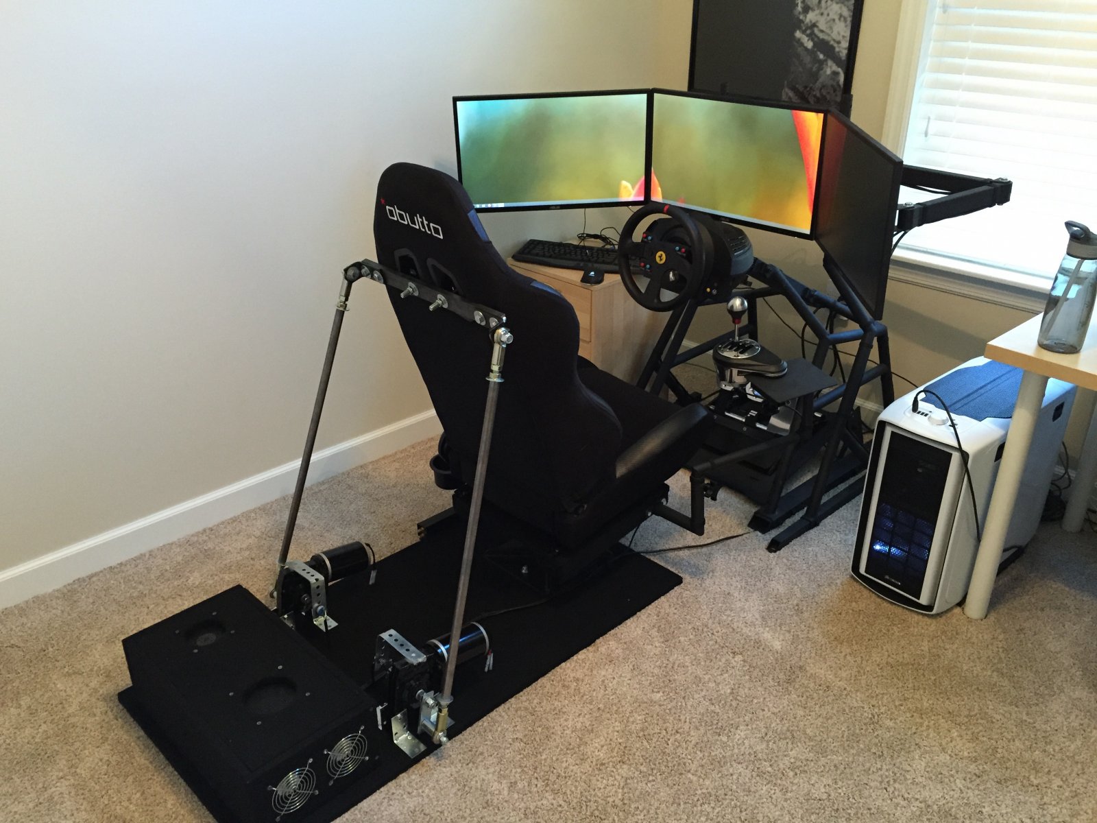

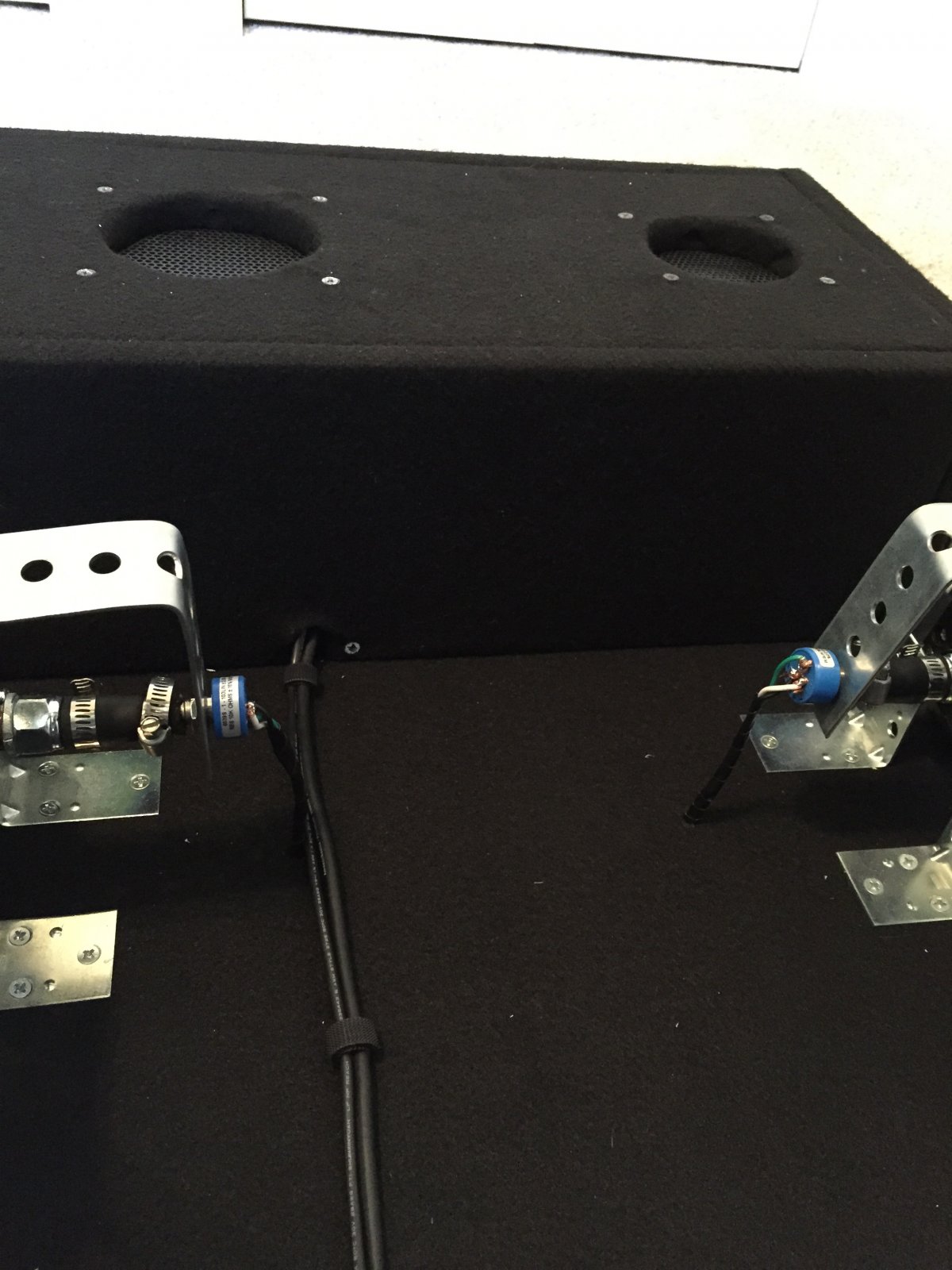

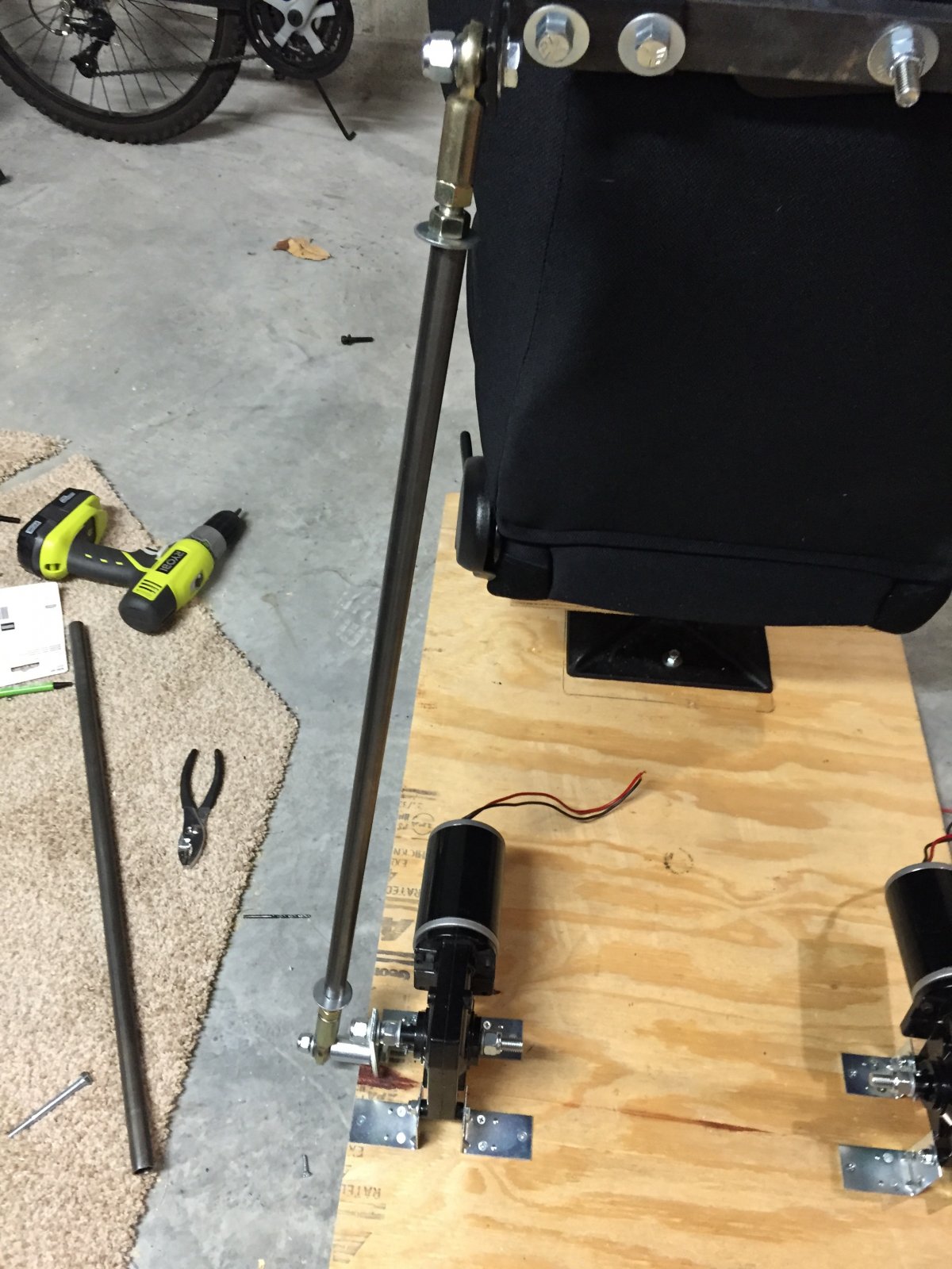

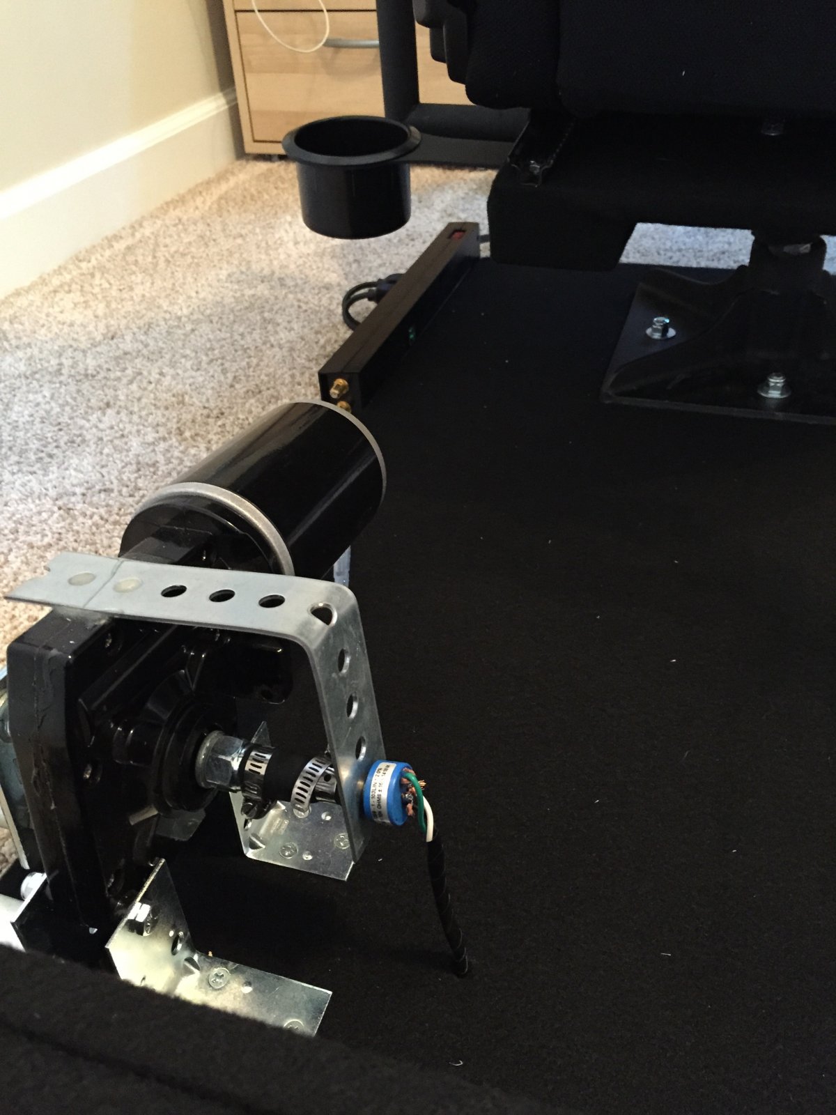

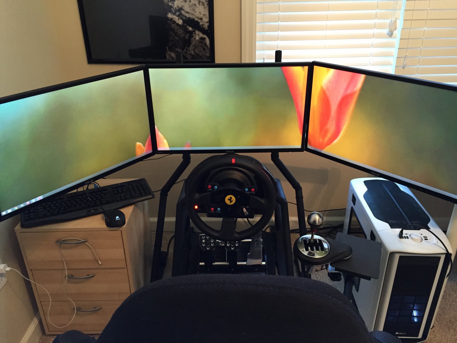

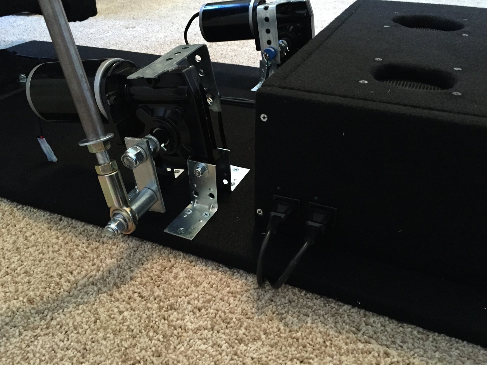

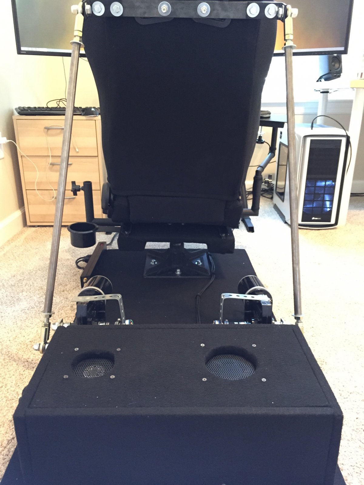

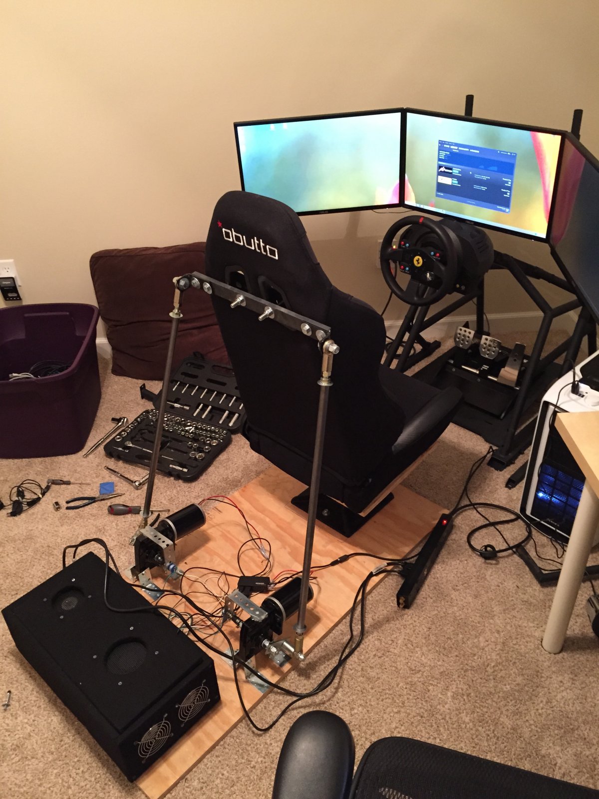

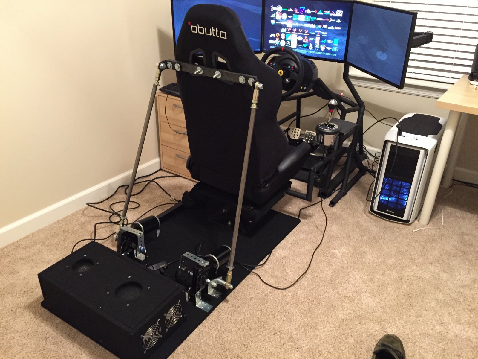

    IMG_0312.jpg All right Below is the rest of the pictures I took, as well as a quick (very raw) video i took before I had all of the wires hidden, settings tweaked etc. I'll be posting a better video in the near future. I will post the time lapse of the build when i get home from work today
    Total cost to convert static rig to 2dof was $709.65. This included several tools, bits, etc as well though. Closer to $620 just for hardware itself.
    If you want to see anymore pictures or have any questions just let me know!

    Thanks everyone, to answer a few of your questions:
    @bosmeck I indeed was in Germany with the 70's Ferrari 312T. Love that car on that track. As for going from static to 2dof i kinda of already knew what to expect for the most part since my brother just converted his Ozone to a 2dof rig and i used the same core parts (Motors, JRKs, Power supplies). As for going to 2dof and having several hours in it now, i'm sure everyone else that has done so will agree, you wonder how you ever raced without it. For example I can't play F1 2014 anymore until a plugin for it comes out because it just feels dull. Definitely worth the time and money (esp if you enjoy designing and building stuff as I do).

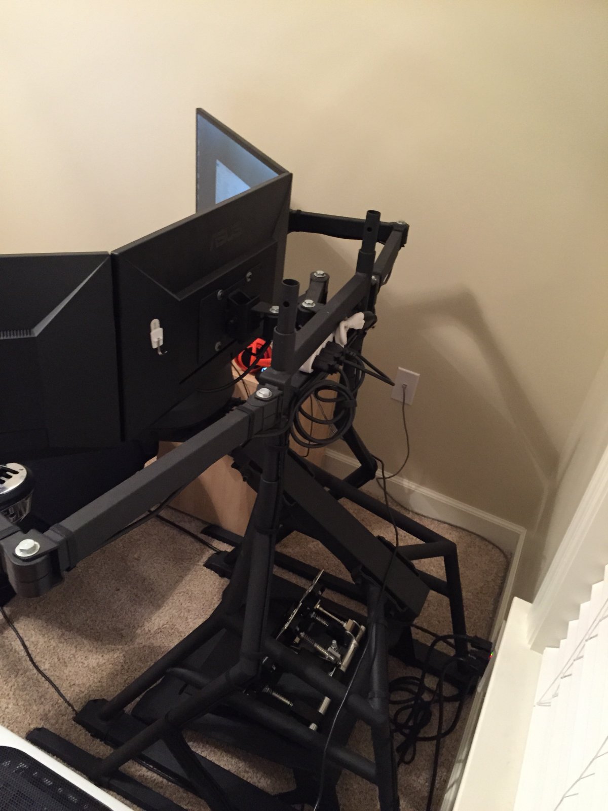

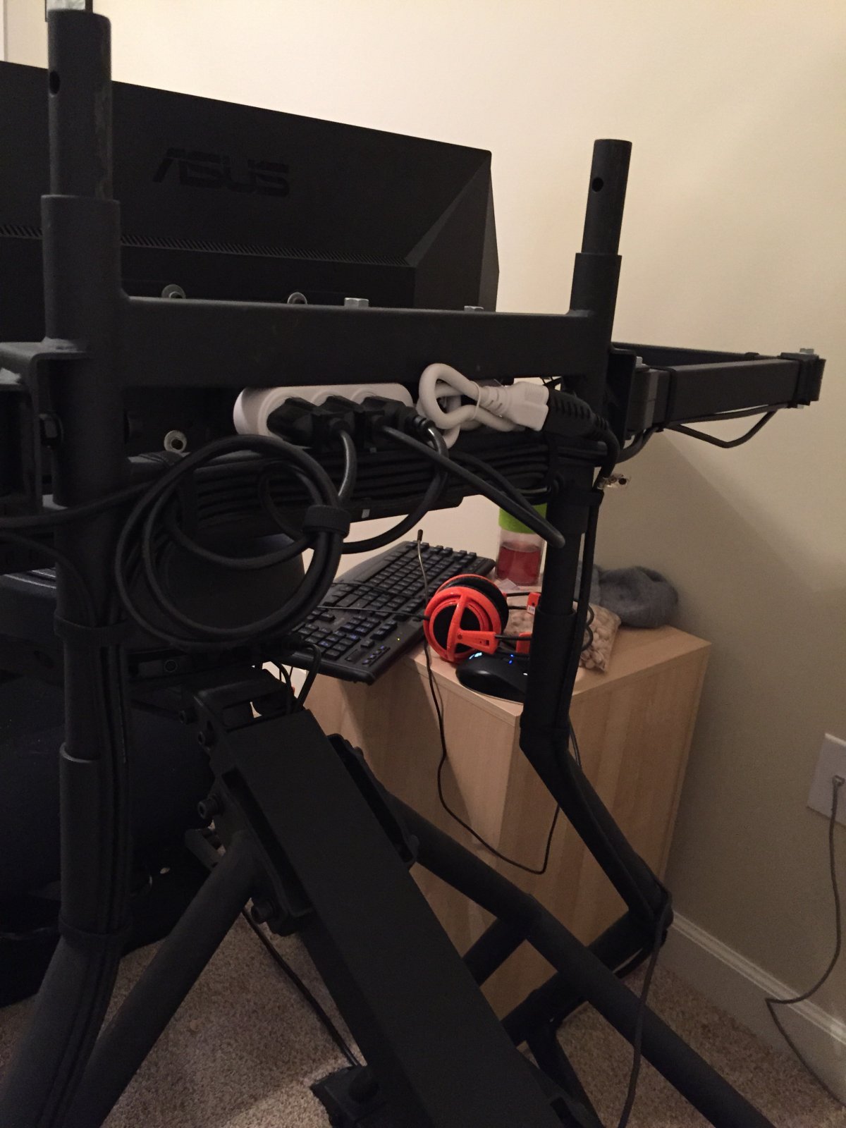

    @Nick Moxley that is crazy, I left work early the second my Revolution came to try her out. As for finding other mods i'm already in the market to add 3dof..your video has got me seeing how well it compliments the 2d0f and makes the whole experience just that much better. I attached a picture with a tape measure of the the feet so you can get a idea of what the width of the wheel/pedal frame is and the monitor stand is. If you cant read it well the monitors are 30" apart from outside to outside. I also attached pictures of the back of mine to give you a little idea of what i plan on doing to get to 3dof...I am either going to mount the monitor mount to a wall or a wider stand since the legs for the stand come off individually (the mount acutally doesn't even get bolted to the legs its just the weight holding it where it is) and then mounting everything else onto a platform. Hope that helps if you have any other questions or I didn't answer that right just let me know
