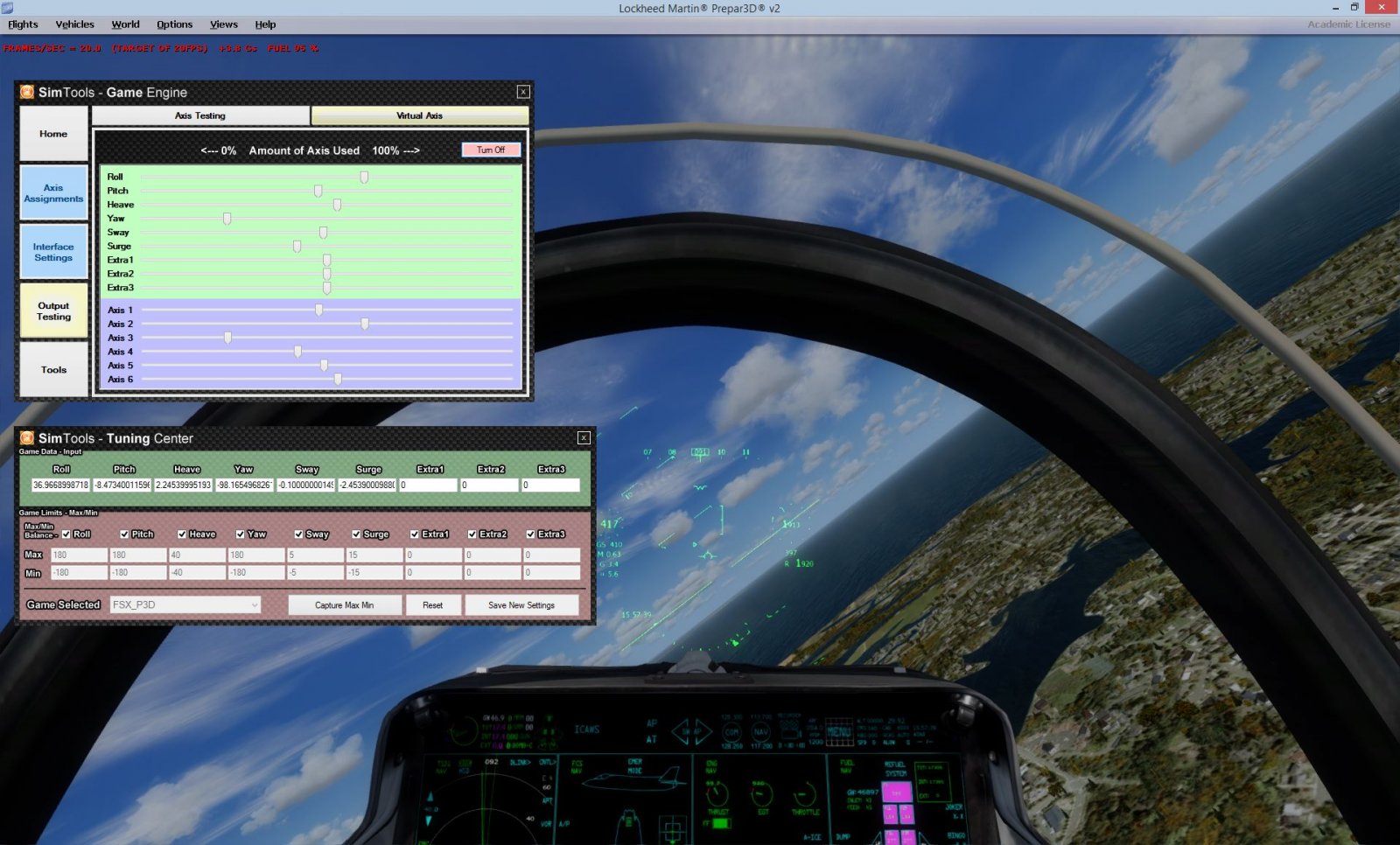

    Thanks so much @value1, you are indeed a wizard and I can't express how grateful I am for you figuring that out...so simple, accept the licenses, but so difficult to know from the error.[​IMG]
    Now to rebuild Prepar3D with all my tweaks and then do a motion profile. My father can then knock himself out in the VR replication of his actual student pilot training, flying the Jabiru out of Launceston airport. Dad thought is was great before, it will be a whole other level once motion is added and refined.

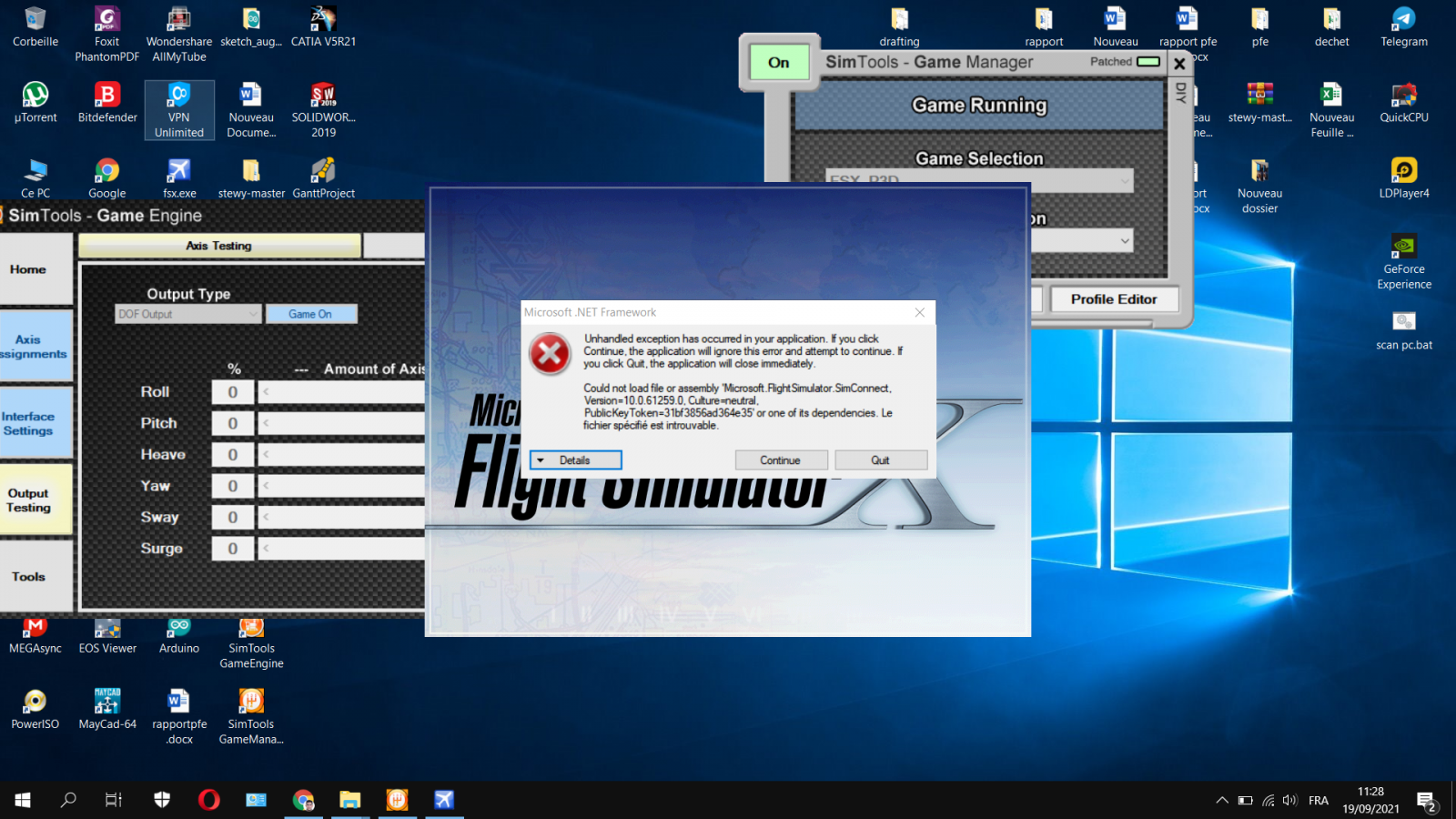

    I have FSX and only the application SimConnect_UDP.exe in the installation directory. Is it equivazlent to the .msi?
    When i run it a have a nover capacity error... any solution?
  5. YOUNESSJDR
    YOUNESSJDR New Member
    Apr 19, 2021
    3Coins
    is there a solution to this problem
