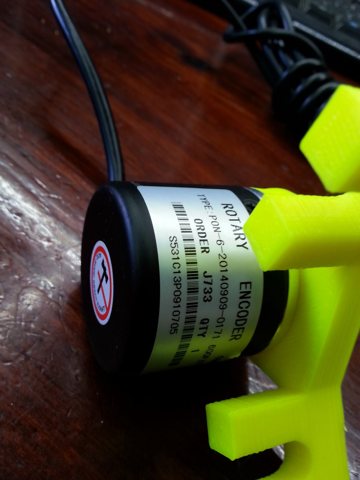

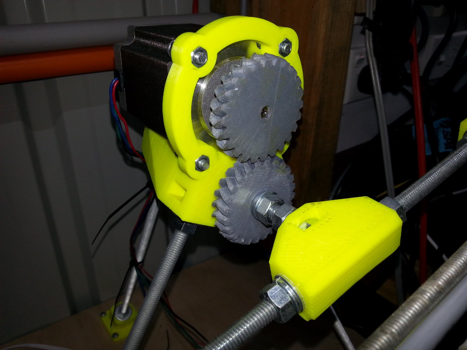

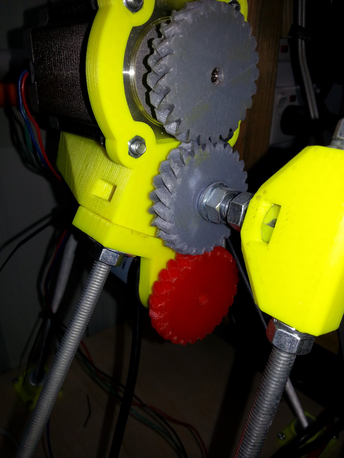

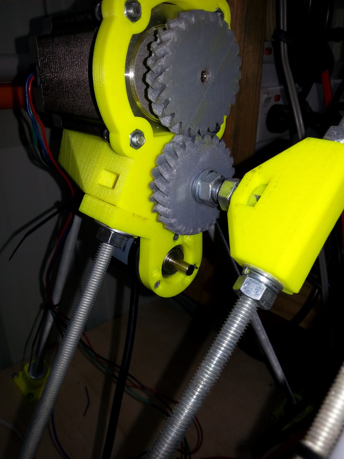

    Another update.
    I have managed to rewrite the arduino code so that it is modular and it now includes a comms module that works well with simtools (borrowed from here: http://www.xsimulator.net/community/marketplace/communicating-with-an-arduino-and-sim-tools.97/, written by @eaorobbie cheers). I still need to add in the code for the encoder as the tracking drifts quite a bit when being used with the game. But at least an encoder is mounted and attached, so that's half the battle. Ideally I would have attached the encoder to the shaft of the motor directly, but I don't have the option in this case, I expect the full scale to be different.
    20141116_145300.jpg 20141118_183541.jpg 20141118_183617.jpg 20141118_183727.jpg
    I also need another encoder inside the inner rig (for the roll motor), but for now this is a proof of concept (to myself mostly) and a way to test code without a massive cost upfront.
