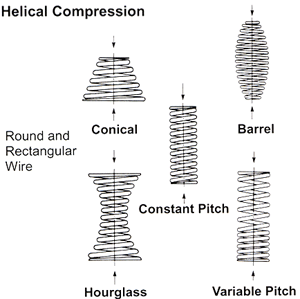

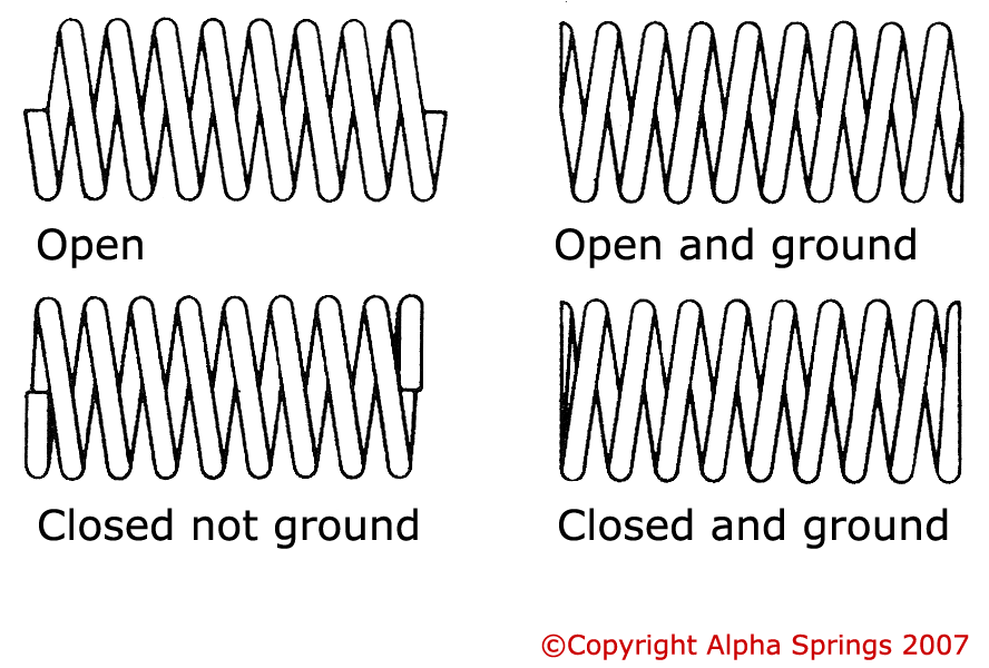

    Hello every one ... My big friend Tom ... sorry I was out if town for a while ... I have something to add to this fantastic thread .
    To be specific in choosing/manufacturing the spring to be used ... I've been previously searching about springs spics/force curves for @prilad to make his simulator ... and found that a Compression spring with constant pitch closed and ground end type is what commonly used for this case .
    In Wikipedia it states many kinds of various materials of it and states the conditions for each use ...
    here is another Spring-I-pedia for calculating any spring parameters .
    compression_ends_diagram.gif Vulcan-Chart-resized-600.jpg.png compression_springs(bjt042).gif

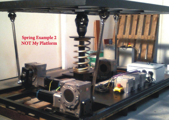

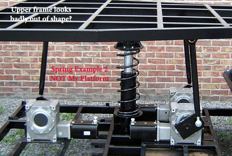

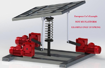

    FYI - To all - above are some of the examples only of what I've seen in platforms and the ones that use springs for extra support -
    The first pic to the left - to me, it looks like the frame is bent and distorted ??? - the center pic is a professional one.

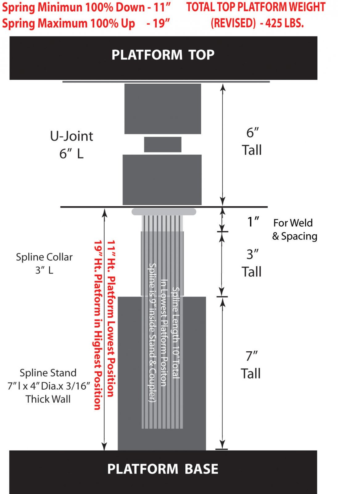

    Hopefully, the attached thumbnail shows the final measurements and information to build my spline shaft pipe, spline collar, etc., with the measurements required for an assist spring.
    You will notice the space with platform 100% down = 11" and with the platform 100% up = 19" - Total up down movement +- 4".
    I have revised the total platform weight, with rider and rSeat, speakers, etc. My first computation was 350-375 lbs., but "me" forgot to add the top steel platform and platform MDF weight...
    (eaorobbie - I know you feel a spring is not necessary with my 117 ft.lbs ea x 3 gearheads - but with the "extra weight" - do you still feel the same way?)
    Fellows, you've kept me on track so far and at this point of the build, I think you all would be proud of what "we" have accomplished.
    Please look at the pic and see if I'm OK / or / about to crash and burn!
    Have a blessed one my friends,
    Tom

    Hi Tom. Just thought I’d throw in my two cents even though I haven’t experimented using springs myself. There are two reasons to use springs. One is that you don’t have the required power without it and you must have the boost. Two is a spring helps provide a more equal force in going up and down. When I said earlier that the PID must work harder without a spring, I was saying that the motors have to work harder (PID timing actually always stays the same regardless of the load). The harder the motors are working to keep up, the worse the motion will be compared to the actual data.
    Since you have the power you need already, you don’t really need a spring for this purpose. This spring would have to be made just right for your rigs weight and throw. But any spring that you add that can remove even some of the weight off of the motors, the faster they should react unless your spring reaches full compression before the levers full throw finishes. So this spring should not need to be near as critical in its specifications. Again, a long as it doesn’t ever reach full compression with your load and throw, you should never be fighting a static spring pressure. I hope this makes some since. You should then be able to ease back on your PID settings. This should take some wear and tear off of the motors and gearboxes as you desire also!

    1. Even with my more accurate top platform weight, loaded, of 425 lbs. - my motors/gearheads can still more than handle the weight??
    2. To "me" - It makes sense to ease the burden and weight on motors/gearheads, longer lasting and quicker response?
    3. My motors/gearheads can take it, but the spring will help ease burden and make response faster?
    4. Speedys' thread from yesterday states I would need a : constant pitch closed and ground end type spring.
    5. DOES my diagram of spine, spline shaft, etc., look to be acceptable in your eyes??
    If ALL looks well to you and the others, then I'll build my spline assembly to my diagram specs. After that, it's to ask the spring manufacturer the RIGHT questions, give them the RIGHT data,
    and go from there?"
    Thanks for your continued responses and information. As stated earlier, and with the bug grandkids passed on - I have felt like a semi-truck has hit me - just lousy, but this thread sure is up-lifting. Thanks.
    Have a most blessed one,
    Tom

    The spring speedy recommends would be your ideal spring (requires no power when at center position). But again, probably very difficult to get one that’s tuned in just right unless you get lucky. And while the numbers still say you have enough power I am skeptical about math when it comes to motors. And if you end up only running at 70% efficiency, you are already below 500 lbs. What I would do is not sweat attempting to get the perfect spring just yet. I would look around for a salvage spring (cheap) that would compress to your bottom position of your platform under its own weight with a driver on it and that will still have some decompression left at the top position hopefully. This spring is not attempting to be in balance when the platform is at its center position. It is simply assisting in lifting the weight. It probably wont be of much help as the platform nears its top position, but it can’t be worse than no spring at all the way I see it. And the tuned spring would only be in tune for a narrow range of driver weight. If you weight 25-30 lbs more than your grandsons, you would probably need to add additional weight to the platform when they are on it. But if it doesn’t work out in the end, you can go ahead a try a custom spring. Put me down for 2 more cents.

    What about making the tension on the center spring adjustable?
    Then you could set the correct tension later.
    Exaggerated Picture to show what I mean.
    Just use 1 or more spacers or make different thicknesses of them.
    Then you can build it without worries of having to change it later.

    yobuddy - hi friend - that's an interesting idea - and a good one - IF I use the springs that speedy and blazinh have suggested (constant pitch), it would be a nightmare to put a spacer "under the cup" at bottom -
    with the filled weight of the top platform (of course, less rider) - at this point I don't know how I would raise the bottom spring cup???? Any ideas....
    I tell you what, IF they still make an air-bladder for springs, like in the old days before air shocks, it would fit around spline pipe and inside of coil spring - they have an air valve just like a car tire and
    you could adjust for weaker or stronger spring.....geeze - I'm going to go and see if they still exist.
    The ideas are just getting better and better - Guys, don't let this go until we've reached a perfect solution - yobuddy - see what you started with another good thought!
    Thanks so much friends,
    Tom

    I think this would be easier and cheaper?
    Use 4 threaded rods in the corners of base sticking upward.
    Thread nuts onto the 4 threaded rods.
    Tighten or loosen the nuts accordingly.
    (Id use 2 nuts on each rod, then tighten them together to lock them into place)

    Of course you could reverse the process too.
    And put the bolts thru the plate lifting the spring, and tighten the nuts down against the bottom of the unit.
    as it would cause the springs lifting plate to raise.
    I hope that makes sense?

    The ol' "Keep it Simple, Stupid" sure applies here. To me, this is a perfect solution. I can spot weld 4 bolts, one in each corner, using 1/2" threaded rod, put a nut "below" the base plate of spring for lifting - put 2 nuts on each rod, with lock washer, above spring base plate and I'm home free. Will use 3" long threaded rod.
    Thanks so very much for a very simple solution.

    Hi guys ... So far so good Tom ... Yes @yobuddy it's nice and very simple solution but hard to tune every time you switch players ... I may suggest that the simplest solution for this is to add a balancing weight "sandbags like in the big air balloons" in the platform center under the kid's feet [BTW ... what is his name Tom ? ] equal to the deference between players weight adult/kids ... so when Tom's grand kid grow up sandbags will not be needed any more ... correct me if I'm wrong or use other solution if you're not familiar with this Tom .
    What do you say about Elevators which uses fixed counter weights to balance the passengers load which is considered a load fraction to motors and VFD's ... the hardest part is where the elevator is empty moving .
    We had a small problem facing the long term wear and tear for the gearboxes and motors coefficient that is solved simply by adding this custom made spring ... "the blue curve " not the negative purple nor the positive green ... that spring may/not cost Tom some more in fabrication but a lot easier and perfect solution ...
    I guess Tom should share this experience/resources for who wants to do the same ... as I can't just read , search and buy a spring ... and to test it's performance How ? and with what ? ... that's why errors for some other sim builders came from ... and for not using a spring at all a Big mistake choice .
