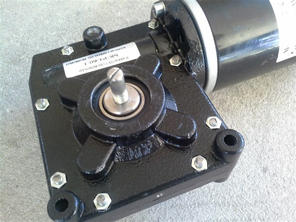

    WORM MOTORS ARRIVED!!!
    Not that exciting as I can't actually do anything with them yet. :(
    Waiting on the JRK's and other parts to arrive. :)

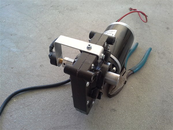

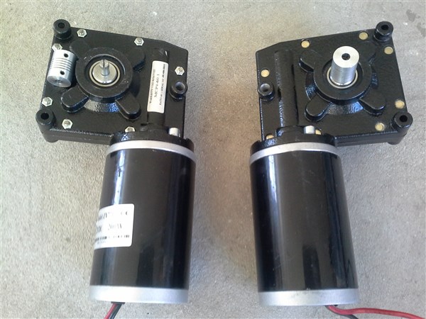

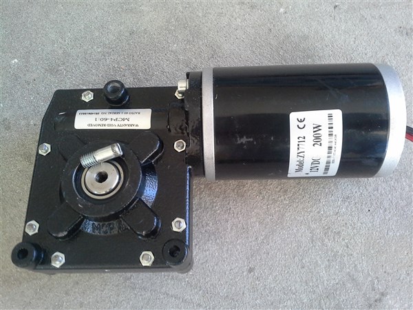

    Sorry to be a pain @noorbeast - Do you have a photo of how you mount them to you motors? I read they don't like direct connect to the motors and need a flex coupler to prolong life ?!
    21,234
    149,078Coins
    +10,928 / 54 / -2
    Sure.
    On the solid shaft gearboxes I drilled and tapped an M8 hole, made a screw in shaft from an M8 bolt, then used a flexible coupling to attach it to the pot, which is held by a light aluminium bracket.
    I drilled some locating holes for the flexible coupling grub screws after I had done the initial set up and testing, as I can't move the 60:1 lever by hand and instead loosened the flexible coupling to do the calibration of the JRKs. So the grub screw holes were drilled once I knew the final position.

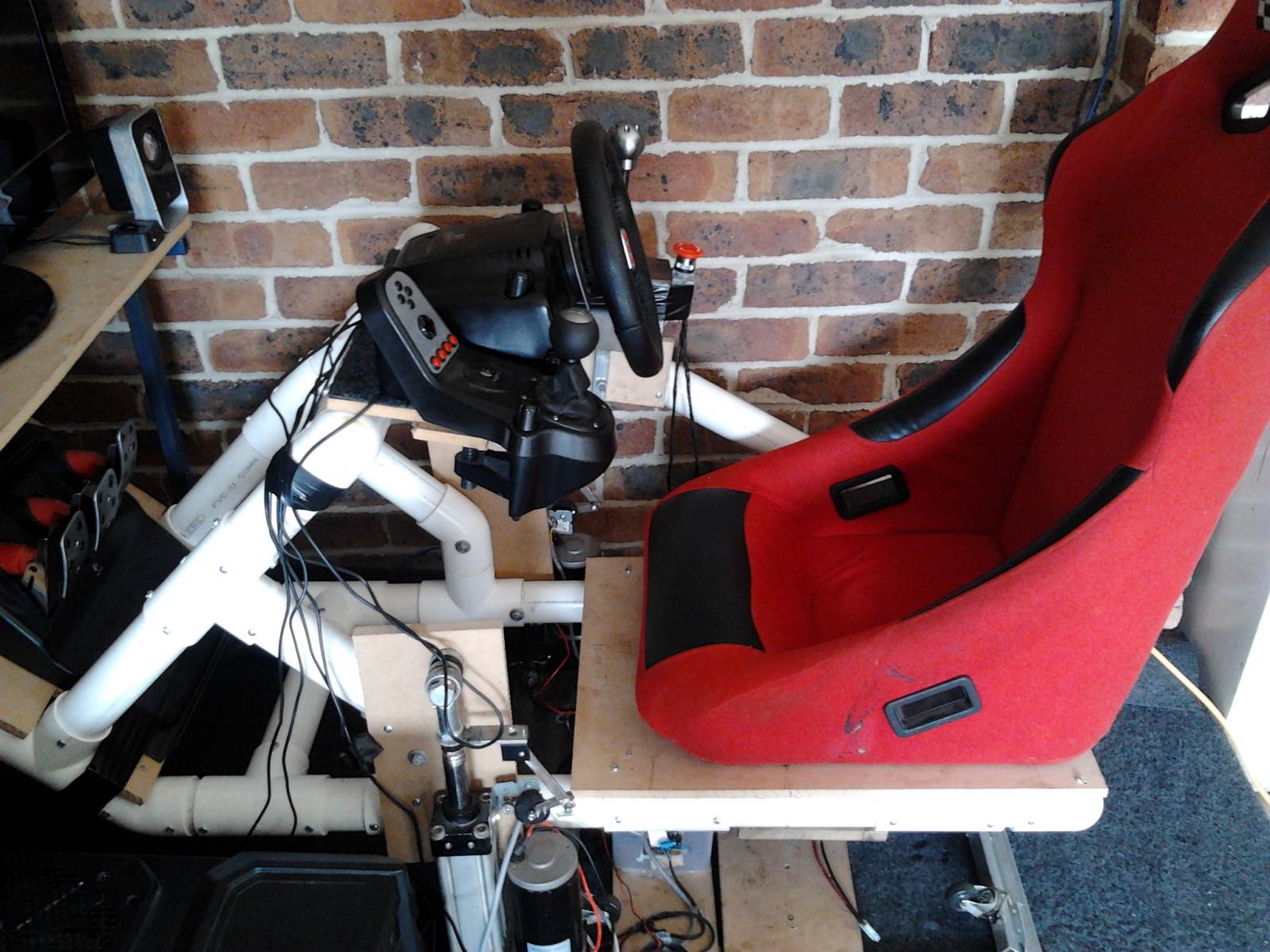

    You need to find the COG by putting the frame, yourself, controls and anything else that makes up the sim on something round, like a metal tube or broom handle and have a mate roll you back and forward until you determine the COG.
    A foot pedal extension will affect where the COG, so keep that in mind for its design and determining the COG. I have an adjustable post to compensate between different controller modes, as the difference in COG is significant: http://www.xsimulator.net/community/threads/dx-racer-compact-simulator.5866/page-8#post-67648

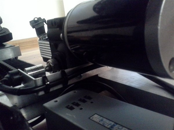

    Actually I just realised that you have 25:1, which will be hollow shaft, so just use a threaded rod through the shaft and appropriate flexible couplings to connect the pot to the threaded rod: http://www.ebay.com.au/itm/CNC-6-35...1626228033?pt=AU_Hardware&hash=item3cea236d41
    On the 25:1 I used a bracket mounted to the existing spare holes are the rear of the gearbox for mounting the pots, which is easy.

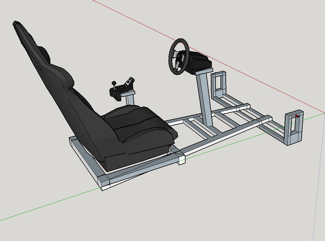

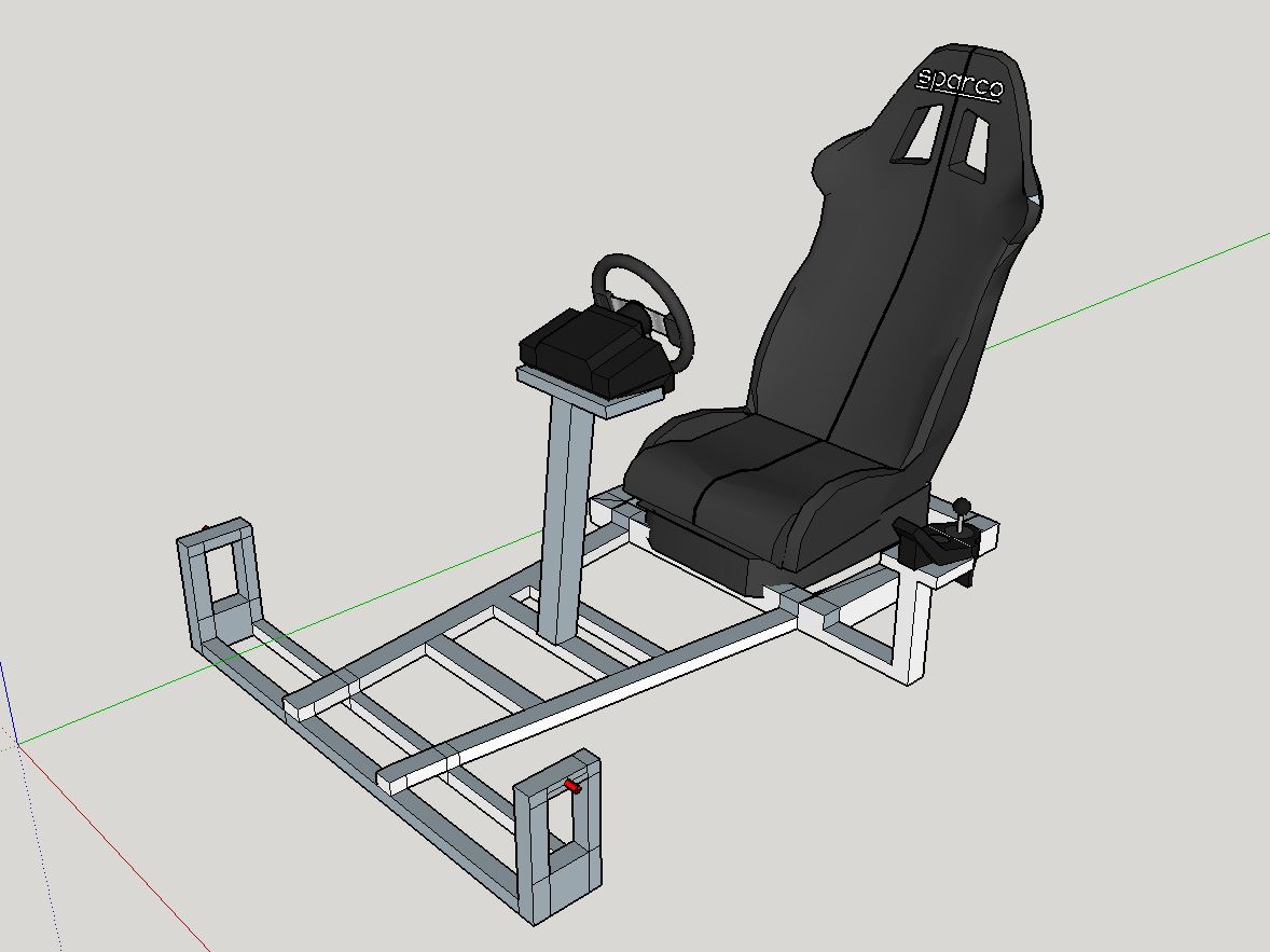

    Started the build in earnest today after watching about 5 hours of "How to (and not to) MIG weld"
    After chatting with the boy (7 year old driver wannabe) we decided on a foot motor mount sim. Yeah... Yeah.. I know, changing my mind again,
    but I can't shake the design I have in my head, so I will stick with that first spark :)

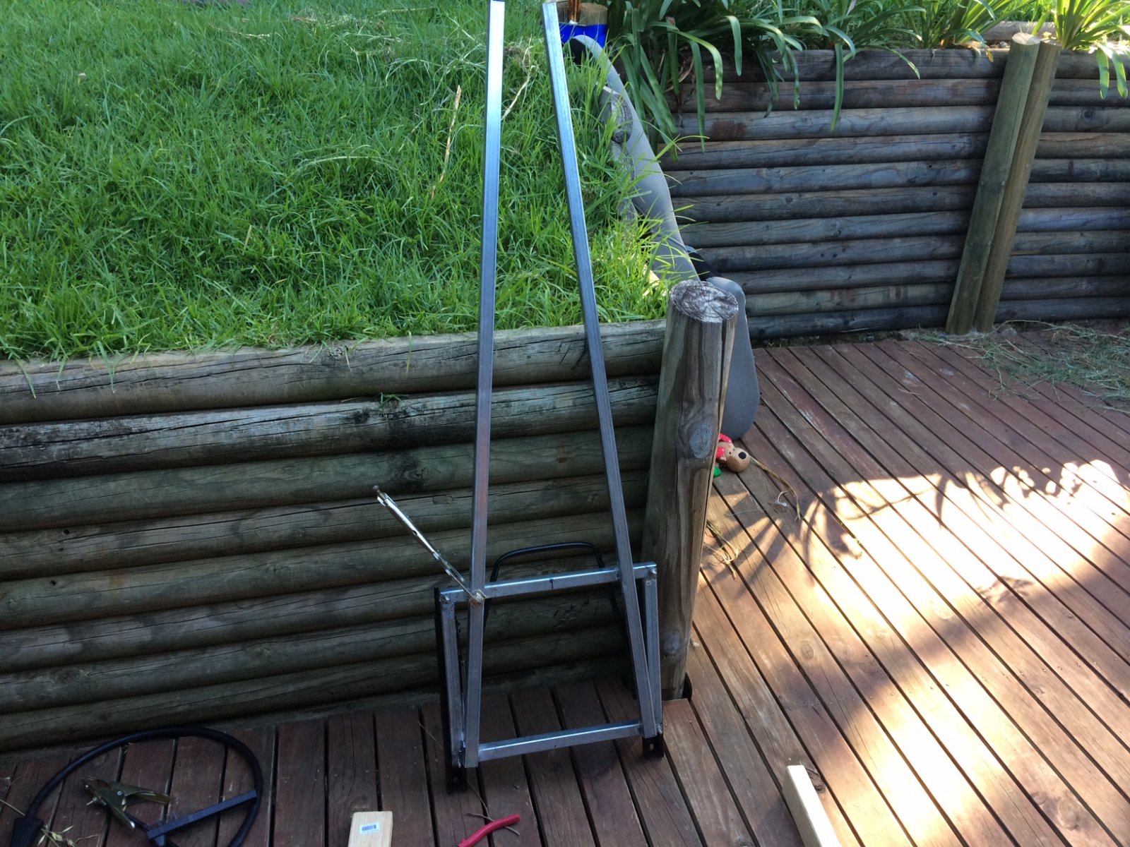

    Today, I welded and mounted the start of the frame to the racing seat slide rails. Tomorrow, I hope to complete the frame.
    Few pics:
    Rig Concept: (not to scale)
    Front side:
    And so it begins....
    The make shift workshop...
    The completed seat mount and centre frame (yes.. welded..then beat the crap out of it with a hammer to test the strength and so far so good!)
