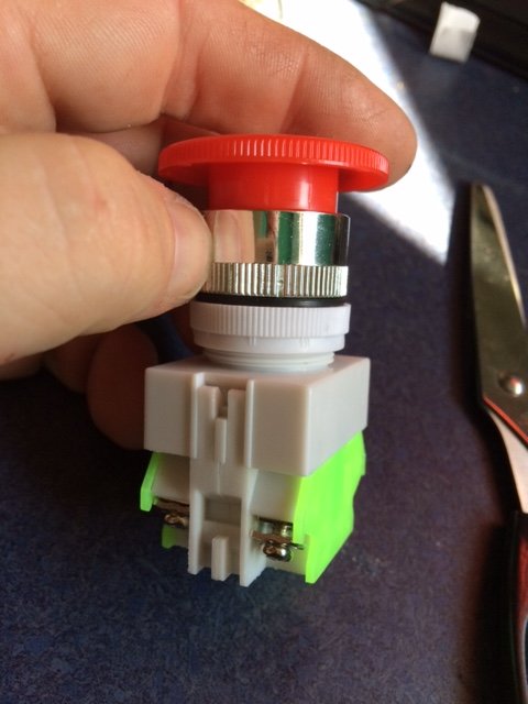

    Quick question around electrics. I am using two HP 600DPS Power supplies and I want to wire an Emergency Mushroom button into the circuit to cut the power to the JRK (and therefore the motors).
    With two separate circuits for power, how do I wire it to have one Emergency switch rather than one per circuit?
    I fully understand how to do it for one circuit, it's easy, but for two it has me flumoxed :)
    The switch will be mounted on the side of the seat. The PSU's are mounted at the front of my sim, about 50cm from PSU to seat. I want to avoid running thick gauge wire down the frame, so maybe a relay is needed as well??
    EDIT: the current Mushroom switch I have is NC/NO type with a single circuit. Assume to do what I want I would need a Mushroom switch with at least DPST?

    Thanks @noorbeast - That is the diagram I used as a base, however that is for a Single Power Source into two JRK's.
    Mine is one 12v feed per JRK.
    Think I've solved it anyway. Thank you :)

    Might require a different Kill switch but this is how i did mine seeing as i have 3 psu's to kill.
    Each Contact block controls a PSU, and the 4th Block the orange one is for the LED light which turns off when i hit the switch or turns off when i kill the main power to the Supplies.
    Make sure you get the proper NC block to ensure when the switch is in the On position or Up that the circuit is being complete.
    Let me know if you need a link to this particular switch, Other's can be found with add on "blocks" I just wanted the LED light as well and this is the cheapest your going to find.

    I did just that @Nick Moxley , great minds and all that :)
    I bought two kill switches just incase, so I removed the NO side and replaced with the NC side.
    So now I can control two circuits off the same switch.
    This is the SPARE switch showing both green (NO) sides now - Will keep for spring spares etc.
    I used the AWG calculator and realised with a run of around 60CM on 30A wire I really had nothing to worry about so I dropped the relay idea.
    Kill switch works a treat now.

    I ran my Switch up near my wheel, and used some rather thin solid 8 wire cable a buddy gave me, so 3 pairs for the PSU's and 1 pair for the 12v for the LED.
