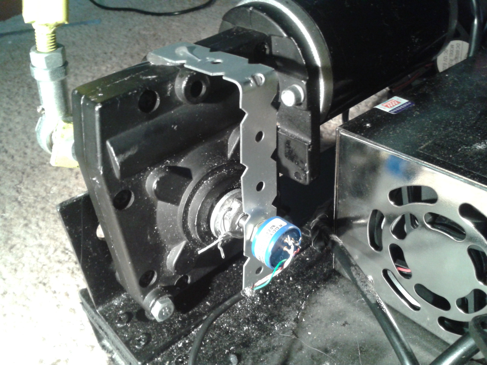

    Page 5 and 6 of my thread has some pics of my Levers and motor's, And for pot mounting go with something Directly on the shaft but incorporate "Flex couplers" to protect the Pot" motor's from Pgsaw should have a 1/2" or 12.7mm shaft, so you'll need the Appropriate Couplers. 1/2" to 6.35mm Links can all be provided when the time comes. My flex couplers can be seen on page 18

    Not sure how simple you want.
    You need a "sensor" in this case a Potentiometer mounted to "read" off the motor shaft or the controller will not know where to motor position is. It took me a bit of time in the beginning to understand this as well.
    @Nick Moxley , I think has more detailed photos of his set up.
    I drilled a hole into the back of the motor shaft the size of the pot shaft. In hindsight now I do not drill right through both, but enough to tap a small grub screw into the top part to tighten against the pot shaft so it holds steady.

    I could get away with using an average coupling for the pot shaft, right? But how would I add a threaded end to the other side of the gearbox where the lever eventually gets added on?
    Like in this picture that @Nick Moxley posted, what is the giant nut going on? And how is that attached the gearbox? I see a black coupling with a grub screw, is that really all it needs? So I could just use a normal coupling, put a grub screw through it and couple it with a threaded shaft?

  4. Nick Moxley
    17,055Coins
    +2,505 / 30 / -2
    The large Nuts "pinch" the Gear box but Aren't technically enough to prevent it from Turning when loaded or something goes wrong, The Grub screws are there to help with that, I have since gone on to Also Use a codder pin on the Tightening nut as you can see in my Flex coupler picture.
    The 2 Nuts have been Super squeezed together then Welded on the lever end....So i just slide the lever and main shaft as 1 through the motor, Add the tightening nut, Tighten, add codder pin to tightening nut, Add flex coupler, add pot. Done.

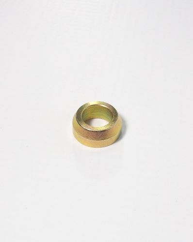

    If using rose joints then have conical spacers for maximum movement, or consider traditional tie rod ends: http://www.xsimulator.net/community/faq/heim-rose-joint-conical-spacers.72/

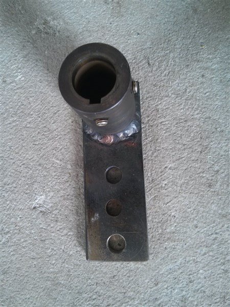

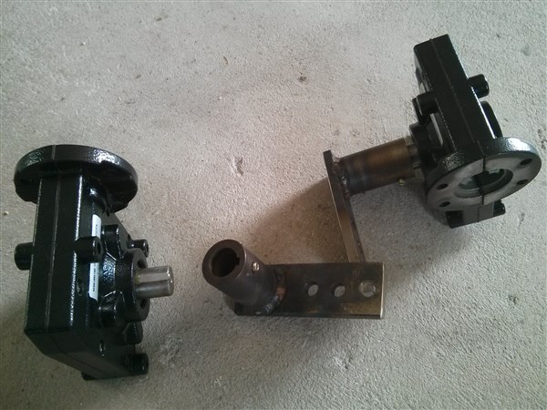

    If using solid shaft keyway gearbox's then levers can be constructed like this, held in place with 2 grub screws. Some use a bolt going all the way through the shaft but keep in mind that weakens it a little:

    Just so I am not confusing you there are different types of gearbox shafts, some are hollow and you can use a bolt through them and easily use welded nuts, as @Nick Moxley does, but other gearboxes have solid shafts, so you need to consider other options. In other words how you choose to mount the lever depends somewhat on the gearbox chosen.
