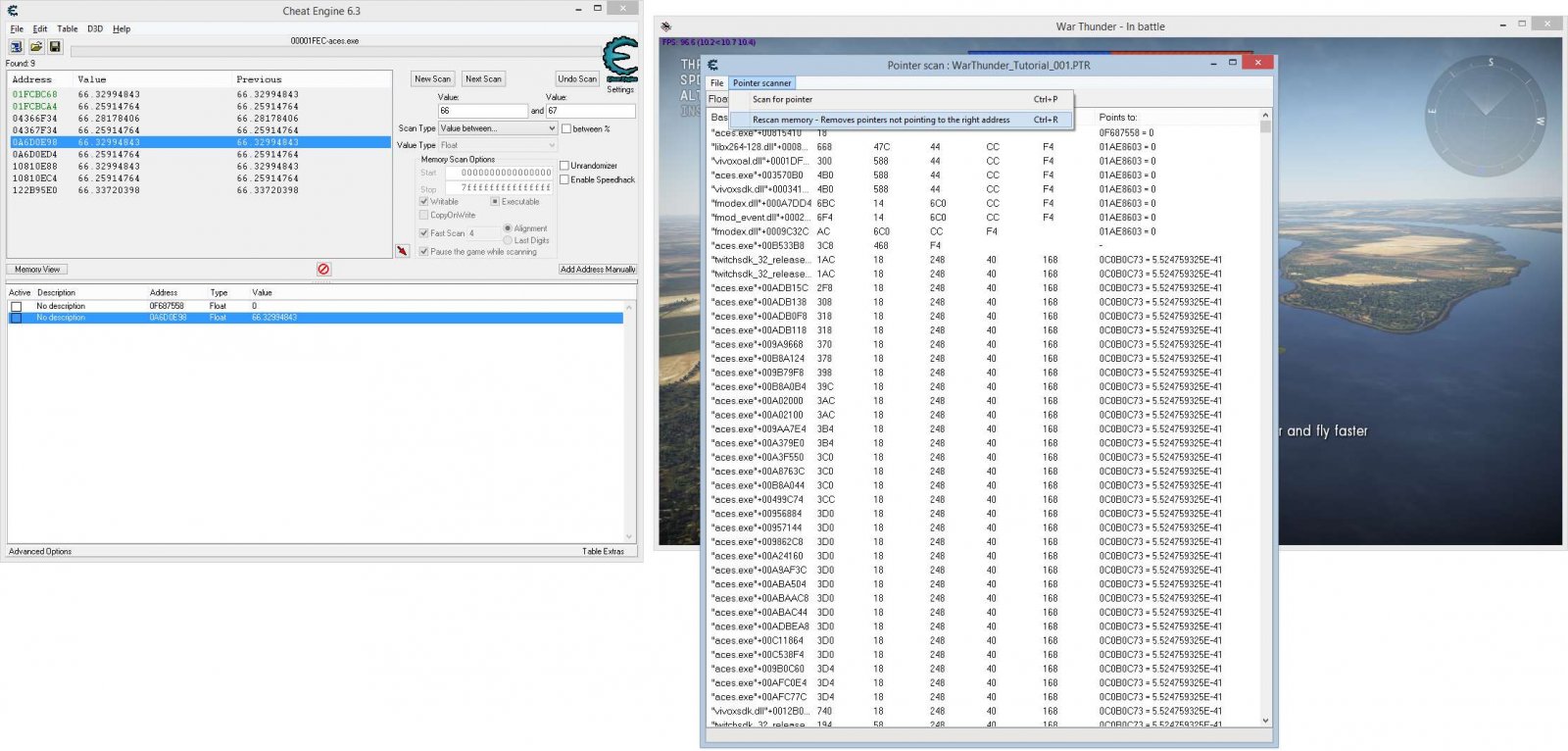

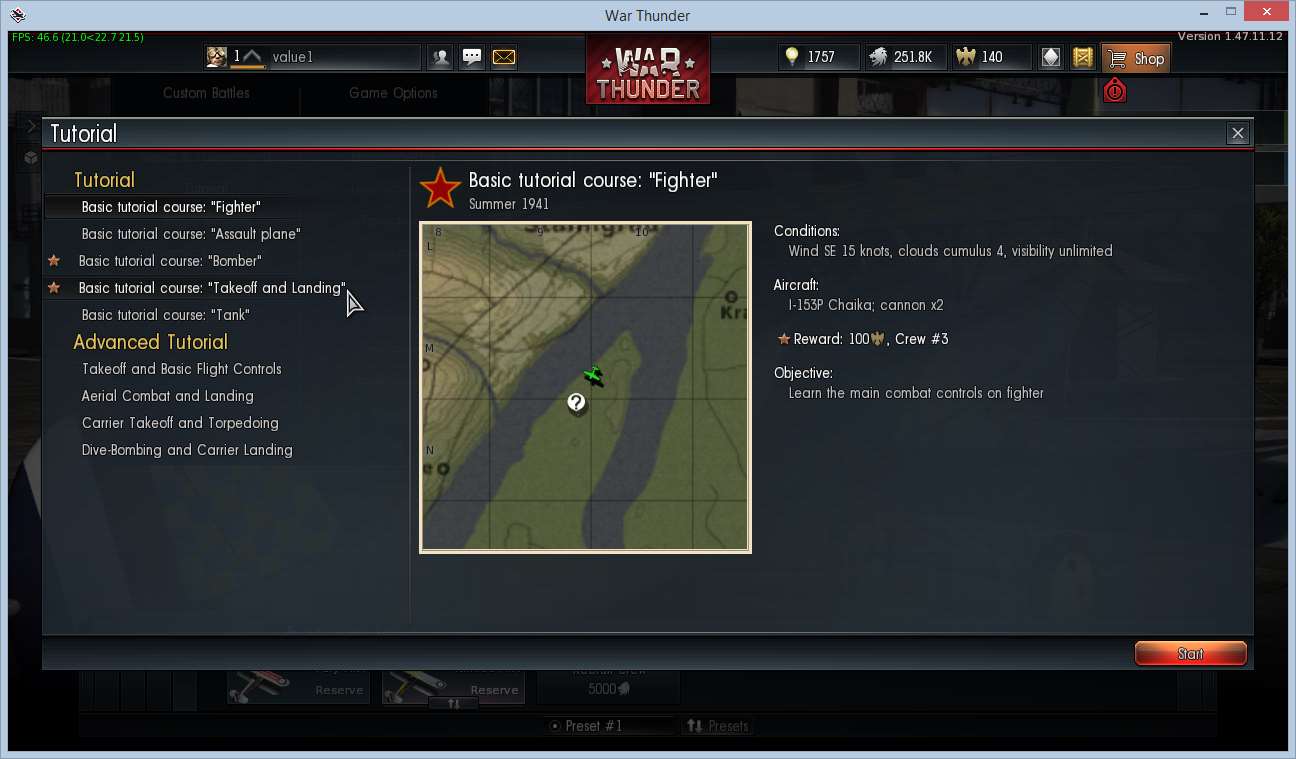

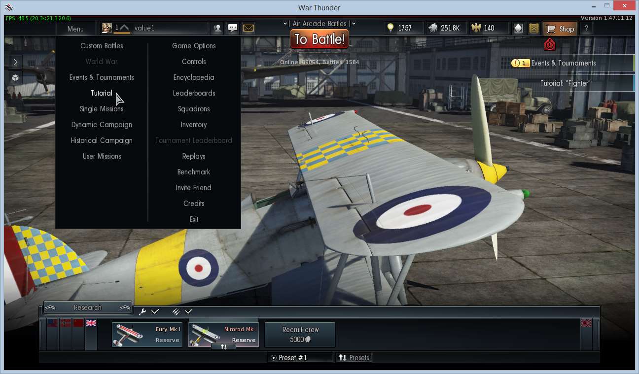

    Tutorial – How to tickle motion out of WarThunder

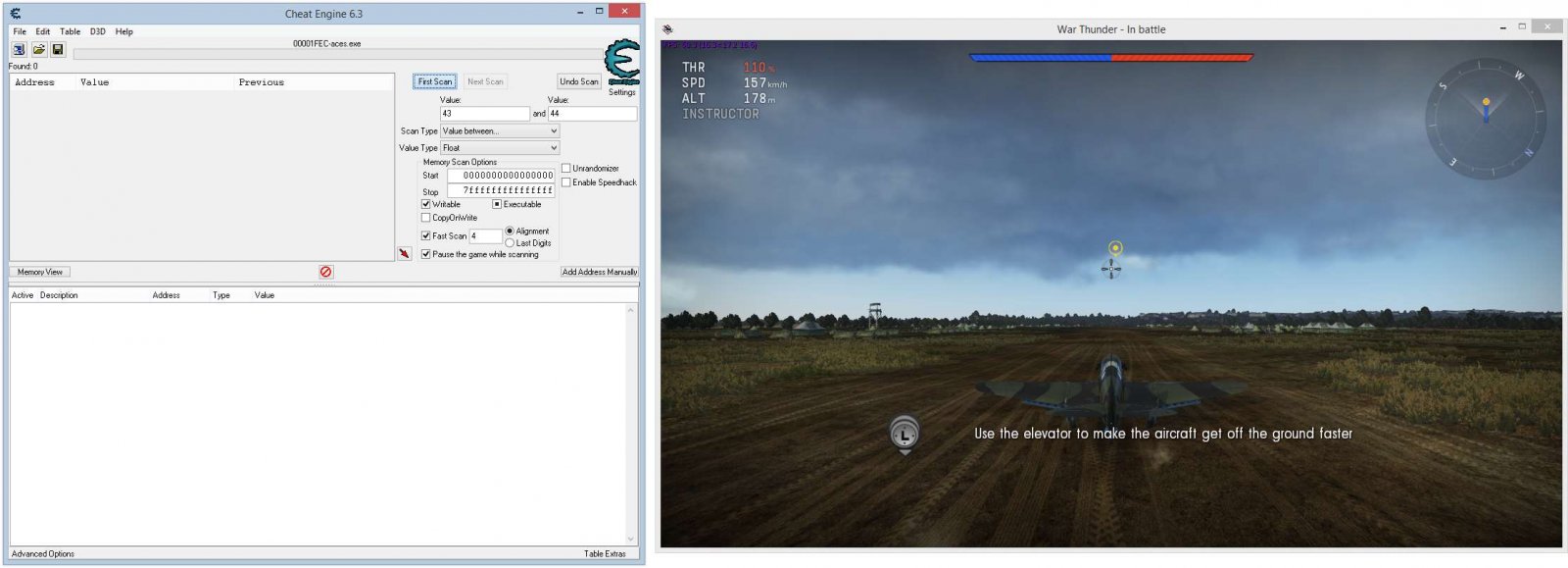

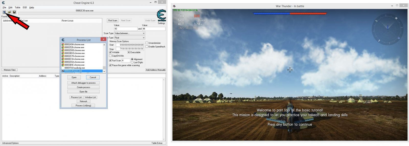

    Start Cheat Engine
    In WarThunder start the tutorial 'Basic Tutorial Course "Takeoff and Landing"'
    Connect now CheatEngine to WarThunder (aces.exe)
    Start the airplane until the program interrupts.

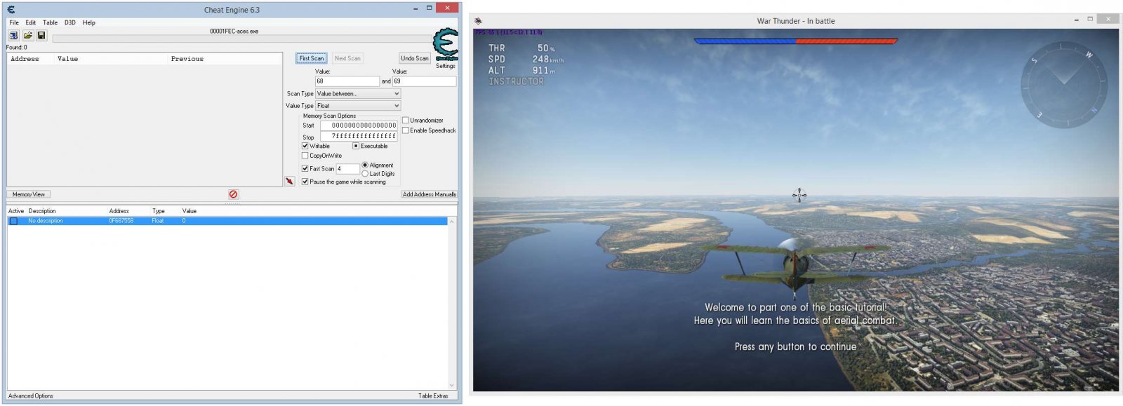

    Check the speed (157 km/h) and divide this value by 3.6.
    In our example this is 43.611 [m/s]. So in Cheat Engine we enter the search values 43 and 44.
    Do the first scan.

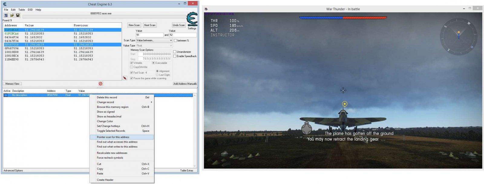

    Start the game again until it interrupts again to retract the landing gear.
    Check the speed again. In our example it's 185 km/h or 51.39 m/s.
    So in Cheat Engine we search a value between 51 and 52. Enter these values and click Next Scan.
    There will be a first green memory address and a few lines down a black memory address with the same value.
    Double click on the black address (0F687558 in our example).

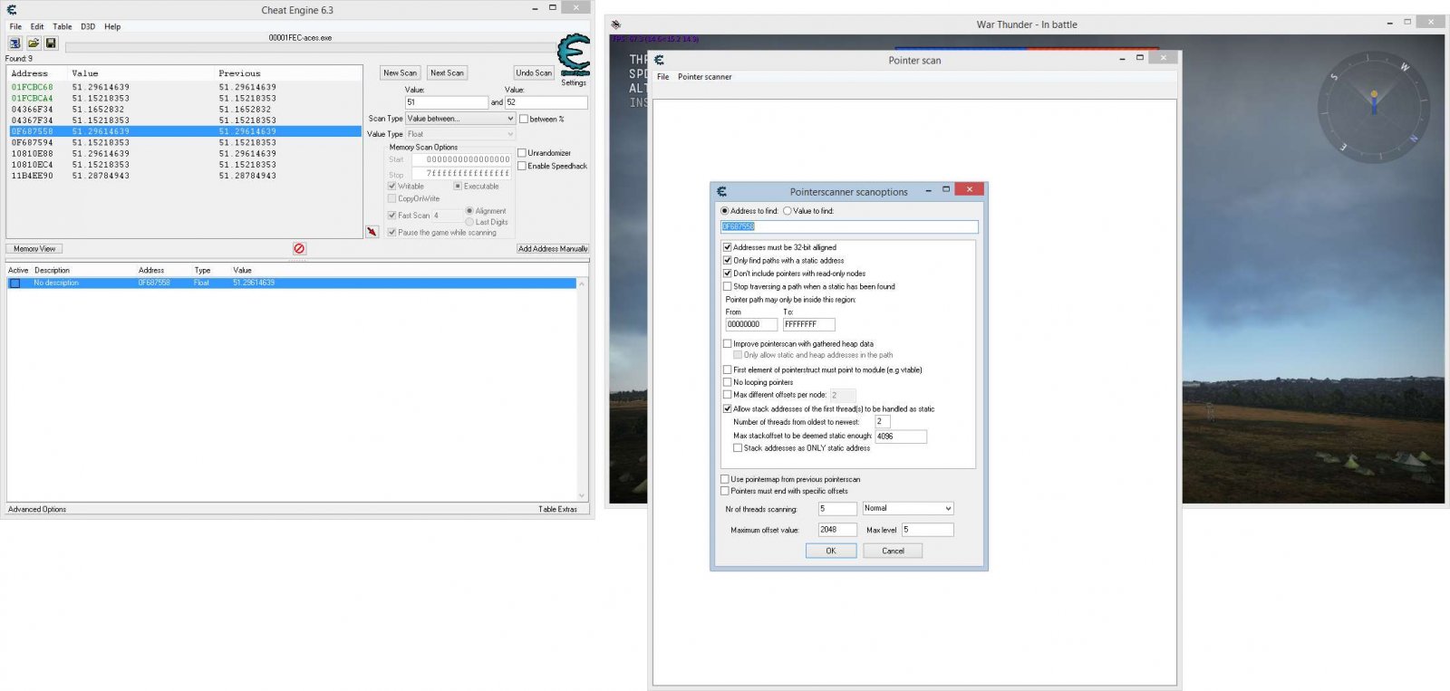

    In the Memory View window of Cheat Engine right-click on this line
    and select Pointer scan for this address

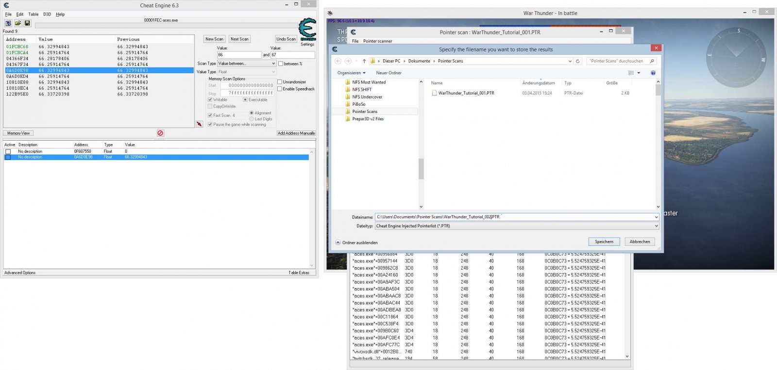

    You will be asked to store the scan somewhere. It doesn't matter where, really.
    The scan will take up to a few minutes and result in hundred thousands of pointers.
    Don't close the Pointer scan window. Leave it always open!

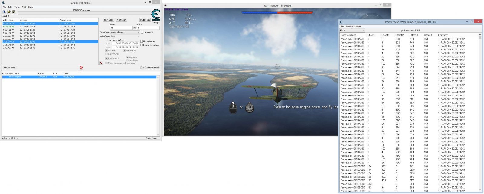

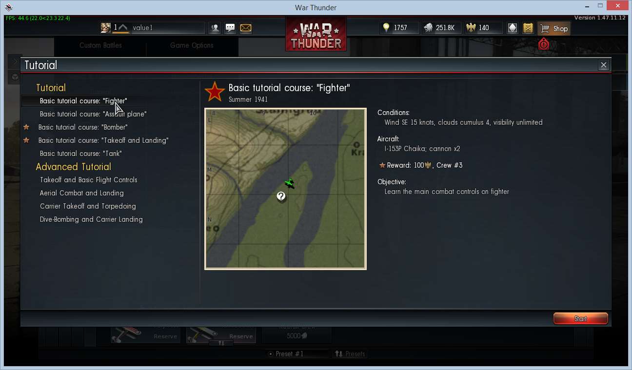

    In WarThunder leave the tutorial, go back to the hangar and start the tutorial 'Basic tutorial course "Fighter"'
    The game will immediately interrupt and you can scan for the speed value again:
    248 km/h = 68.9 m/s so you click New Scan, enter 68 - 69 and click First Scan.
    Continue with the game until it interrupts again and scan for the speed value (in our case between 66 and 67 m/s)
    Again, you will find a first green memory address and the same value a few lines down in a black memory address.

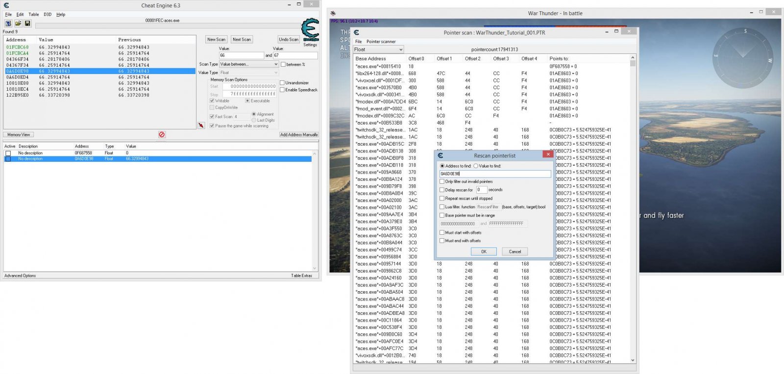

    Switch to the Pointer scan window and click on Pointer Scanner - Rescan memory
    Enter the address you just found now into the dialog box
    You'll be asked for a storage location of the pointer scan file
    Give this file a new name - just to be on the save side.
    This time there will only be a few thousand pointers left.

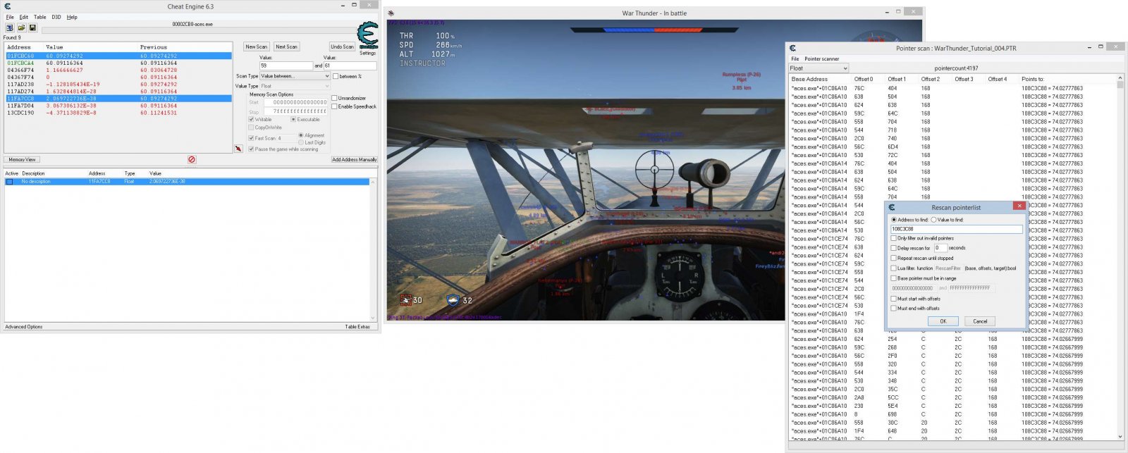

    Go back to the hangar and start a live battle.
    Because there will be only a few thousand pointers left, you will see which memory address is the right one in the Pointer scan window.
    So do a pointer re-scan for this address without scanning for values in Cheat Engine first:
    After the pointer scan click on Offset 3, which will sort the pointers.
    One of the first pointers - if not the first anyway - will have a structure like the first line in the picture above.
    Double-click on this pointer to copy it to the Memory View window of Cheat Engine. It should result in something like P->12345678

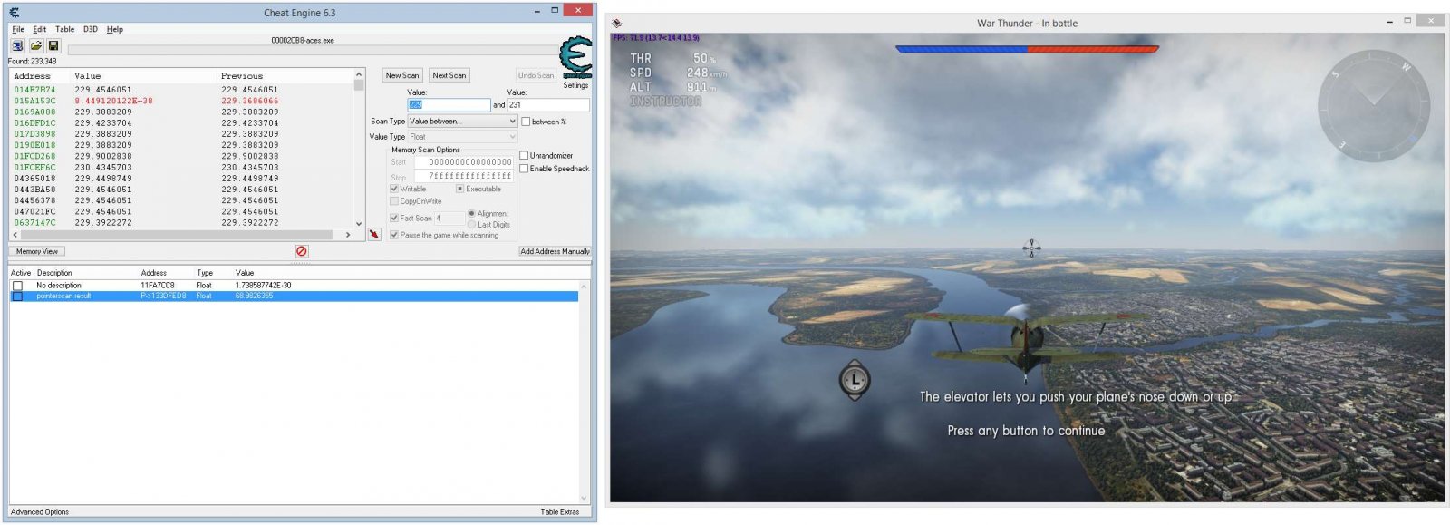

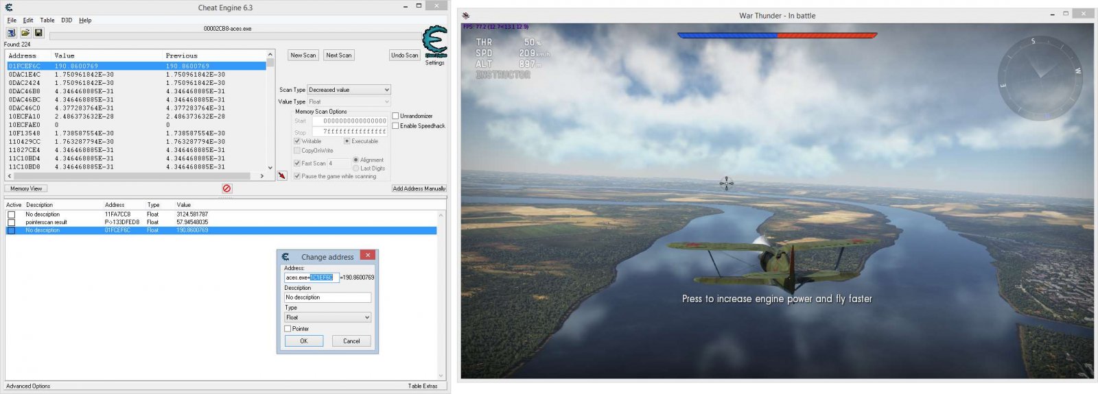

    Because the yaw/heading value has a different data structure we also must find the yaw value.
    Go back to the hangar and start the 'Basic tutorial course "Fighter"' again
    At the beginning the heading of the plane is always 230°. So press New Scan, select Float, Scan Type "Value between…" and enter the values 229 and 231.
    While the game is still in the first freeze, scan for the heading.
    Now continue the flight and change the course of the plane with the rudder anti-clockwise.
    The game will interrupt again, after you met the first target Target small.jpg .
    Now search for a "Decreased value" because the heading is between 0° and 360° in clockwises rotation.
    There will be a green memory address like in the picture above.
    Double click on this to copy it to the Memory view window.
    You can double-check if you really found the heading value by curving around an observing the behaviour of the heading value (clockwise turn = +, anti-clockwise turn = -, values from 0° and 360°)
    We're almost there.

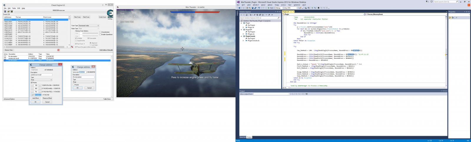

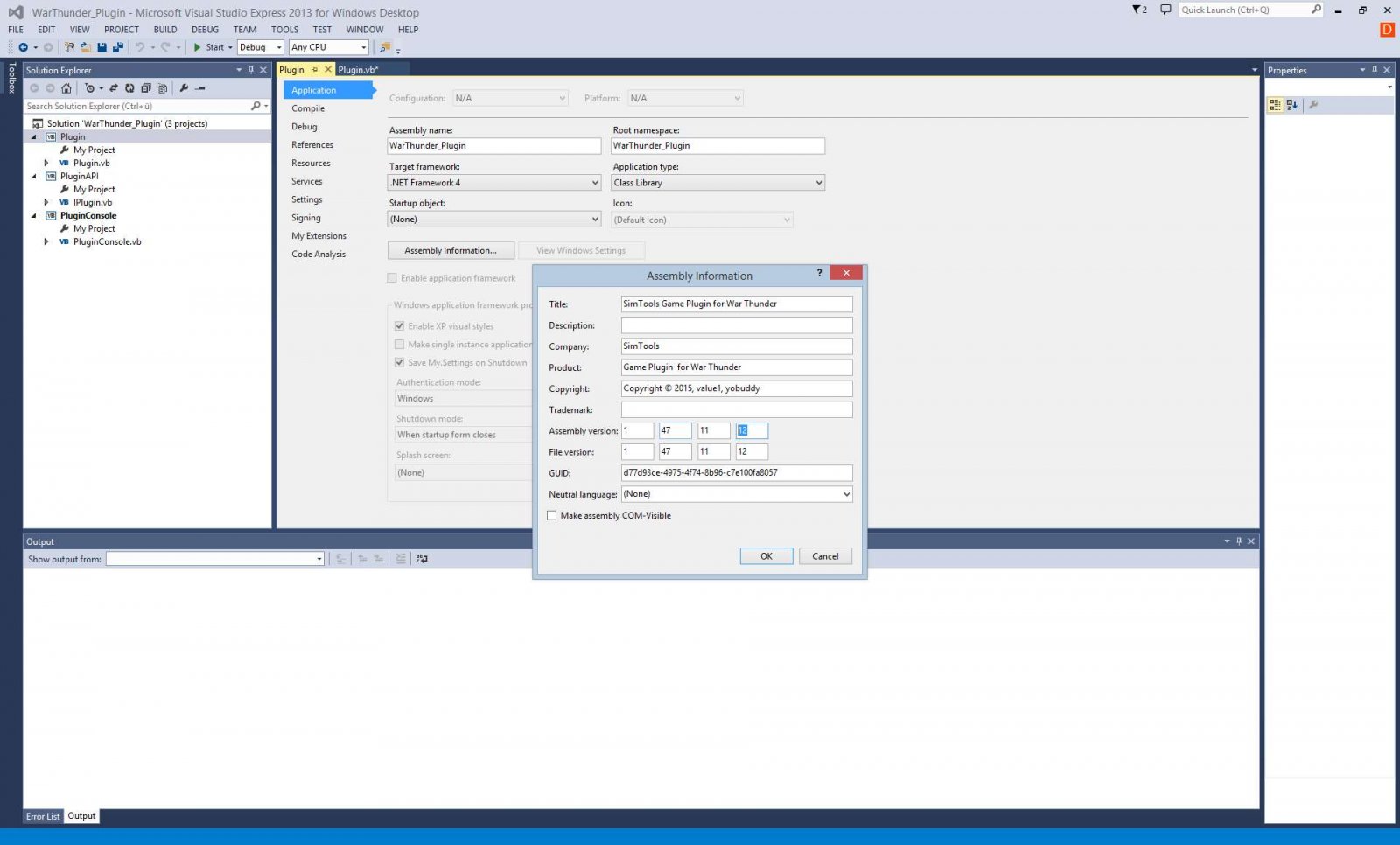

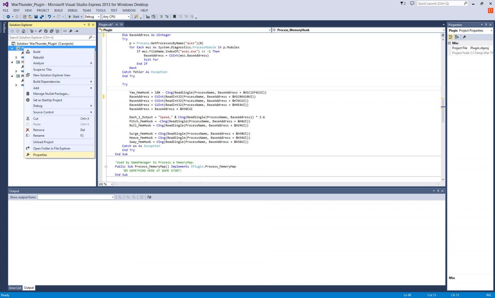

    Open now the WarThunder_Plugin.sln in Visual Studio Express 2013 for Windows Desktop.
    In the Memory View window double-clik on address of the heading and copy the hex number behind "aces.exe+" into the VisualBasic line Yaw_MemHook = as shown in the picture below.
    Do the same for the pointer structure for speed.
    Don't forget to increase the version number of your plugin under Assembly Information…

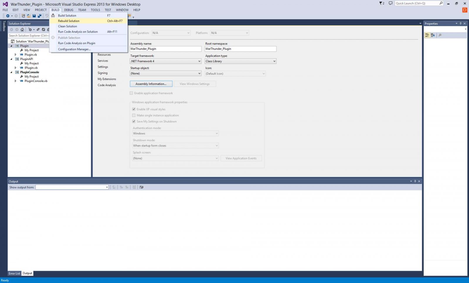

    And rebuild the plugin:
    You will find the plugin in
    …\War Thunder Plugin\AdditionPlugin\bin\Release\WarThunder_Plugin.dll
    Copy this file the the WarThunder_Plugin.zip which you find in the directory above.
    Your plugin is ready to use.
    Enjoy!
