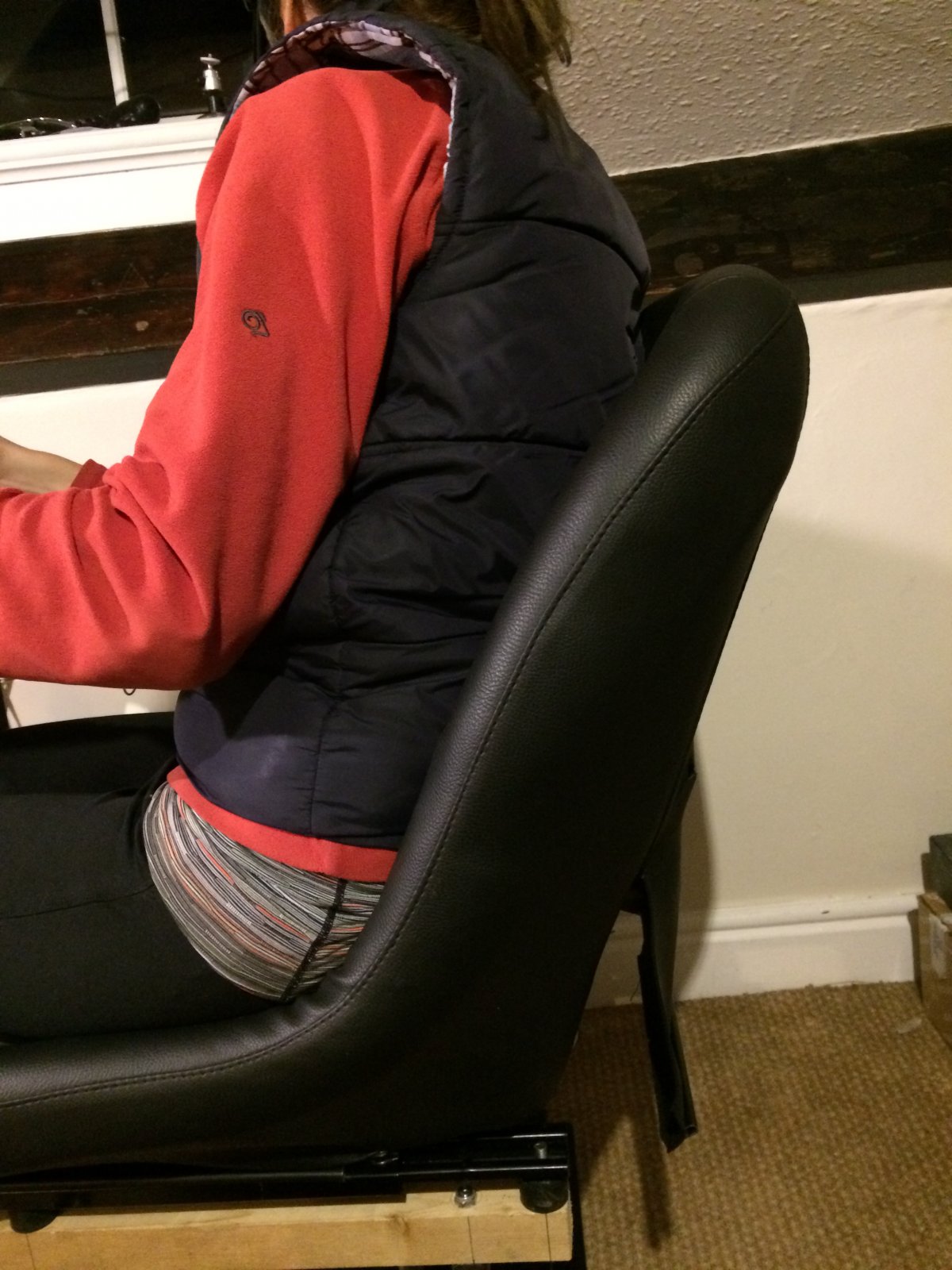

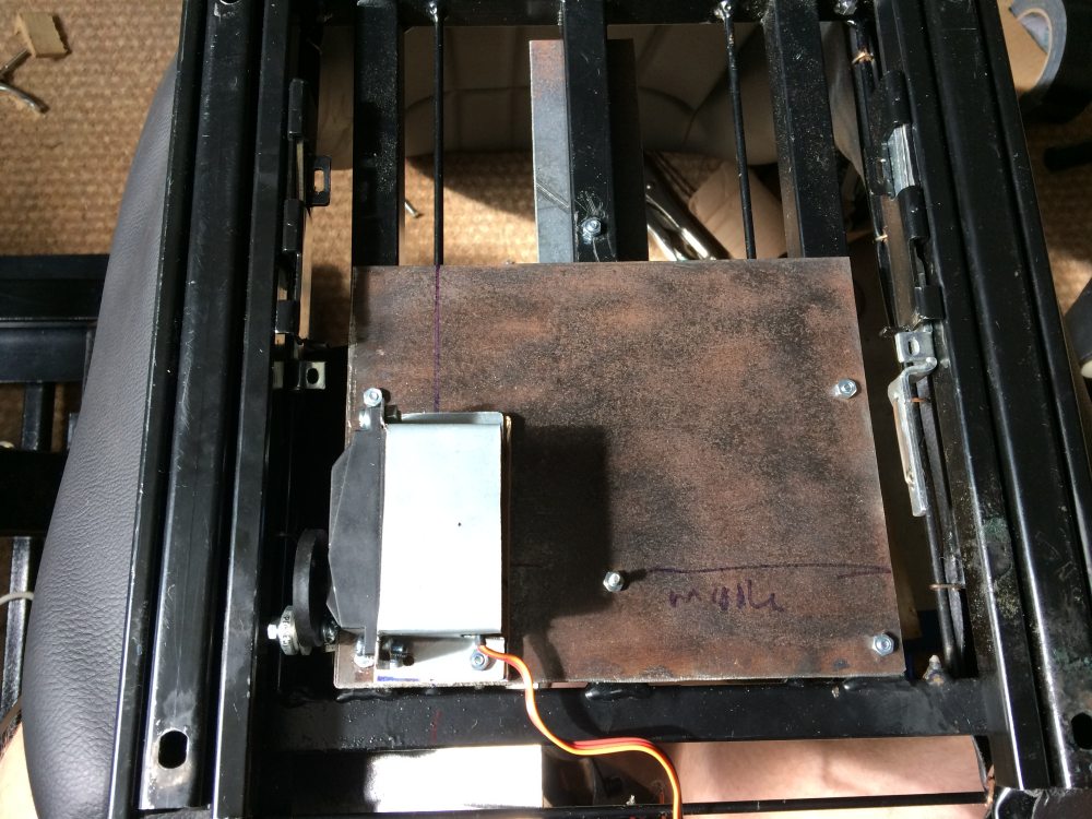

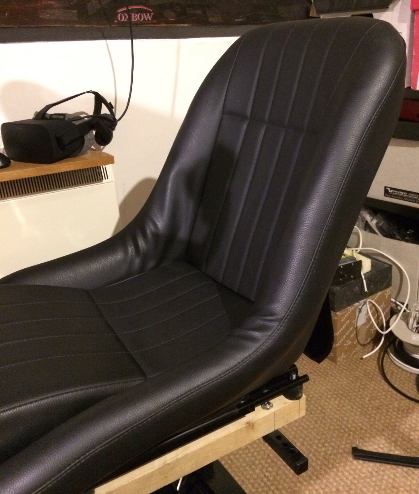

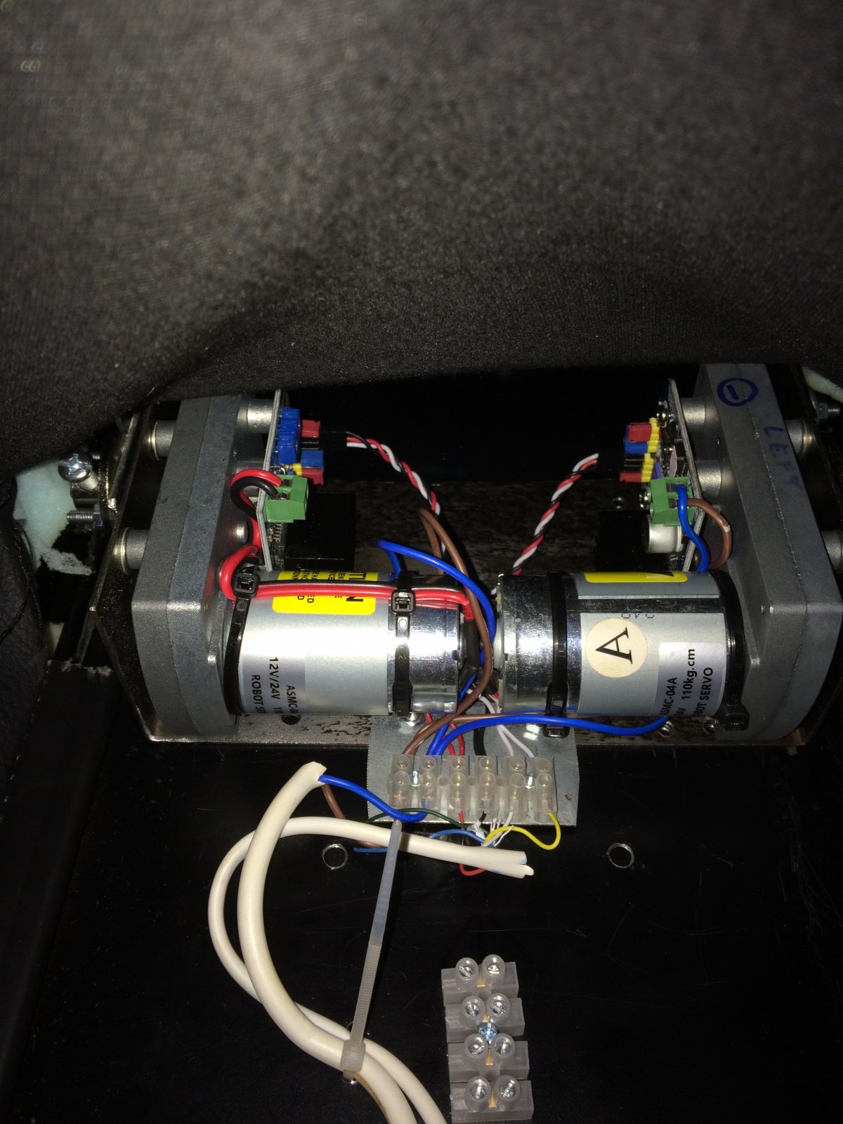

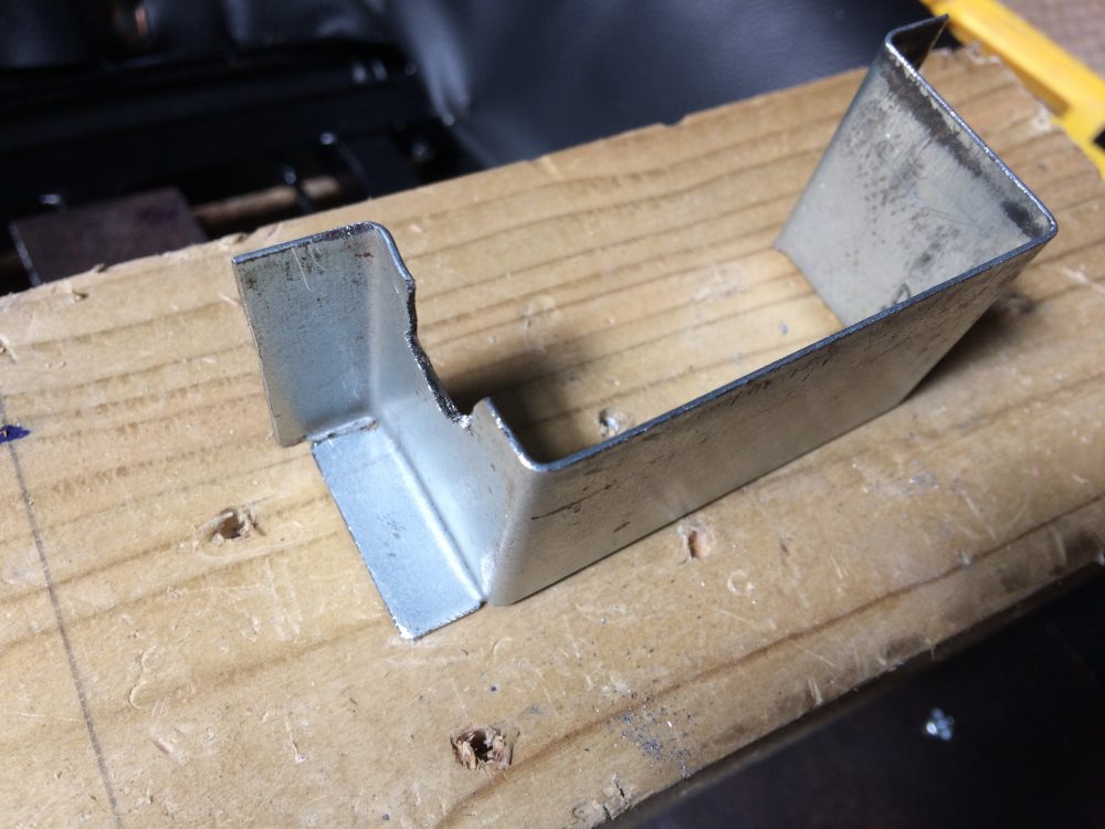

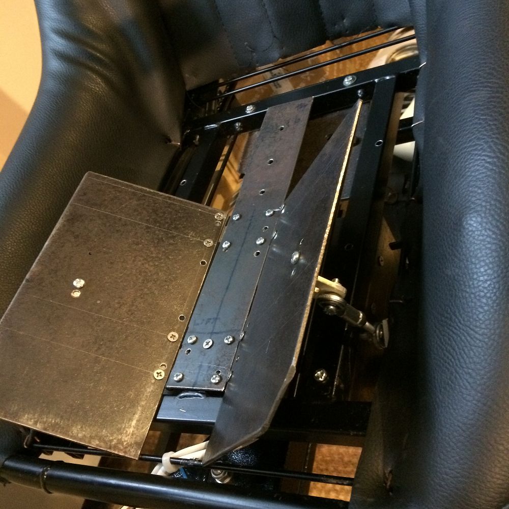

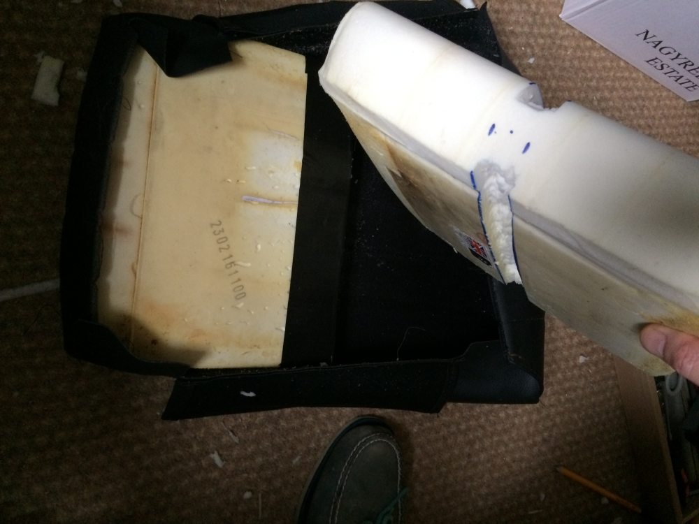

    A productive weekend. I had some steel plate cut to size and made some cages for the servos, spent many happy hours drilling holes, and took the plunge to cut up my foam seat base to enable it to flex with the flap movement.
    Overall conclusion: Not bad. I need to do some tuning as I can get a fairly nice sense of pressure but it doesn't kick in soon enough. If I fly a stunt plane and make tight turns its quite nice, but that won't be the norm. One effect I was hoping for that these servos just aren't capable of is the thump that comes with a hard landing. They aren't quick enough for that.
    Overall then I want more power so I have two of these on order. 24v and almost double the kgcm. The KingMax servos can be put on the seat back plate for surge. Also I'll test the foam base without the vinyl wrap and try padding the front of the seat to make it deeper. I want to minimise the movement-to-sensation time.
    I've also been thinking about -ve flap movement. I suppose if neutral is slightly high then it can drop, so I'll experiment with that. It won't be sustainable but as an instantaneous sinking feeling in windy conditions it might be nice.

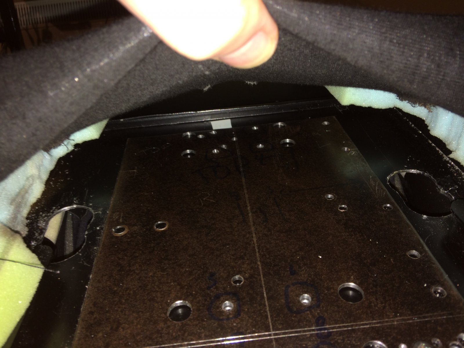

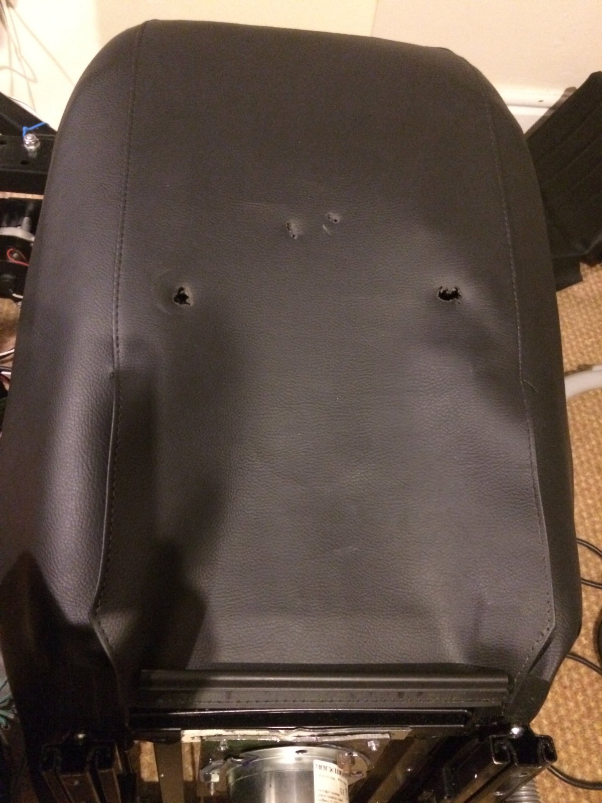

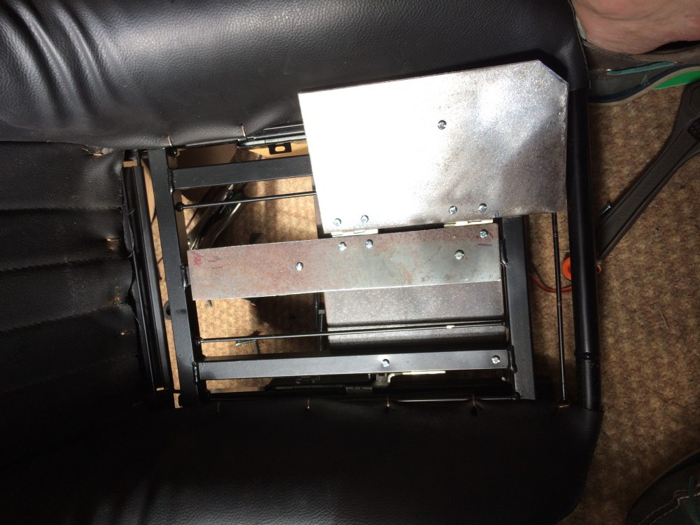

    Part Two - Surge
    As I am currently waiting for a replacement board for one of my 110kgcm servos which I'm now using for the heave function, I have repurposed my 65kgcm KingMax servos to be used for surge. I've certainly made things difficult for myself too. The original goal was to add G-Seat functionality to a compact racing seat with minimal visible external gubbins. Ideally I wanted it to look just like the normal seat but with secret G-Seat functionality built in. That proved just about possible for heave, by lifting the seat cushion and hanging some servos underneath, but with surge I have all the upholstery contend with and if I tore that off it would never go back on right. Now I see why people build a separate seat or work with a bare bones aluminium Kirkey style seat. Still I ain't giving up.
    I realised I was never going to mount the flaps and servos directly to the steel seat back. Just not enough room to measure, position, drill and fix. I decided to:
    1. build the flap/servo system onto a separate steel plate
    2. dismantle it and use the plate as a template fixed to the rear of the seat to drill through where needed
    3. Move the plate to the front of the seat back and reassemble the flaps to that with the servos behind the seat back
    It would involve some drilling through the vinyl but I got away with very little in the end. The hardest bit was cutting through the seat back to allow enough space for the bearing rods to move. In fact the reason I don't have completed pictures is because I'm still cutting away at bits of the seat back that are catching the bearing rods and servo arms, but I'm 90% there, and I'm very pleased by how discreet it all is. I've yet to find out what it feels like of course, which I'm rather nervous about.

    Now I have £140 of burned out servos. My conclusion is simple - Small sealed RC servos should not be used for motion platforms. I disassembled one of the dead servos and the motor inside is so small. The motor still works so its the circuit board that has failed.
    I do have some other learnings.
    1. The principle of using hinged flaps to simulate surge is sound and a very enjoyable addition to a seat mover. In fact I enjoyed it so much I stopped playing around in my Cessna and starting blasting around the skies in an F15 with afterburners so perhaps that's why I stressed this little servo so much
    2. The flap needed to go up higher. It was a good effect in my lower and middle back but I didn't go up high enough so upper back was getting no sensation
    The plan now is this:
    1. Switch over to using my 110kgcm 24volt servos for Surge as these are open with heat sinks - see here
    2. Get 2 more of these 24v servos for heave, but I might as well get the stronger 260kgcm - see here
    I have photos of the finished thing with servos/flaps in-situ but there's no point showing these now. I do however still think I can build this with the stronger servos and fit it all into the same small space. There might just be a small bulge in the vinyl at the back.

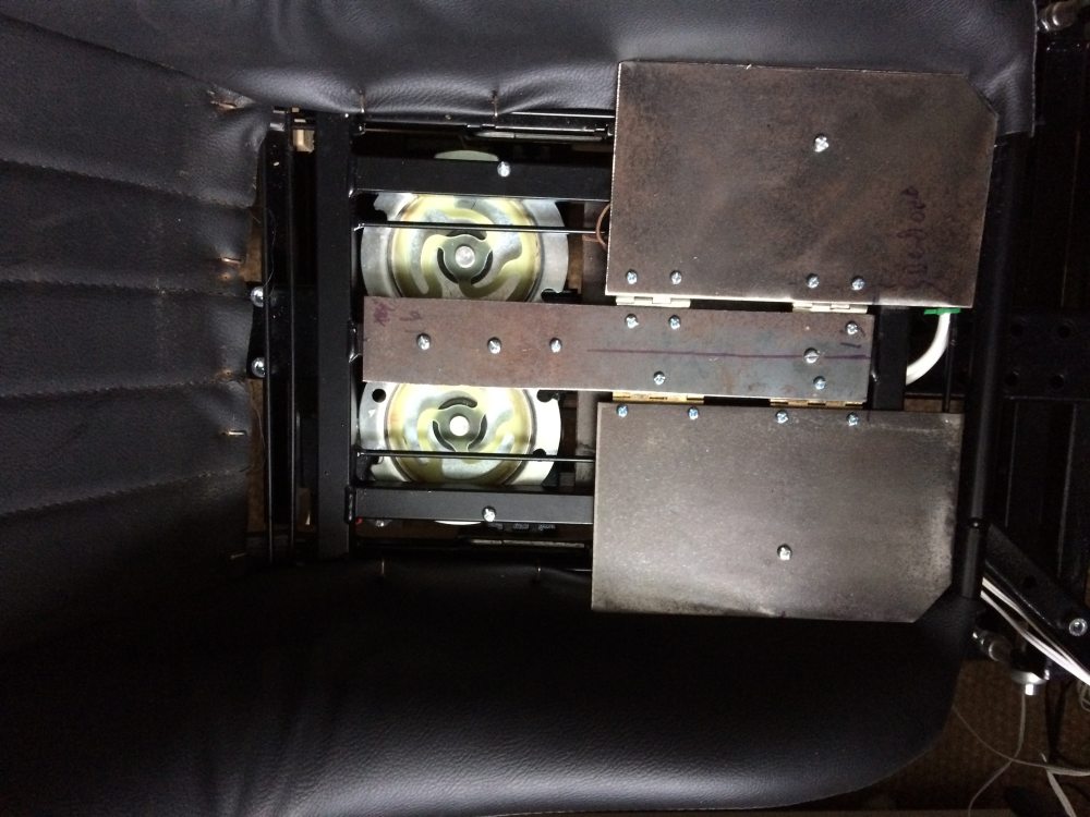

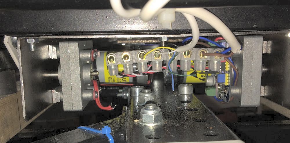

    A busy weekend. The heave/underside is now all built, mechanically at least. I'm just waiting for my new servos to be dropped in place of the old. I'm very pleased with the design. Its very low profile underneath, in fact I have about 2mm clearance between the motors and the centre bar of the 3DOF. There's very little space for the bearing rods too, but liberal use of countersunk screw heads allowed me to fit everything in and still use a thick gauge of steel for the lever arms. I'd really rather have gone 6mm with the bearing ends but space limits me to 5mm. Should be OK for flying.

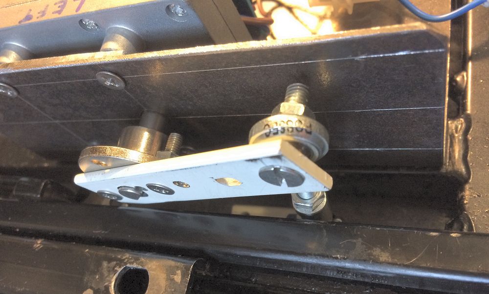

    @MarkusB I've just reread one of your posts and reminded myself that you were putting springs under the heave flaps. Great idea. That way the servo doesn't need to do all the work - 1/2 the work maybe? If neutral is the mid point? Can anyone work out the forces and best settings for this? My design is so compact though that I'll have to see what kind of springs would do the job. Maybe just normal coil springs as I have a metal plate below each flap that the springs could press against. I have no idea about springs though and how to work out tensions and forces.
    If I eventually get these 260kgcm servos and incorporate springs I should have ample power and speed. My hope is I can simulate a bumpy runway or in fact bumpy air. I think it should also be strong enough for a driver's G seat.
    Update: Having doubts about this now. Do springs really reduce the work the servo has to do? Surely every ounce of force they aid in one direction has to be pushed against in the other?

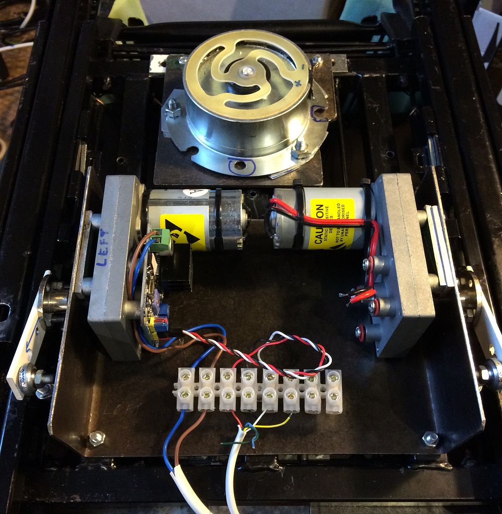

    Runs hot
    I've been playing with the surge flaps for a few days now and they're working well. After a bit of use though I notice that my back is getting warm. It turns out the motors are running pretty hot. There's a heatsink on the controller board but its the motors themselves that get rather toasty. I measured the motor diameter as 36mm which I discovered corresponds to a 540 size motor, so I've got a couple of these heatsinks in the post to me now. It looks like hot 540 motors are pretty easy to deal with as I see all kinds of options on ebay, many with built in 5v powered fans.
    https://www.ebay.co.uk/itm/RC-1-10-...nk-Heatsink-Tamiya-HSP-Car-Truck/263030741808
    The other reassuring thing about discovering that the motor built into these servos is of a standard size is that its therefore feasible to upgrade them. The gear mechanism can be accessed by removing 4 screws so the whole thing is quite open. You just can't do this sort of tweaking with a sealed Turnigy style servo. I'm still hopeful that this servo model can provide a great and simple solution for a lot of people to build compact G-Seats.... Despite the fact I'm still arguing daily with my chinese supplier of these servos and have yet to receive the 260kgcm model. I've always been a glass half full kind of guy.
