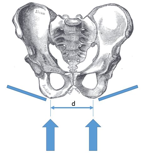

    Hi @Spit40,
    At the moment I am in the progress of rebuilding my g-seat from scratch. It will again become part of a 2DOF simulator.
    2 remarks about the list of your planned changes:
    Some time ago I had a PM discussion with another forum member about pairing servos, and I also read some related posts published in an RC modelling forum.
    What you should consider: If the paired servos have a rigid connection to the paddle and if they are not perfectly aligned, they may work against each other (at least a little bit). For example, one servo arm may try to move some millimeters farther than the other, which will then cause a continuous load on both motors. The solution could be a connection that is not completely rigid, but a little bit flexible.
    This is also my new approach. For getting the correct distance between the hinges, I measured the distance 'd' between the two lower parts of my pelvic bone (see the image below).
    The idea is as follows:
    If the distance between the hinges is larger than 'd', the paddles tend to squeeze your body, and if the distance is smaller than 'd', the paddles tend to lift your body.
    I got the basic idea from @RiftFlyer, see here.
    The difference is that I will still mount the hinges at the edge of the paddles instead of 30% away from the edge. I will only increase the distance between the paddles as explained above.
  15. Spit40
    Spit40 VR Flyer
    Nov 3, 2016
    351
    United Kingdom
    2,946Coins
    +201 / 3 / -0
    That is a very interesting idea, and it makes a huge difference to the load on the servos of course. I may wait to see how you get on though, as at present I do get some lift off the paddles, which I think is a good thing, but doesn't feel the best being under my thighs only. Surge is so good that it draws attention to the imperfect heave.
