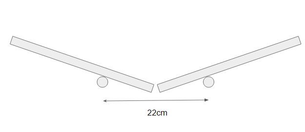

    I have the hinges mounted at the very edge of the flaps and 22cm apart. So it is not like on your drawing where the hinges are some cm away from the inner edge.
    And since these 22cm are a little more than the distance between the two lowest points of my pelvic bone, the flaps cause a pure squeeze effect without any heave.
    I did not make any experiments with orher setups though, and thus I cannot say what the optimal distance is. Maybe your setup does feel better, so that you may regret having changes it. But for me the effect is really satisfying as it is, and thus I will keep it.
    What I am not satisfied with are my current backrest flaps. I guess their hinge distance is too large, so that they tend to squeeze by back, which does not feel like surge. I will change this when I am back home after my vacation.

    @MarkusB I'd like to switch to your approach as i don't like the feel of the heave action on mine. Unfortunately my classic car seat has a narrow seat area. Not much more than 22cm in total. How wide are the heave flaps themselves on your rig?

    I don‘t have their width in mind and can measure it not before next Saturday. I think they are about 12cm, but I am not sure.
    But you can determine the required width:
    Mount two pairs of hinges on a wooden board in the desired distance (in my case it was 22cm, but yours may be different depending on your anatomy), and connect provisiory flaps (e.g. wooden planks) to the hinges. Then sit down onto the wooden board between the hinges, move the flaps upwards with your hands and check which part of the flaps that gets in direct contact with your body. This is your required flap width.

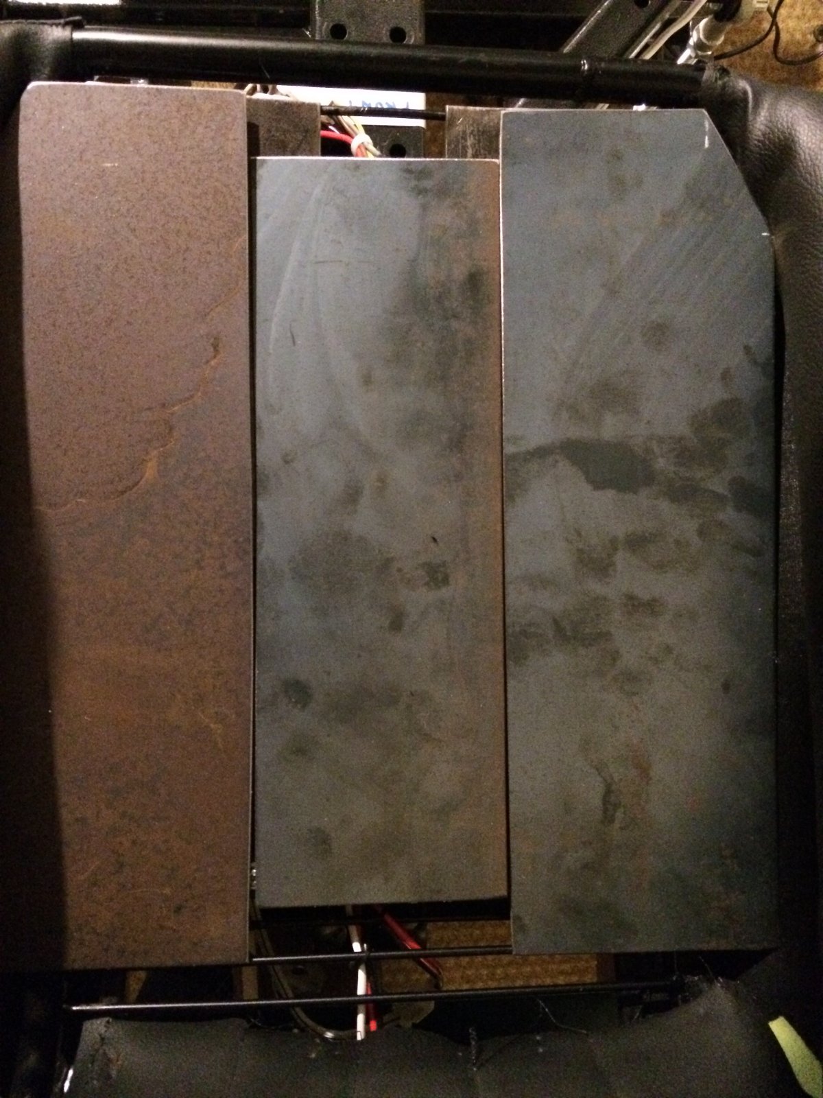

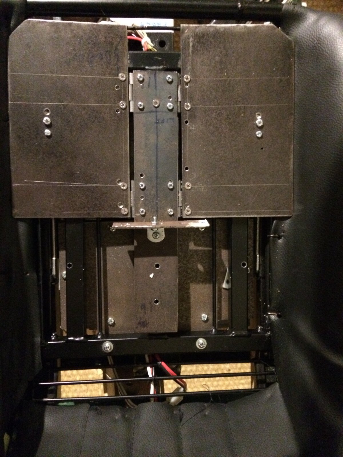

    Version 2
    The time has finally come to work on version 2 of my gseat. For a few months now I have had the heave flaps disabled. The reason is that I was running the motors way too hot (I could smell how hot they were getting) and the action was fairly unconvincing especially for flight. My thighs were grtting lifted but it was nothing like the sense of being pressed into the seat.
    The change I wanted to make was to use @MarkusB 's approach of a full depth heave flap (rather than front section only) with flaps placed so as to apply a side squeeze only rather than a lift action. Much less force should be needed for a squeeze.
    The reason for delay is that my bucket seat is so narrow i felt the only option was to switch seat which i couldn't bring myself to do. Here's the v1 design and you can see there's no extra width.
    I finally concluded i could peel back the leatherette and make some room by squeezing the foam with cable ties.
    This is version 2 prior to bolting everything together. The flaps are probably slightly wide so i'll be cutting them back a little once its all fitted and i see how tight it is.
