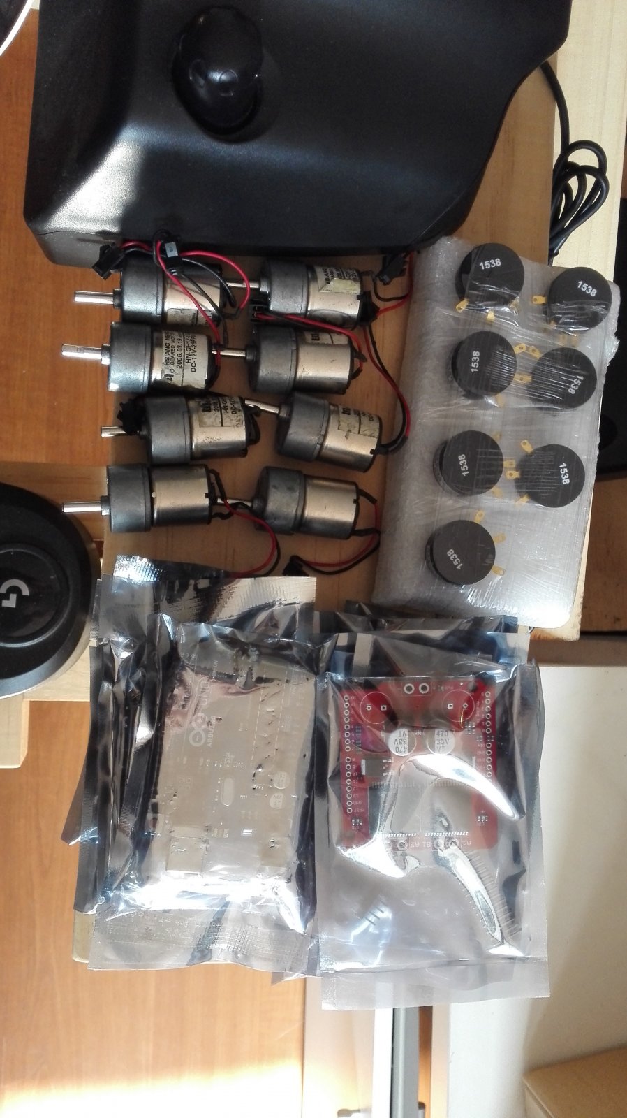

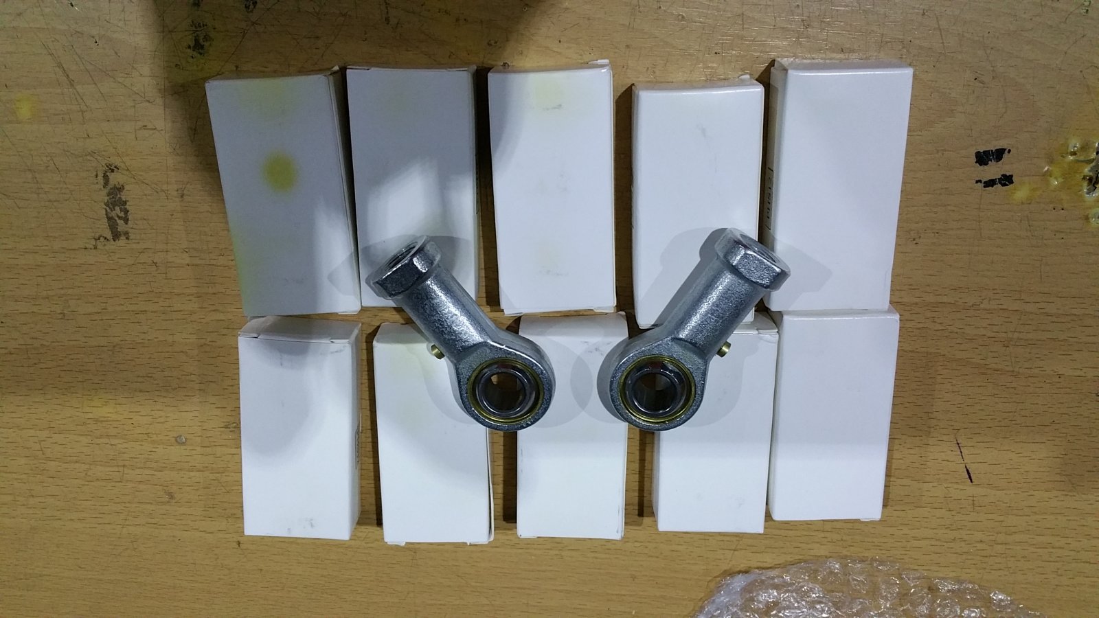

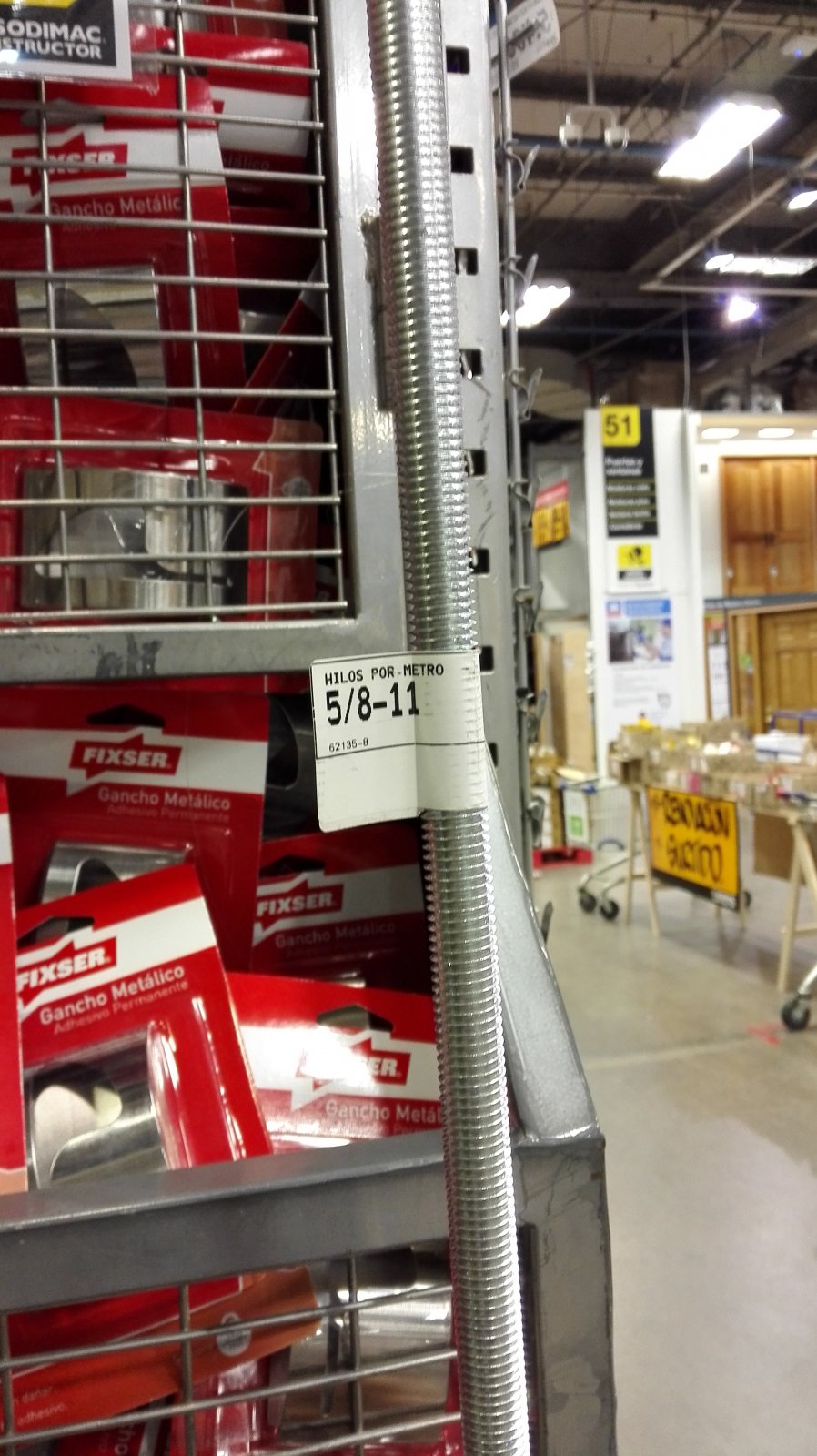

    Preparation progress:
    12V DC motor: inquiry price on line, the seller has 200W to 600W motor, I'm worried more power more noise.
    3 Ards and 12 MMs: book on line
    6 POTs: book on line
    6 Flexible Shaft Couplers: book on line
    PSU: book on line
    but there are something I can't find, any one can give me some suggestions?
    12 Ball Joints: I found it on line now.
    CTC shaft: can’t find it.
    Long shaft (connect to CTC shaft): find some pole, maybe can be use. attached the picture.
    Connector of CTC shaft and long shaft: can’t find it
    12V DC motor: still not decide where to buy(too expensive to ship to Chile and too much tax). so bought 8 small motor to DIY a model first .
    5 Ards and 15 MMs: received
    7 POTs: received
    8 Flexible Shaft Couplers: received
    PSU: book on line
    This weekend I will start my model. It's time to upgrade my rig with DOF.

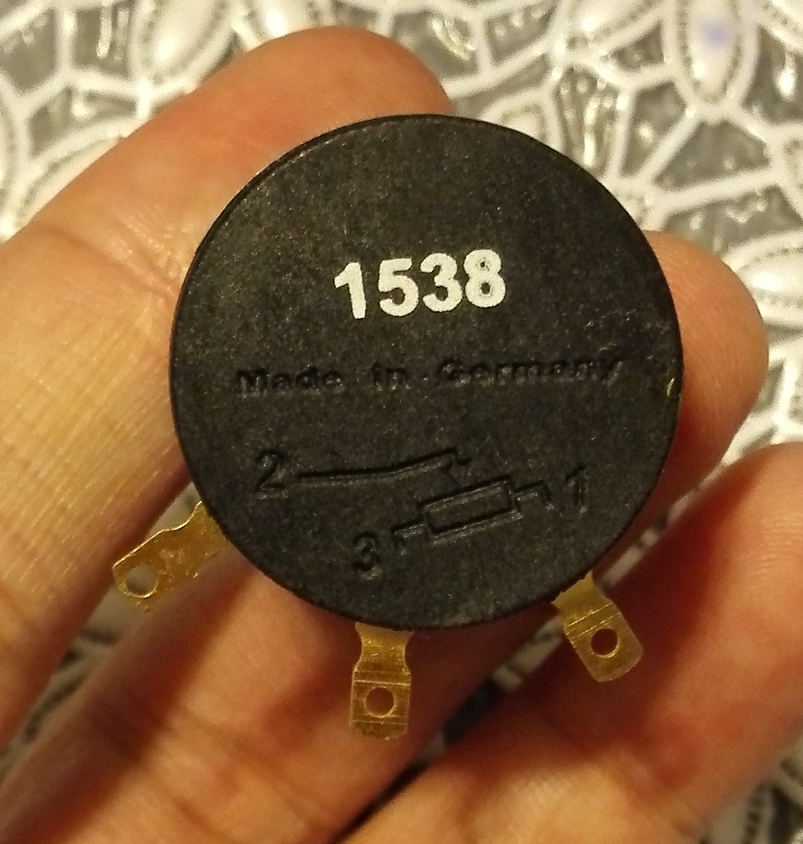

    the POT I bought as attached picture, which one should I connect to +5V and which one should I connect to GND? the else one I will connect to A0 and A1 in Ard.

    You can connect 1 and 3 either way. If the motor runs out of control then they are reversed so change them around.

    or swap motor wires

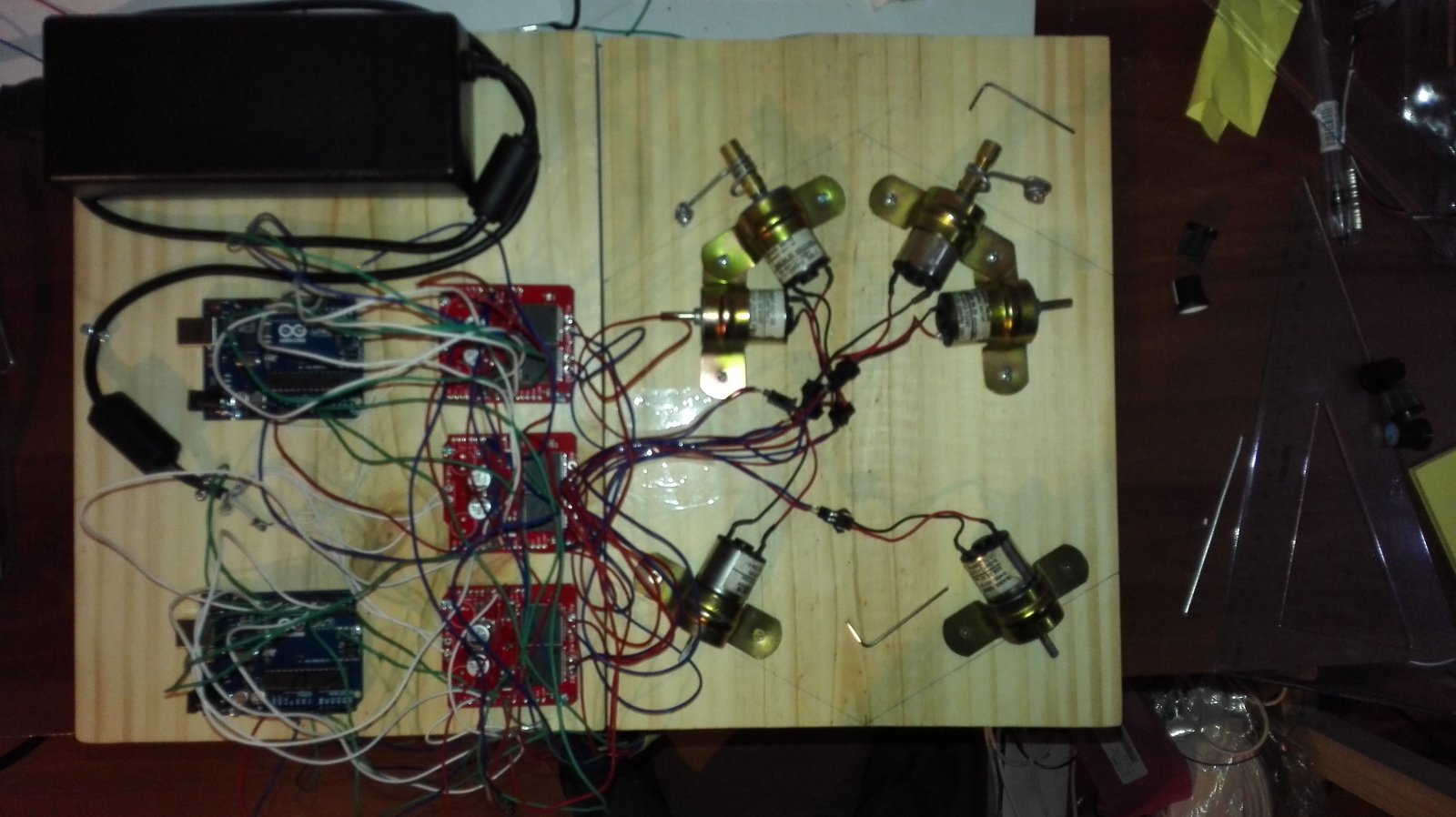

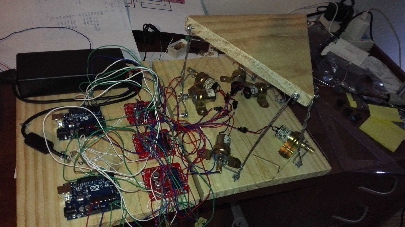

    First draft version model, working on POTs, used to study and test.

    Looks the model works. but the 2nd left motor works not fine, only when the motion amplitude large(I choose motion mode in SMC3Utils v1.01 tool) the motor works. what could be the reason? the motor, Ard, or MMs?
  17. Racing Mike
    Racing Mike Member
    Apr 24, 2016
    99
    Chile
    348Coins
    +34 / 0 / -0
    when I increase PWMmax for moter it become more responsive.
    why each motor has different responsive PWMmax? my motor 1 is about 30, but motor 2 is about 200.
  18. SeatTime
    2,572
    Possible unserviceable MM driver chip.
  19. RacingMat
    2,233
    21,059Coins
    +2,092 / 21 / -2
    the troubleshooting procedure would require that you swap one motor with another and check
    then swap one MM with another and check...
    etc
    this will tell you where is the default ;)
