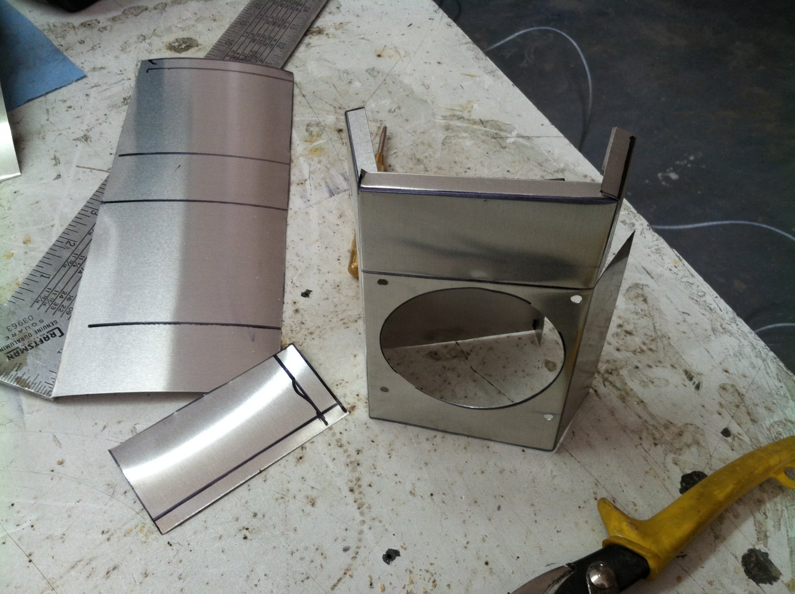

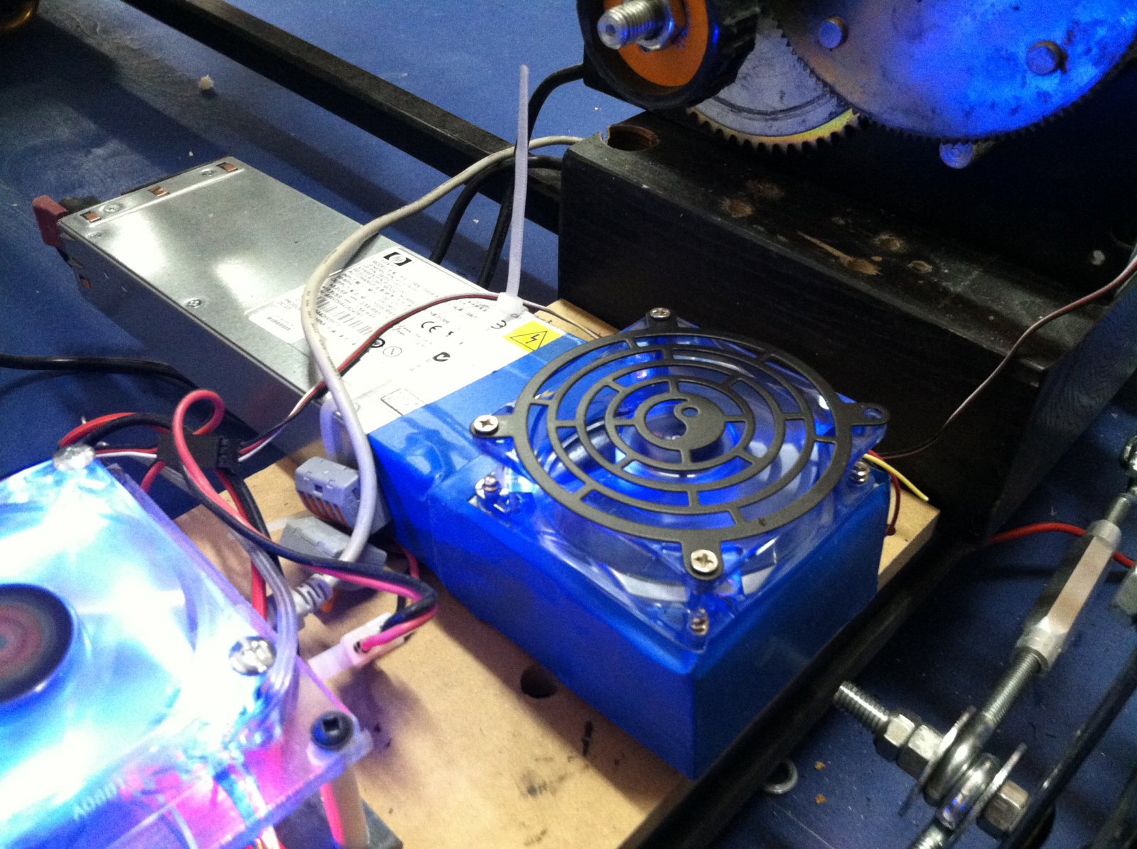

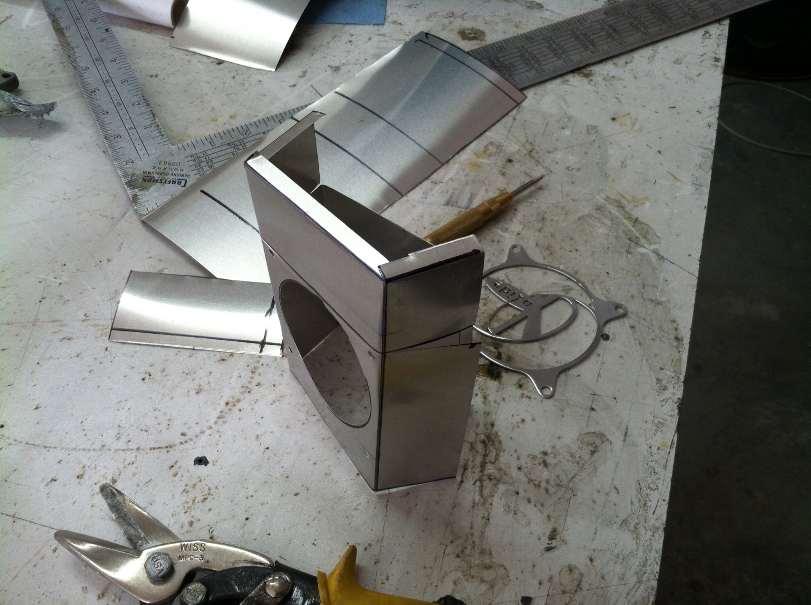

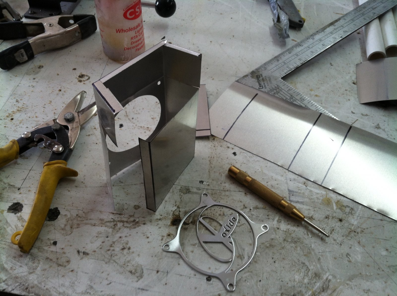

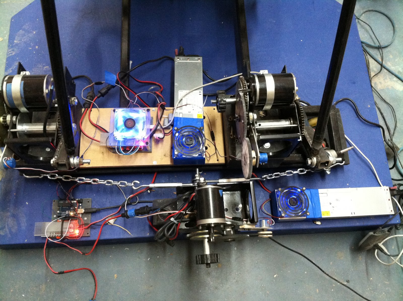

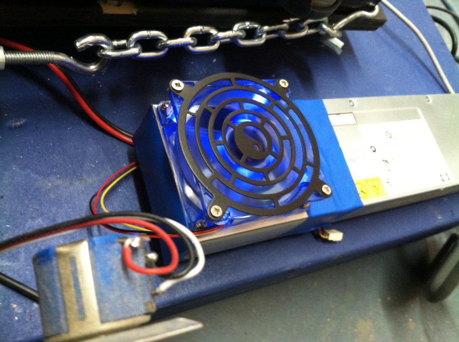

    My cooling solution for the server PSUs. Neat, tidy and above all....SHINY. :cool:
    I simply folded some aluminum flashing material (for roofing) into a couple of boxes that fit over the end of the PSU, attached a couple of 80mm PC fans and off we go to the races.

    And, as promised, the video:
    Yes, I know....I need practice, lol.
    I cannot stress enough how much more immersive it is with traction loss. It was well worth the little extra effort to add it.

    I would say that it is more useful to people with one screen cause they have pretty limited view and headtracking allows them to freely see what is left and right, the things you can already see with three screens. Three screens with good FOV basically remove the need of headtracking, speaking of driving sims, for flying sims I guess headtrack is good for both triple and single screen setups.
    @Historiker
    I'm noticing that traction loss is moving you left/right even on straights with high speed where it doesn't seem that you're losing your car's back end. Is it set-up right? For traction loss only or also for car orientation?
    The rig is moving good btw, I thought winches where slower, but here they move nice.

    Yes, head tracking is excellent for single screens. It allows you to expand your view without the need for two more screens. Unfortunately Assetto Corsa has a very narrow view available at this time. In iRacing you can literally look over your shoulder with head tracking, it is much more natural in that game. In flight sims head tracking really shines, for me I would never play a flight sim again without it. Racing sims, to me, seem so lacking in immersion due to the lack of freedom of head movement. iRacing, again, comes closest.
    @prodigy I have sway slaved to the traction loss axis. I like how it mimics the side force you get at high speeds with even a little steering input.
    You can not really see it but there is a constant rumble that the winch motors deliver to the platform, it makes the entire thing vibrate constantly and small road bumps are felt. As you can see, large road bump (you know....curbs...other cars and suchlike, lol) are really delivered to the spine :grin

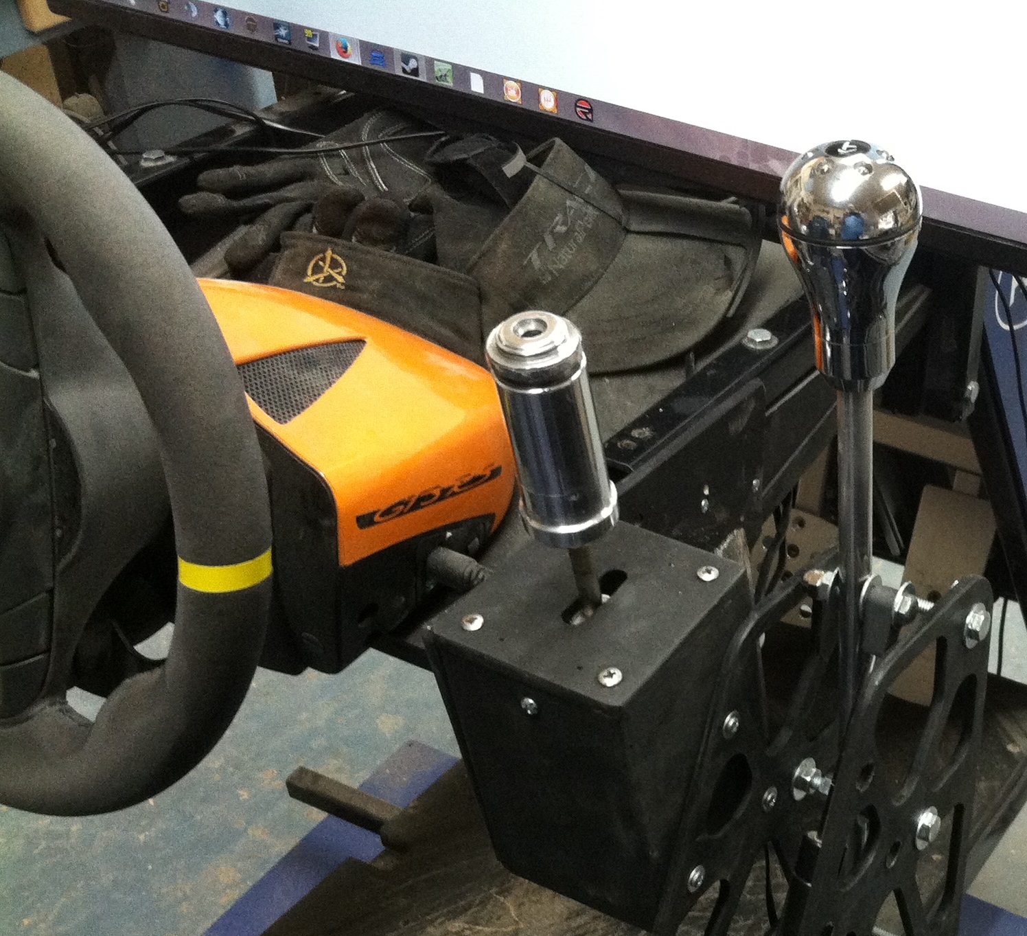

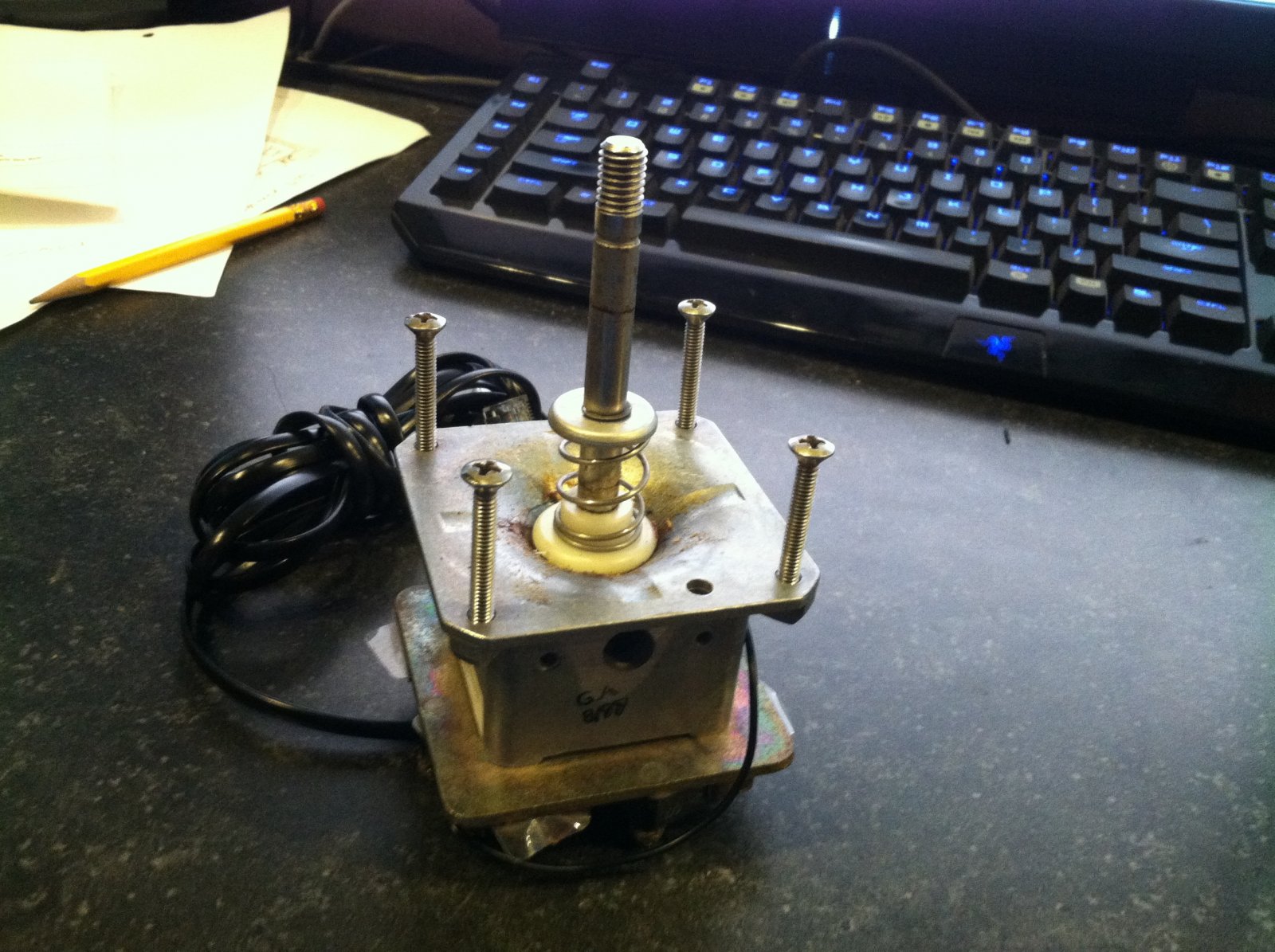

    I added some controllers today to my pit, it is starting to look....busy :)

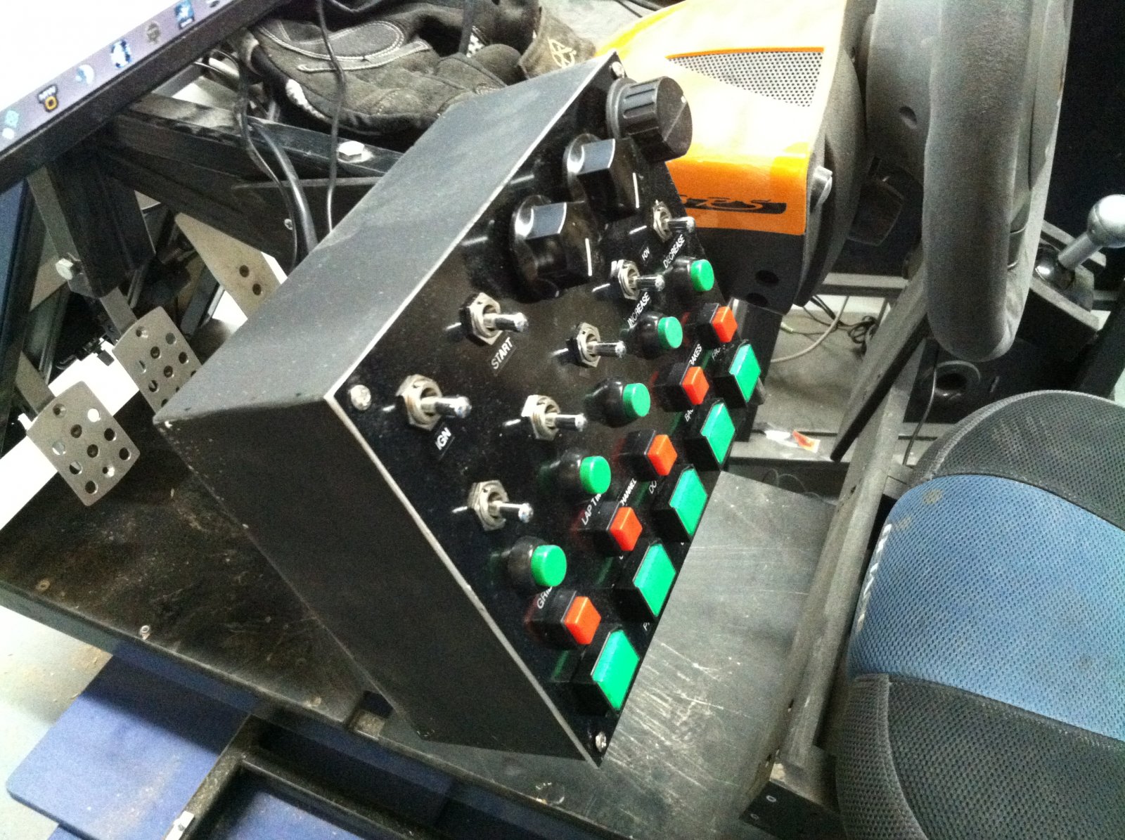

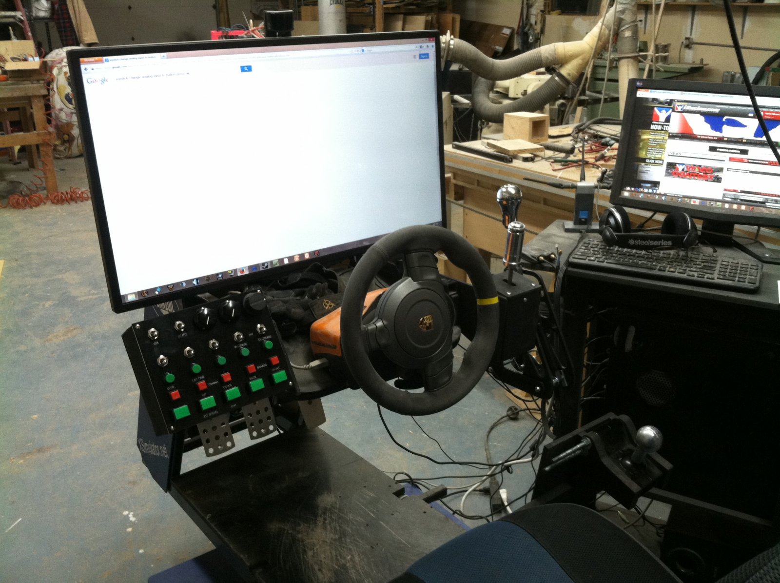

    I wanted a sequential shifter mounted near the wheel but the aftermarket units are a bit expensive. So I modified an old hydraulic controls joystick that I had laying around the shop into a sequential shifter...it was a very easy controller to make. The E-Brake unit is a left over short throw gas spring and potentiometer. I cut the framework out on the CNC. But units are connected to the button box via telephone cables. I wanted plugs that had a positive lock, I hate the PS2 plugs that Fanatec uses; they work themselves loose after a while. The button box has 28 inputs (including the six position rotary) and two analog inputs.
    The controller inside the box is a Teensy++2.0 micro controller configured using GenericHID software. It will do up to eight axis' and an unlimited number of buttons with big enough matrix's but I am using the easy to wire 32 inputs (no matrix needed) and only three of the analog inputs. The controller is 10bit so I get 1024 steps on each axis so it is pretty precise.
    The handle for the sequential shifter is a chunk of aluminum that I had laying around, a few minutes with the lathe helped to to look a little more like a real shifter knob.
