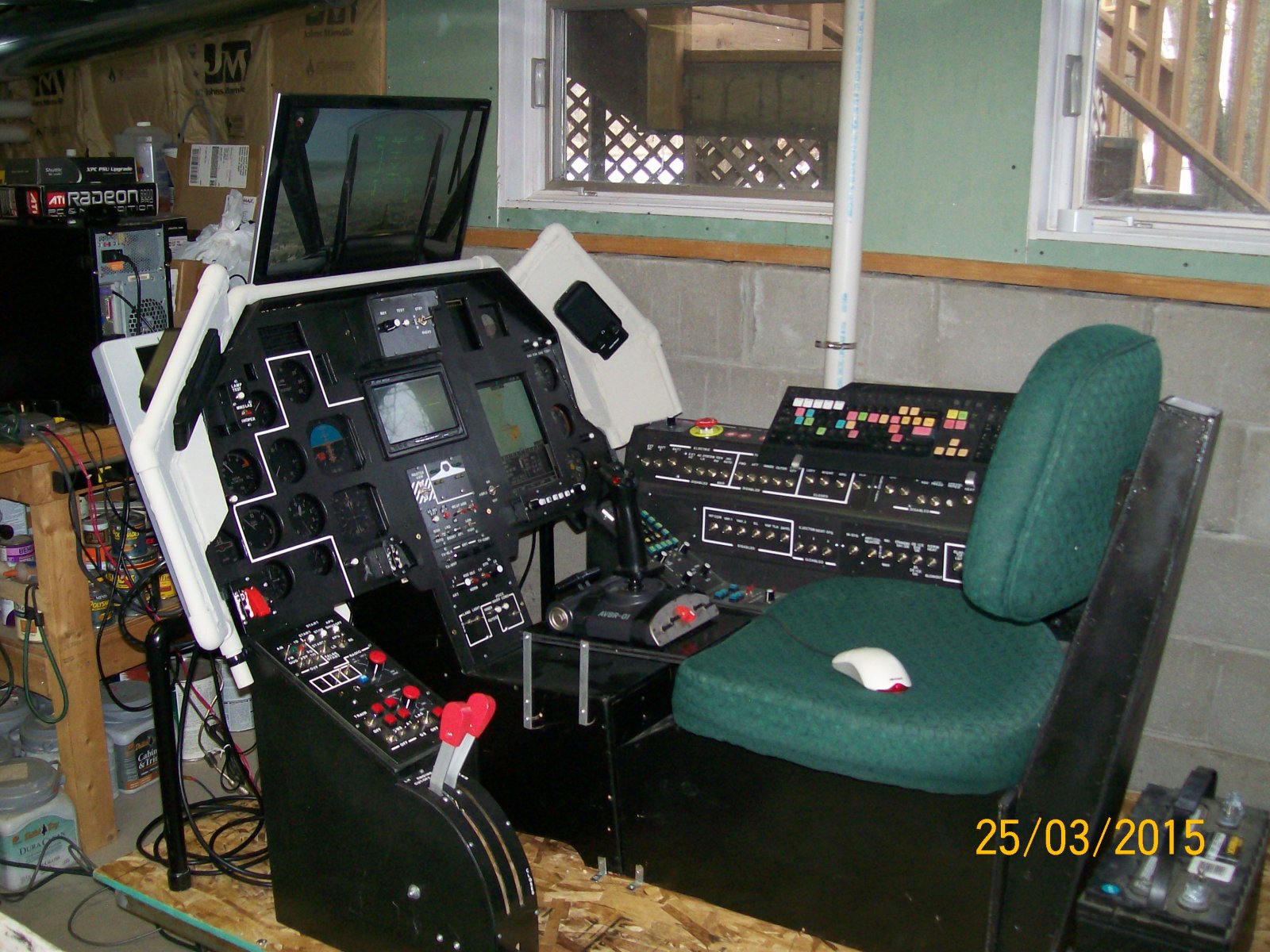

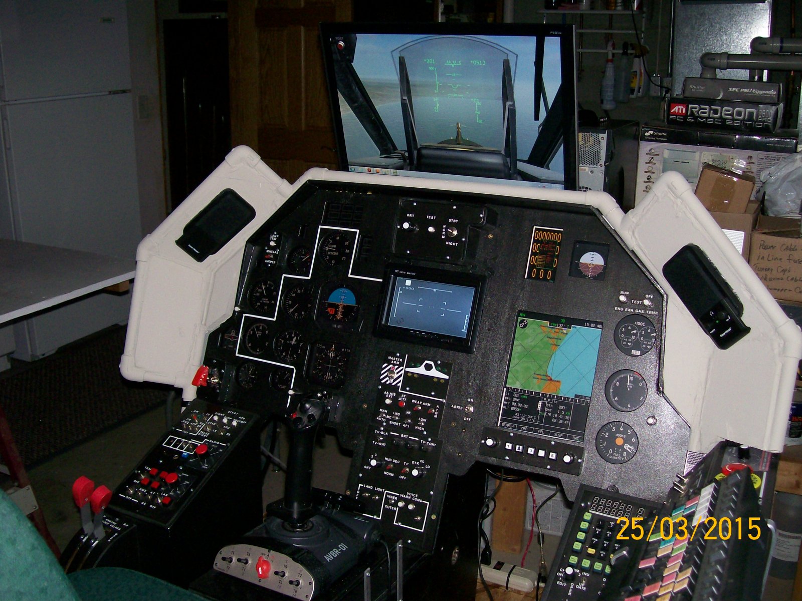

    Well,. my motion platform is working however we never did figure out why it would not work with helios running so I kind of went away from DCS and now I am using it with FSX along with their gauges and it seems to be working ok, needs a little tweaking. I am in the process of building interchangeable dash boards to setup with the different aircraft that I am flying. I believe that with the winch motors I will be able to have a two seater (side by side) with dual yokes I hope to at some time have three motors with "HEAVE". The pictures are of my DCS Black Shark KA-50

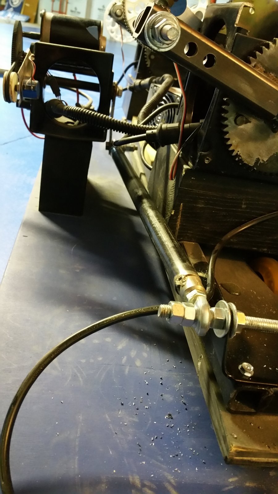

    It's Done! Today is the first day of my new found freedom from construction. The wife gave me the entire day to just play so what was the first thing I did this morning? Yep, I constructed a new linkage for my traction loss motor and set the motion pit up!
    Now, having seen Pit's threads on MM and his winch motors, I think I will rebuild the pit using better hardware :D
    By the way, I fired up iRacing for the first time this year and bought the Holden Commodore......that car will Murder you. Not just kill you accidentally but actively try to Murder you, lol. I am loving it.
    The problem that I was having with my traction loss motor was how to connect it to the platform. I had tried a simple chain connected in the middle to the motor from each side, this worked but the chain would stretch or break (now that is violent motion!:) ). I was going to try Seattime's excellent example and build a roller chain system but last night (while planning my first construction free day since April 7) the solution hit me. It was so simple that I feel a little stupid to be honest. I used the same linkage from the traction loss motor that I did for the other motors, but rather than going up to the shoulders I simply mounted it on the right side of the platform base. DoH! Easy.

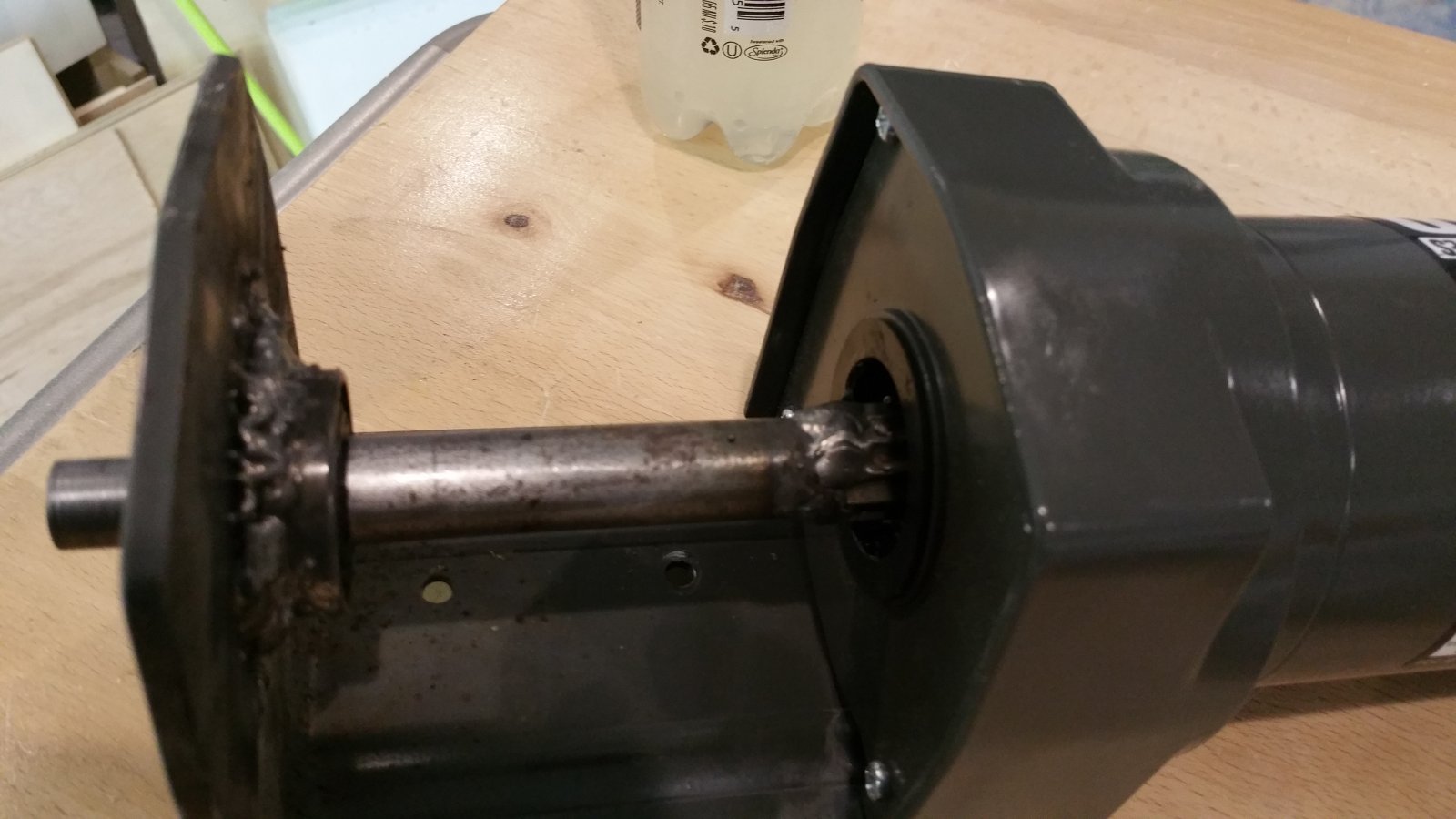

    Thanks goes to Pit for showing me some closeups of his winch conversion. While I do not have easy access to bicycle parts I do have a few flange bearings and some 5/8" steel round stock. I turned the round stock down to 1/2" so it would fit through the bearing and would act as a natural stop to keep the shaft from sliding out the end. The small gear slides out and it was easy to weld it to the end of the shaft. I bore a 1/4" hole (close match for the one in the gear) so that when I welded them together a drill bit shaft kept them aligned. I am out of flat stock so will have to wait a bit to make the lever. If this works out I will make two more (got a great deal on three at Harbor Freight) and replace the sloppy boat winches on my motion platform.
  18. Pit
    3,007
    30,516Coins
    +3,098 / 31 / -0
    hi @Historiker great solution! Why I used bottom brackets: the weight on the axle was absorbed by the bracket and was not lying on the gear to reduce the noise of the planetary gear.
