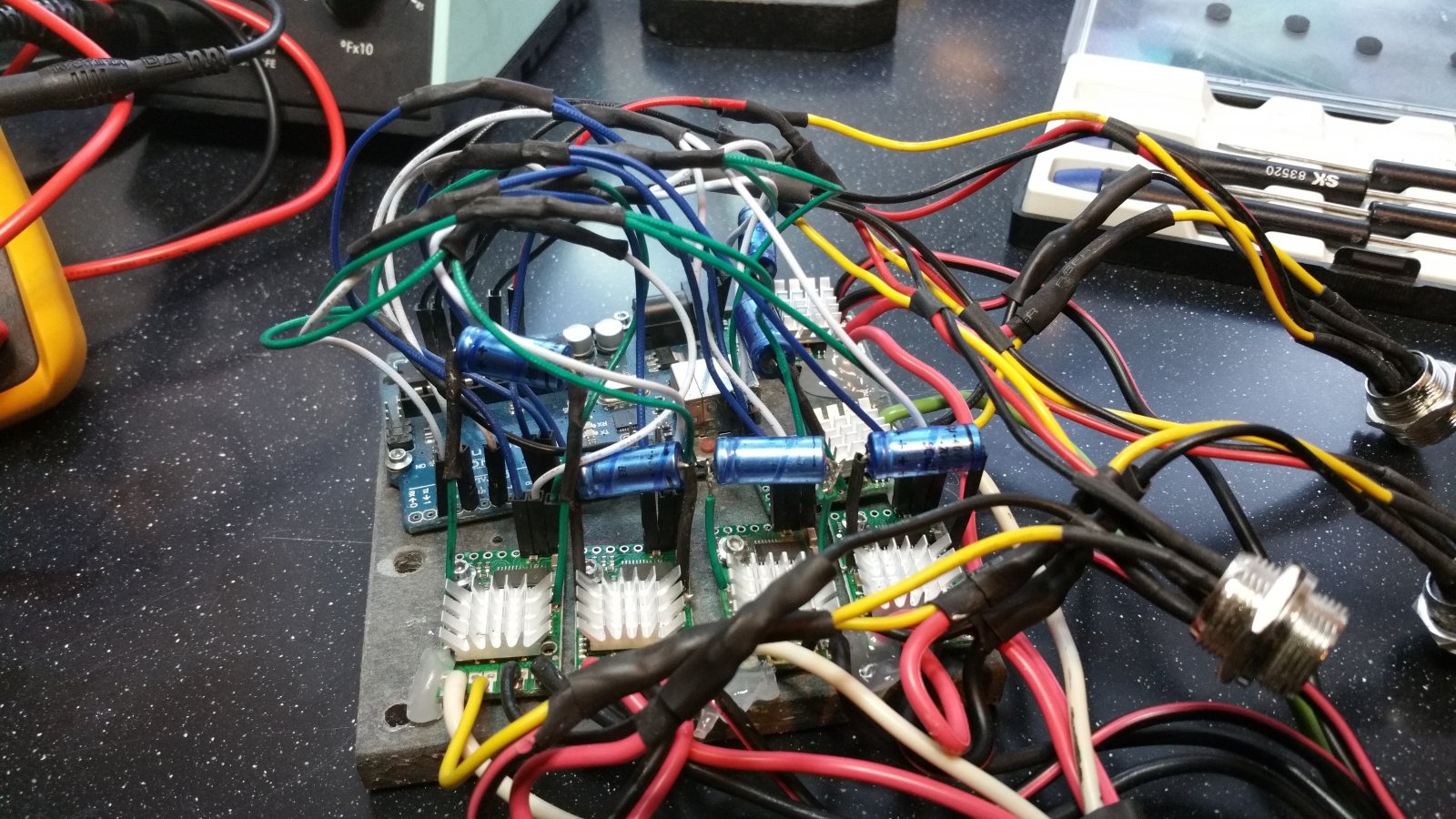

    I removed the electronics to put them on the bench and inspect the connections. I did not find anything amiss so will get them plugged back in and some screenshots/pictures later today. Here is a picture of the
    Arduino/Pololu setup.
    WARNING: @Pit , @SeatTime , cover these pictures with your hand when you read this so the tangled mess of spaghetti will not upset you! :D
    Someday I will reconfigure my wiring but for now I just spliced into the setup that I had been using for the old motors. I added another Pololu 755 to each motor one at a time so I would not get the wiring...er..messed up....any more than I already had it :)
    Bench tested fine, and everything seems to work as far as power output and Simtools. Just have the eventual motor 1 drop after 10-20 minutes of gaming requiring an Arduino reset.

    Possibly swap the Pololu cards around and see if one is faulty or maybe is it a heat issue ? Is it just turning itself off with load on it or is it turning off when you are just on the test bench ?
  8. Historiker
    2,163
    9,212Coins
    +2,177 / 19 / -1
    No issues at all on the test bench but then I am not putting high amperage through them then either :)
    Good idea about swapping drivers around. I will have to remove them from this arrangement and use breadboards as @Pit recommended in his MM thread.
  9. SilentChill
    2,645
    20,604Coins
    +3,570 / 34 / -0
    Yeah im just thinking of a process of ilimination until you find the fault, could possibly be overheating issue those heatsinks do look tiny. I take it you have fans when they are on the rig ?
  10. Historiker
    2,163
    9,212Coins
    +2,177 / 19 / -1
    I do, but they do not get more than warm. This was true when I was using them as singles as well. As a matter of fact I was not using heat sinks at all with the old motors.
  11. SilentChill
    2,645
    20,604Coins
    +3,570 / 34 / -0
    Wow my MM's get scorching hot without heatsinks and fans and even with them on they get hot. If its not a heat issue thats one less thing to worry about :)

    IMO if the rig works fine for 20 minutes I assume an overheating issue.
  16. Historiker
    2,163
    9,212Coins
    +2,177 / 19 / -1
    That is what I am thinking as well, thanks Pit.

    I was thinking that an overheated driver might be causing a feedback issue for the arduino?
  19. speedy
    speedy Well-Known Member
    Feb 1, 2012
    1,193
    Alexandria , Egypt
    7,951Coins
    +1,288 / 10 / -0
    Nob ... there is no actual relation between them ... when the driver is overheated resetting the Arduino will not solve the heat problem issue ..
    • Disagree Disagree x 1
  20. Pit
    3,007
    30,516Coins
    +3,098 / 31 / -0
    @Historiker please can you check out after the motor driver was shutting down and directly after that you start SMC3 the driver will be alive again?
