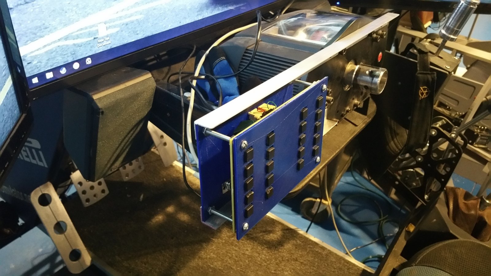

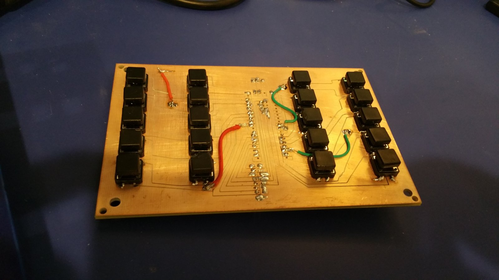

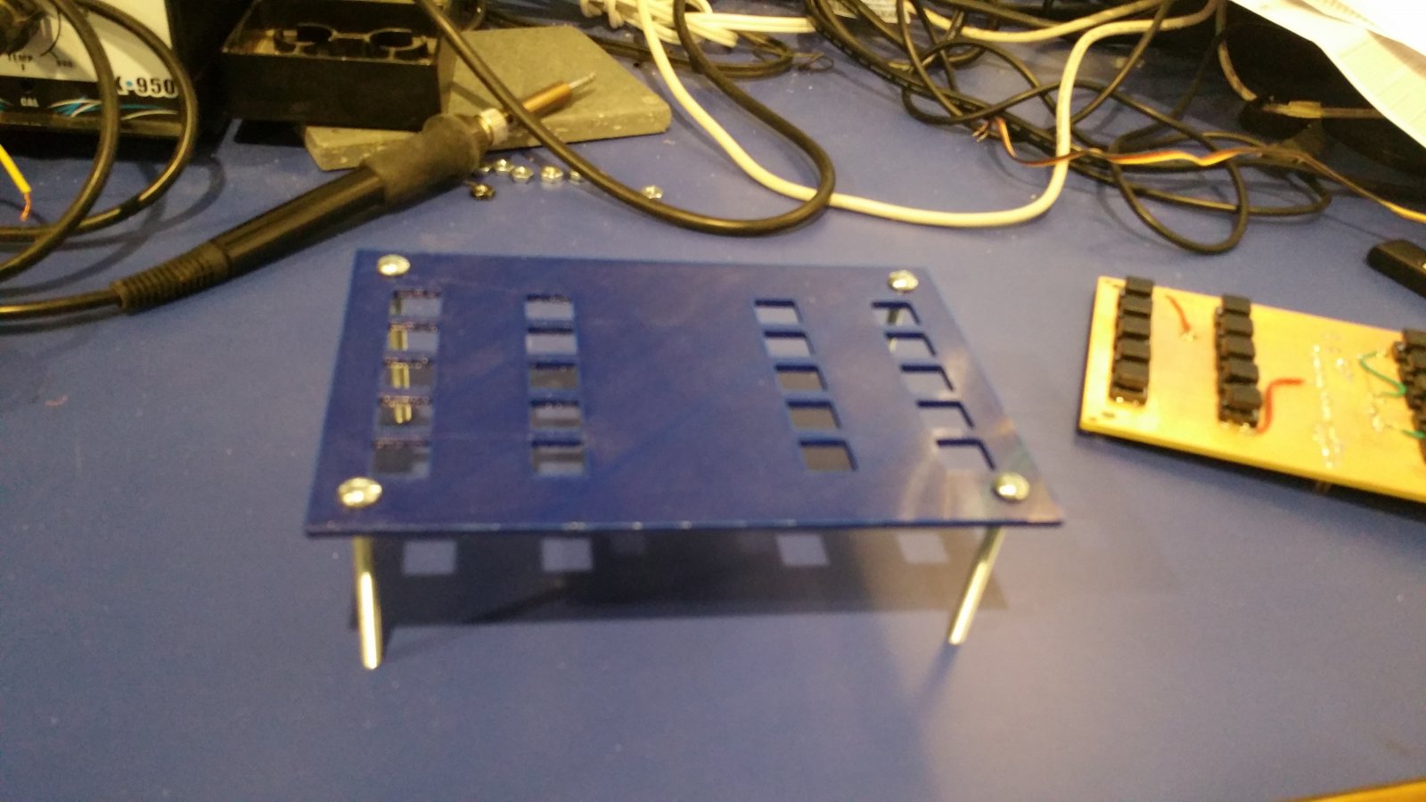

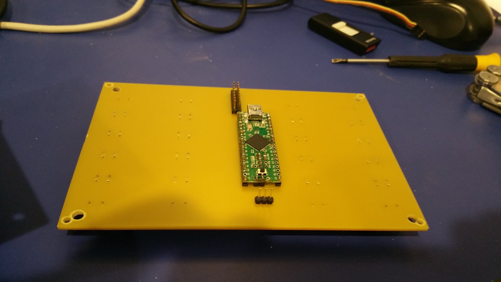

    Two of my cheap momentary buttons went bad on my button box. I was going to replace them but the spaghetti mess of wiring inside the box made this almost impossible. So...
    I made a new one :)
    I wanted it smaller than the original, less mess inside and better access to the rear plugs for the peripherals (7 speed H-shifter, analog hand brake and sequential shifter).
    Again, I am using the same Teensy++2.0 development board that I had before, just soldered directly to a PCB button array. Far less cluttered this way.
    The front and back plates are PLA made on my 3D printer.

  12. RacingMat
    2,234
    21,094Coins
    I do like your wiring!
    4 wires for 20 buttons :thumbs
    • Agree Agree x 4
  13. Historiker
    2,163
    9,212Coins
    +2,177 / 19 / -1
    Yeah, that is a little embarrassing, my traces came out too narrow in a couple of places so I had to jumper them.

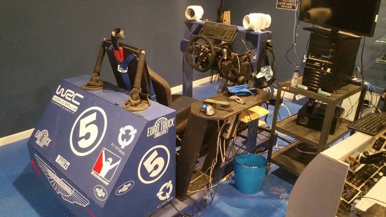

    Long needed update for the rig.
    I am now using my HTC Vive on the driving simpit. I have removed the monitors with the exception of a window monitor to get things started. The addition of motion canceling (thanks for the info @noorbeast) makes it a smooth(pun intended) experience.
    Added simulated wind thanks to @SilentChill using two 4" marine blowers. This really adds immersion in open top cars like the Pro Mazda in iRacing.
    Summer is almost over and my summer tours are definitely over so hopefully I get more time in the simpits this winter.

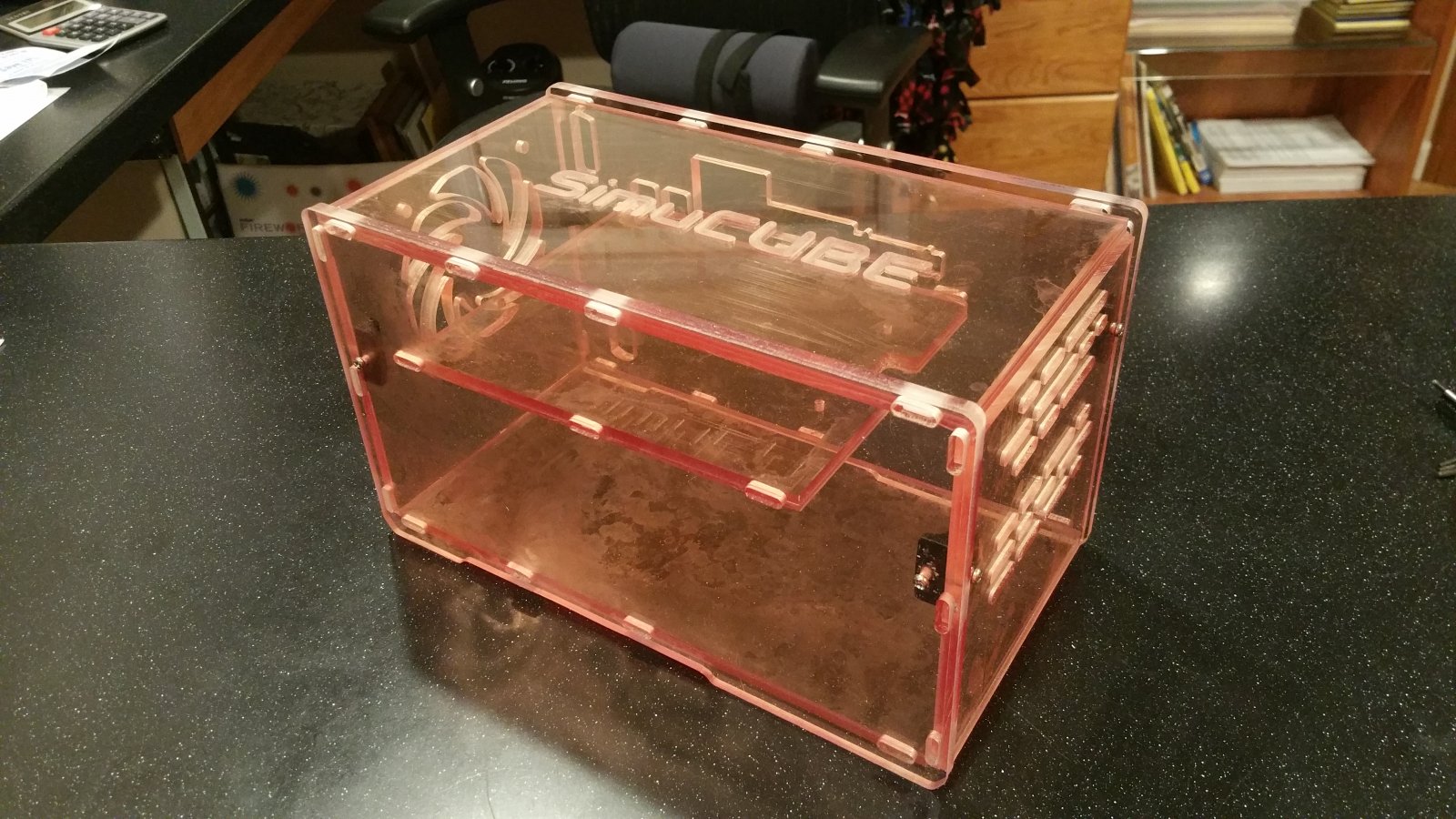

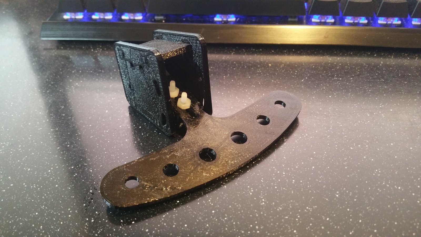

  20. Historiker
    2,163
    9,212Coins
    +2,177 / 19 / -1

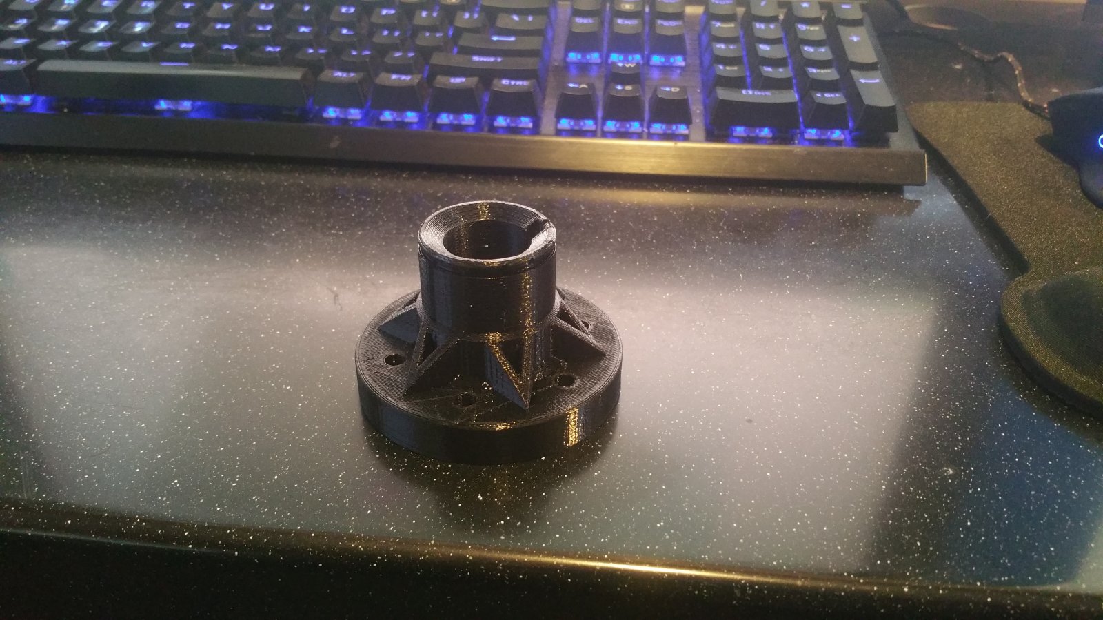

    Using my 3D printer I whipped up a prototype paddle shifter using the CAD files @TOPMO3 generously posted to his OSW build thread. I am not sure that I will go the custom wheel route yet. I am leaning heavily toward using my Fanatec BMW rim with a Teensy LC project board introduced by Darknao here:
    https://github.com/darknao/btClubSportWheel
    After all, there is no reason to reinvent the wheel (Oh boy I have waited years to use that pun!!! :D )
    Topmo3's design is really nice, parts fit well together and the action would certainly be good with magnets installed. If I go this route I will use 3D printed parts for the box and CNC cut phenolic plastic for rigidity.
    Not sure if I will get this project done before September though; I am leaving in May to ride my bicycle around Europe for three months. Hopefully I will have the base working by then; not sure about the wheel though.
    Also thanks to @RacingMat for the wheel hub design, I printed one of those as well.
