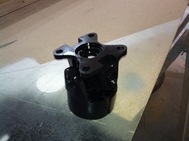

    I stopped by the friendly local metal recycler today and with a little help from one of the yard guys I found a broken driveline of just the right type for the center pivot. The guys there even cut it off for me.
    A little time with the sand blaster and a spray can resulted in a nice looking pivot:

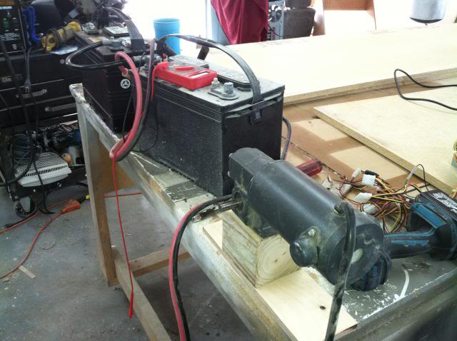

    I wanted to do a little testing on the batteries and motor today as well.
    Two 12v deep cycle batteries in series resulting in 24v and one of my motors bolted to the table. The motor without load pulled 3.2 amps and under load (heavy weight attached to arm) 14.5amps.
    Now that I have a power source (I actually had those batteries sitting unused as they are destined for my wind generator. What better way to recharge them for the motion pit?!), have tested the motors, and ordered the misc mechanical parts, I need to get a couple motor drivers. I think I will take the chance on the Chinese drivers. Two of them for less than 50.00 delivered is hard to resist. If I am lucky they will work fine...if I am unlucky I am out a little money but will have the piece of mind and not wonder what if. The gamble is not that great. I also have several potentiometers that I can use for the project.
