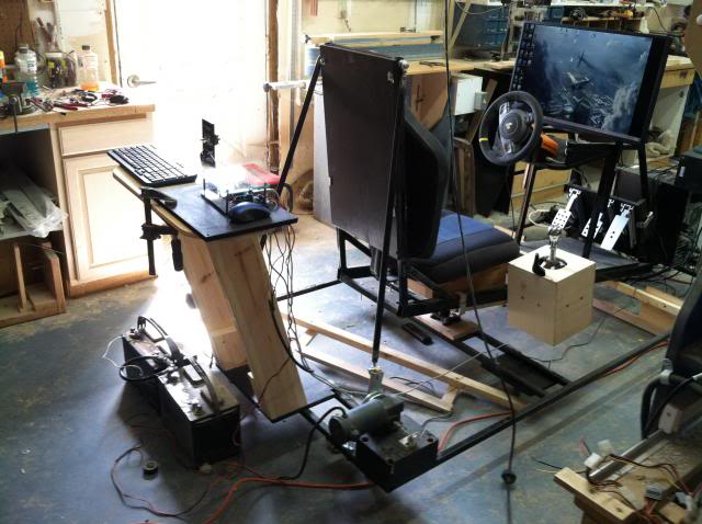

    Picture update:

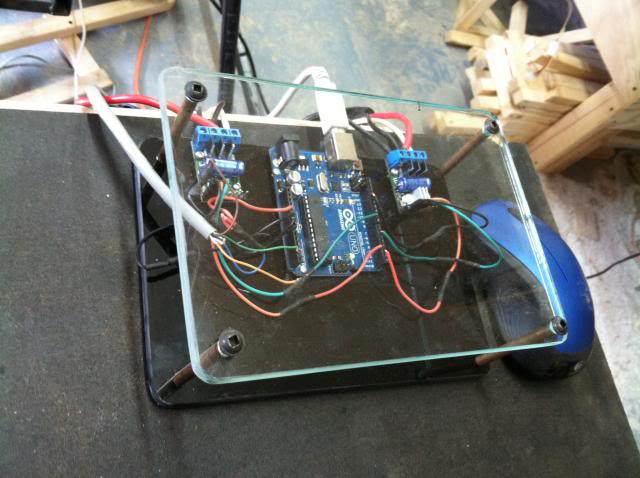

    I applied some heat sinks to the Pololu 755s, replaced the 15amp fuses with 20amp units and connected 24v to the motors. Night and Day difference between 12v and 24v. The platform jumps! (literally)
    I am using standard 270degree pots so there is about 10degrees of lash at the center....shakes the poop out of the entire structure lol. Doesnt seem to overheat the motors though, everything was functioning well except that the motion is entirely too quick, too much force.
    Because of a defect in my Ardiuno I cannot edit the sketch to reduce the motor power (as Mat kindly pointed out that I could). So I am going to try to do so in SimTools instead. I reduced the axis assignment power setting to 25% but when I started Race07 the whole thing wanted to jump from one side of the shop to the other! Didnt hurt anything, but it was exciting for a minute (no I was to chicken to actually try to sit on it during these tests and a good thing too).
    I am going to read up on Simtool settings and see what I can do. I will also replace the standard pots with 10 turn pots (only thing that I have around right now but I will order 5 turn pots as well).
    My Arduino/Pololu box:

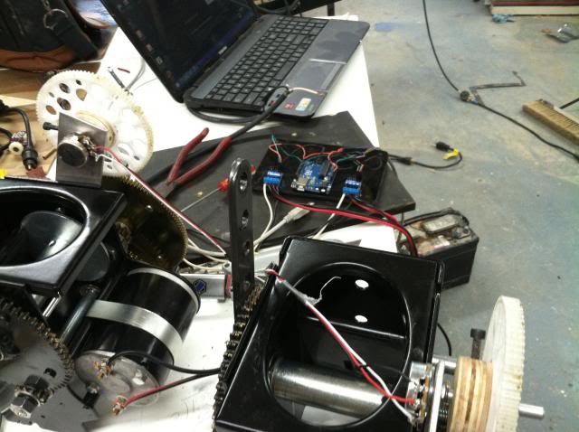

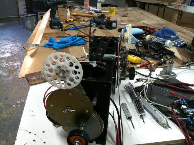

    My winches and Pololu package showed up yesterday!!! Yeah! And my heli gears showed up today! Yeah! I opened the package of Pololu JRKs and found that instead of 12v12 (that I paid for) they shipped two 12v3 units to me :(
    Now I have to wait for them to receive the return package and ship the correct items. I should have bought them directly from Pololu instead of through Amazon.com :(

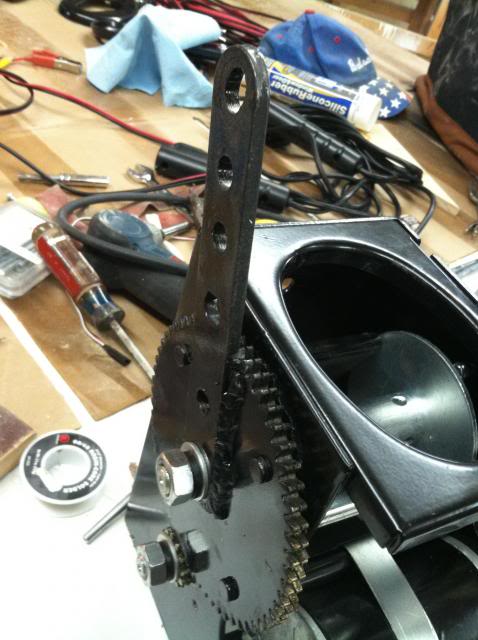

    The winches are torn down, I used the winch handles as lever arms and welded them to the gear (as per Rob's pictures). I also removed the large loose wire guards on the inside, they cause the clanging noise noticeable in some videos of winch use. Nothing I can do about the growling that the gears themselves create though. Still thinking about building enclosures.
    I am still debating using hall effect sensors; it would not be that hard to install them, nor connect them (I have built hall effect sensors into several custom joysticks) but I do already have the heli gears so I might just go with 10 turn pots (because I have them laying around).

    I have not had time to actually mount them to the framework yet but they are converted and ready to be mounted. I only have one problem yet to figure out.
    I am using standard 270 degree pots right now as the 10 turn pots short the arduino out for some reason. There seems to be a short in the pots themselves, not sure why. They work perfectly with the Teensy++2.0 as joystick axis. Here is the problem with the 270degree pots:
    I can only get about 10 degrees of movement on the winches. Which makes sense when you think about it as the motor itself is moving the full movement of the sliders but of course that movement is greatly geared down by the time it reaches the lever arm. Is there a way to multiply the movement of the pot as far as the Arduino is concerned? Or can this be done in SimTools somewhere?
    Even if I do replace the standard pots with hall effect sensors they will still have about the same swing area (hall effects read the magnetic orbit so no more than 360 degrees rotation). So I will need to figure out how to tell either the Arduino or Simtools to assume that any movement is much larger than it is reading (or do I have that backward?).
    Anyway, here are my winch motors converted for motion use:
  17. Historiker
    2,163
    9,212Coins
    +2,177 / 19 / -1
    Success!!!!
    I figured out why my 10 turn pots were shorting the Arduino...er...I wired them wrong :)
    With that sorted out I mounted the winches and fired up the computer.
    I tested everything out, got Grid2 working great (failed with Race07 and Unlimited Rollercoaster...not sure why).
    After playing around for a while I convinced my daughter to try it out, although I did get a video of her driving (mostly crashing) she refused to allow me to post it on youtube! ;)
    So I just posted a clip of the winches in action here:
