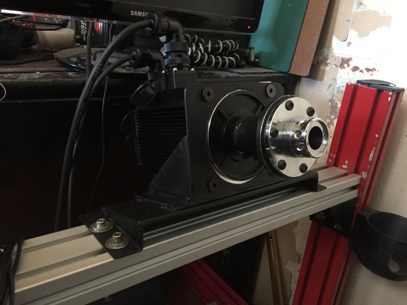

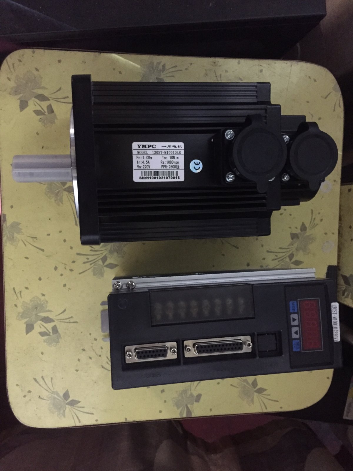

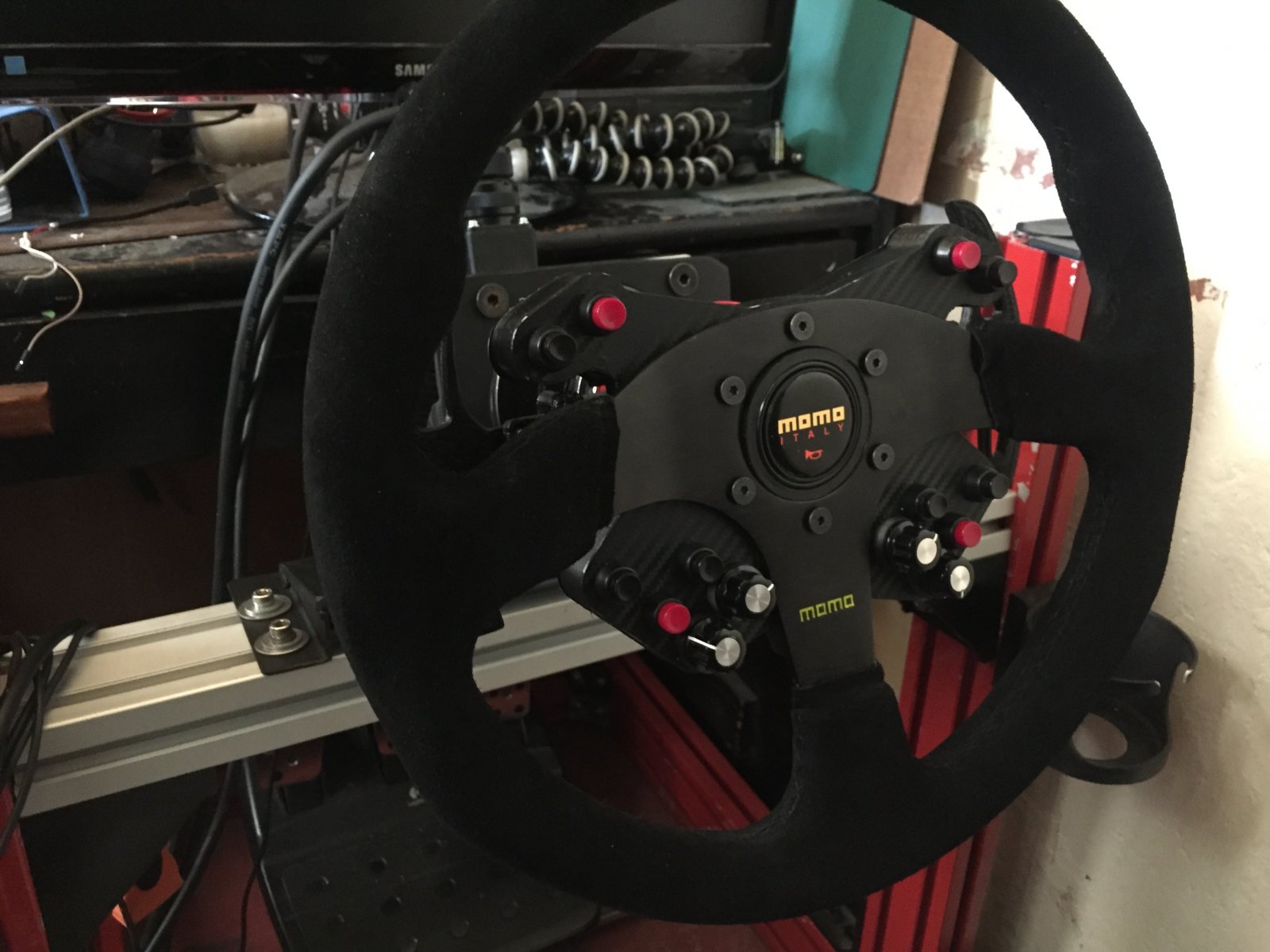

    Jumped down the rabbit hole with Thanos TDD controller with AASD30A Servo kit
    1x Thanos TDD
    1x AASD30A servo driver kit incl 130st motor

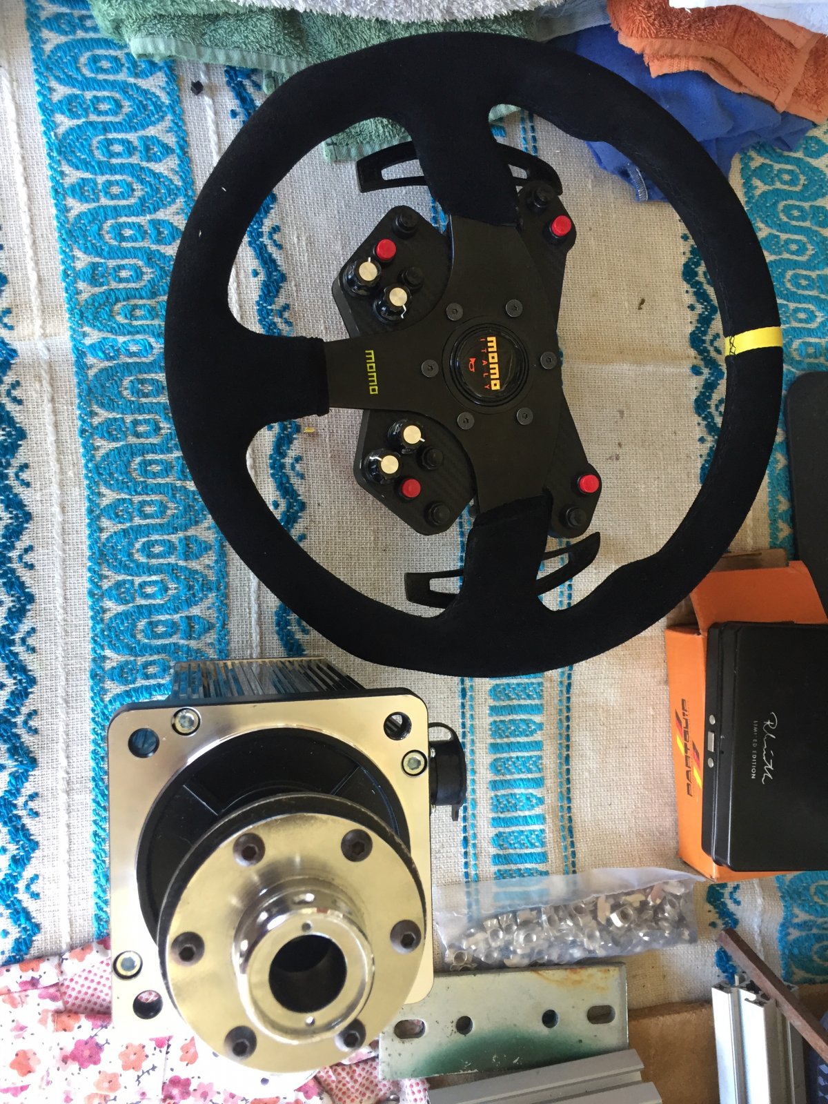

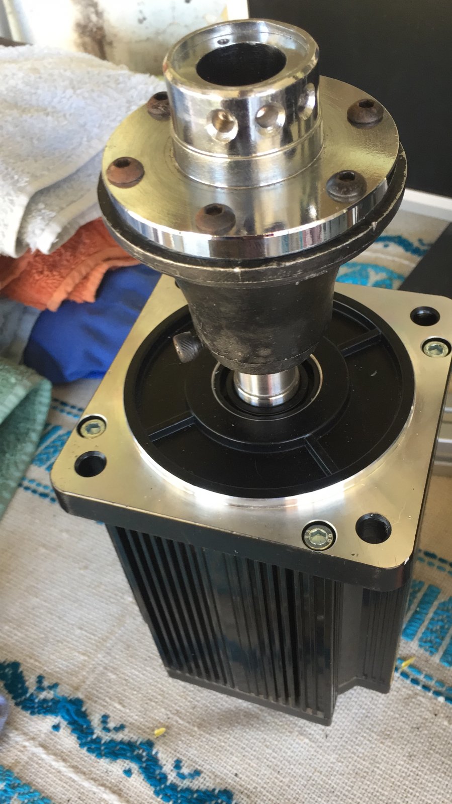

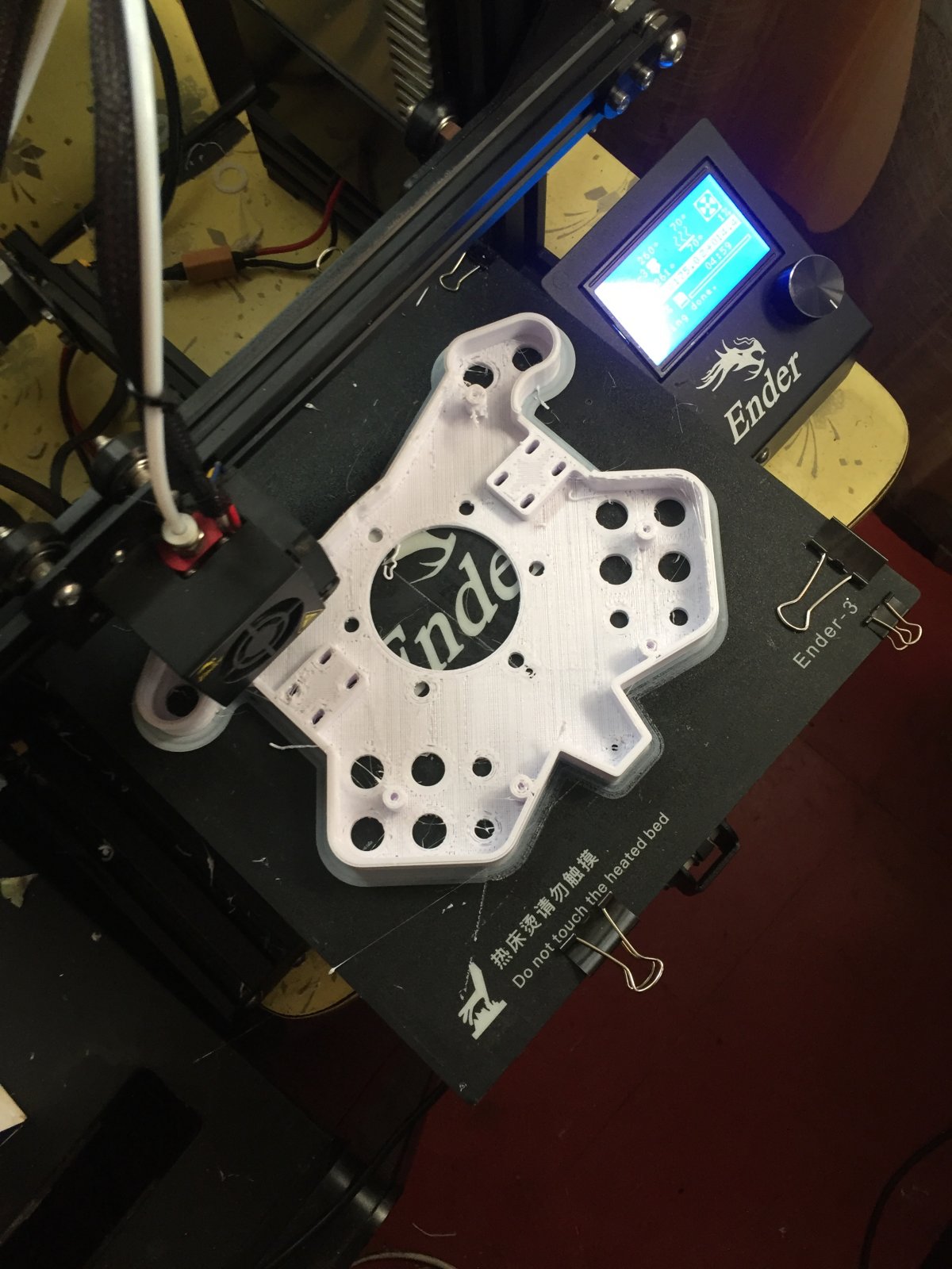

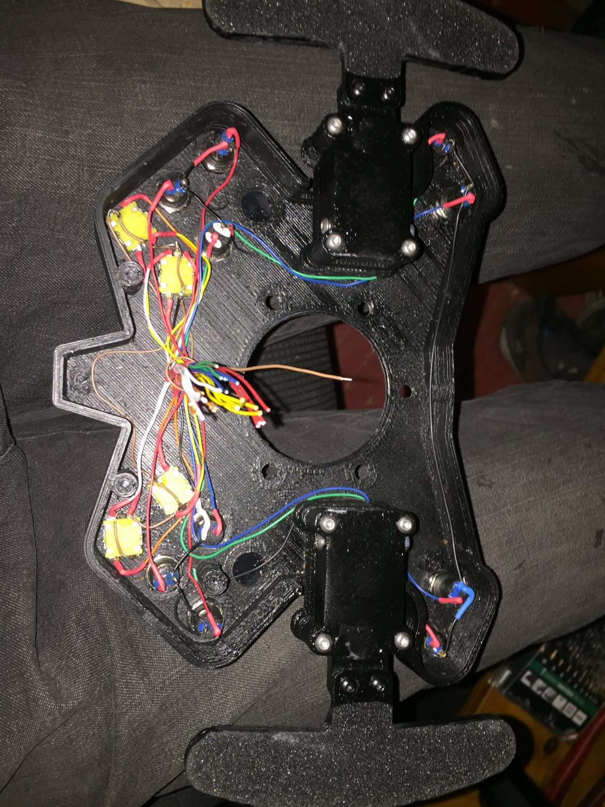

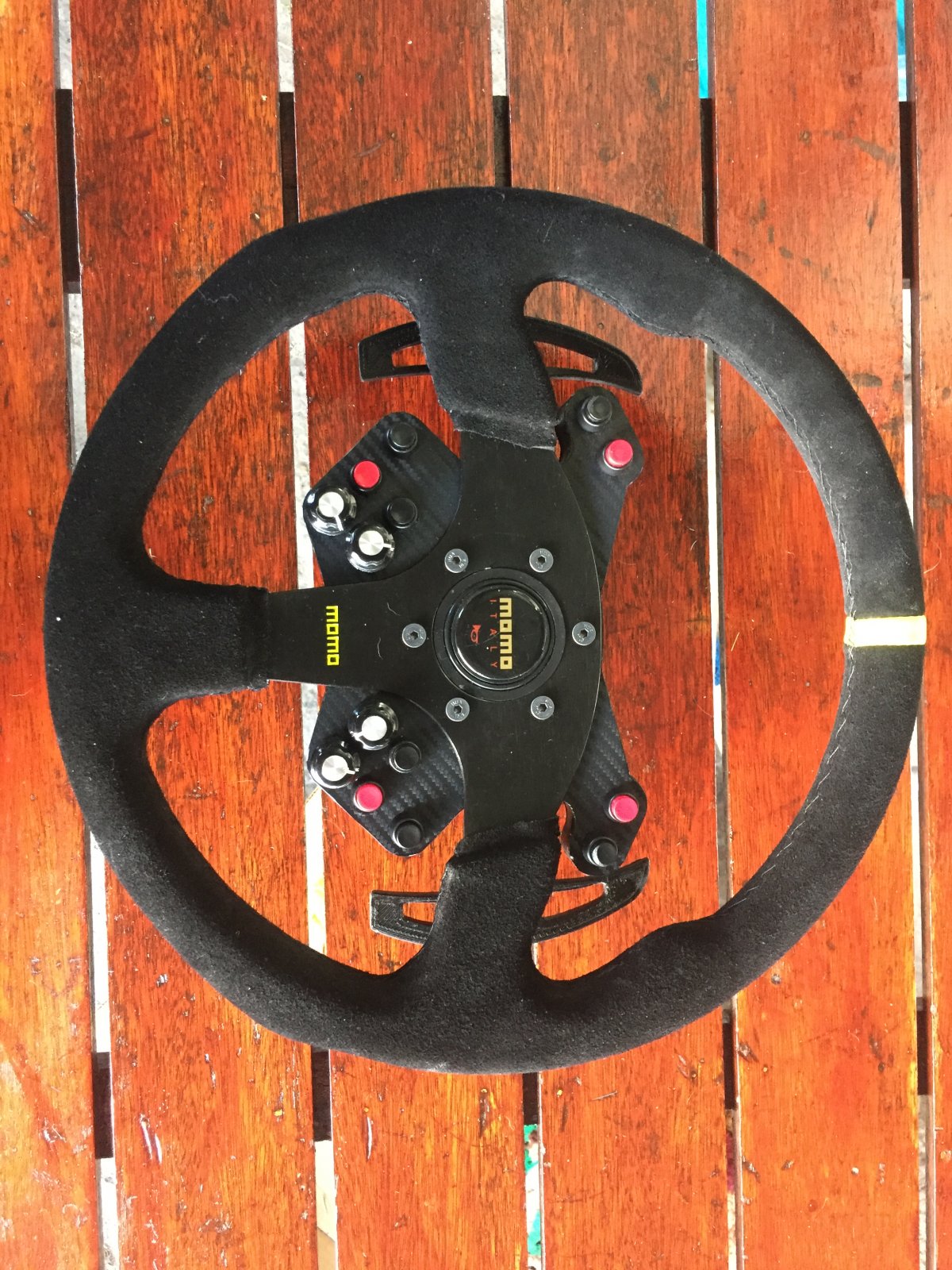

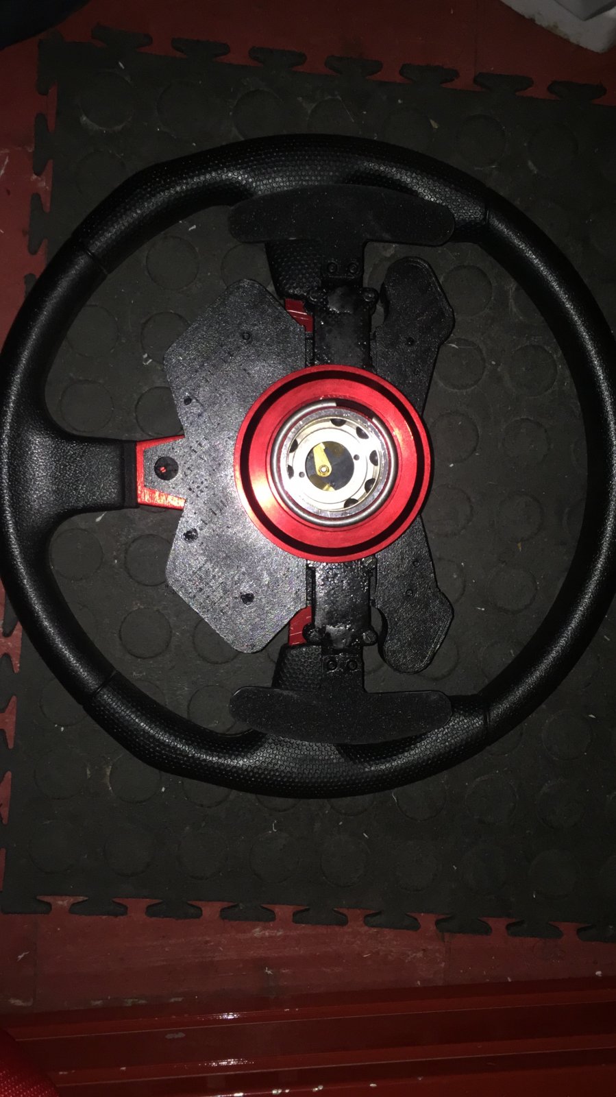

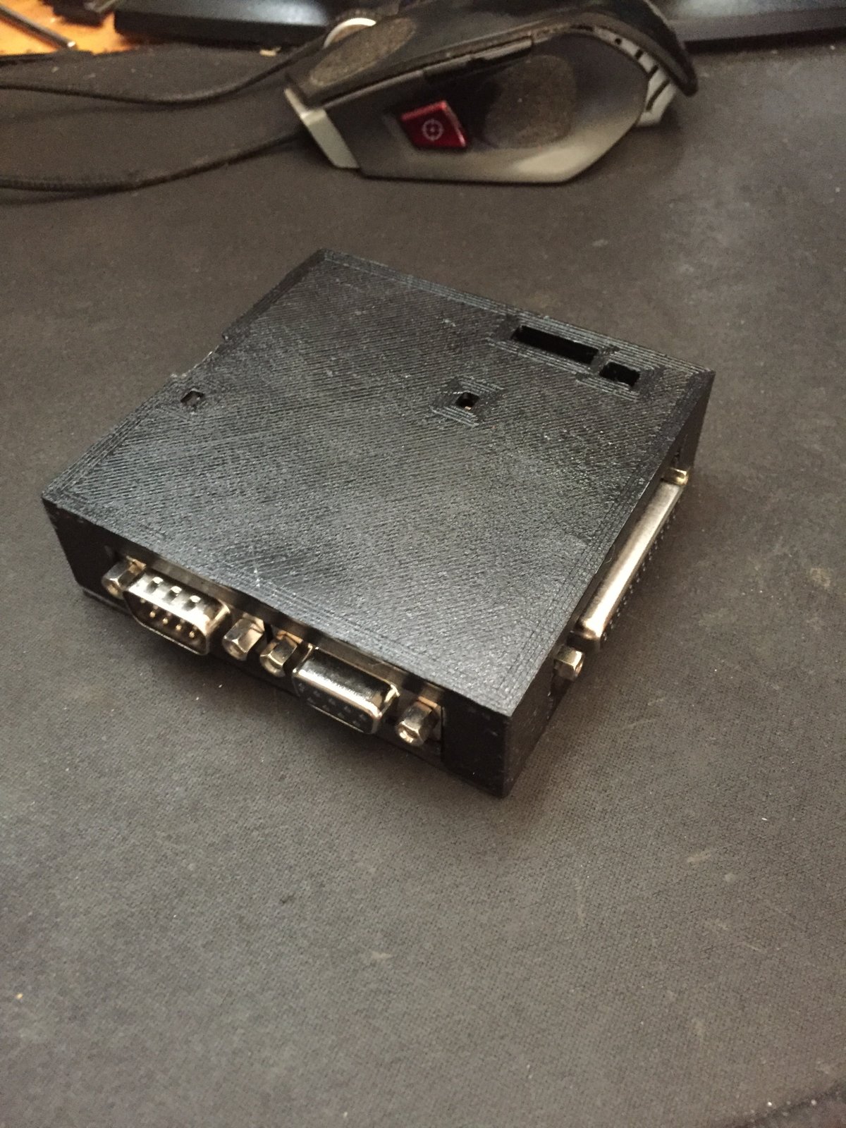

    FA2B271E-D285-4DA3-90F4-B19E8DB0189C.jpeg 069F337D-E394-4FB4-87AA-E280E8577722.jpeg 3d printed the button box, some modifications had to be implemented for the wireless device

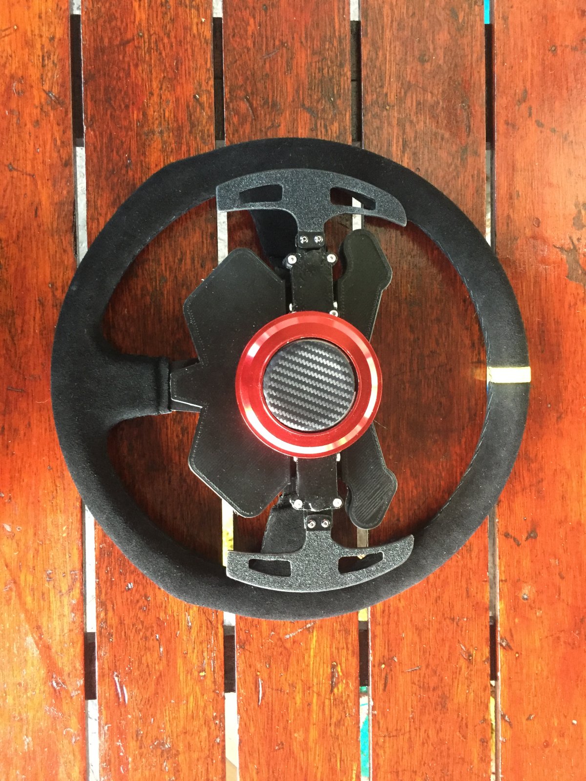

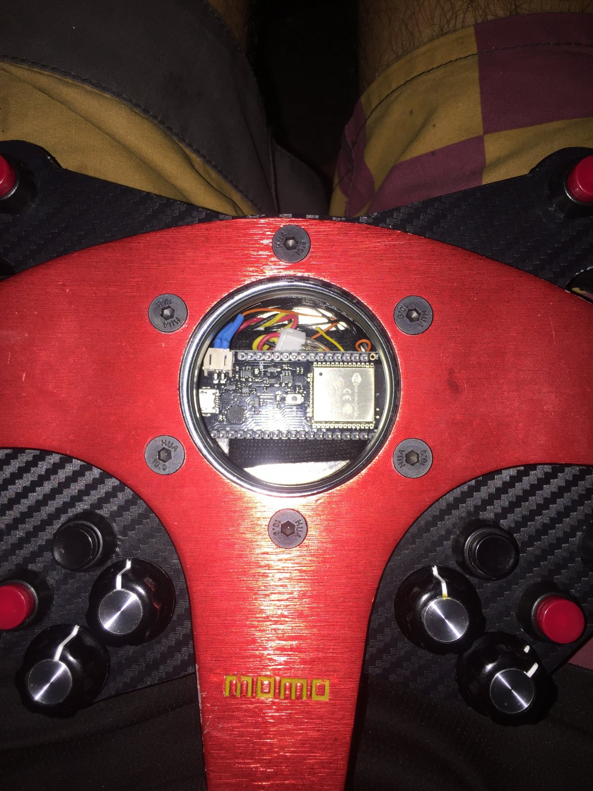

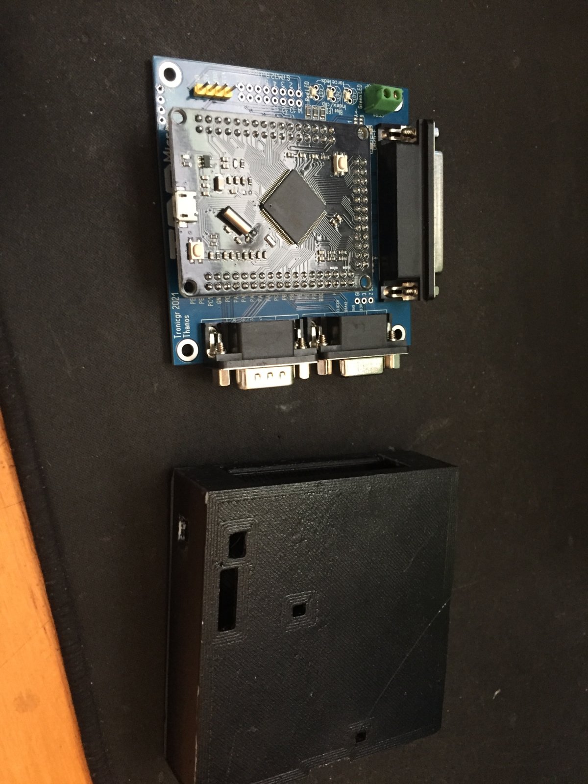

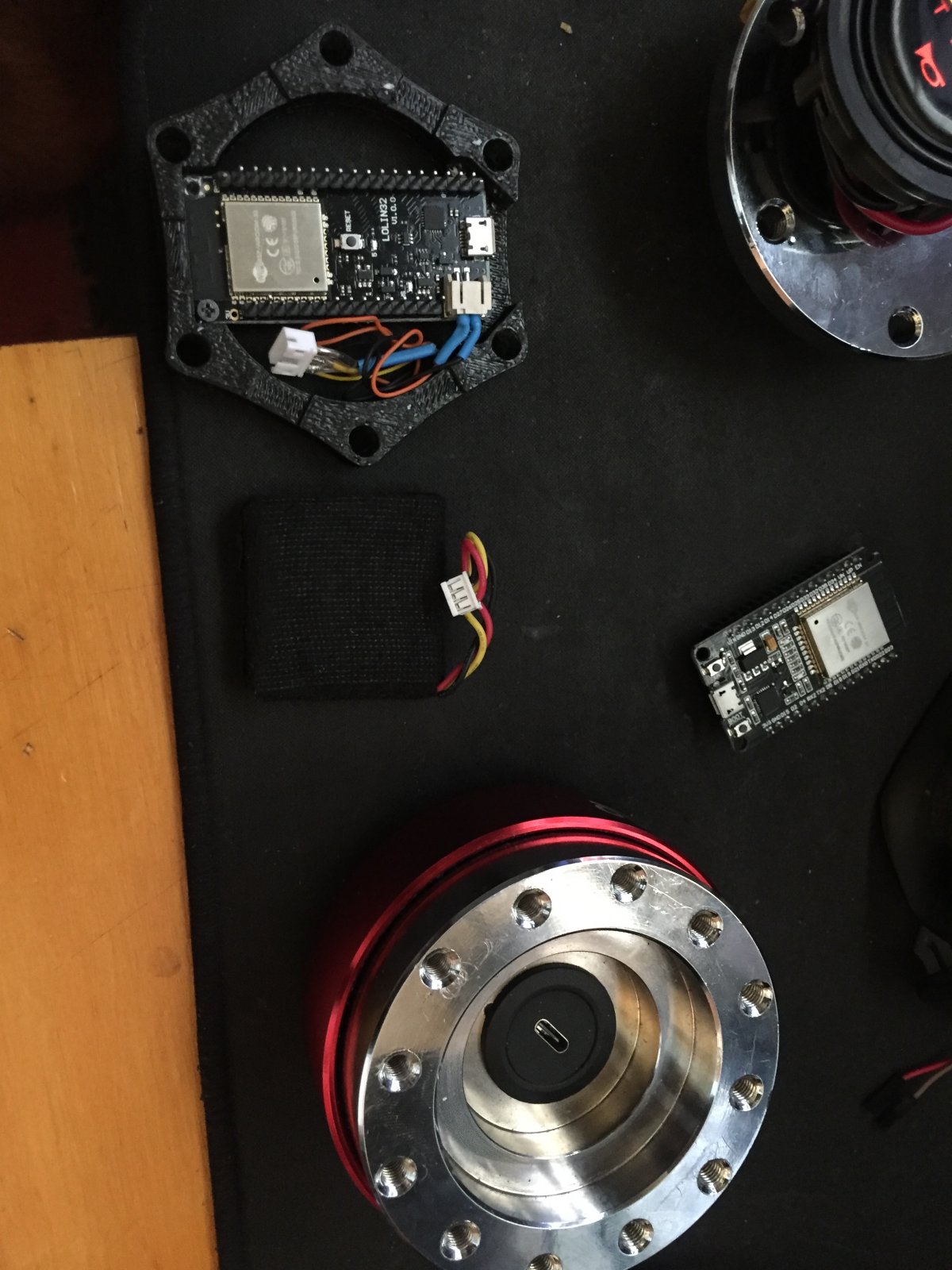

    Esp32 with 950mah lithium battery. Creating the wireless button box

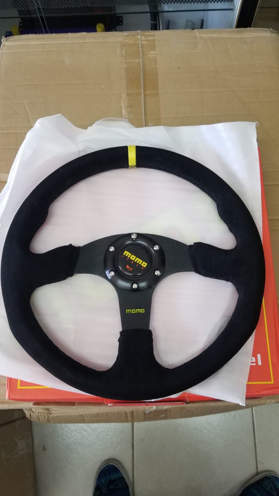

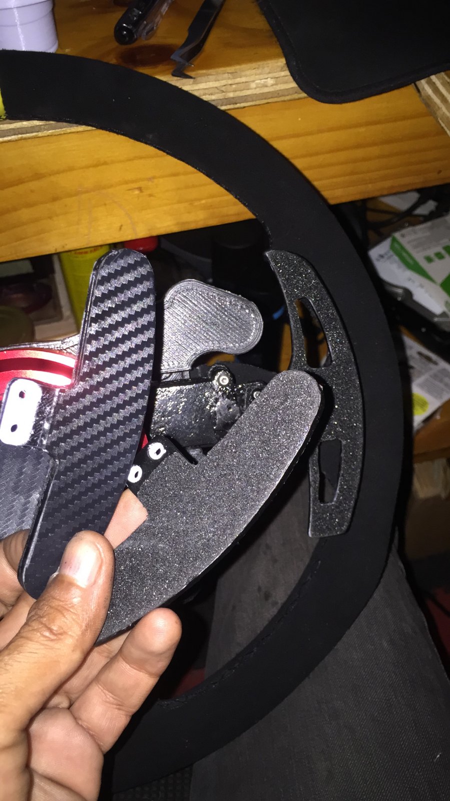

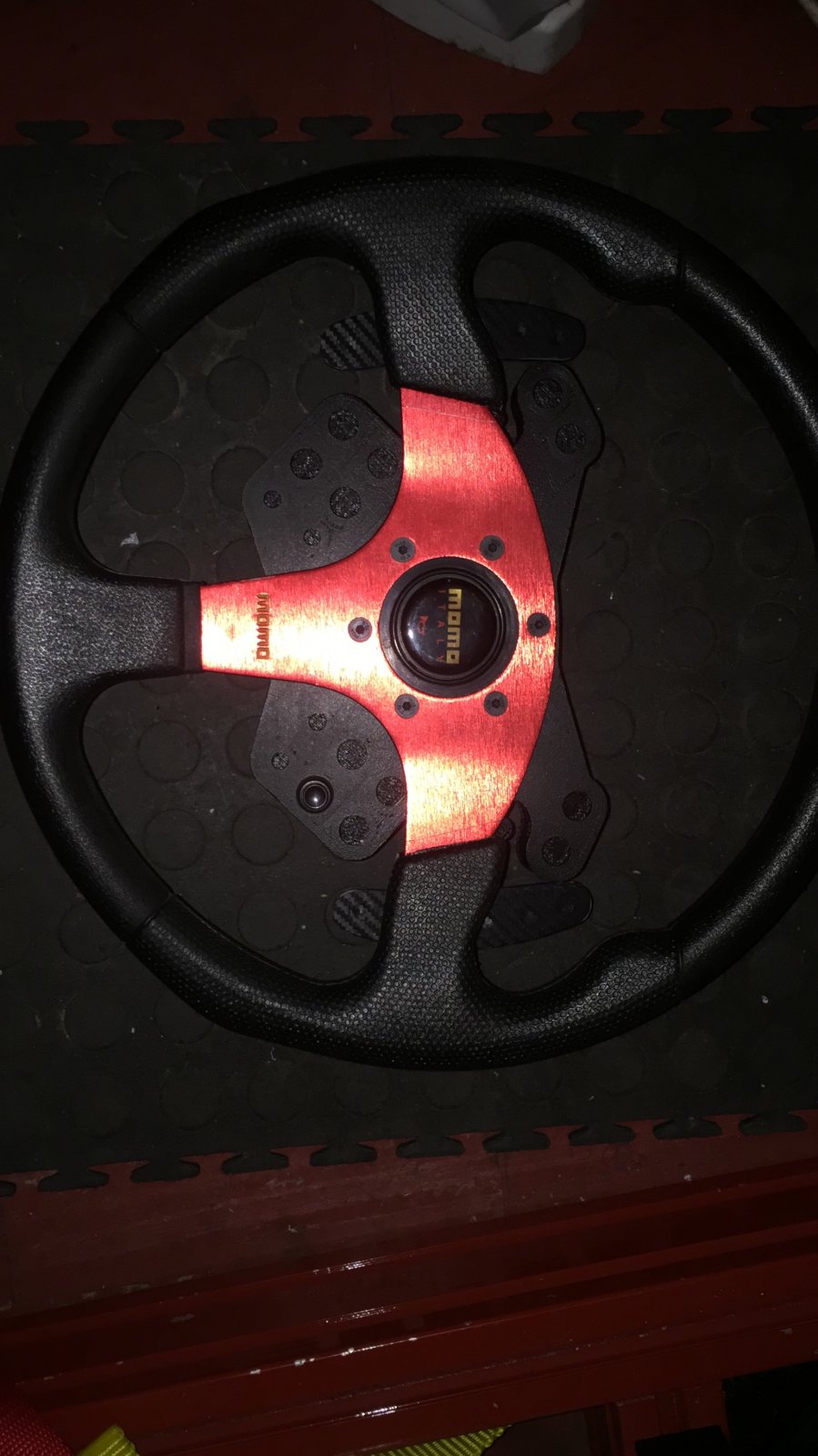

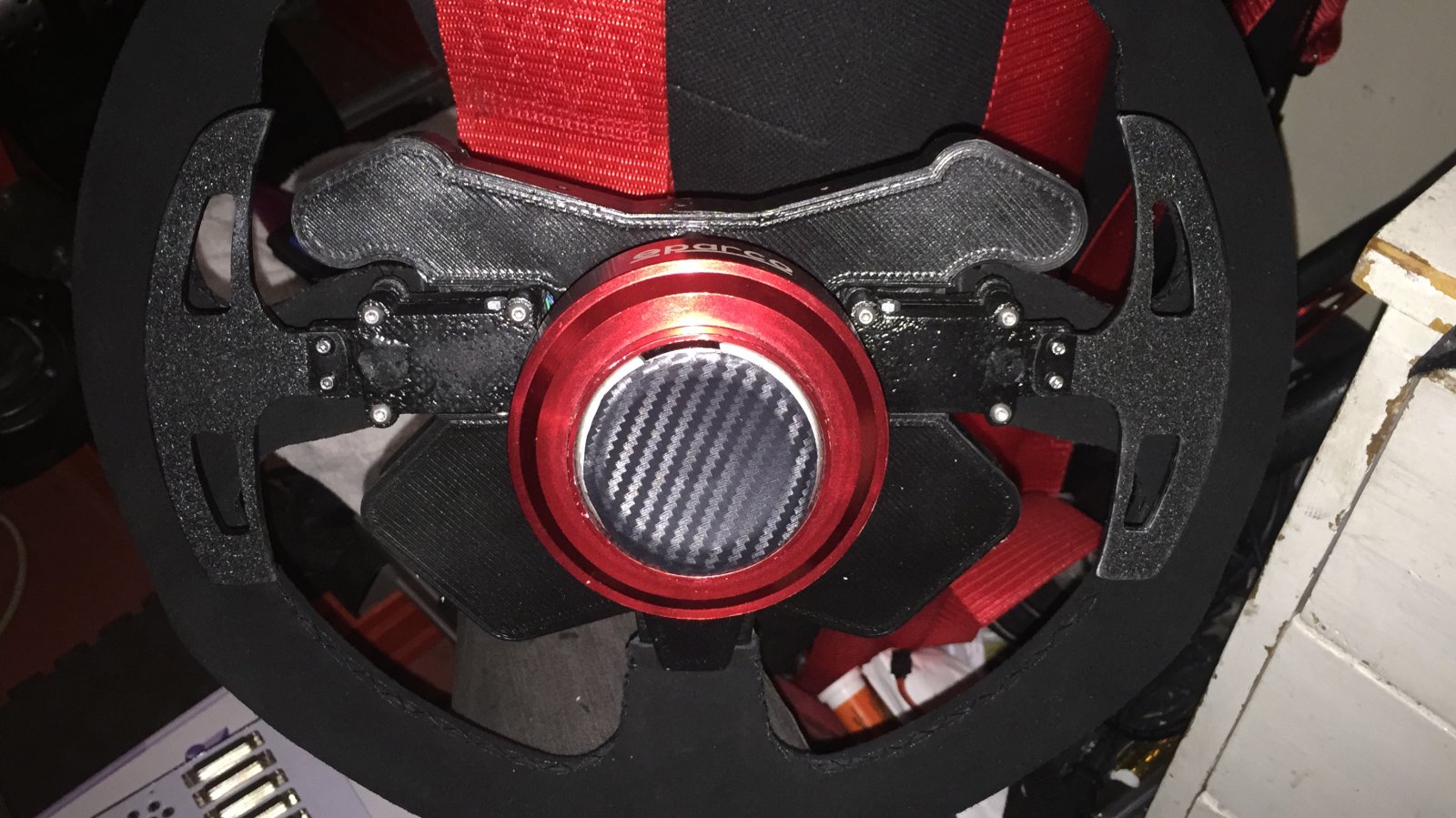

    Suide 340mm Momo rim, few upgrades to the paddle shifters og felt to mediocre

    Currently using MMOS firmware set to 11Nm, well balanced. TDD makes its a breeze to setup incl pedals and shifter, slight EMI noise not noticeable when racing overall coming simucube Mige , Accuforce, fanatec dd1 this feels between almost the same as all three depending on the software configuration as it can be different between games. Extremely happy with the results
