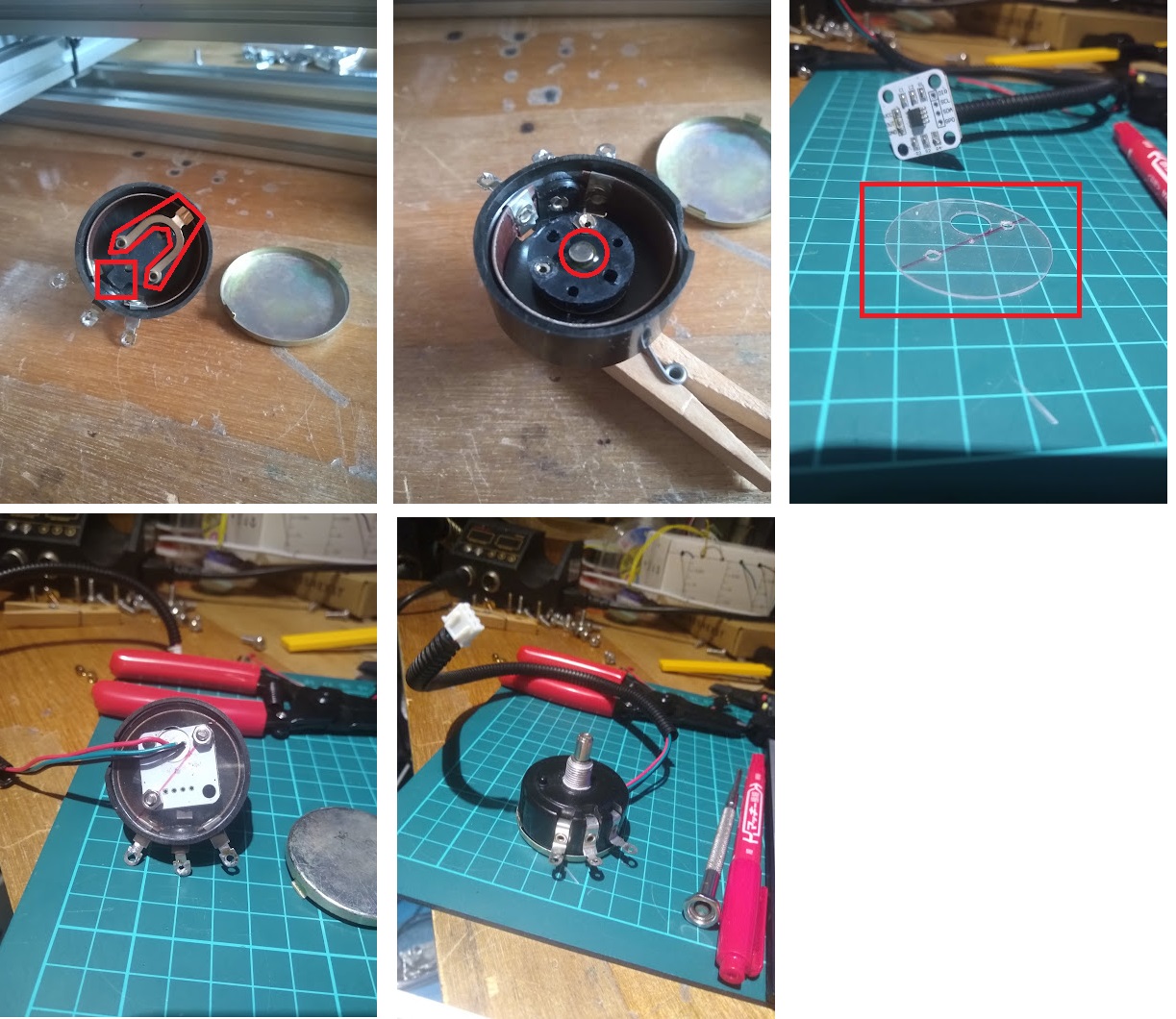

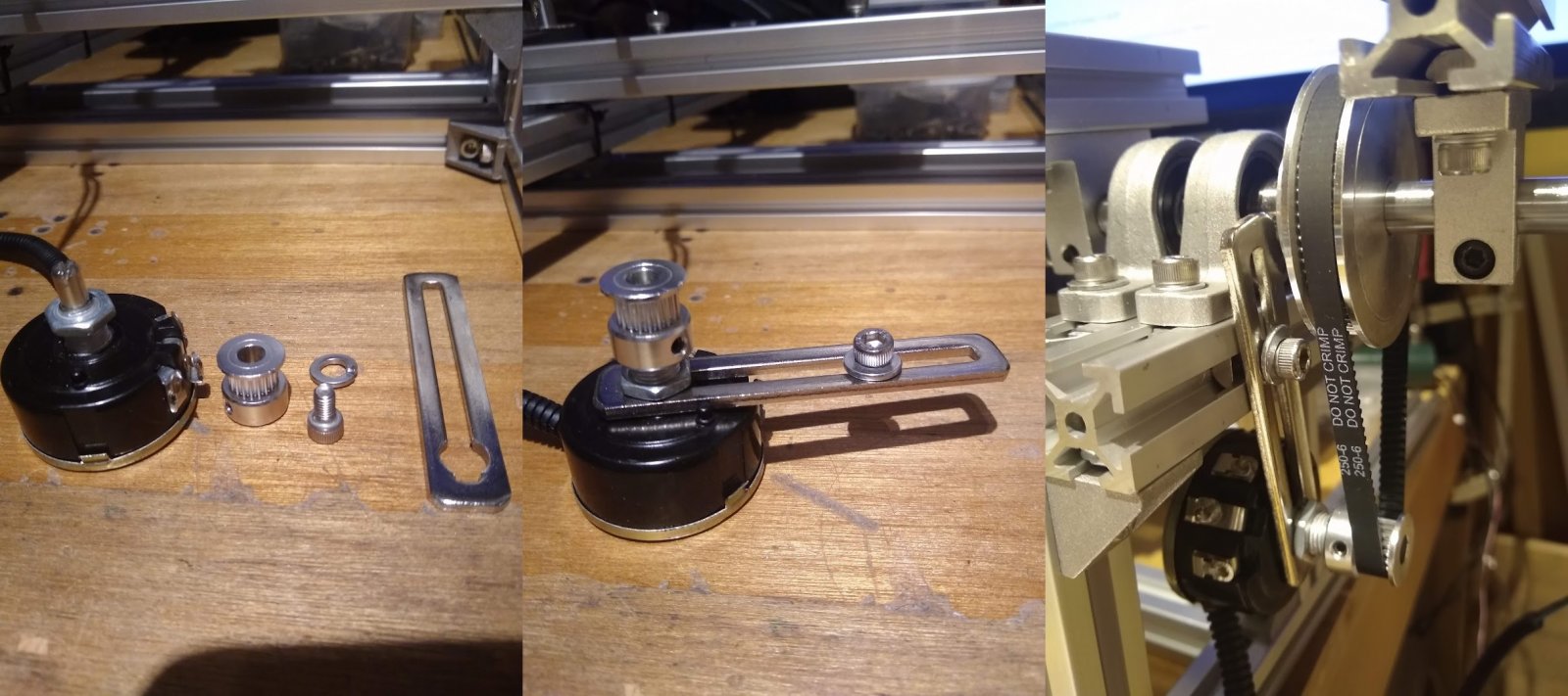

    I made 360 degree encoder from scrapped potentiometer and AS5600 position sensor breakout board.
    The potentiometer I used: https://ja.aliexpress.com/item/1005001708276947.html
    Top left: Opened potentiometer. Red area needs to be removed.
    Top center: Grew magnet comes with AS5600 at center.
    Top right: Create mount plate.
    Bottom left: Put it togethr and put into potentiometer
    Bottom center: Done

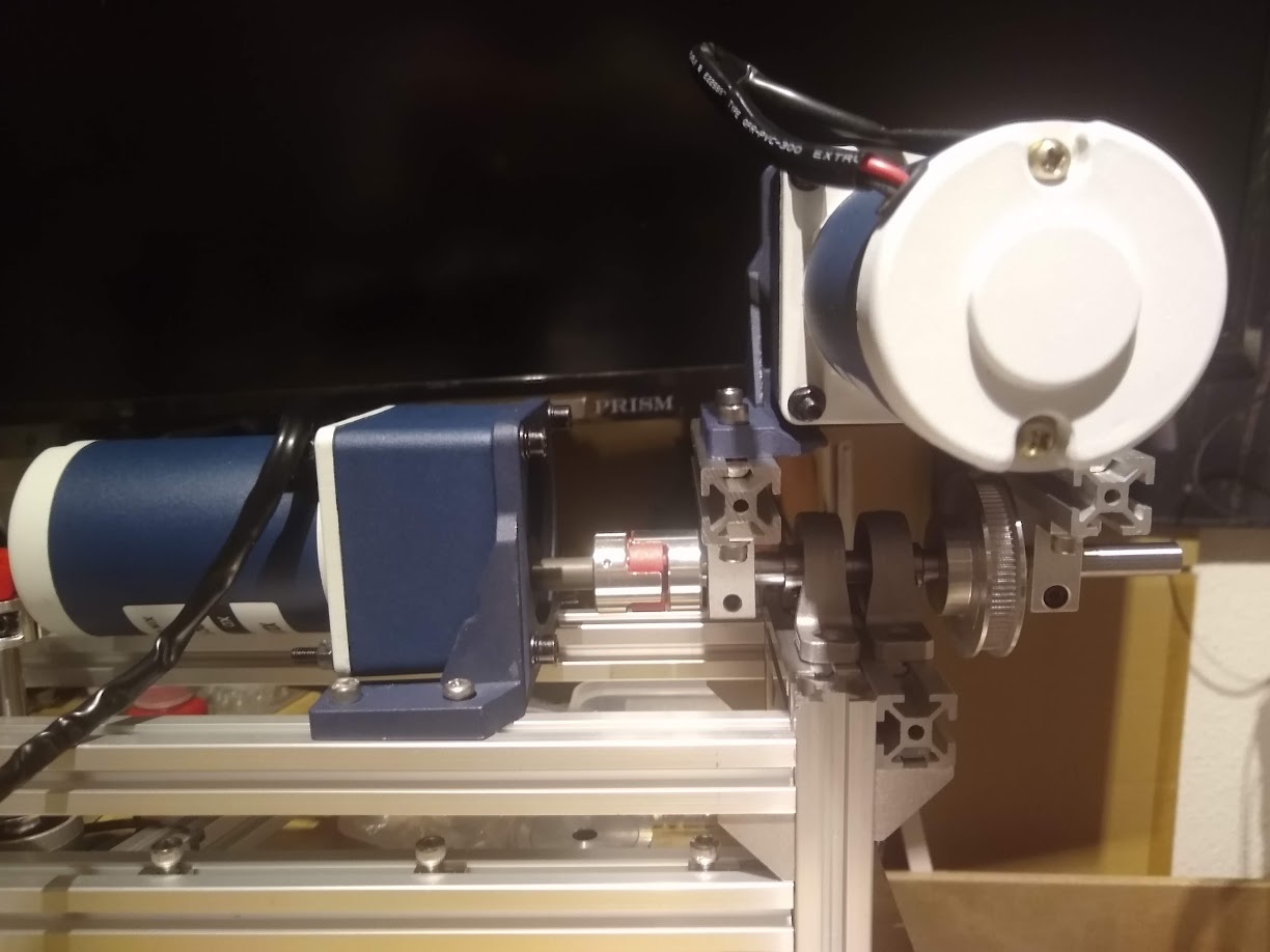

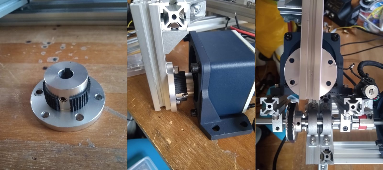

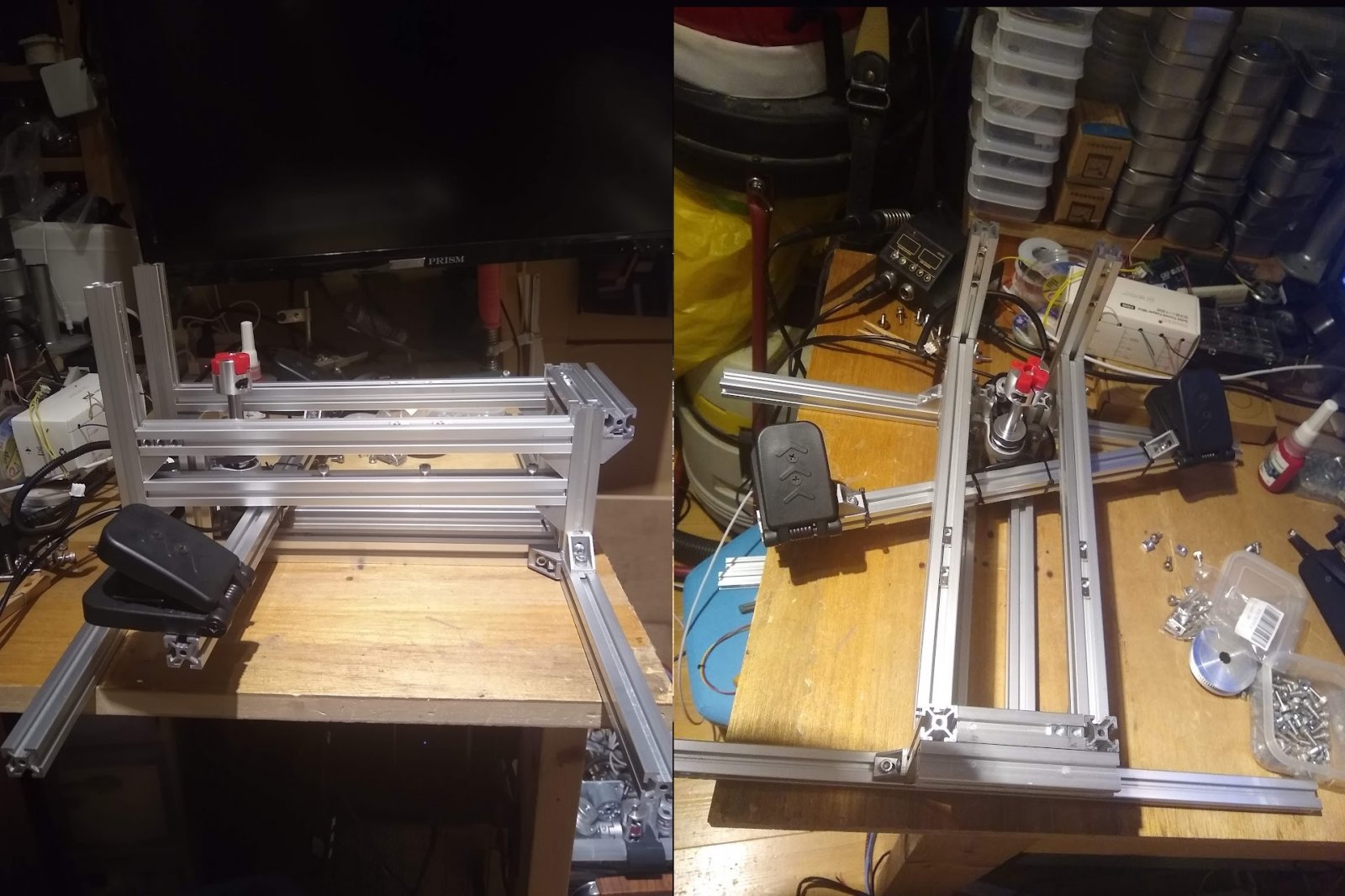

    I am updating my FFB joystick because of facing an issue of slipping rod. To fix this issue, I need to change my rod from alminum to iron and apply Anaerobic Adhesive (3M TL90J) between rod and motor coupler etc...
    And I am going to use this encorder.
    Please find attached photo. This is the base of my FFB joystick. I will upload some photos about mouting motor etc afterwards.

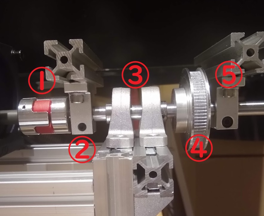

    From left to right. Rod φ is 10mm.
    1.Motor coupler (already applied Anaerobic Adhesive )
    2.Linear Rail Shaft Guide(2020 Alminum profile is already mounted)
    3.Two Pillow Bearings
    4.GT2 timing pulley (80th teeth)
    5.Linear Rail Shaft Guide

    Finally x and y motor was mounted like this.

    X axis encorder build and mount to FFB base.Please find attached photo.
    Left : Parts list. Arm needs 10mm hole for mounting potentiometer.
    Center : All parts are combined like this.
    Right : Mount it to FFB base (Y motor was removed.)

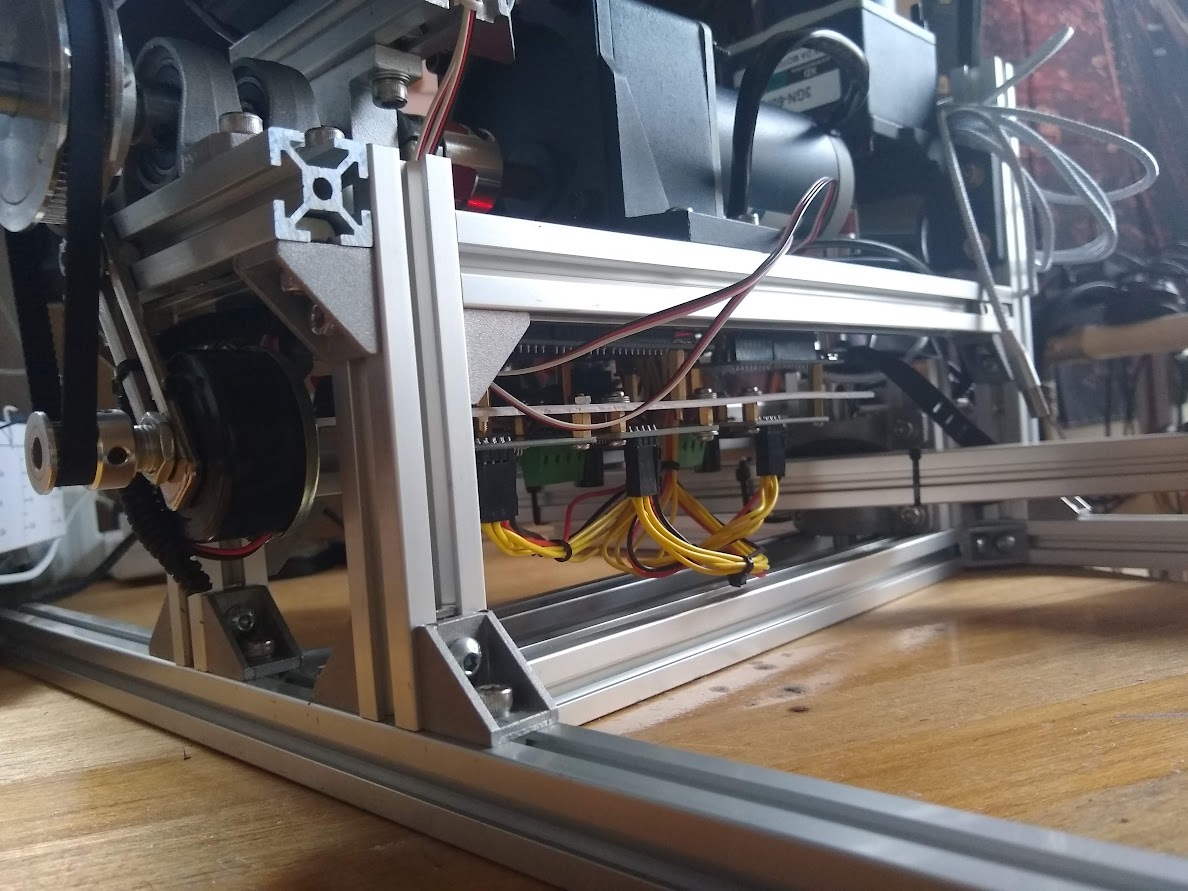

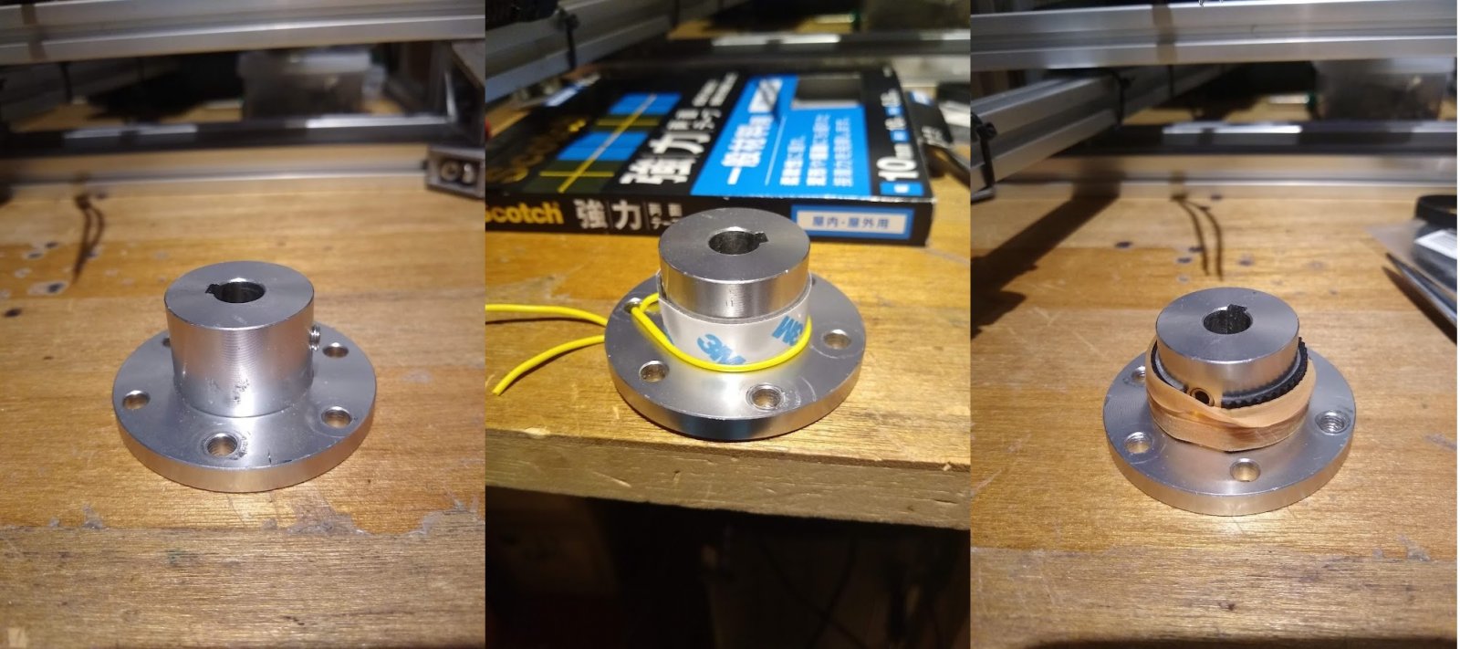

    Y axis encorder build and mount to FFB base (part 1).Please find attached photo.
    Left : Motor flange (φ10mm + Key)
    Center : Put double side stick tape. Yellow wire is for some space from edge.
    Right : Place timing belt. Holding by rubber band over night.

    Y axis encorder build and mount to FFB base (part 2).Please find attached photo.
    Left : Motor flange with timing belt.
    Center : Attach stick part (2020 alminum profile) to flange and mount it to motor axis.
    Right : Put it to FFB base. You can find encorder (most right) which was purchased from Ali Express.

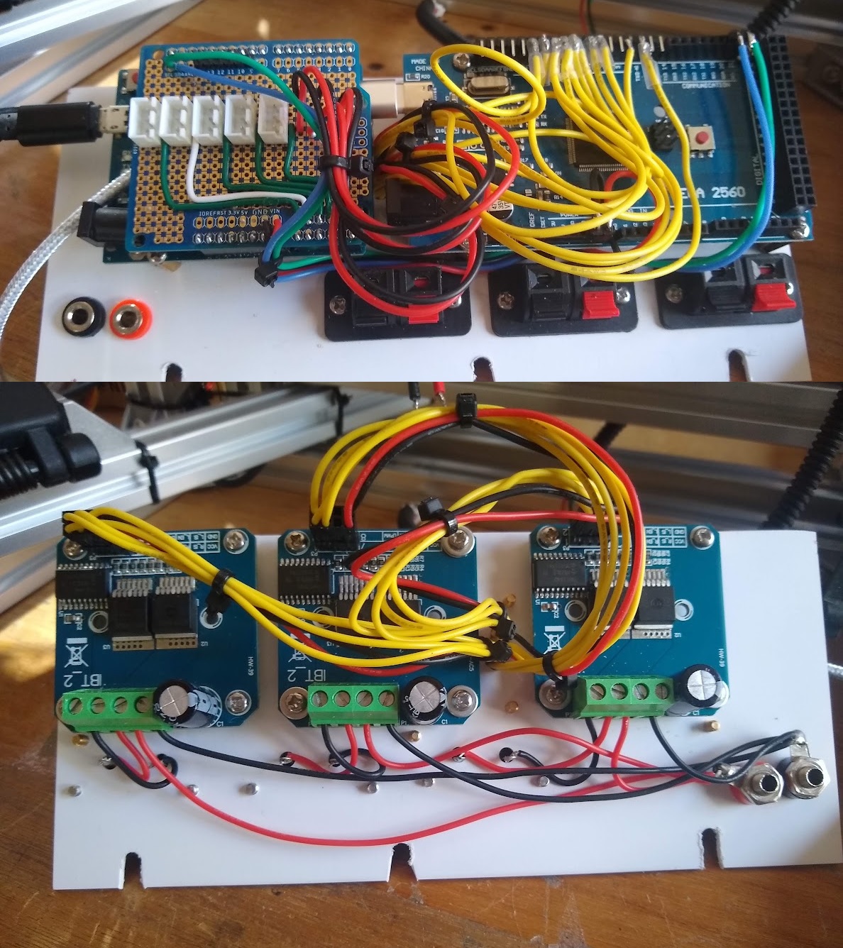

    This is my FFB controller. (Top and bottom view).
    You can see Arduino Leonald (left as joystick controller) and Mega2560(right as PWM motor control).
    Code can be found in my GIT. https://github.com/GNZ-3/ArduinoFFBJoystick.
    Schema diagram in GIT is little bit different than this photo. FFB_Controller.jpg .

    Controller board was mounted on my FFB base. Please see attached photo.
    I will mount this FFB base into my 1 DOF rig. Please wait for my test filght movie.
