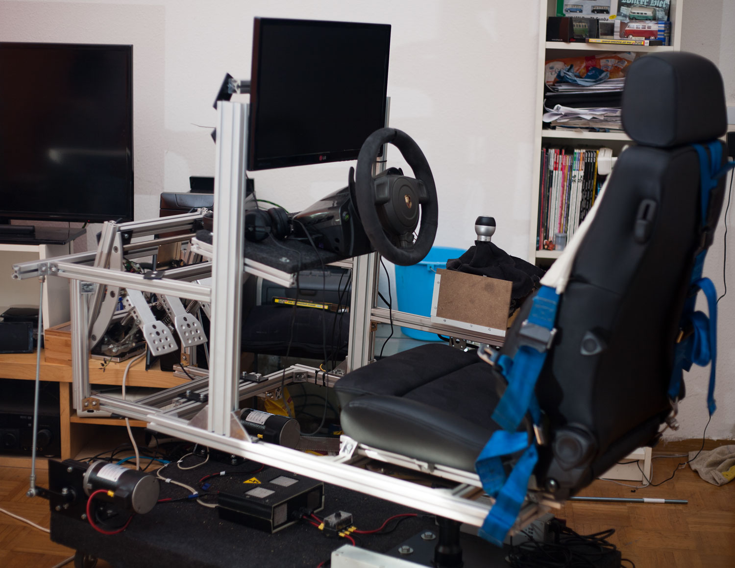

    After getting the rig mor stable I now can see that the M8 rods are not very good. I ordered some m12 rod ends and will upgrade if they arrive.
    With your help I get my motion profile better and better. But i have one very big Problem. At the moment I only added Sway and surge no heave yet. I increased the number for surge until braking or accelerating there is nearly no movement left. But if I drive over a bump in Dirt rally my rig jums up and down and the whole plattform is jumping through the room :p

    If possible attach it to the floor. Mine is screwed down to the floor. Or a base that is heavier and has a wider base. Maybe it's twisting. In which case make it more rigid.

    I think this will not be possible because I live in a rented appartement. But maybe I can add some bodybuilding weights easy to my platform.

    If done some litte changes to the structure. I added some tubes for Lcd and 3 in the front for stiffness. Also I added my shifter. It is an Bmw steptronic. The housing isn't finished completly. At the moment i try to figure out some problems with the wheel. Maybe i have to dowgrade the firmware.
    I reduced the Motor settings and now I got a much better movement. It's getting better and better and I had a lot of Fun the last days.
    So again I would like to thank all the people here in this community. Thanks for all your help to getting me where I am.:thumbs
    Also I've orderd new rodends to make my rods m12 like recommended.
    And also I've ordered a new 7 port USB hub with metal case and screwholes. This should be easy to integrate.

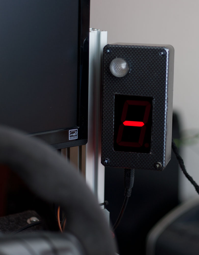

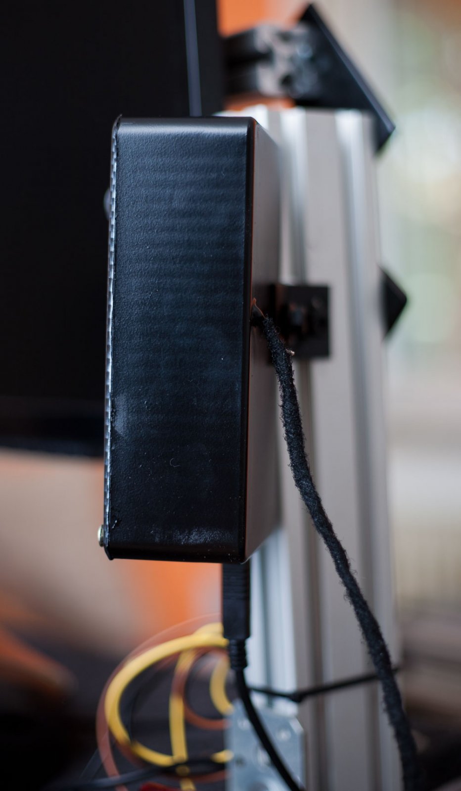

    Added Gear Indicator with Shift Led.

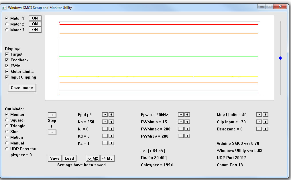

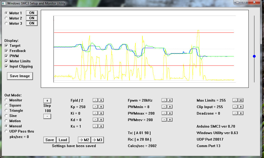

    after playing around much with the settings and even got frustrated, i found the fault.
    I made a video. I move the motors with output testing. As you can see the front motor has a strange behaviour. Both motors are build up with same cabes connectors etc. as on the other side. Smc Settings are identicly.
    I checked all wires and Pot feedback in Smcutilitys looks good also. Can this be a MM fault? Because I broke the one on this side and repaired a trace. I also ordered a new one hopefully it will arrive soon and it was this driver.

    might be mm, switch sides and see if the other mm does this on the motor with error. what is smc3 settings. run utility and post screen shot so we can see. i had similar behavoiur and it was a cooked or bad monster. but could be settings.

    Nice build.... Where can you get this gear indicator, how does it plug into the system? thanks

    @helisfreak
    You can't buy it somewhere. I build it my self with Arduino and Bcd to letch decoder to drive 7 segment. This are party i have laying arounnd from my cluster Project, since this will takae longer time as i thougth.
    You can find some info on my other thread about the cluster.
    http://www.xsimulator.net/community/threads/diy-switec-dashboard-with-menu.7056/
    I've used a more esy wireing because it's only gearindicator and shiftlight at the moment. Inside there is a little breadboard glued where all parts are on. I'm to busy to make a pcb at the momement.
    If you are interested in more pictures from Inside, wireingdiagramm annd code let me know thank i put it together and upload it.
    Before i forgett. It is plugged in via usb and controlled via gamedash. In the second picture the wire coming out from behind, goes to 12V.
    The seven segment display needs 8-9V So i used the 12v avalible with a voltage regulator.
    You can also look at @RacingMat thread. He made a very detailed tutorial for seven segment Gearindicator. :thumbs

    Yes maybe switch sides with pots or replace them. Seems one side moves more than the other. Time for the smart guys to chime in. But switching working parts from your good side may help you find the source of the issue. Swap 1 piece at a time. A pain but a good way to troubleshoot.

    maybe i find some time. It's not directly moving faster than the other side. I checked this with sine wave output. The rithgt motor moves smooth with the feedback line. The other just increased speed at two positions and this will cause him to overshoot and move slowly back to original position.

    Today I swapped the pots and the issue was gone. So one of my pots is defective. I had them from my first simulator build where I had no flexible couplings.
