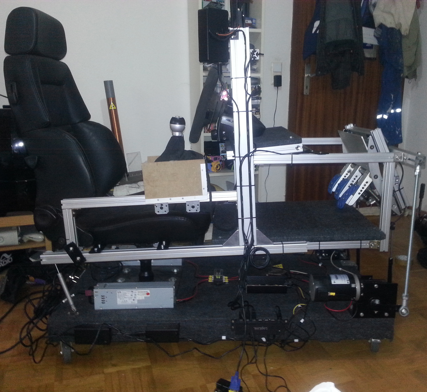

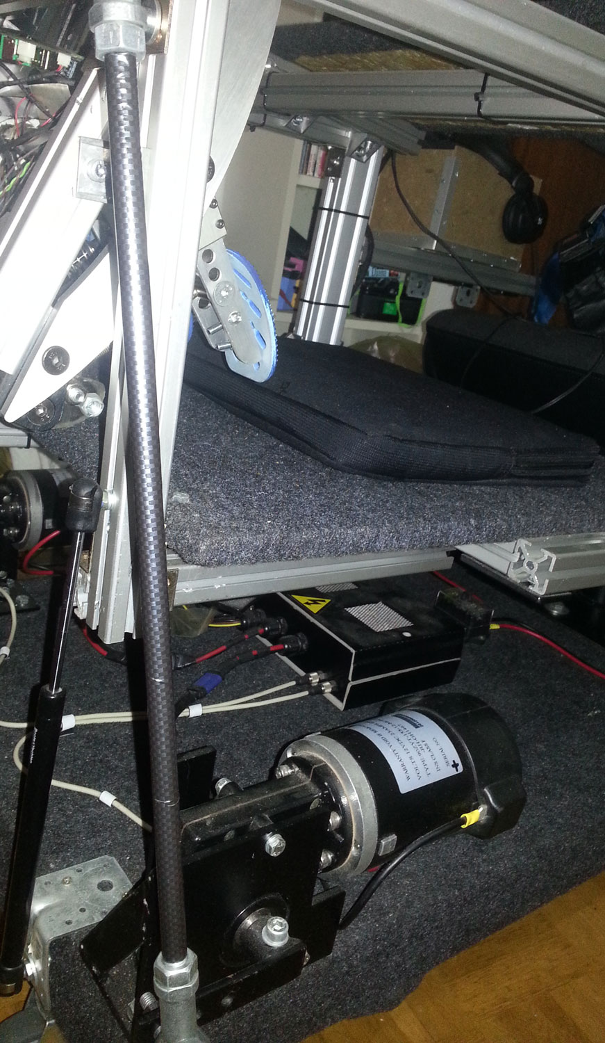

    So today I've rebuild the Simulator. I didn't change much of the structure, but was able to save some Kg of weight and reduced the Seat more to the pivot center. While dissasambling I noticed a minor glitch that i have forgotten. I had not the right screws for mounting everything to my ujoint. After taking the seat apart I saw there was very much slack at this point. I fixed this up also.
    While the whole weight was removed I noticed what @Nick Moxley mentioened in his post 2DOF motion simulator build

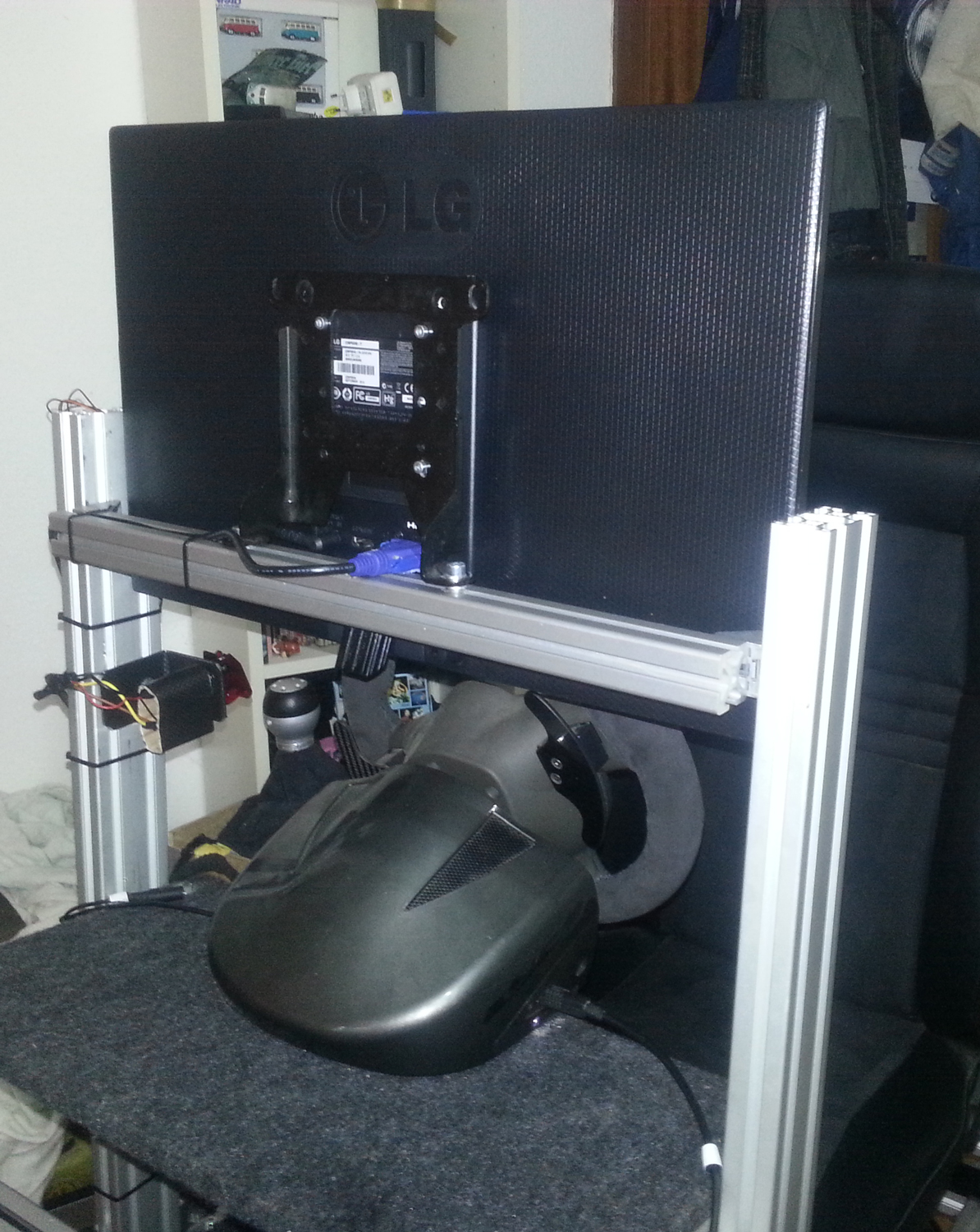

    The slack was now very big. I reassembled the Rig and don't balanced it 100%. Now if I sit in my seat and lean right or left there is no more slack noticable. Before you could move the platform by leaning left or right. The two small spare dampers I had i mounted on the back for testing. I also used the time to clean up my whole wireing of the sim. The monitor mount is a little bit different too.
    I'm still abit confused for my motor settings, but I will give this a try now.

    Thanks to you, I have a lot of fun now. I'm still tuning my settings for the updated rig, but I can say it's much better now.
    There are fast movements and good reaction without going jerky now.
    Before I always had a little sway movement result in a very low gforce feel. Now I can really drive the sim to the sides to feel the forces in corners.

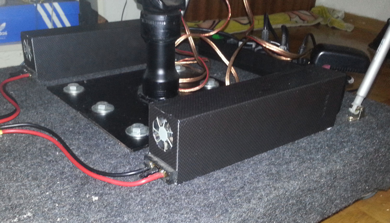

    it's now one month ago since my last post here. I wan't to give a little feedback about my rig. After lowering the platform everything is working nice. I had no issues with heat or failed electronics or software.
    It's no major upgrade but I had some carbon foil left and wrapped the psu's and rods to give it a cleaner look.
