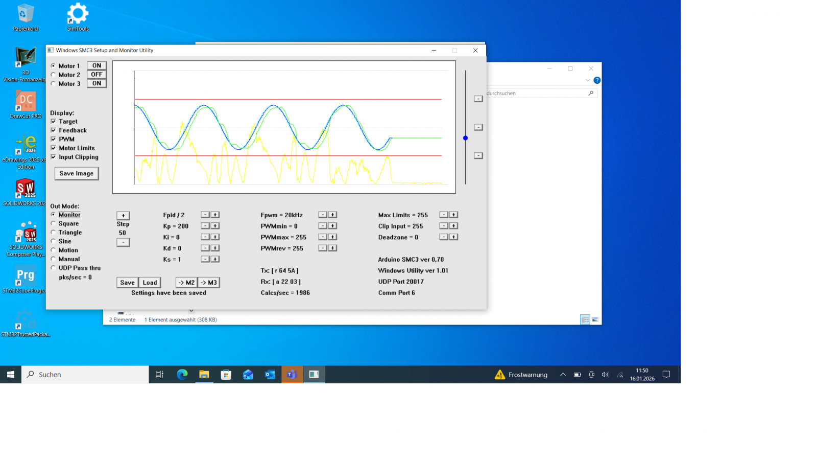

    I am in the middle of converting my Simulator to a Seatmover. Since it is many years ago after I used it last, i have to setup everything new. I still use the same Controller with SMC3 (still V.06 on the Arduino) and the same motors.
    I am trying for 3 Days straight to get it working again. So far with mixed results.
    I have a hard time to set up the SMC 3 Parameters. On the way up, the motors are very smooth, but I get trouble when the motor is moving downwards.
    Its like the motor is overshooting, slows down for a moment and move back on.
    This gives me like a step motion downwards. What is the beste parameter to look into?
    22,185
    154,750Coins
    +11,196 / 57 / -2

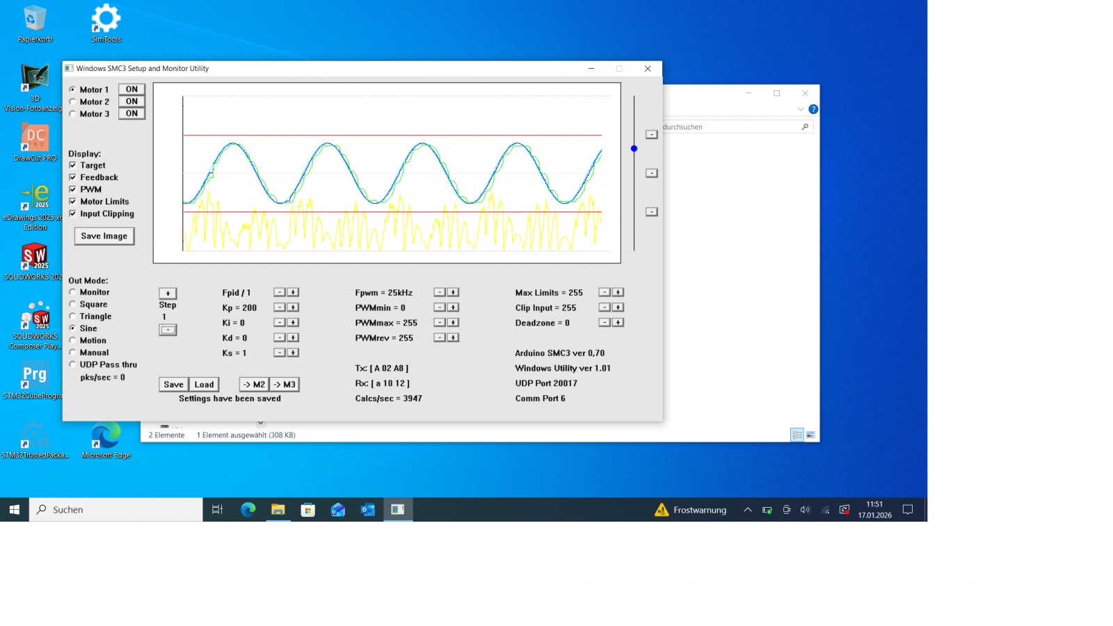

    Can you please post a picture of SMC3 running the Sine Test.

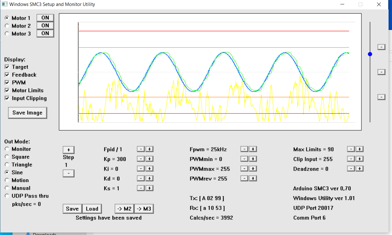

    i attached some screenshots. If i upp KP more than 200 it gets worse.

    Try setting Fpid to 1, Fpwm to 25 and Step to 1 then re-run and post the Sine test.

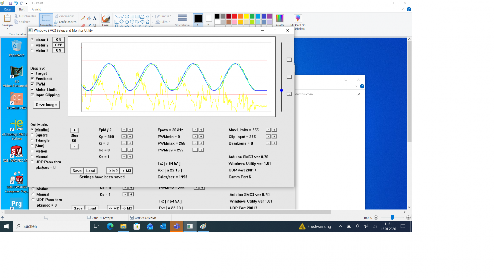

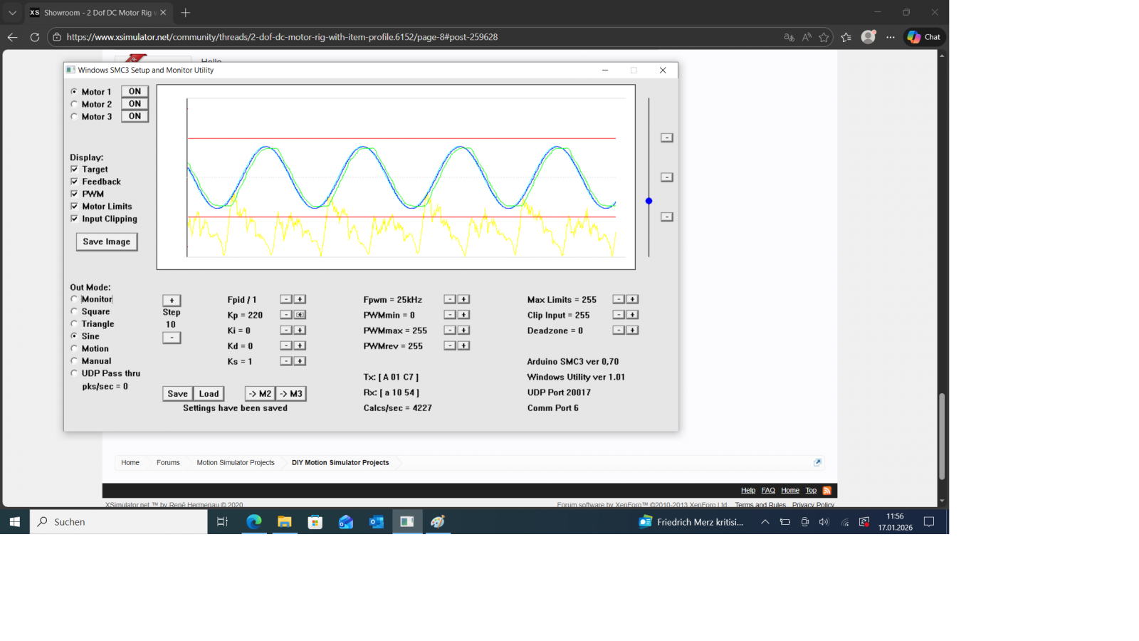

    changing the settings doesnt make a differenece. the motor moves like its going up and down stairs.
    on the picture nr.4 I moved the motor connection further away from the ujoint. This makes movement better. Maybe there is to much load on the Motor.

    Increasing the distance between the motor placement and the pivot reduces the load on the motor, as does shortening the CTC distance used on the levers, with the latter sometimes being easier depending on rig design.
    If you can also increase Kp and rerun the Sine test.

    I tried increasing kp, but this doesn't make it better. I think i first need a way to move the motors more far away from the joint, without new parts ^^
