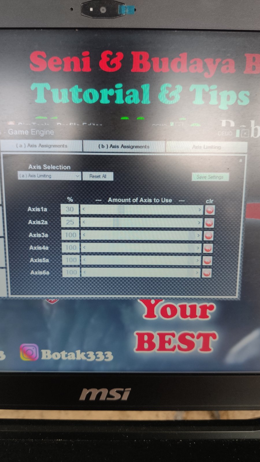

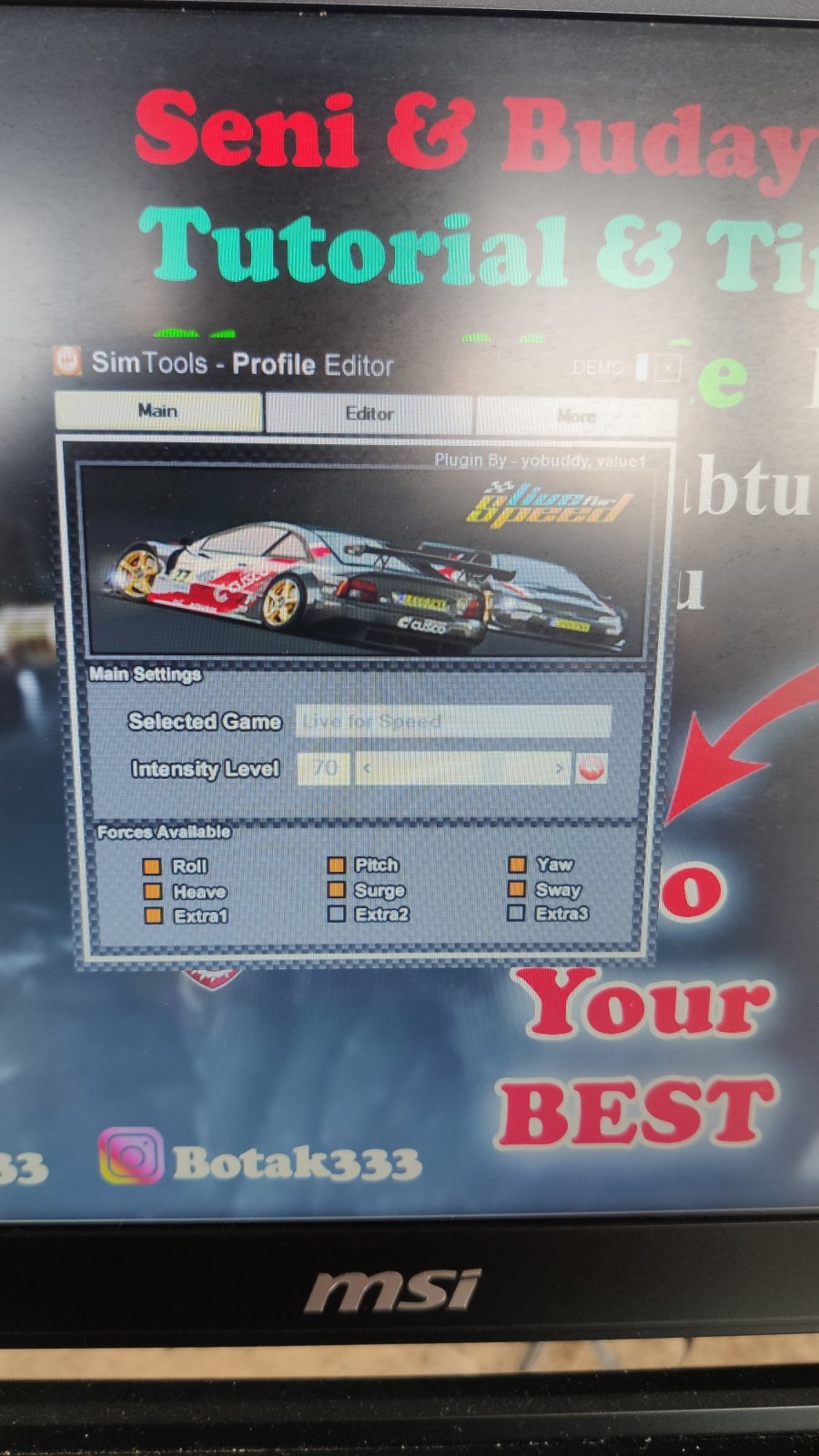

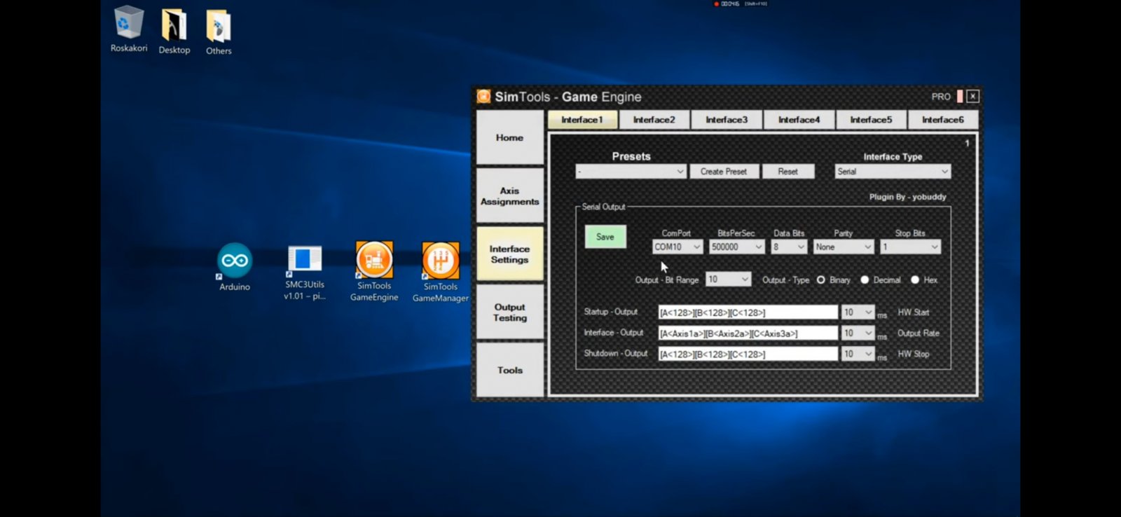

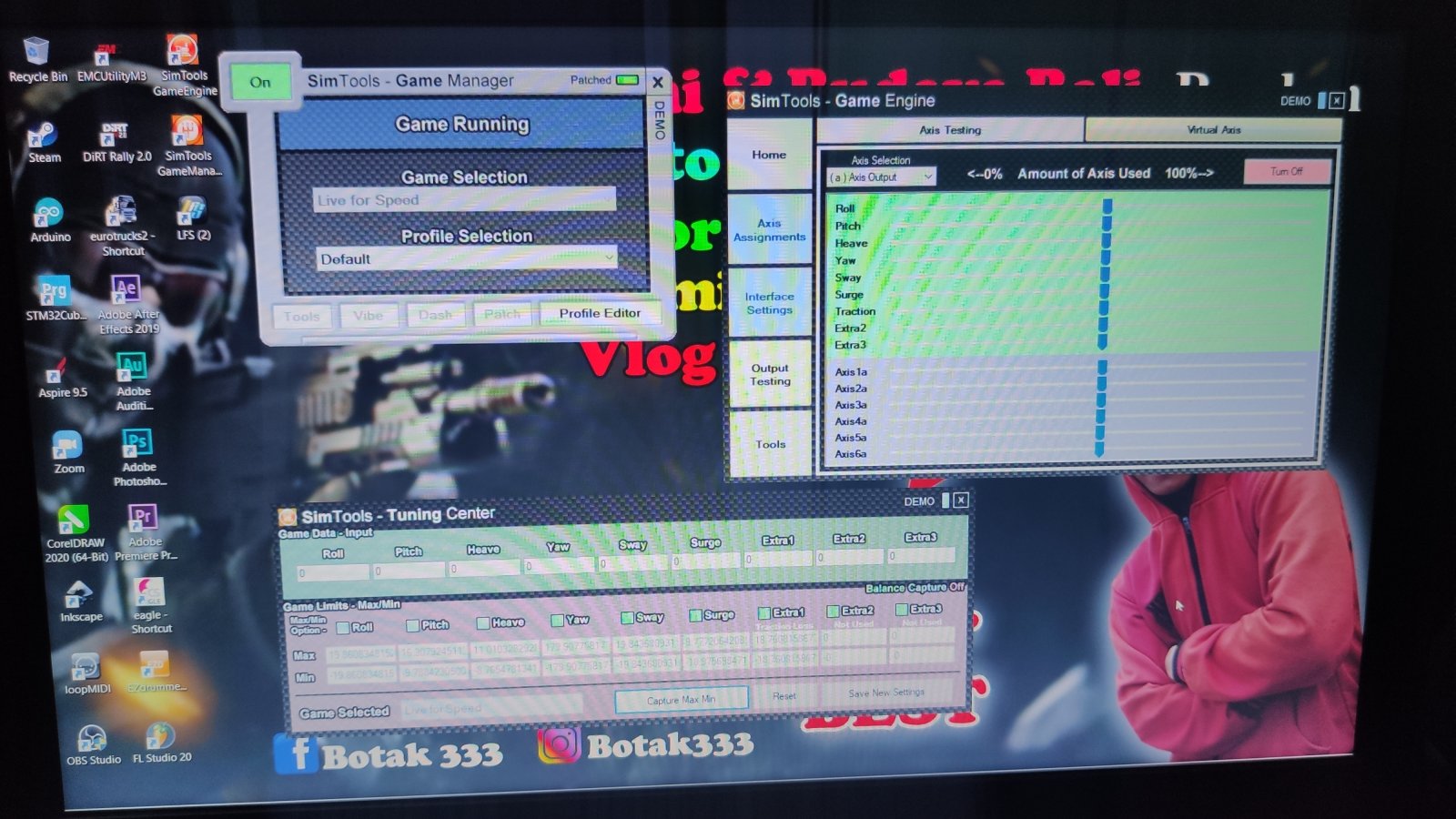

    hi can anyone help me? I have successfully built 2 dof, using a wiper motor + smc3, I have tested it with smc3utility to work well, then I entered the simtool (demo version) I have set accordingly in the picture (learned from this forum and some videos on youtube link: https: //youtu.be/rTUGWnJZTuI. )
    when testing output dof works fine, but when playing LFS dof doesn't work!
    I follow the directions @noorbeast link: https://www.xsimulator.net/community/threads/help-to-configure-the-simtools-to-life-for-speed.7425/
    the same doesn't work either,
    starting lfs single player first and then patching it doesn't work either, changing the axis assignments setting to sway and surge or pitch and roll also doesn't work what's wrong ???
    Please help me

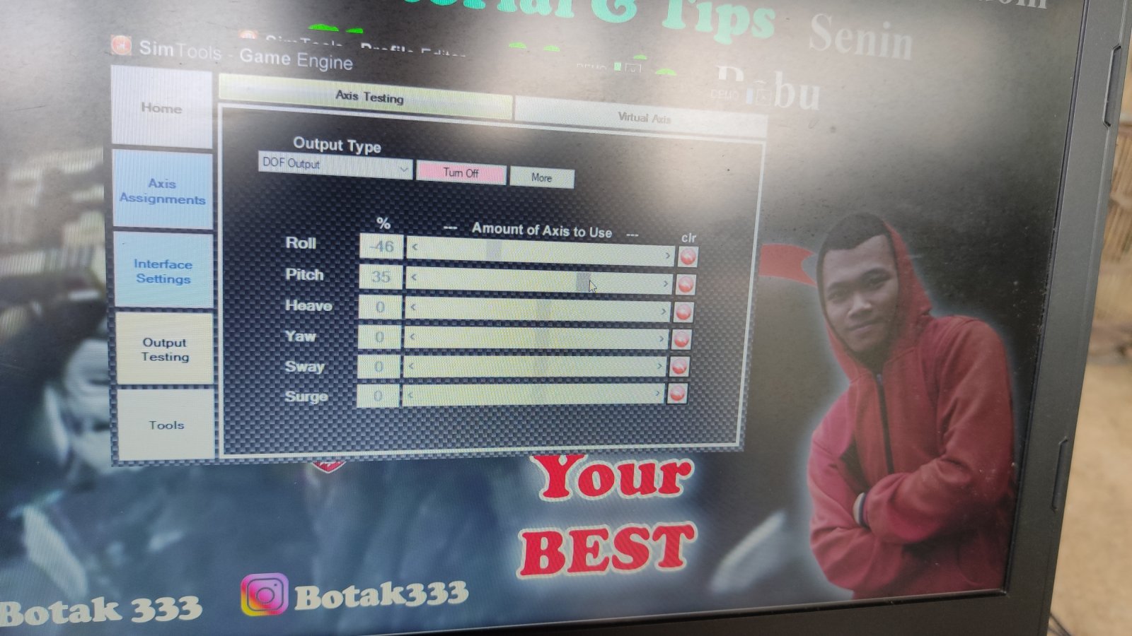

    How to know the testing as expected sir??
    I see when i move amount of axis to use the dof will move too sir. I thing the dof output testing are oke sir.

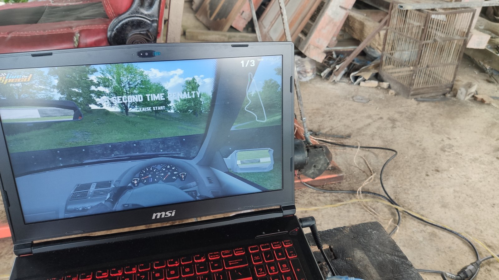

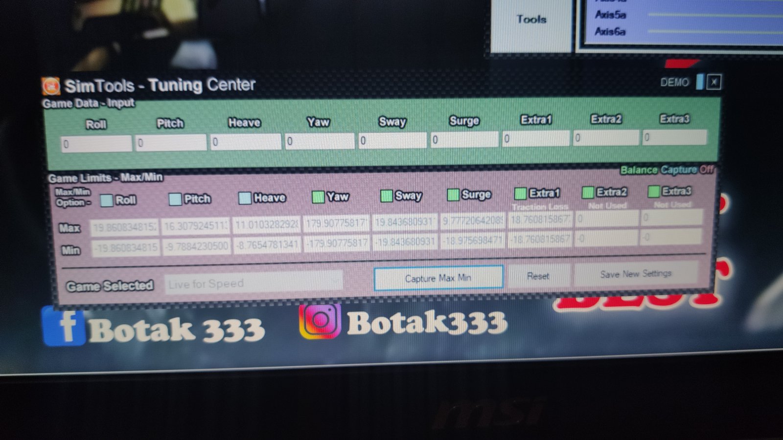

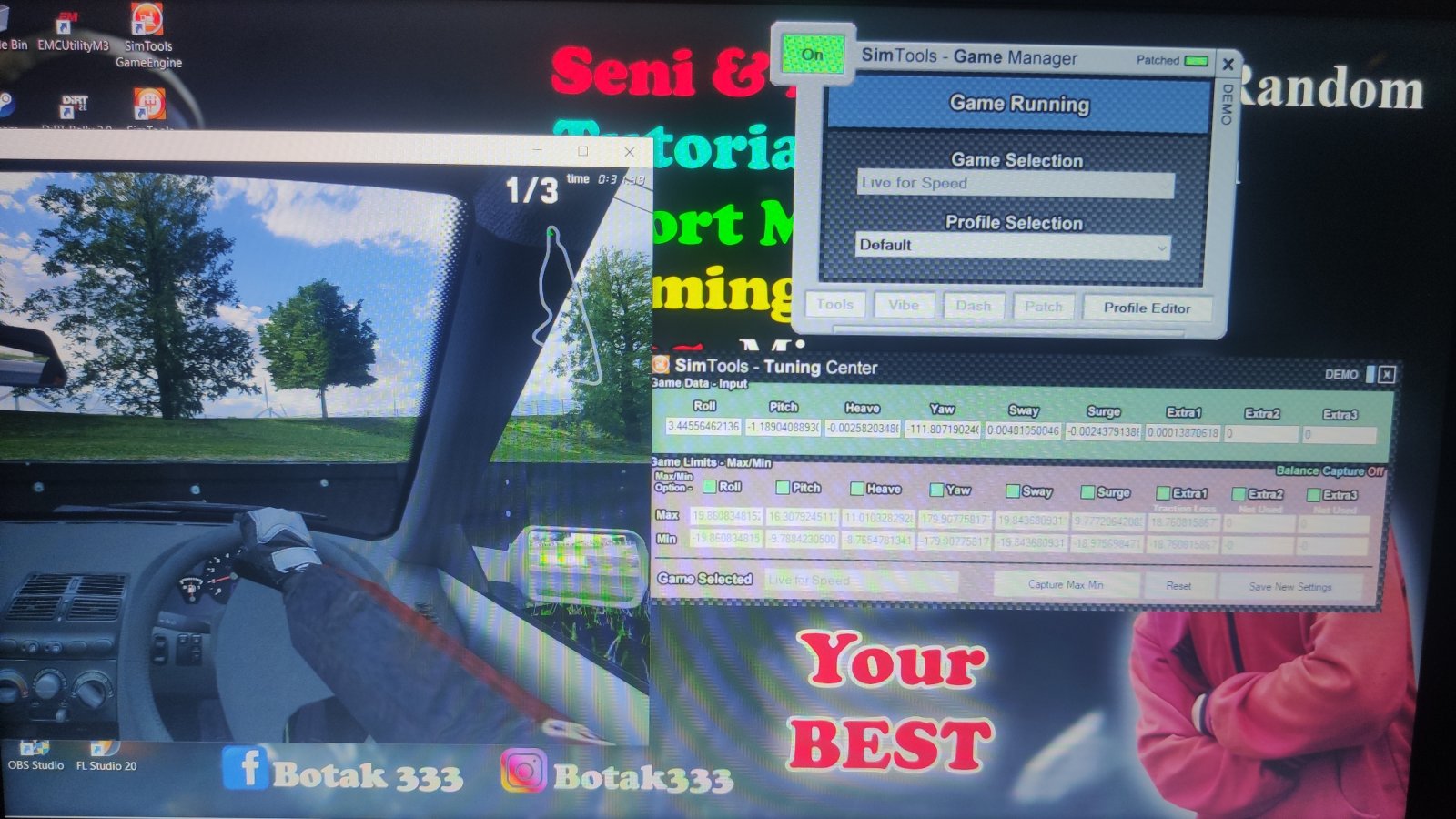

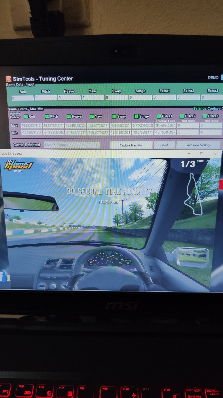

    Can you please run the Tuning Center and LFS at the same time and take a picture, we need to check if there is data in the top row while LFS is running. I can't see LFS running on a track in any of the existing pictures.

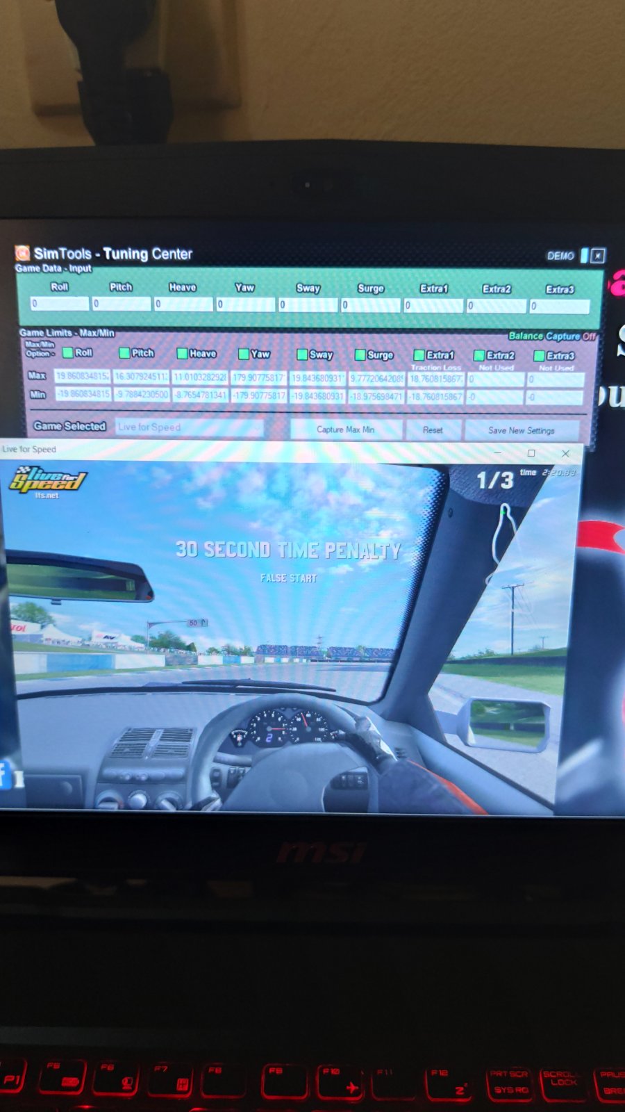

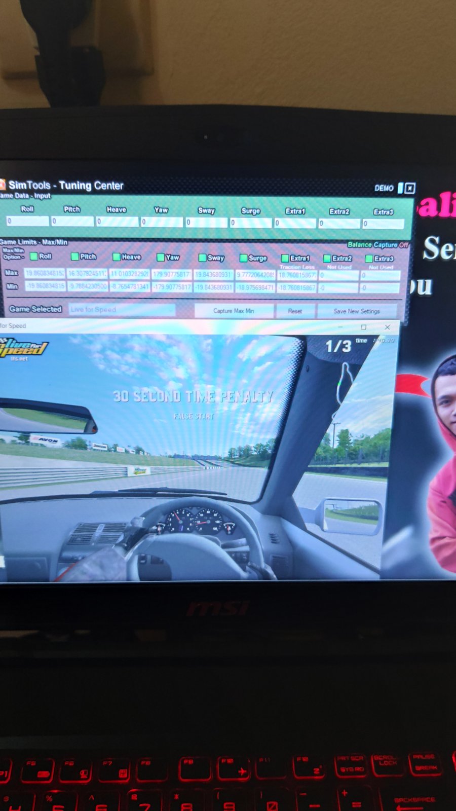

    This sir if i runing lfs and show the tunning center sir, the tunning center cannot work sir, on the to game data input just show 0 sir, while i run lfs, and broken the car to wall sir.
    I do this sir After instal lfs, run lfs and play single player sir, After that, minimize lfs and patch with game manager sir, after that go to lfs again and play sir.
    I cannot upload the video sir, just upload photo sir
    22,201
    154,669Coins
    +11,207 / 57 / -2
    OK, no data is getting through, so either there is a problem with LSF patching for motion, or something like your anti-virus or firewall are interfering with patching and/or data communications.
    Temporarily disable your anti-virus and firewall, then unpatch LFS, open LFS and do a race in first person mode, close LFS, repatch LFS, then test LFS and see if there is data in the top row of the Tuning Center.

    I dont used anti virus sir, just windows defender sir. And for run lfs first oerson is single player sirr??? Because i dont see first person menu sir on lfs. This night iwill try sir, but it is posible to try without arduino(smc3) amd my dof sir?? or there are settings that must be changed in the game engine or game manager sir ??

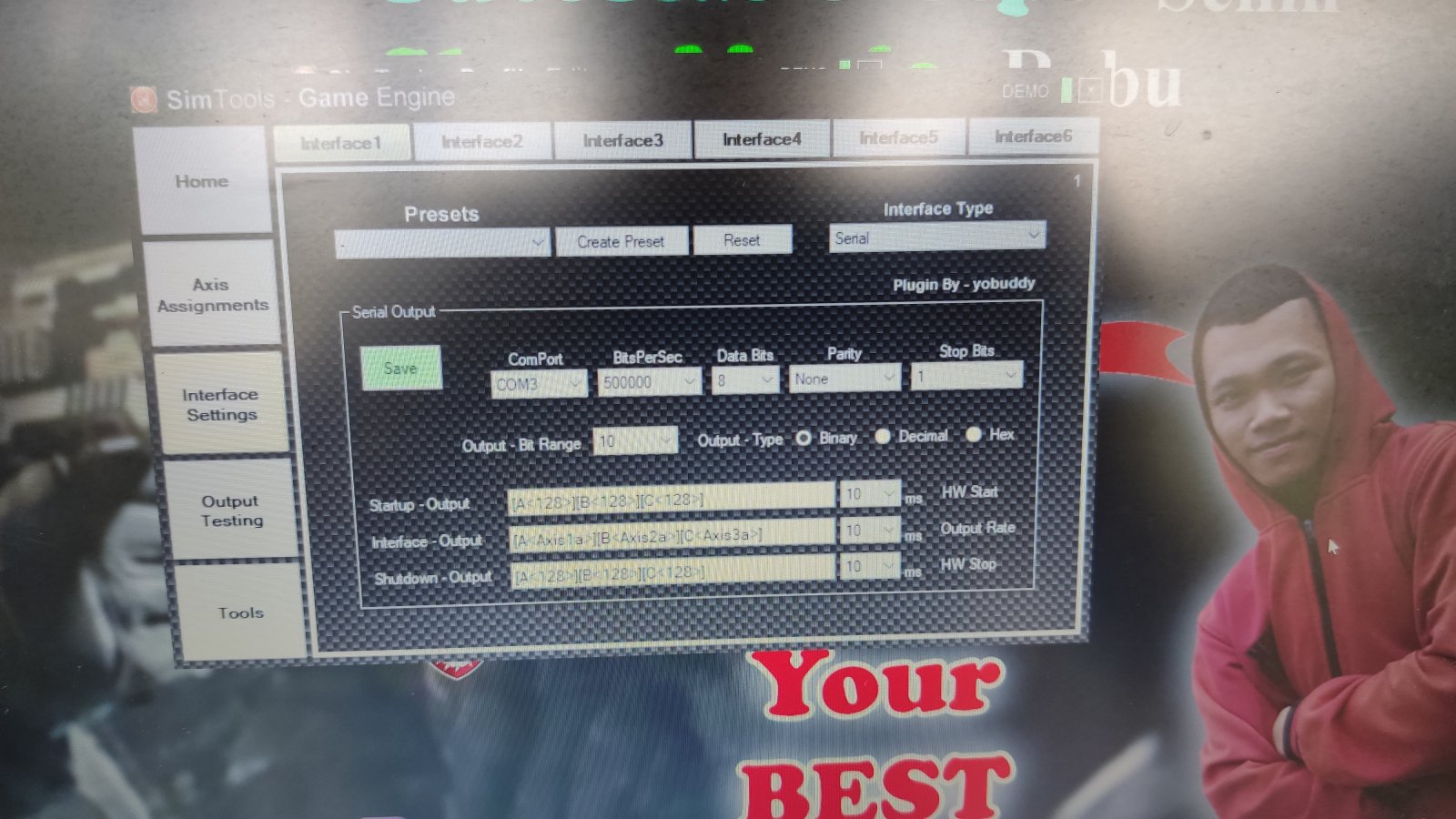

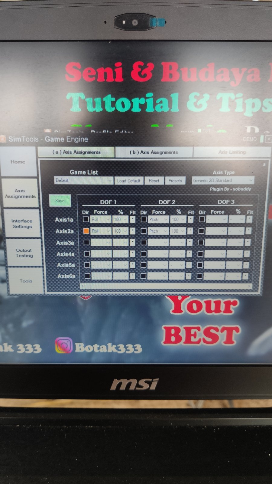

    Yes sir, tonight i will try, andwill info to you after that, or this error because i input interface setting like this sir?? My dof is 2dof.
  15. noorbeast
    22,201
    154,669Coins
    +11,207 / 57 / -2
    For a 2DOF use this in Interface Settings: [A<Axis1a>][B<Axis2a>]
    For now delete the Startup and Shutdown entries.

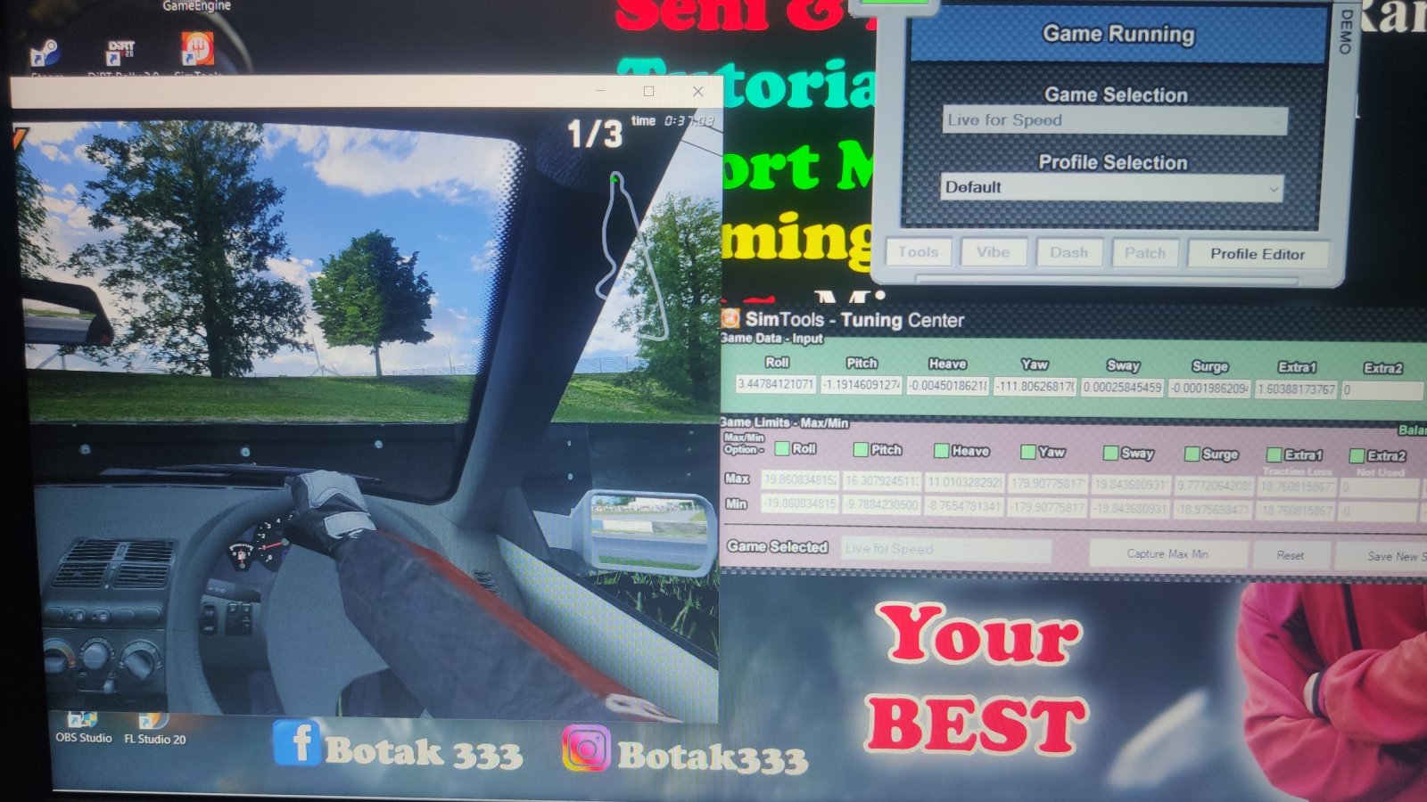

    Sir if like this the tuning center the dof work fine sir??.
    And what is fungtion of strat up and shutdown sir??
    Ithink the problem come frome windows defender sir, because after i exclusion folder lfs, and remove start up amd shutdown and remove [C<Axis3a>] on tuning center show like this picture sir.

    Thank you so much sir, i will learn more sir
