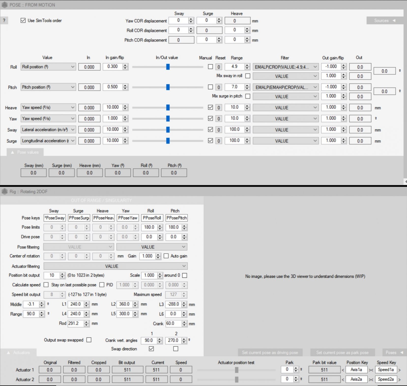

    Thanks Skuldi,
    This really helps me understand how flypt workshug:
    I need to adjust the scale of my rig in flypt, because now I only get 5 degrees of pitch or roll on my rig when I output 10 degrees in flypt .
    Maybe it is also possible to get it done by changing the gain ?

    jupp, but at the end i left it at 1.000 and only changed the scale of my rig. i can't remember what the problem with gain was.
    EDIT: leave gain at 1.000 try changing skale below that

    I did some test , changing the rig dimensions to other then the real size seems to work but I find it a strange solution.
    What helped the most was changing the range in the rig module , I changed it from 180° to 95°
    now my roll output in Flypt is 10° my rig is at 10.2°
    pitch 10° give 8.7° on my rig.

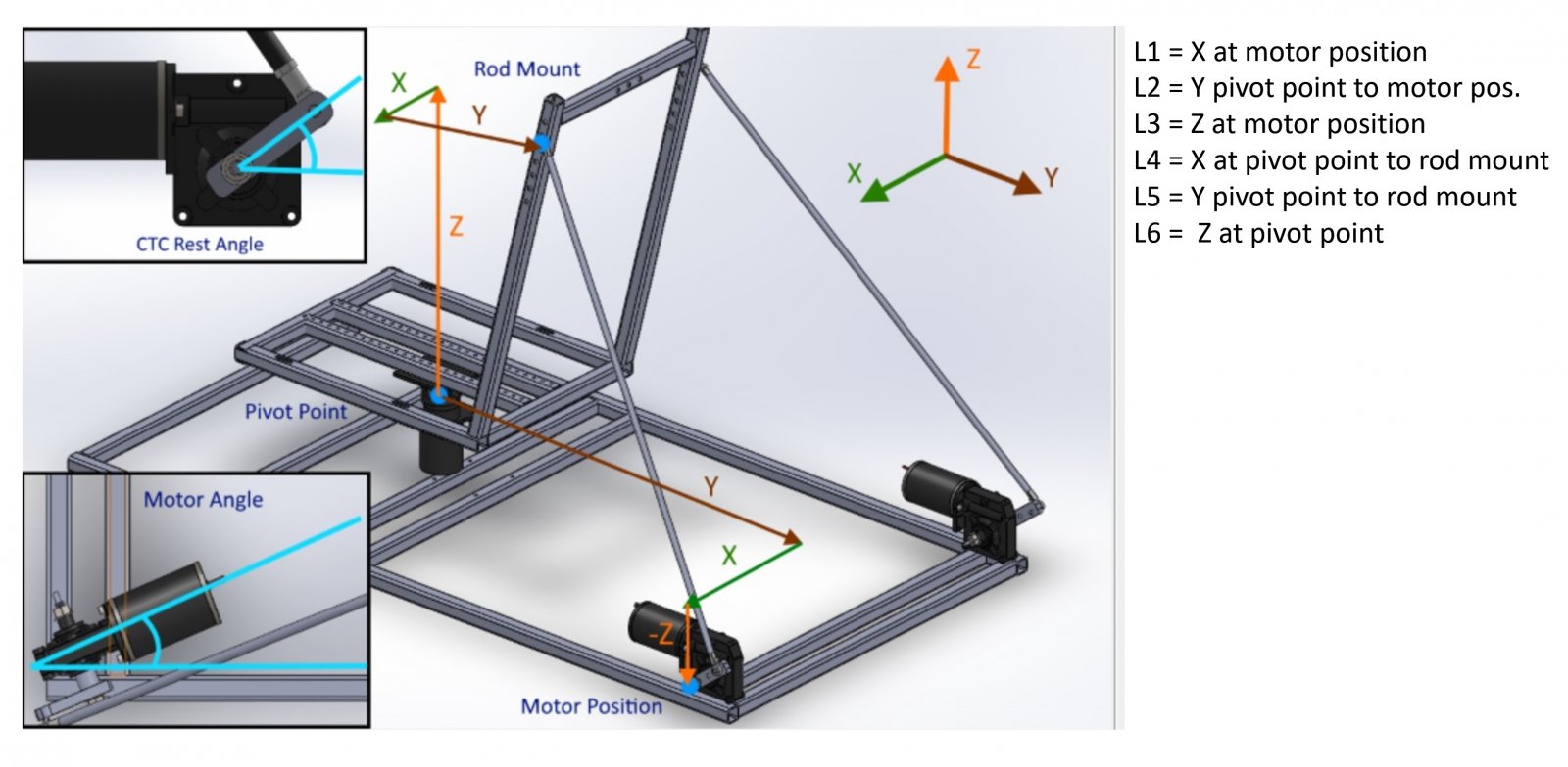

    changed values of L2 and L5 for 40mm so that pitch ended up at 9.5°
    L1 to L6 compared to sim calculation picture , made the changes more visual for me
    One thing the pitch and roll output do they just add up in the output?
    if i set pitch to 6° and then 6° of roll. one output to a motor will go to 12° ?
    that is maximum range of my rig
    so does that mean i'm limited to 6° for pitch and roll ?

    After tuning flypt with MSFS2020 , I did my first test flight in VR :cheers
    It worked , I did reduce the input gain a lot, just to be on the safe side
    In VR it feels great in non-VR it is too passive.
    I got 7° of Pitch and 6° Roll max on the rig but it seems te be enough for VR.
    here are my settings for FS in VR mode.
    Movement is still a bit shaky when output is slowly going up or down.

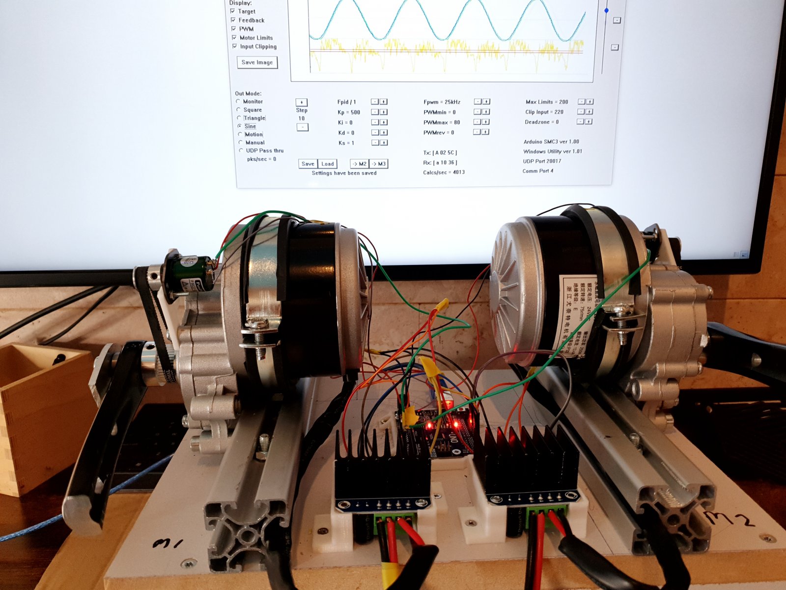

    You can try to reduce PWMmin in SMC for smoother movements.
