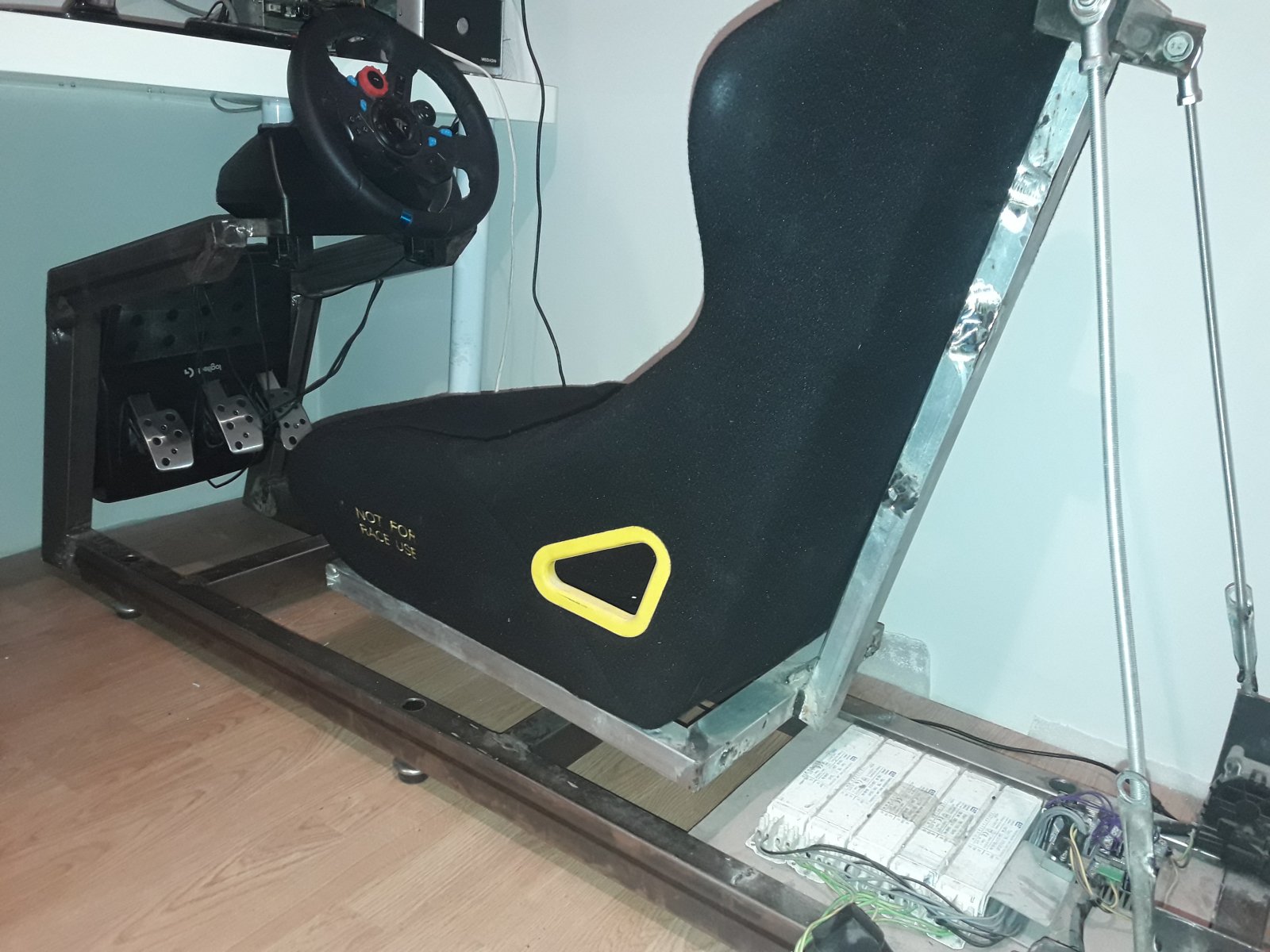

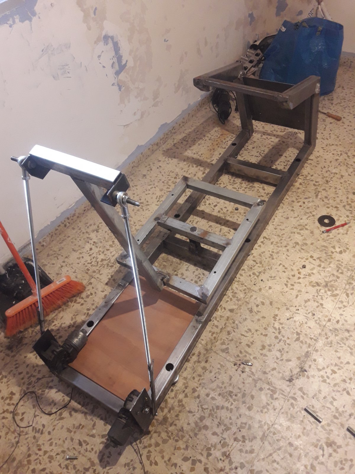

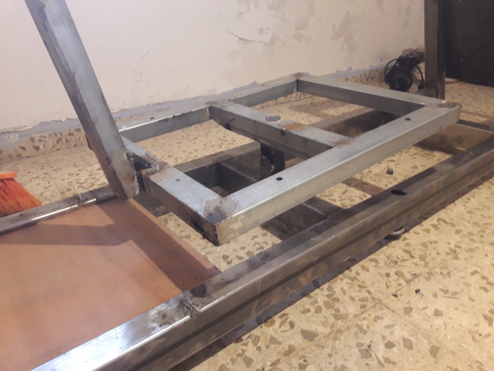

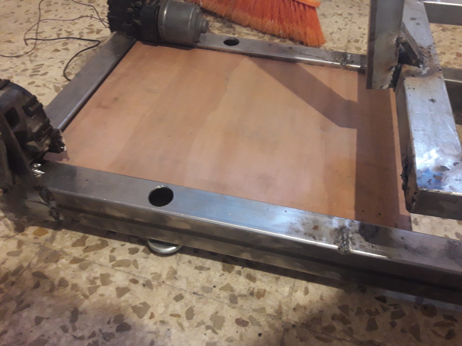

    Hello I am from Seville (Spain) I communicate with you through translators. I am making a simulator for ps4 com logitech g29 a baquet momo some lamps of diachroic lamps, arduino two bridges for 12 volt motors of ibiza 6l windscreen (2004). I am an electrician and my blacksmith friend is the one who helps build the structure. I leave you some photos

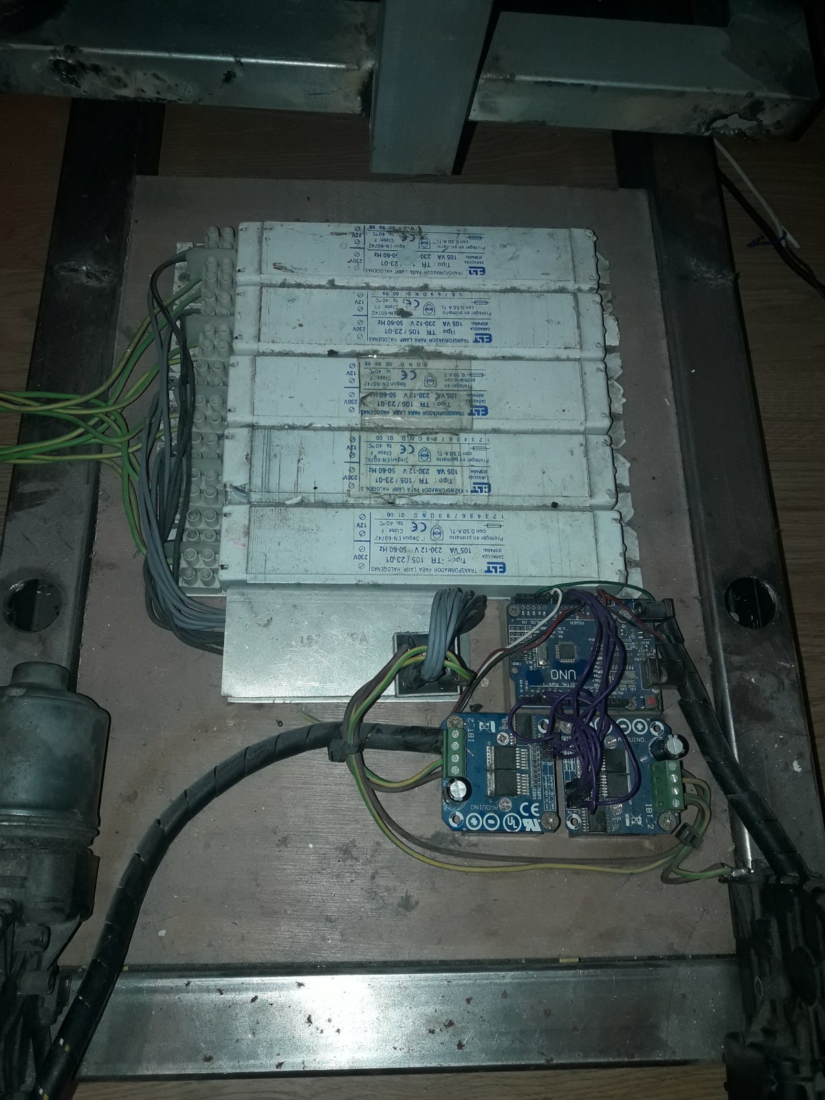

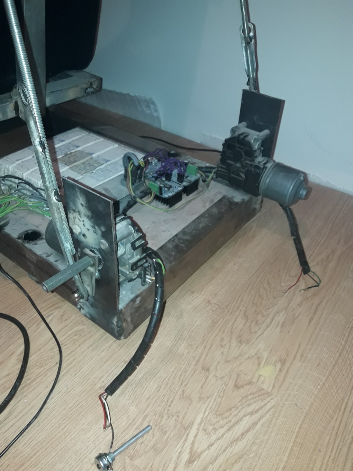

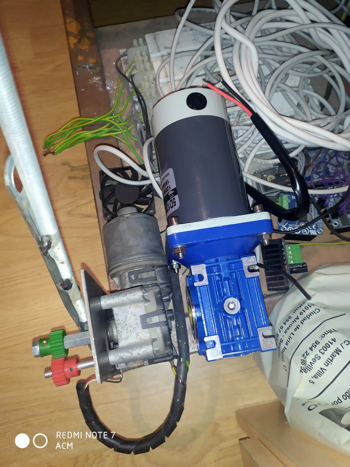

    Hello !! after intwntar several times, I already got my engines to move with ps4. Now all the values have to be adjusted and the potentiometers have to be perfectly fitted with some pinions that are making me.
    then I leave some photos of the process.
    a greeting!

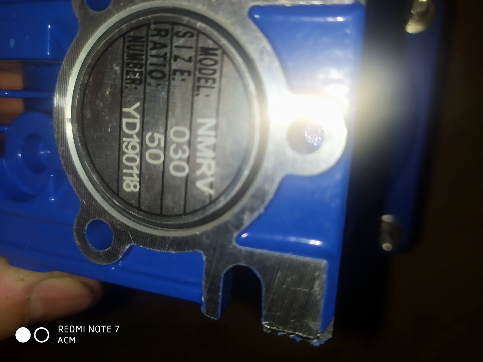

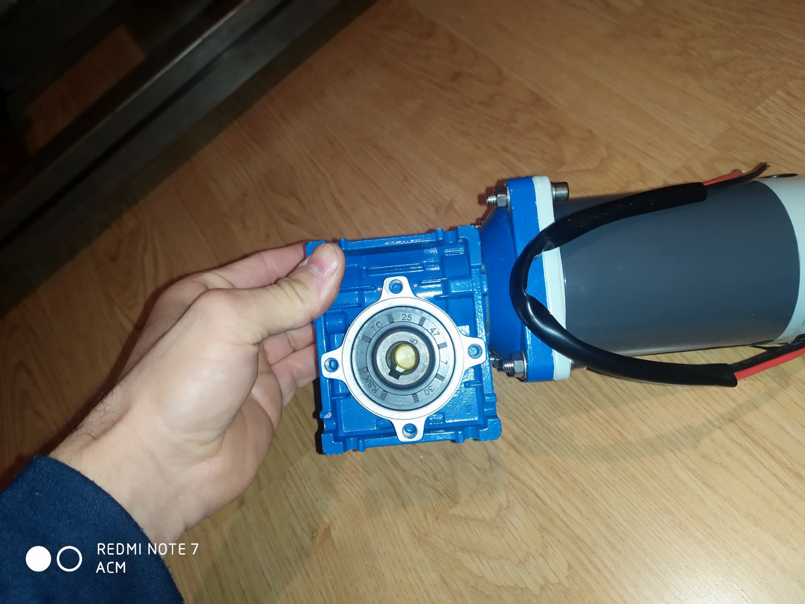

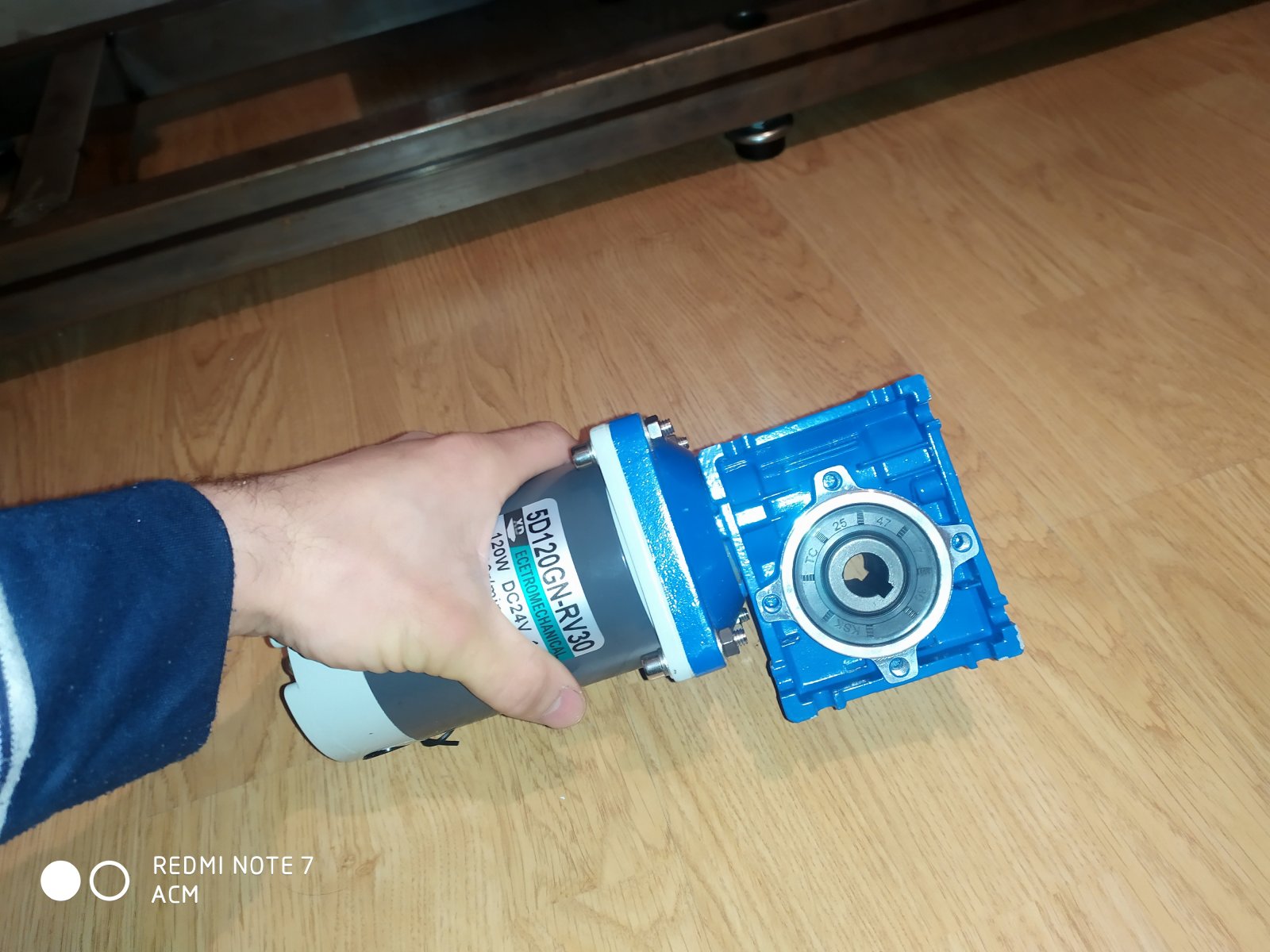

    Hello again, after a long time, I come back to continue my project.
    Among other things I go to the PC platform
    After my first project without great successes due to various failures, now I come back with more knowledge thanks to all the contributors to this forum.
    Used:
    - improper power supply
    - underpowered engines with unsuitable gearbox.
    - very low quality potentiometers
    The result :
    It worked, which for me is already a lot. So now I decided to perfect it with better components.
    Next I show the components that I am going to use:
    Motor: https://es.aliexpress.com/i/32926108505.html
    gearbox : 50:1
    Potenciometer: https://www.mouser.es/ProductDetail/858-6127V1A180L.5FS
    power supply: mean well 24v 20A for each motor
    What do you think of the new components? THANKS!!!

    2DOF, DC motor
    Looks like you got a much better selection of components for your new build.
    I also looked at those potentiometers for my build, seems really good.
    Mean well power supplies I have used before and done some measurements on, really well built power supplies for a reasonable price, great bang for the buck!

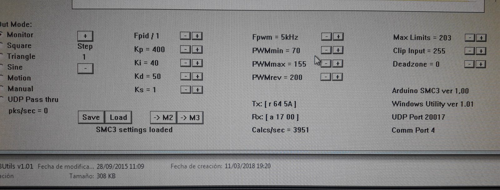

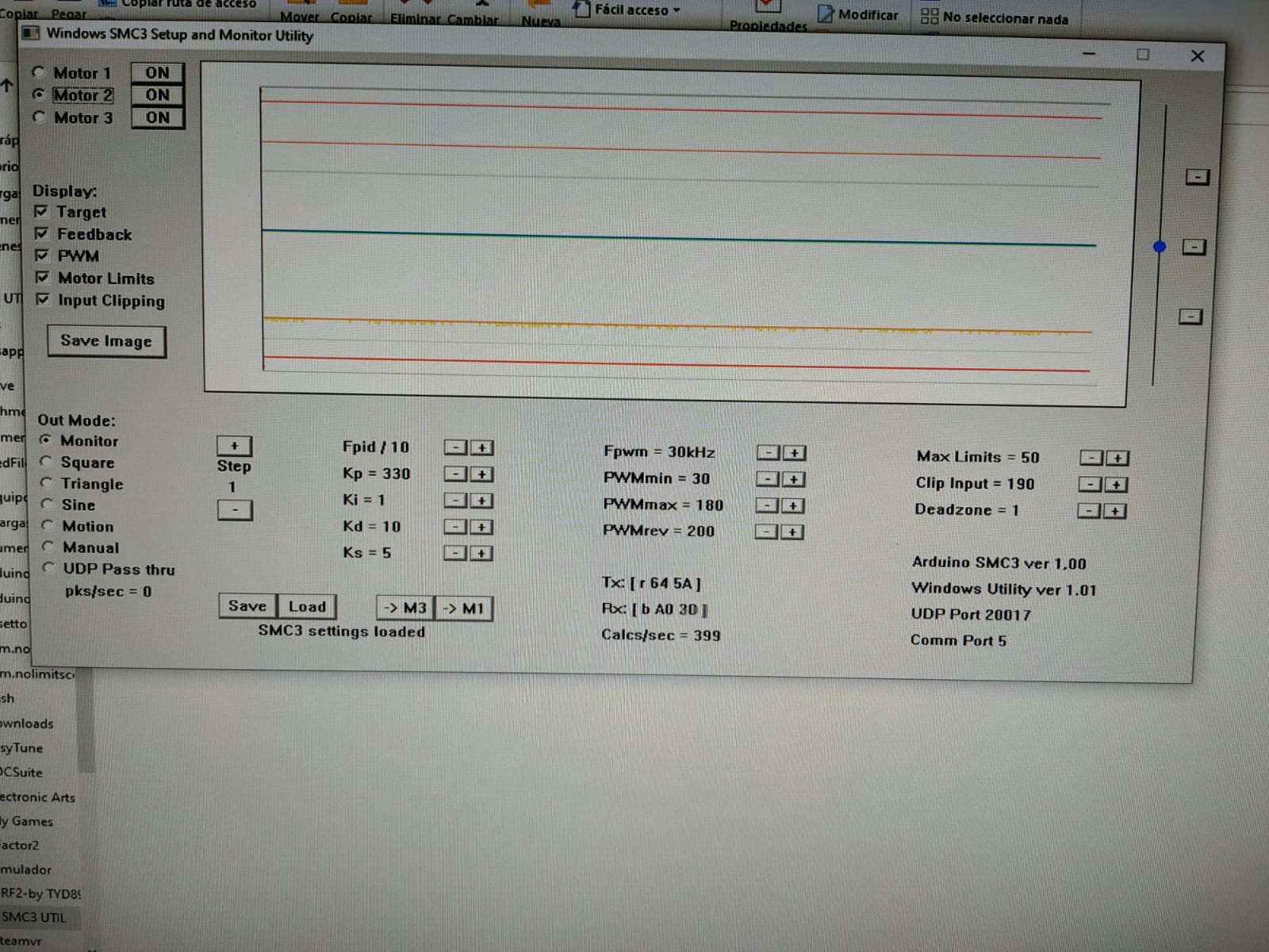

    I have a problem with both engines.
    The motors are continually stopping and I have to press the reset button on the arduino
    I use ibt2, in smc utily I observe that the yellow line (pwm) is very irregular.
    in my opinion with many peaks.
    Could they tell me that I have bad?
  17. noorbeast
    22,146
    154,502Coins
    +11,184 / 57 / -2
    Can you please provide pictures of all of your settings.
  18. Notre
    Notre New Member
    Feb 11, 2017
    12
    seville
    - 69Coins
    Also say that he added some pneumatic pistons to smooth the movements.
    Without the pistons the platform did not return to position 0 when it had to go up.
    when no one is on the chair it seems to work.
    sdjoint the photo of the configuration.

    Can you also please post pictures of all of your SimTools settings.
    Under what circumstances do the motors stop, is it hitting something or something else?

    - 69Coins
    right now I am not in front of the pc.
    In my opinion the engines stop when they have to make an extra effort.
    it also happens when I move quickly in smc3 utily.
    could the ibt2 be defective?
    the ibt2 have feedback towards the arduino? I cannot find the reason for the stop since the feedback of the potentiometer never exceeds the maximum limit.
    all of this happens mostly since I added the pistons although before it also happened less frequently
