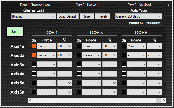

    Got it. When I break, my seat also leans backward instead of forward. Which parameter do I choose for that?
    That's correct :/

    Reversing the orange check boxes you have set for surge should do the job.

    Thanks, I'll try that.

    I should have said uncheck them.

    Things are fealing great! I've also reversed/unchecked my settings for sway and now i feel the "Gs" when I turn! XD
