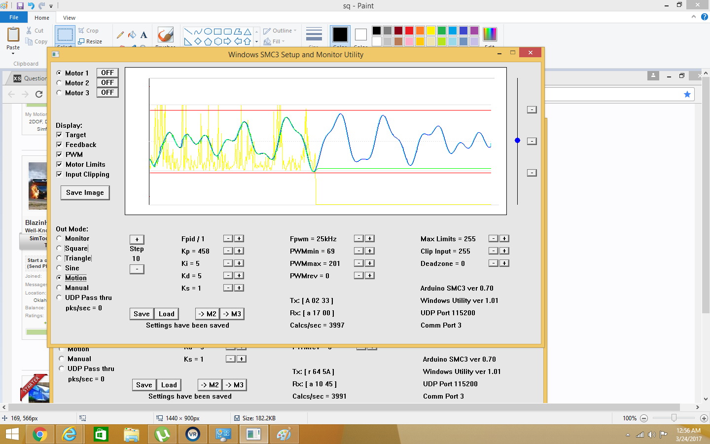

    thanks @speedy for detail explanation
    before i was using 1k pot today i replace it with 10 k
    now I got what @insanegr & @Pit was trying to tell. My bad understanding

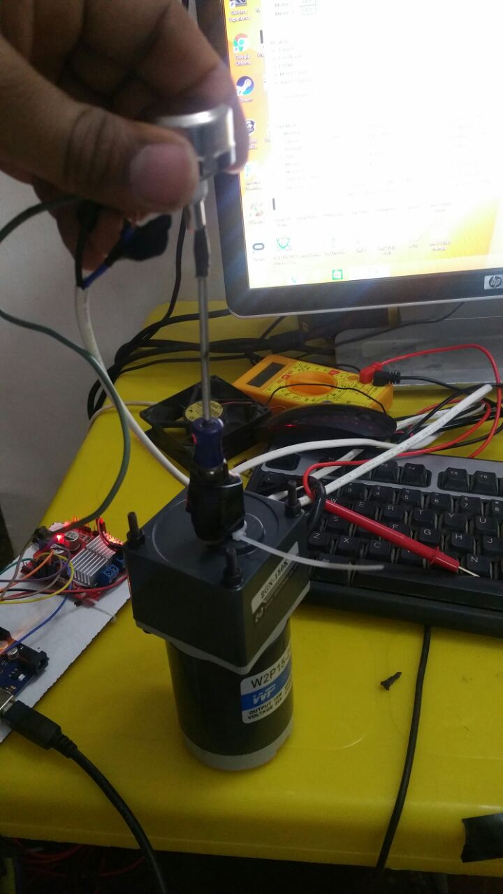

    now i tried to hold pot and motor shaft like this picture
    now the smc3 utility is showing this type of reading
    now please guide me further

    I have joined screw driver with motor shaft and hold the pot by hand please check in video
  4. Pit
    3,007
    30,518Coins
    +3,101 / 31 / -0
    Great, you got it working, but the motors are way too "slow", you cannot do anything more. Are you sure the motors are only 12V motors?

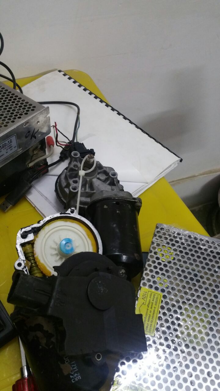

    I have replaced my dc 24 volt motor with wiper 12 volt motor
    should we need to setup pot directly with motor ?
    i saw somewhere on youtube that pot is connected to motor from backside with extended shaft and from front shaft using for playseat so should i have to do the same as this motor is very fast and i cant handle it with pot in my hand
    do you have nay picture for reference for this motor

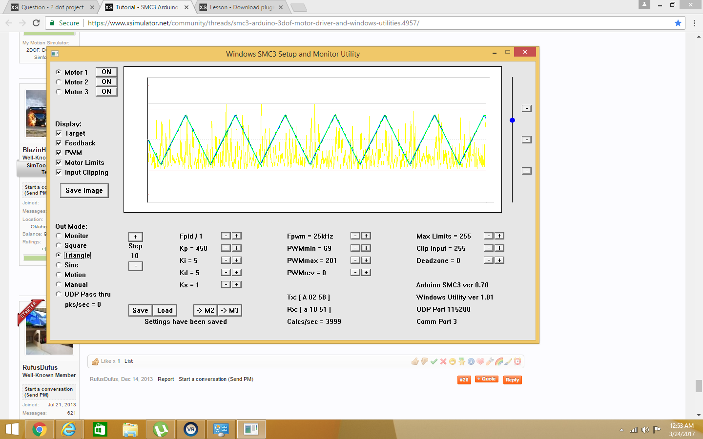

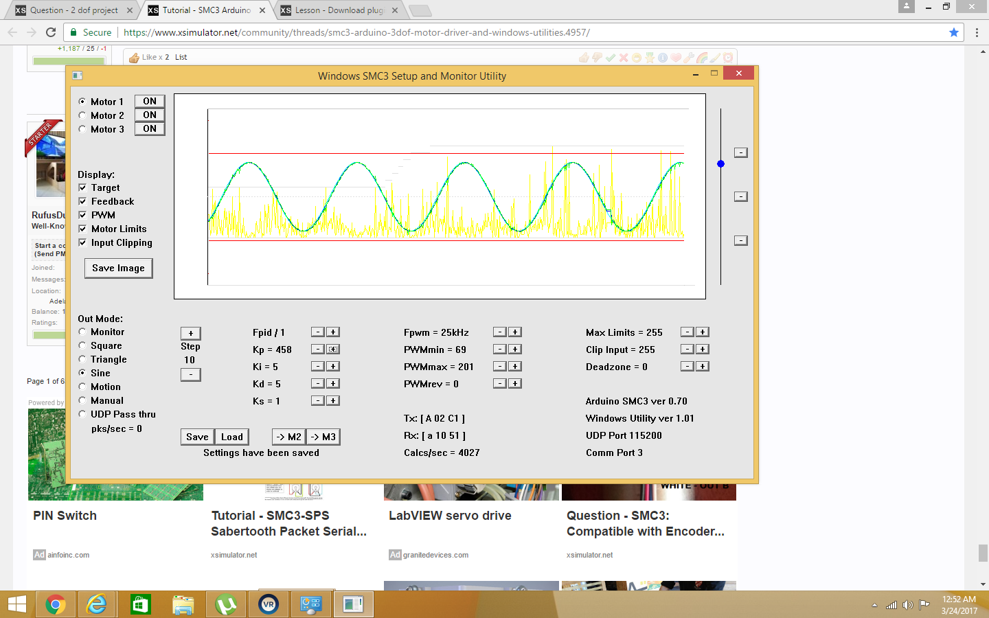

    hello guys i am back . i have bought a wiper motor and make a back shaft for pot now my smc3 is like this smc3 after pot.png

    Very Nice ... keep going . :thumbs
    To more enhance the square step => use the Ki & Kd to lower the oscillation , use 1/10 the amount of the Kp or lower ...
    To get a perfect position holding use some more 50 or 70 PWMmin to overcome the motor startup friction .

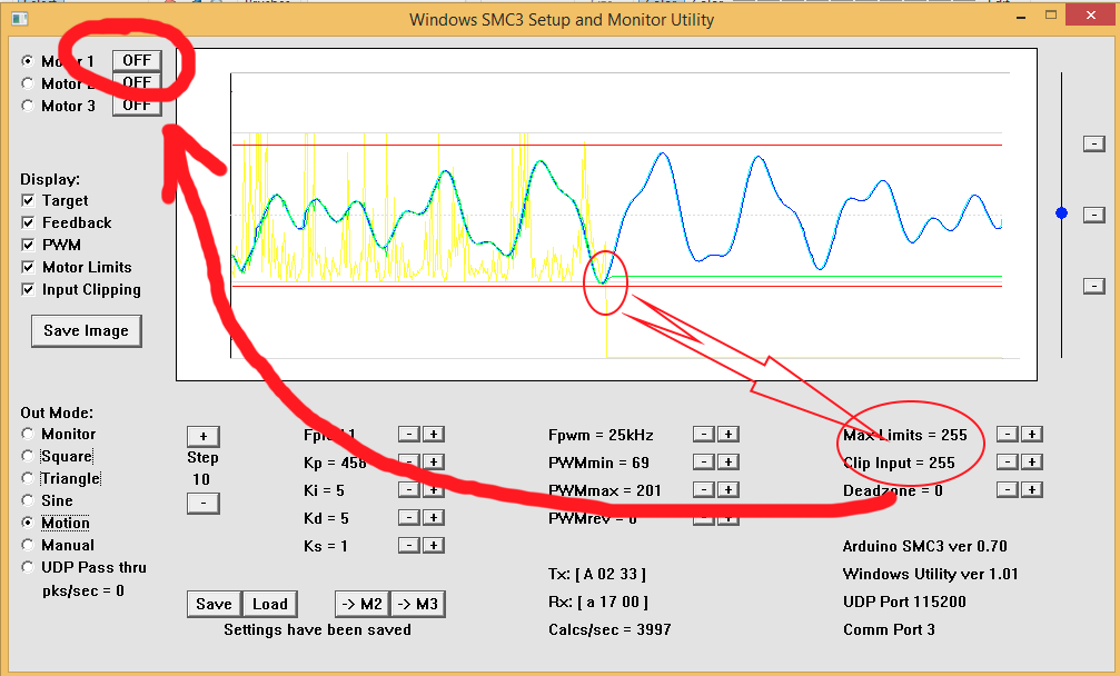

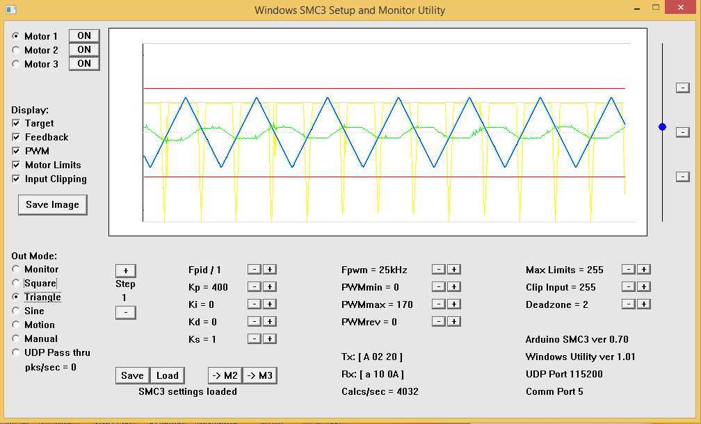

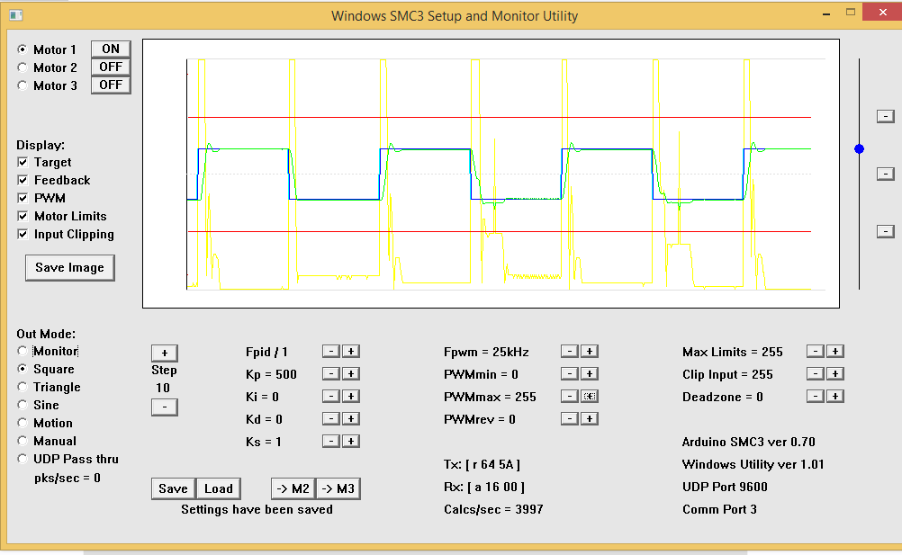

    hello please guide me

    @Pit you mean to say i should change the limits what would be the correct limits please share link
  20. SeatTime
    2,572
    +2,854 / 40 / -0
    This will all depend on 'Your' rig - very unlikely that any two will ever be the same. Members have been kind enough to get you in the ballpark, but now you need to educate yourself so that you can do/understand yourself - instead of expecting every step to be done for you. Have a look at the FAQ - it is all there. Yes, you need to do some work.
