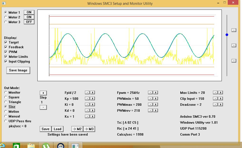

    hello i have changed the max motor range & other settings now SMC is working fine

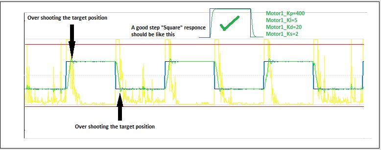

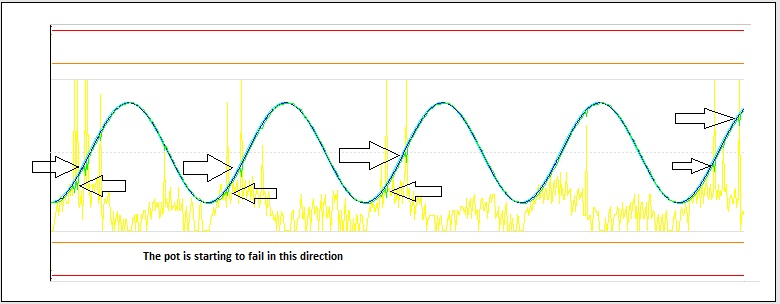

    In the "Out mode = Square " ... you'll see an over shoot for the motor "Where the motor goes beyond the step up/down " ... while it should be like an S curve ... smooth start > the fastest go > and a smooth stop ... you need to do that with the help of Kd , Ki , Ks ...
    Make sure that you have a good feed back + No mechanical play .
