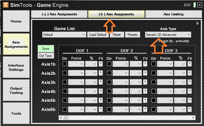

    As mentioned it is a lot of other project going on as it stil is (a rainy) "summer" here in northern Norway. But I spend a little time with my sim-rig also. I only play ACC now and try to make the seat-mover work as best as possible in that game.. (btw, testing rig and trying to improve safety rating... bad idea :))
    I had some issues with unwanted movements and found this tread: https://www.xsimulator.net/communit...p-to-prevent-negative-vales-and-movement.340/ I was very useful and the chair worked more stable with setting up a and b axis. I still have some small movements I feel is not right (maybe my bad driving :) and maybe some filters would help as smoothing and washout. I cant find any way to activate filters on the b axis, as I cant see that box,,, what am I missing?
  19. noorbeast
    22,185
    154,750Coins
    +11,195 / 57 / -2
    In what circumstances are you restricting movement, as that would normally be used with something like a G-Seat?
    If you have B axis configured in the Interface Settings you can configure them in the (b) Axis Assignments tab.
    The Axis Type opens further options such as Filters.

    Thanks, believe I tried axis types, but will try again when I get home. The movements I talk about is ex. sometimes on a straight, i feel i get some quick sway-movements that is too much compared to what i get in a turn. Hard to explain. As I understand smoothing filter, it is to make theese movements a bit smoother, and washout is to make reversing movements (back to zero) softer? I wont be surpriced if I got it all wrong :)
