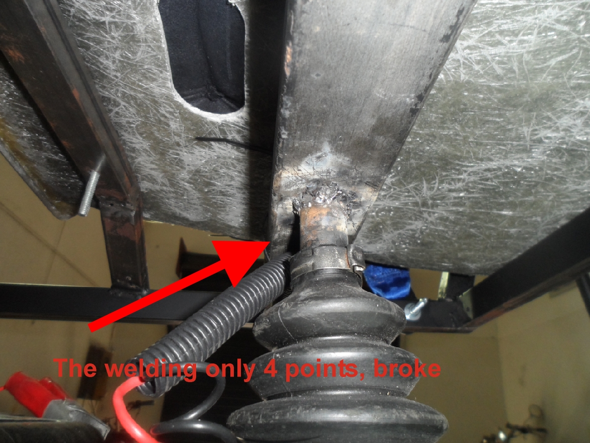

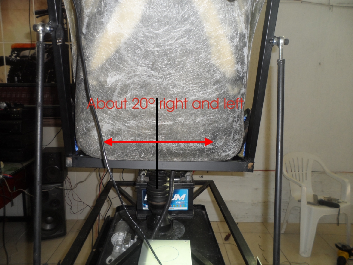

    Hi all
    when I tested the first moves, they were not smooth so I had a problem:
    the weld on the shaft had only 4 stitches and they broke.
    the seat then moved about 20 degrees to the right and left.
    this ended up giving me an idea for a Traction loss.
    This above weld broke

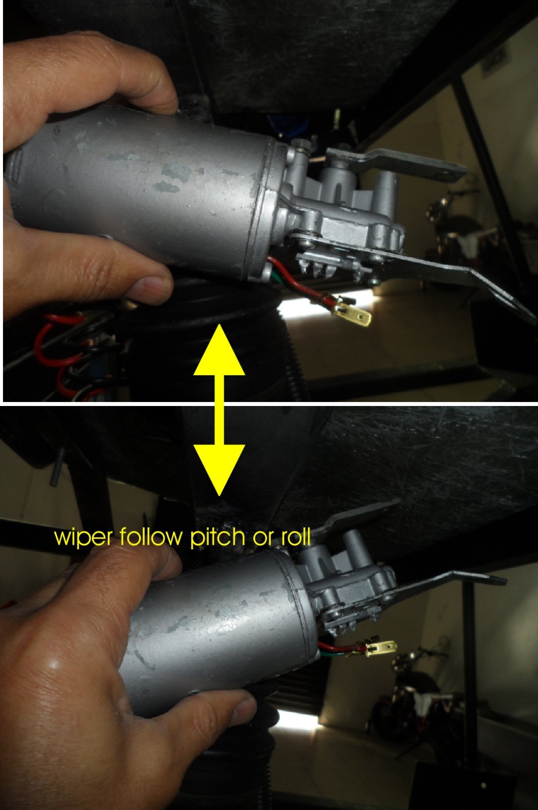

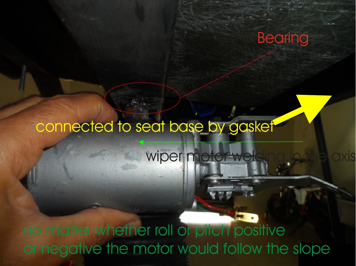

    so I had an idea for TL
    if the motor is attached to the shaft it can move
    both for roll and pitch without other mechanisms like wheels ....
    like the picture below
    the troublle:
    I have an arduino nano and a Monstermotor only one output working, another interface with RacingMat code will work for an EXTRA1?
    txs to all.
    22,185
    154,750Coins
    +11,196 / 57 / -2
    If the pivot for your additional motor is the shaft under the seat then what you would be implementing is yaw not traction loss, as the latter has the pivot point near your feet while the pivot point is centralized for yaw.
